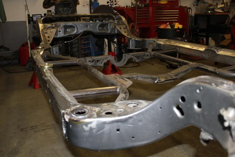

HEEP 05-05-2013 05:36 PM
Just a quick update. It rained this weekend, so I was able to do some work and finally finished the frame. Got all the body mount rings that are included in the HPI kit installed and then the braces that are from ABC welded in.
Then, I got to clean out the catch-all. The body. Put a bunch of thingins in the attic of the garage to get it out of the way. My son was excited that he can help now that all the welding is done. Going to be a busy week for work, but maybe, just maybe, I can get the body back on the frame sometime this week. If not, it will be Sunday before I will have some time... no wait, that is Mother's Day. That will not happen. HAHA

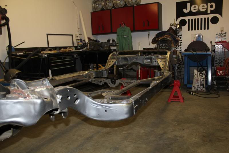

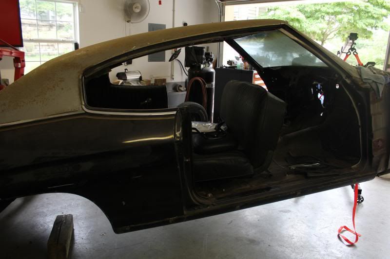

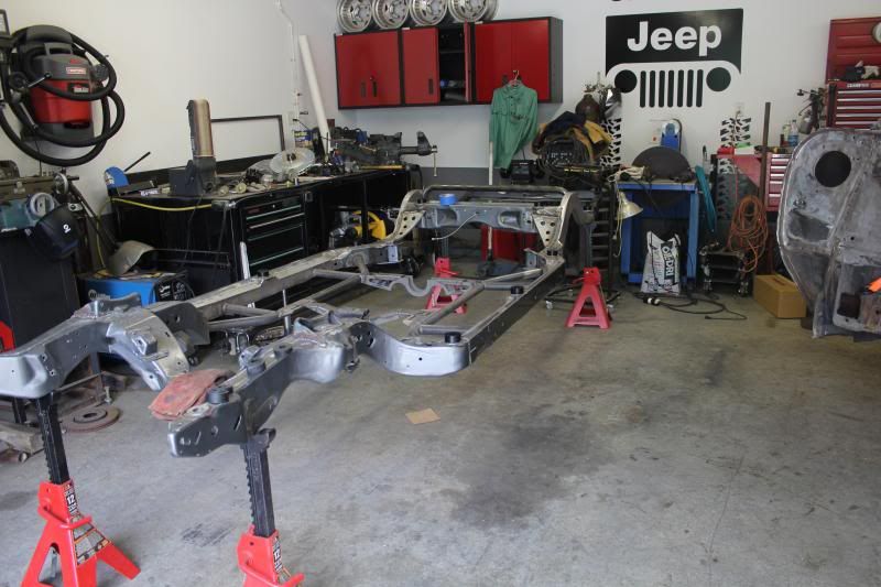

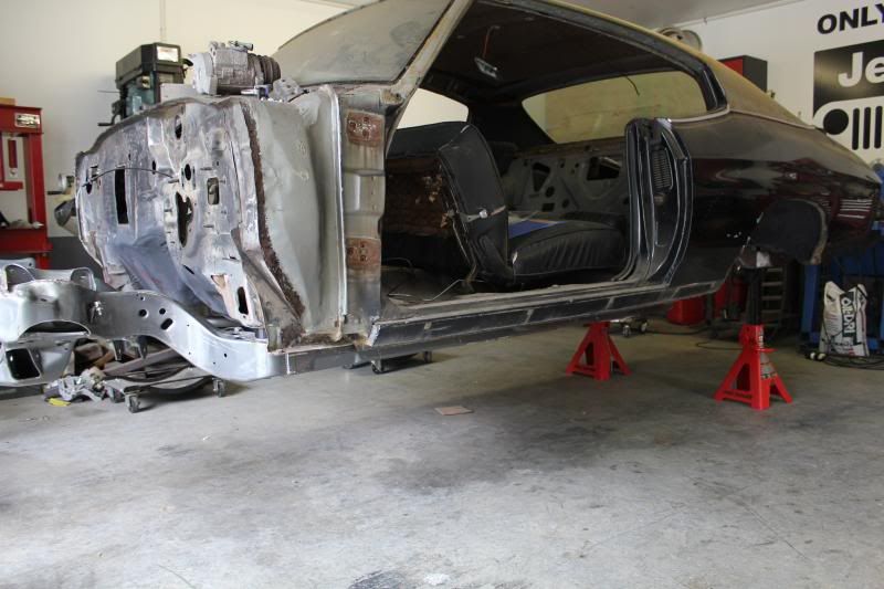

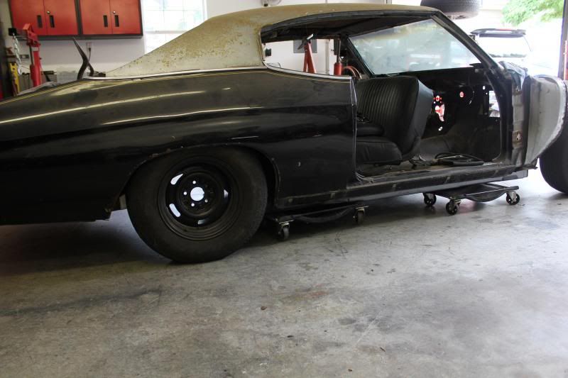

HEEP 05-06-2013 07:08 PM
alright, business dinner got over early, so I got a little time in the garage. Took you a couple of pictures. First one is the finished frame.
http://i115.photobucket.com/albums/n...psdae8dc4f.jpg
Here is the other side view.
http://i115.photobucket.com/albums/n...ps3bbc981f.jpg
Here are the spacers that come with the HPI kit.
http://i115.photobucket.com/albums/n...ps8314110f.jpg

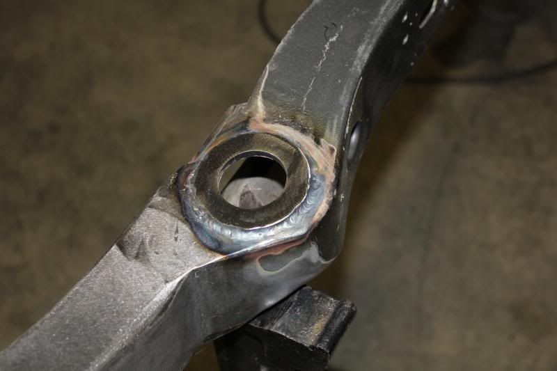

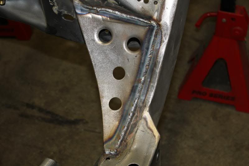

Here is the gusset from ABC welded in.
http://i115.photobucket.com/albums/n...ps713db9ac.jpg

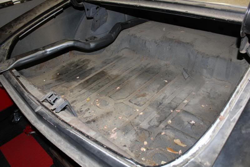

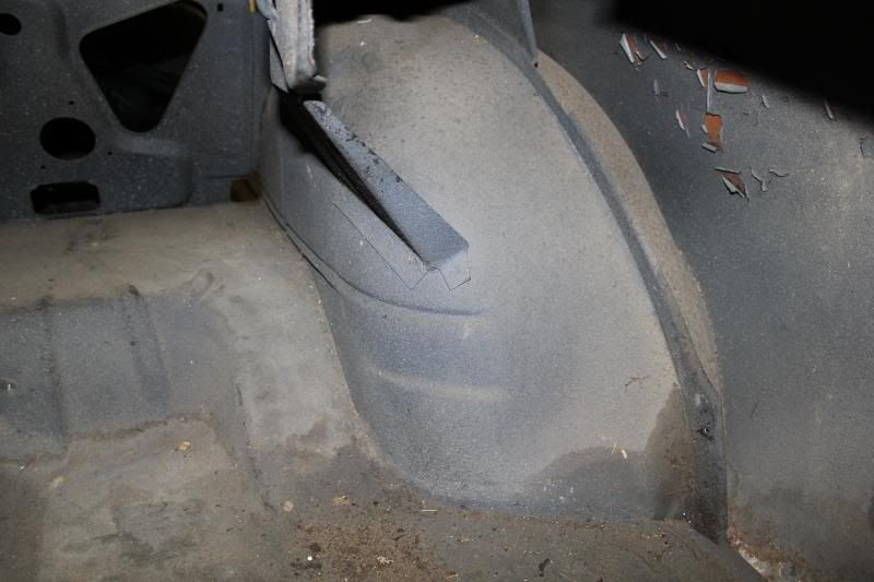

Of course, we are starting to get ready to set the body back on. the trunk has not been this clean in years. Anyone need an original crossmember?
http://i115.photobucket.com/albums/n...ps890b569f.jpg

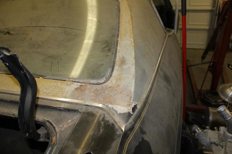

Then of course, this car was originally a vinyl top car. Ironworks Chevelle brought back some memories.
http://i115.photobucket.com/albums/n...ps13fda6e5.jpg

214Chevy 05-06-2013 07:18 PM
There you go Heep...that's more like it. Frame is looking good bro. :welder: Big progress getting the body back on. :thumbsup: :thumbsup:

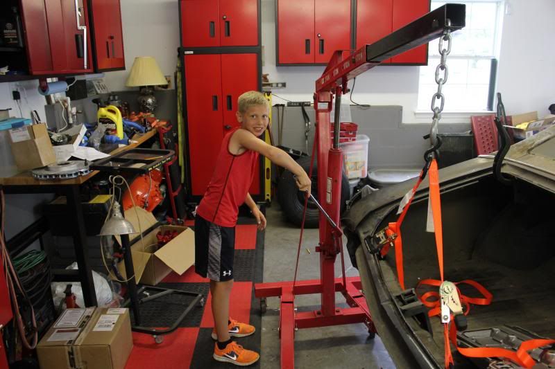

Yes, I'm ready. trying to figure out how at this point. I'm thinking two engine lifts, one on each end. I can put the frame on dollies, to manuever it better. you know how it is, these garage built cars with no lift:bang: .. got to do everything the hard way.
HEEP

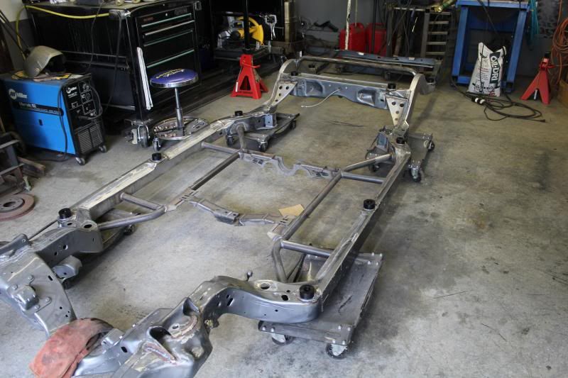

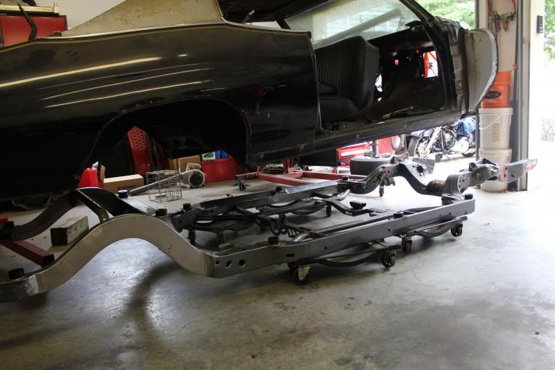

HEEP 06-02-2013 04:53 PM
Well, it was a monumental day in the HEEP garage. After 23+ years, the frame and body have been mated back together to make one. As I stated earlier, a couple of engine lifts
http://i115.photobucket.com/albums/n...psb02dd35a.jpg
With some good help
http://i115.photobucket.com/albums/n...ps60b3ae0a.jpg
I set this on some rollers
http://i115.photobucket.com/albums/n...psa40726b7.jpg
http://i115.photobucket.com/albums/n...ps7f3b3df2.jpg

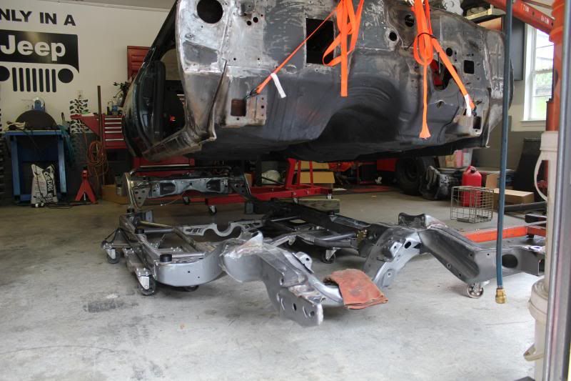

HEEP 06-02-2013 05:00 PM
Rolled them together
http://i115.photobucket.com/albums/n...psb5f0051b.jpg
Got a little jack action
http://i115.photobucket.com/albums/n...ps93a27cee.jpg
http://i115.photobucket.com/albums/n...ps33f13f61.jpg
What about ride height
http://i115.photobucket.com/albums/n...ps128775b3.jpg
And we are set in the garage
http://i115.photobucket.com/albums/n...ps8b8b4986.jpg
At this point, I guess now set the engine, get the suspension under it. Many nights in the garage coming up.

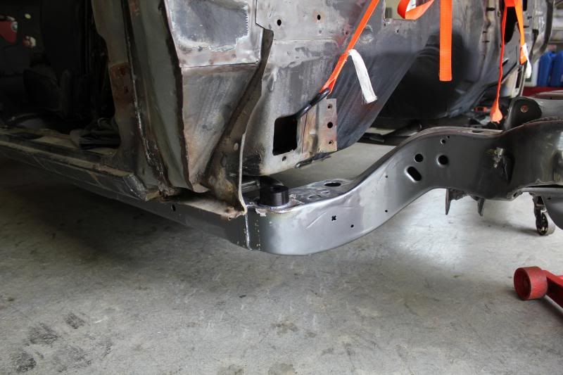

HEEP 06-09-2013 05:28 PM
well, not alot of progress this weekend. Worked on getting all the body mounts lined up and bolted down. Evidently, after sitting for all those years and all the welding I did on the frame, things have moved a little. looks like I am going to have to grind out one or two of the holes to get this thing bolted up.

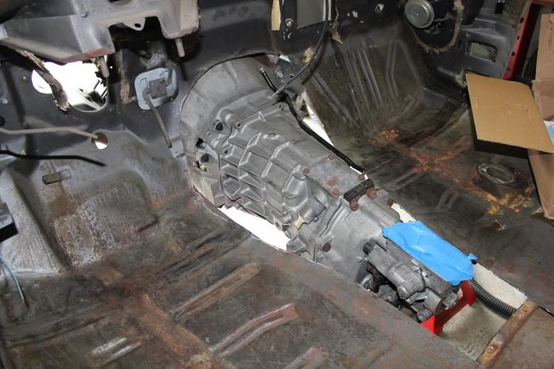

Wow, didnt realize how long it has been since I updated. Well, I finally got the guts to cut the tunnel out. Getting ready to set the engine in the frame. I ended up with Camaro mounts for the engine. I'll see how it works out. So my son an I went out tonight and got to work.
http://i115.photobucket.com/albums/n...ps0226a6b8.jpg
From the front
http://i115.photobucket.com/albums/n...psd4a87521.jpg
Got the trans mounted to the engine with the help of little man.
http://i115.photobucket.com/albums/n...ps4d9d8be6.jpg
Pulled the shifter and will get to setting it in tomorrow. I hope.
http://i115.photobucket.com/albums/n...ps2a6ab9b9.jpg

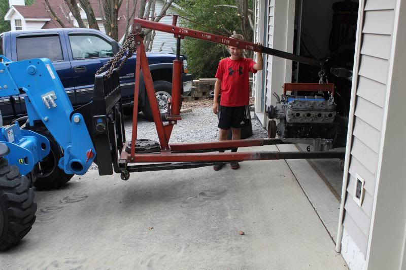

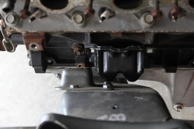

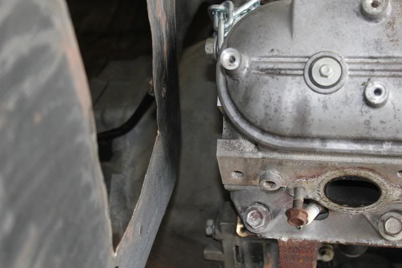

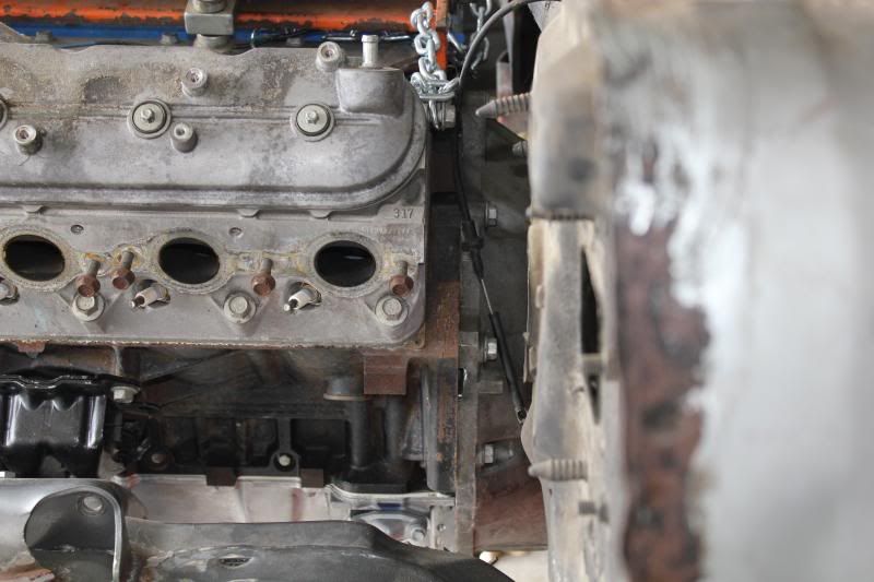

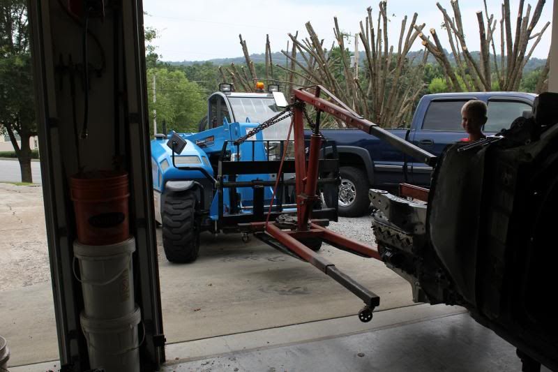

HEEP 08-04-2013 05:28 AM

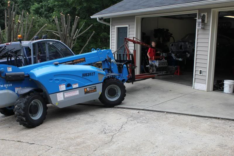

Well, like I said, I got the engine at least set in the frame. Had a rather unique tool that I used, as the frame was set a little closer to the door than I had planned.
Anyway, I had rented this for another project here at the house, and thought I would seize this time to use it.
http://i115.photobucket.com/albums/n...ps5b4fa02d.jpg
http://i115.photobucket.com/albums/n...psb6914e30.jpg
http://i115.photobucket.com/albums/n...ps257a6afc.jpg
So this is the outcome of the event. Rather painless in setting it in. As you can see it is jut resting on the pan and the trans has the mount in. I am playing with the idea of using Camaro mounts so you can see them next to the stock Chevelle towers. I will need to see what I can do on this. I think engine setback is good, let me know if I am wrong here guys. Let me know if there are any other pic that are needed to make that decision.

214Chevy 08-04-2013 05:51 AM
Heep, that is a rather unique tool. LOL!! If you set the engine back, are you gonna redo the firewall to accomodate the engine? Also, why won't you just get some LS adapter plates?

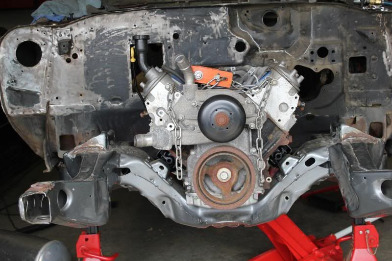

HEEP 08-18-2013 05:49 AM
Engine Placement
Alright guys, I need some advice. I have purchased the GM conversion pan from a member here and got the engine set in. Right now, I have a 3.7 degree angle front to rear on the engine so it will clear the steering linkages. Now, I'm also more forward of where I would like to place the engine as it is about three inches from the firewall. The one thing holding me back right now is the trans mount. I will need to see what I can do to make it move farther back.
I'm ok with using the normal Ls swap mounts or fabricating whatever I ned to make it work with the camaro mounts.
So what is the optimal angle for the engine to set in? Would I be better off to purchase the Mast pan to make sure everything clears properly? Do I need to set the engine back further than the three inches to the firewall?
Thanks,
HEEP

Ok heepster, mine is about 1/2" off the firewall. I made my own mounts, and my own tranny crossmember.

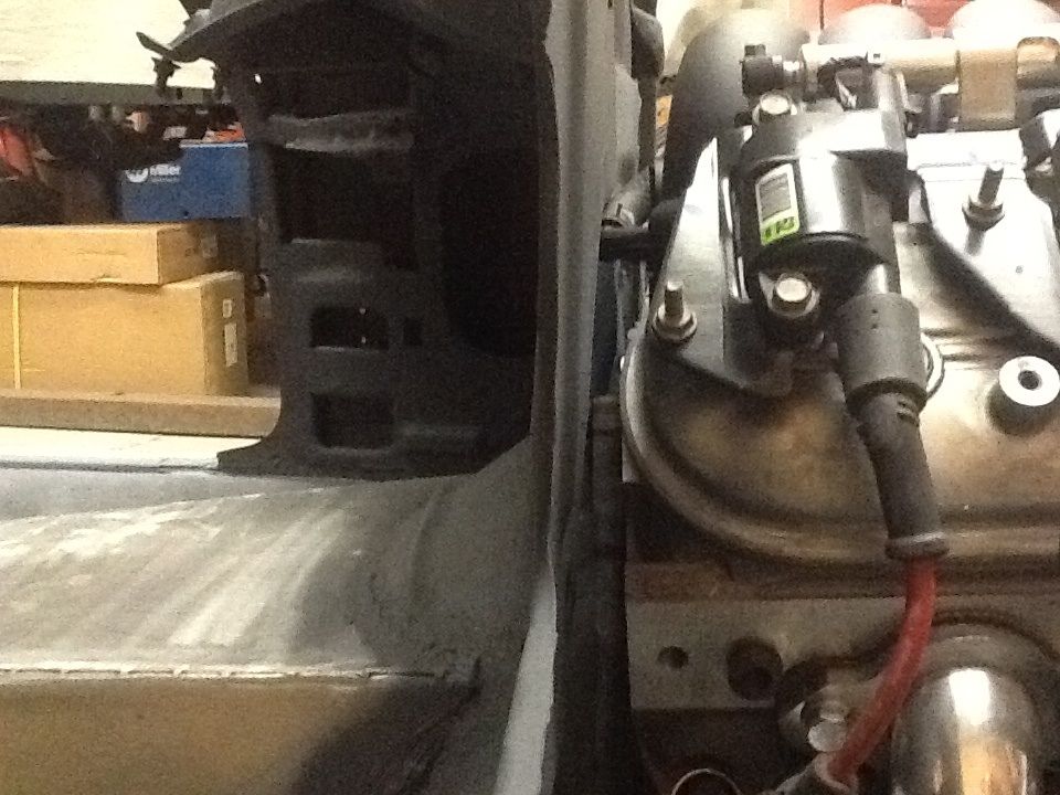

http://i1278.photobucket.com/albums/...ps2f75b6ba.jpg
Che70velle 08-18-2013 12:42 PM
Everything clears great. My vacuum hose for the brake booster just touches the firewall. I'm not so sure if I'm gonna keep it or not, as I might go manual brakes.
http://i1278.photobucket.com/albums/...ps5bcedf8f.jpg

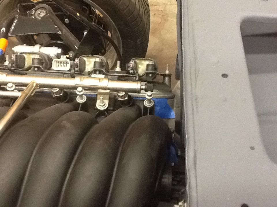

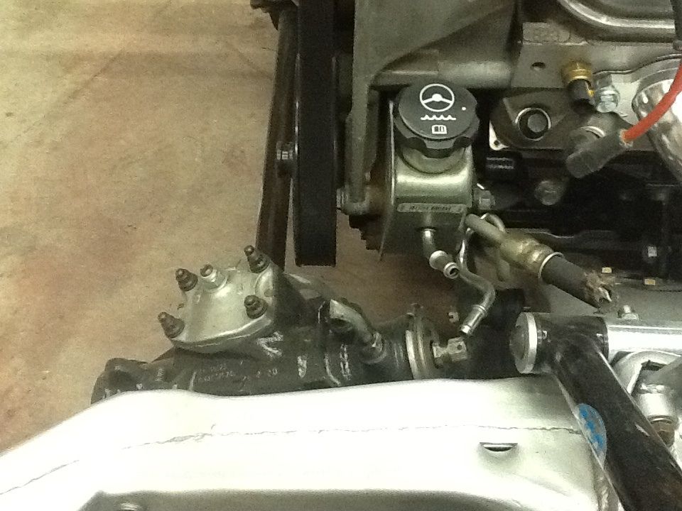

Che70velle 08-18-2013 12:52 PM
Here's a pic of the steering box clearance. I basically set mine back as far as possible during mockup. Of course I had my headers installed, and I put the steering box on, to make sure all my stuff was covered. Having your oil pan on will be mandatory to ensure your golden on fitment. I'm using the Holley pan. It's about 1/4" off the top of the crossmember, and I also have a ton of clearance on the sump of the pan to the crossmember. I researched this a lot. Some people reported that they had to raise the engine, in order to get tie rod to pan clearance. My engine is as low in the car, and as far back in the car as possible with a stock firewall, and I have no problems anywhere.
Now I have to go update my build thread with new pics. I finally got my body on my chassis!
http://i1278.photobucket.com/albums/...ps1851cc44.jpg
