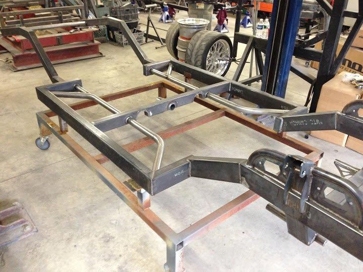

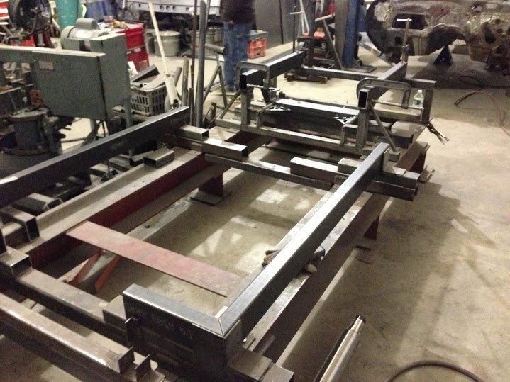

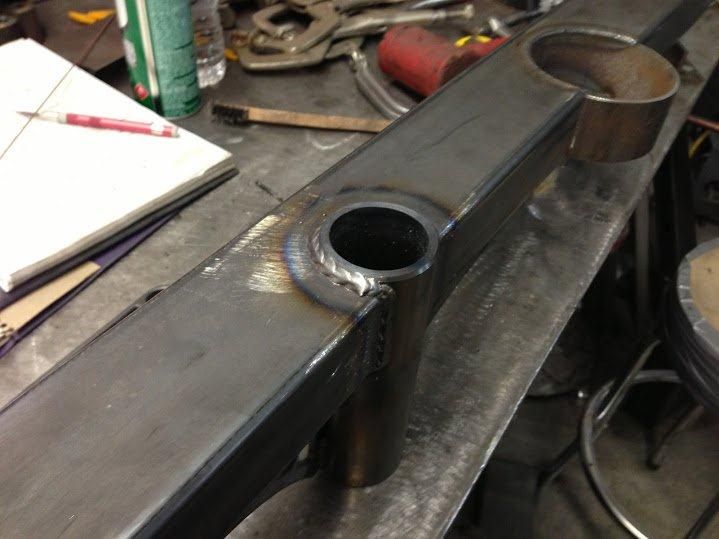

Frame shots
http://i1138.photobucket.com/albums/...ps52feb71e.jpg
Ron in SoCal 04-05-2013 08:49 AM

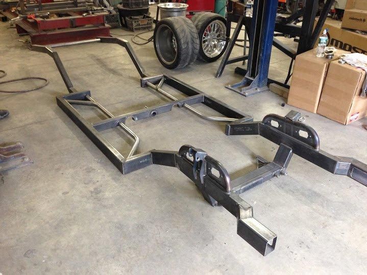

Payton King 04-05-2013 09:27 AM

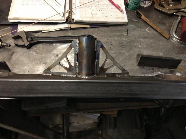

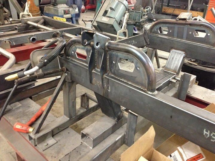

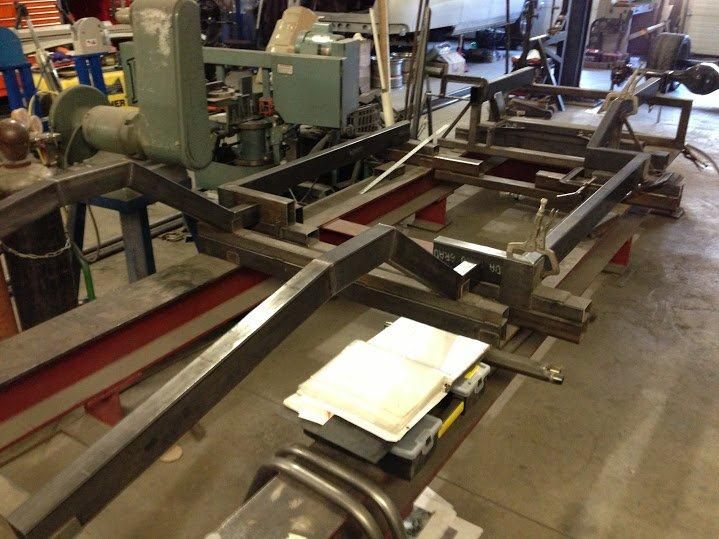

more
http://i1138.photobucket.com/albums/...ps8657aa9c.jpg
http://i1138.photobucket.com/albums/...psc496eb4f.jpg
http://i1138.photobucket.com/albums/...ps3a0d9330.jpg
http://i1138.photobucket.com/albums/...psb9425805.jpg

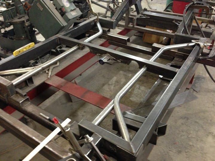

Payton King 04-05-2013 09:30 AM

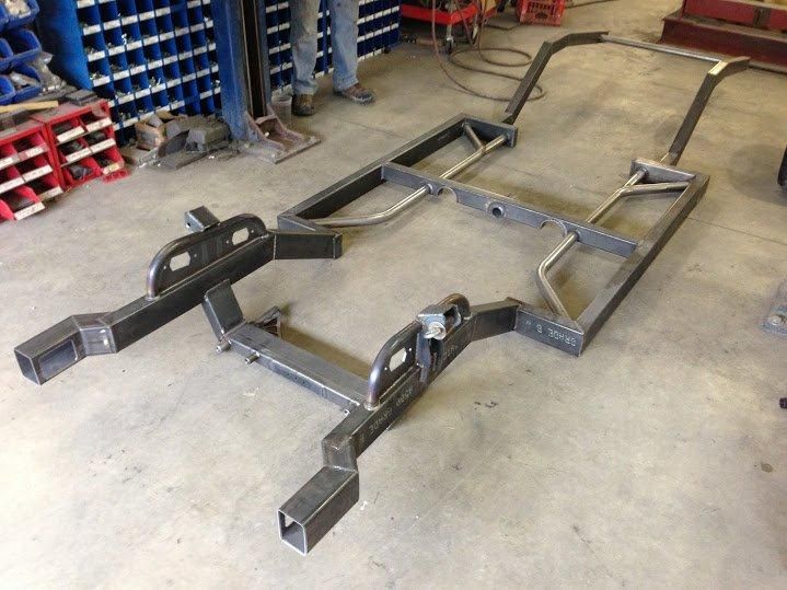

more
http://i1138.photobucket.com/albums/...ps3579192e.jpg
http://i1138.photobucket.com/albums/...ps16b64505.jpg
http://i1138.photobucket.com/albums/...ps69ef5705.jpg
http://i1138.photobucket.com/albums/...ps455b4950.jpg
http://i1138.photobucket.com/albums/...psb0e60ffc.jpg

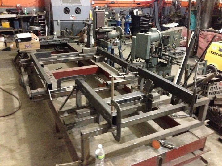

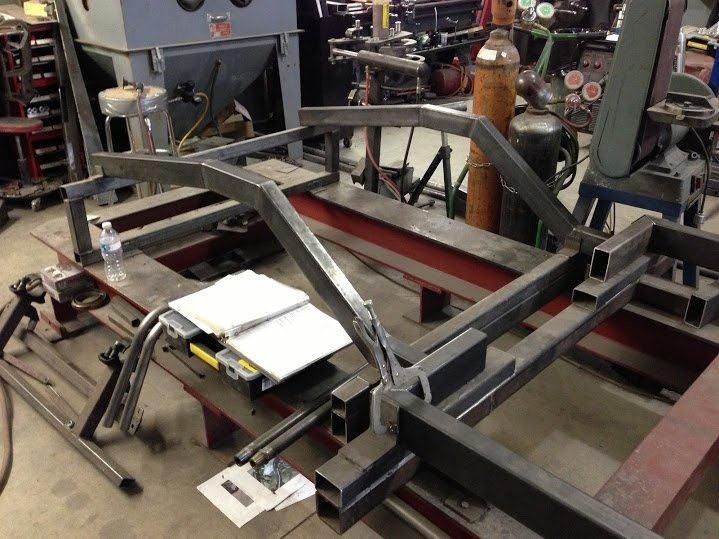

Payton King 04-05-2013 09:32 AM
http://i1138.photobucket.com/albums/...psefb7fe31.jpg
http://i1138.photobucket.com/albums/...psde92a76d.jpg
http://i1138.photobucket.com/albums/...psd6e87d2f.jpg
http://i1138.photobucket.com/albums/...psb31df0cc.jpg

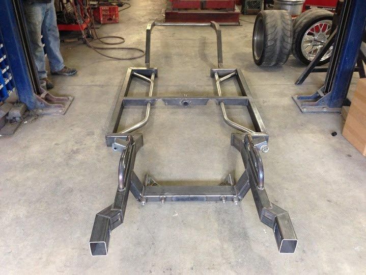

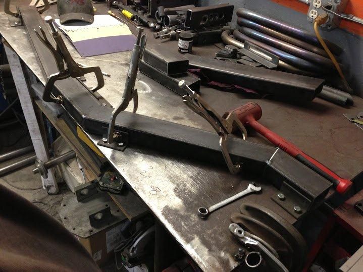

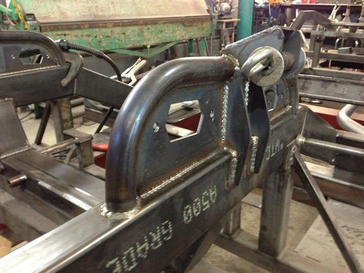

Payton King 04-05-2013 09:34 AM
contol arms 1 inch longer than stock C6
http://i1138.photobucket.com/albums/...ps33d59e54.jpg
http://i1138.photobucket.com/albums/...ps8ff060fb.jpg

57hemicuda 04-08-2013 05:40 PM
I can tell just by looking at the tubing its 2x4 tubing, looks like Jake snuck a piece of 3x4 in there where the core support bolts on,and 2x3 for the trans crossmember. Don't know for sure, but looks like 1 3/4" round tubing on the center there. I'm running the same front clip on the AMX I'm building.
I really like the minimal nature of Jake's frame, keeps the weight down knowing that there will be alot of cage work holding it all together. Loving this build so far.
Payton King 04-09-2013 06:14 AM
Ron is correct
The 2x3 for the torque arm crossmember was done like that so when I run 3 inch exhaust it will not hang below the frame...Jake's idea
