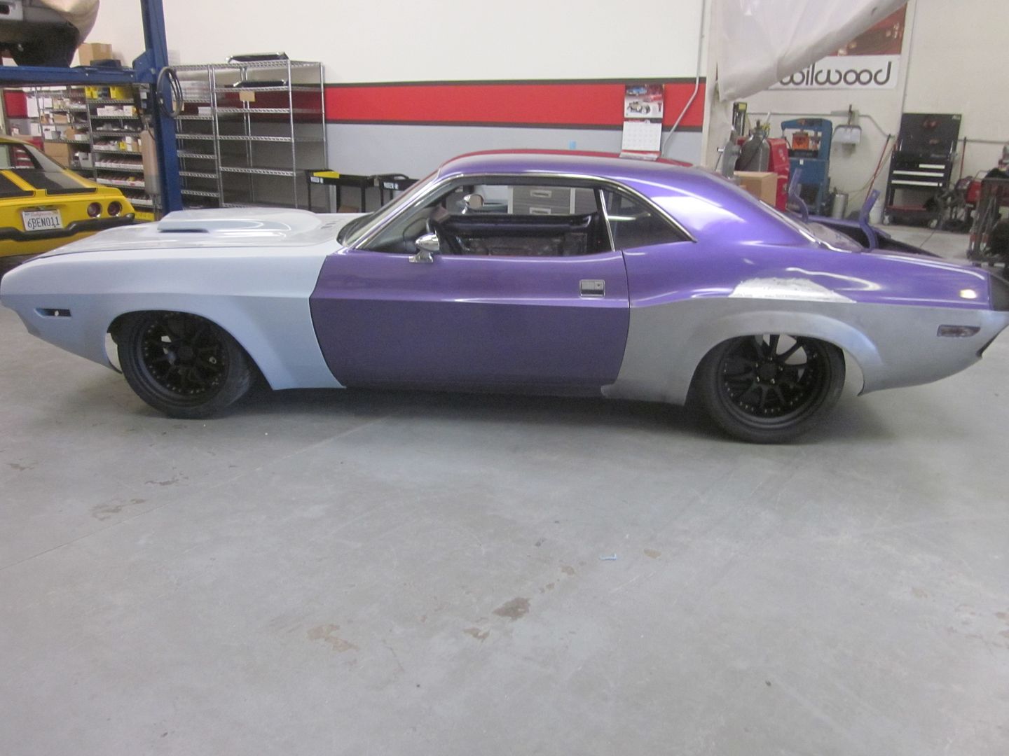

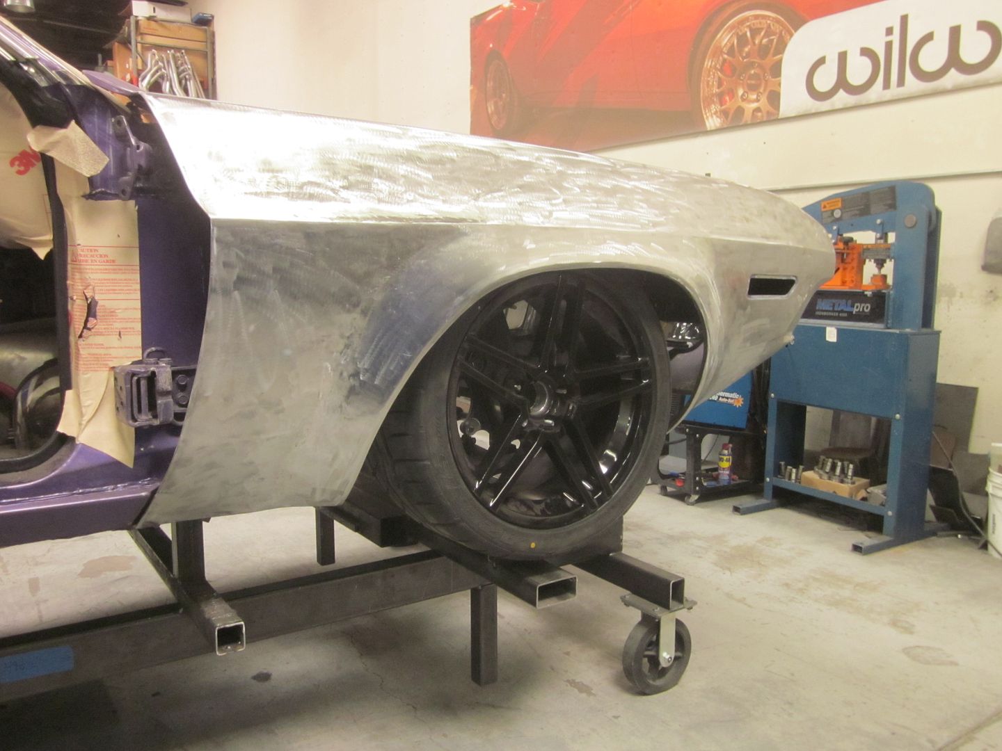

Weld them in place & clean them up a bit.. & they look like a mini-flare!
http://i1015.photobucket.com/albums/...ps4b658897.jpg
http://i1015.photobucket.com/albums/...ps1bc4f16d.jpg

Payton King 05-23-2013 06:36 AM
I like it!
was a little nervous on the first pic, but you nailed the final product...not that I did not have faith.
73CPCAMARO 05-23-2013 10:46 AM
Very nice :thumbsup:
Cris@JCG 05-23-2013 06:58 PM
It looks better in person.. I was a bit worried too when we started this part of the project!

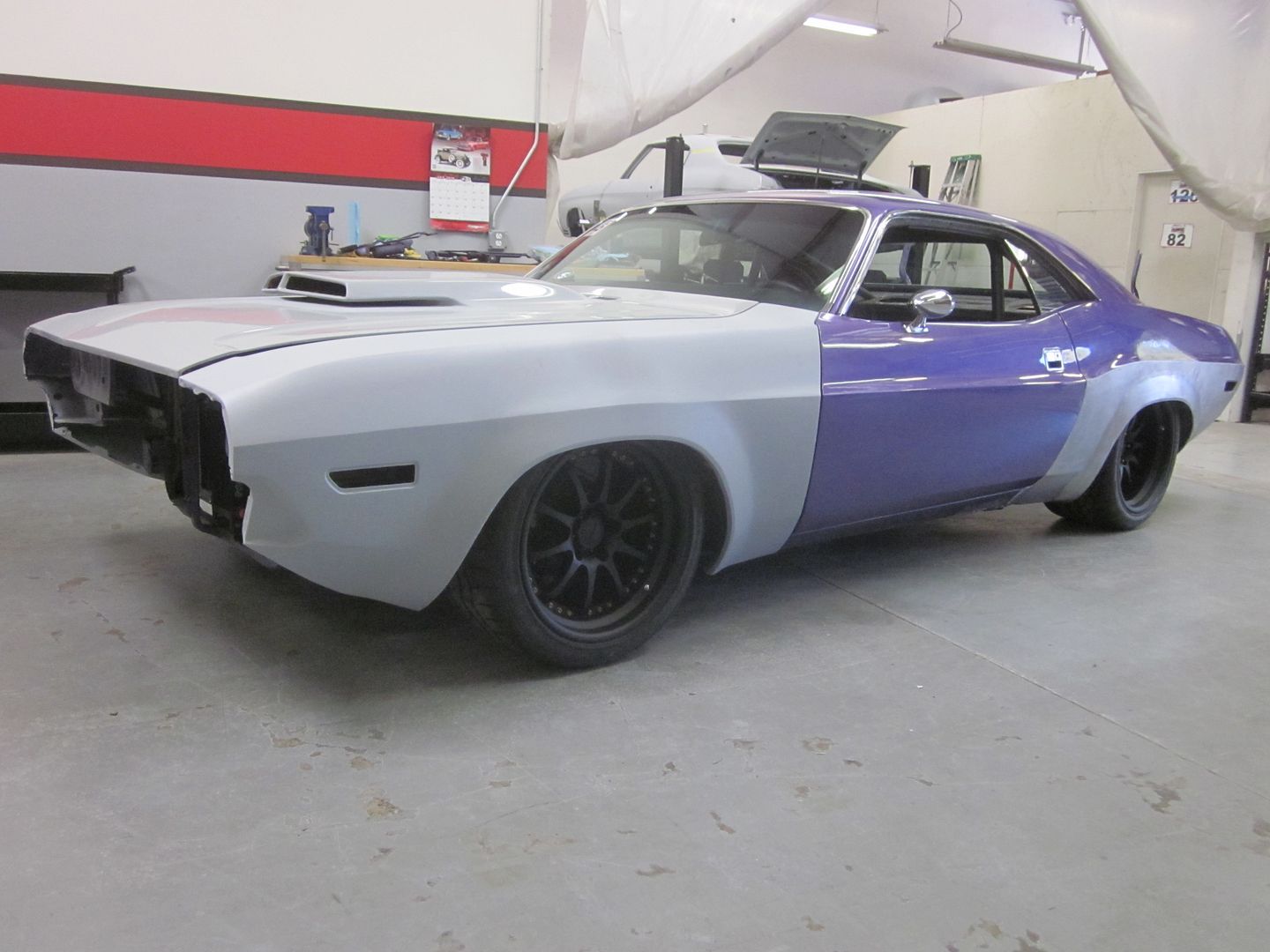

Cris@JCG 06-17-2013 07:21 PM

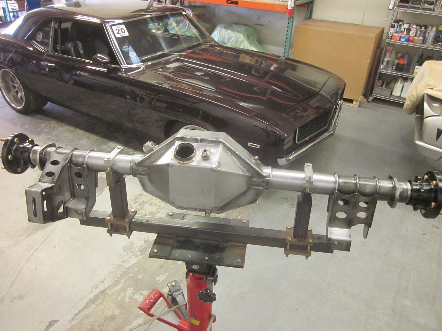

Got a bit of progress today.. We slowed down a bit because we were waiting for the rear-end from Speedway Engineering to complete the floating axle ends.. Tomorrow we start the rear qtr panel flares.. got 50% of the mini-tubs done.. Got the radiator with fan in place.. Setrab coolers done! Got a bunch fiberglass pcs coming in from AAR..
http://i1015.photobucket.com/albums/...ps5e69a0ec.jpg
http://i1015.photobucket.com/albums/...ps51b77e3d.jpg

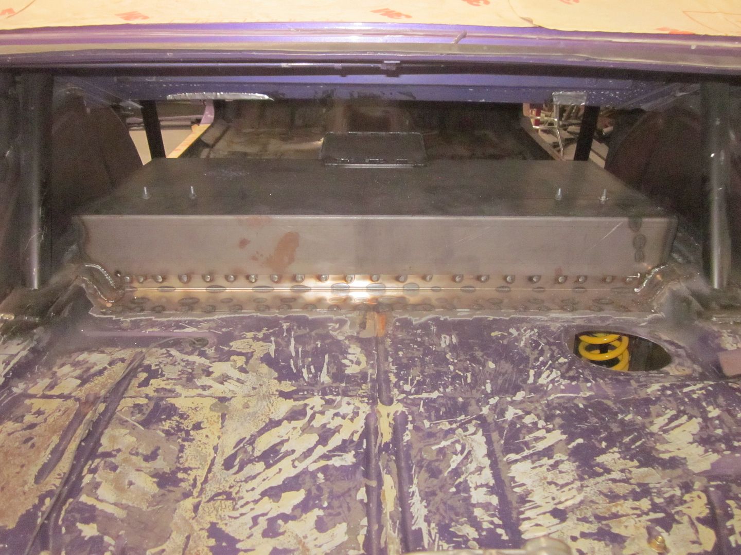

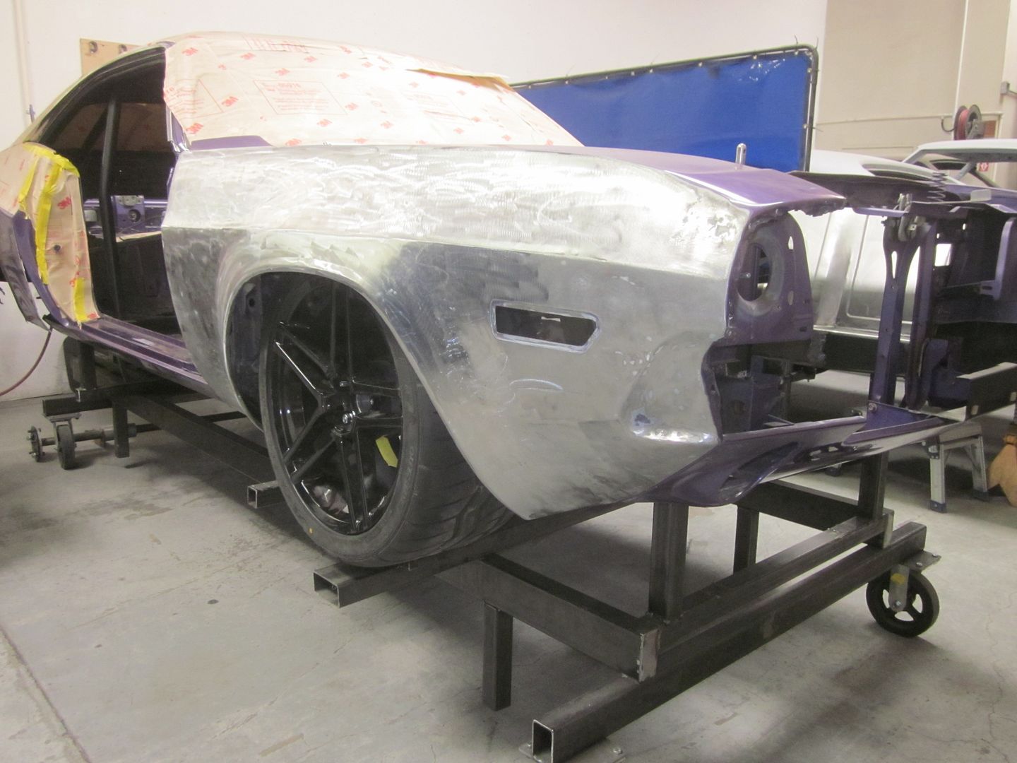

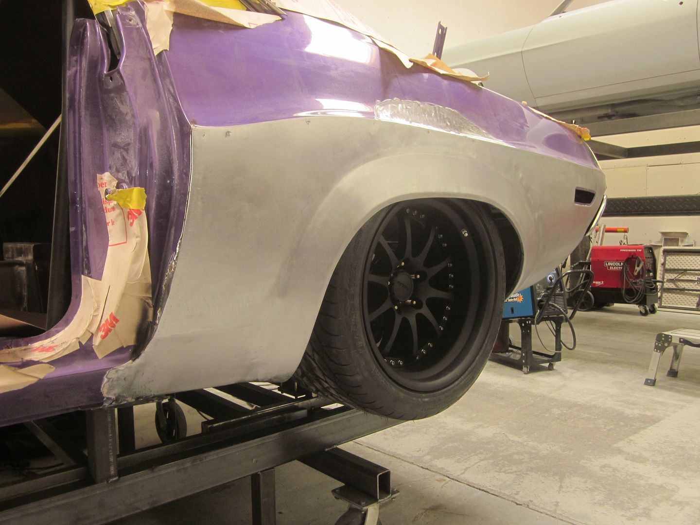

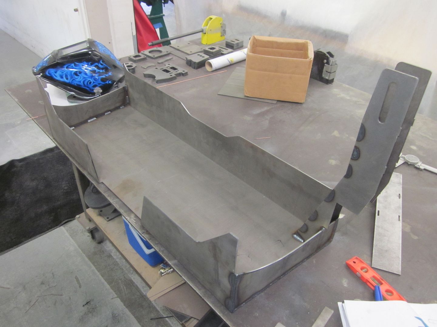

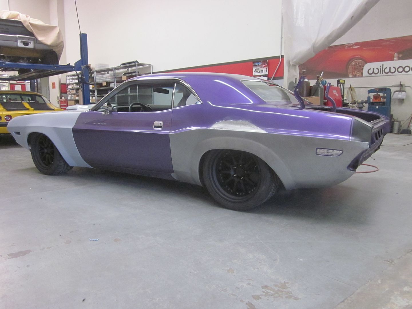

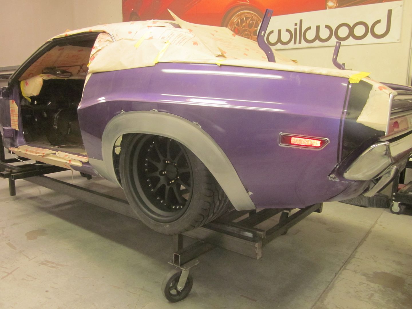

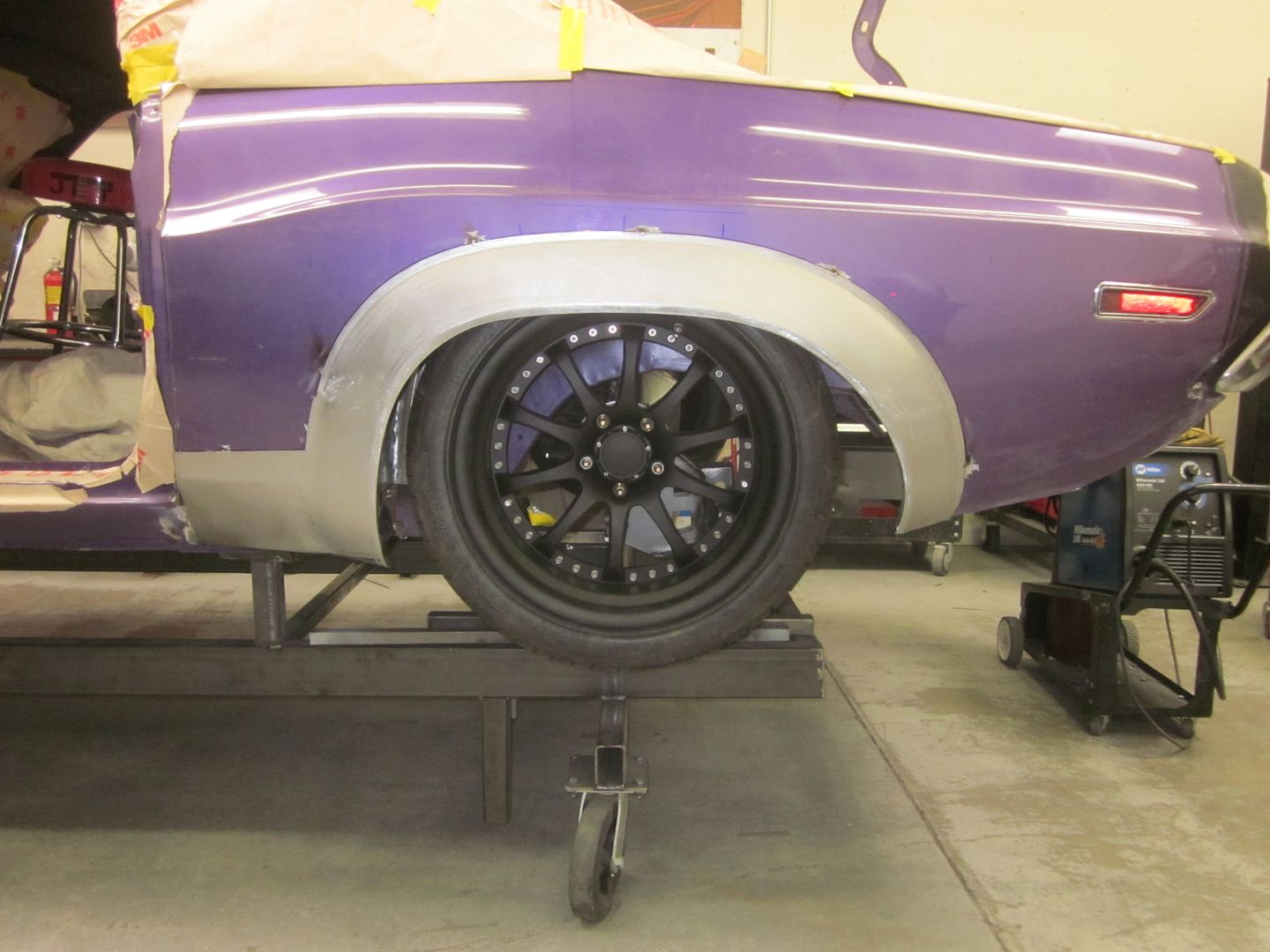

Got some rear stretch & flares going on today in the fabrication shop… We lowered the top of the opening to give the car a lowered effect to maintain ground clearance & suspension travel.. But we also pulled the lower bottom of the qtr so that we keep from kicking up rocks to cover the tire but also works as a deflector of air ..
http://i1015.photobucket.com/albums/...psc37f7584.jpg
http://i1015.photobucket.com/albums/...ps26c83466.jpg
http://i1015.photobucket.com/albums/...ps5b954d81.jpg

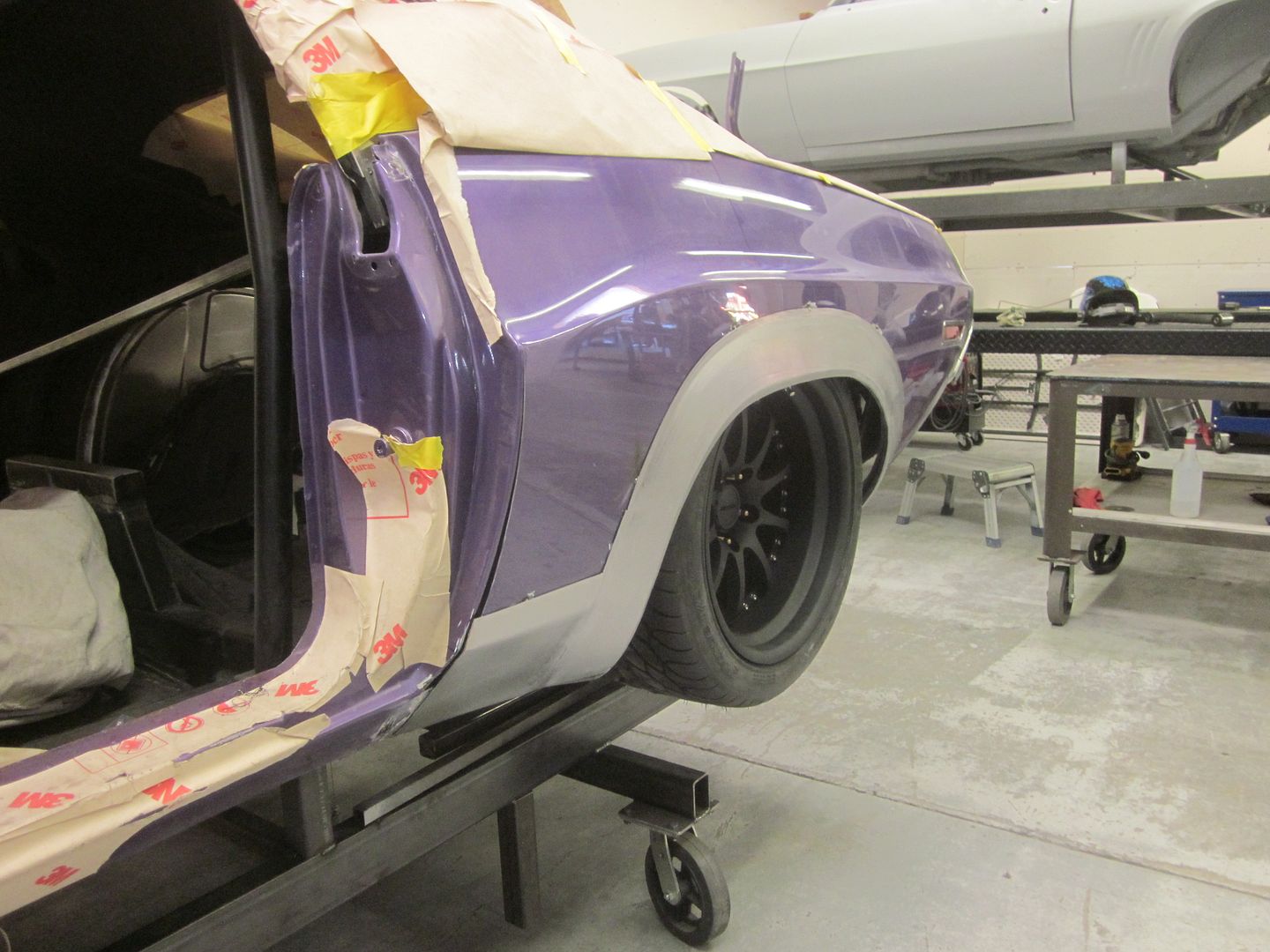

Cris@JCG 06-25-2013 12:03 PM

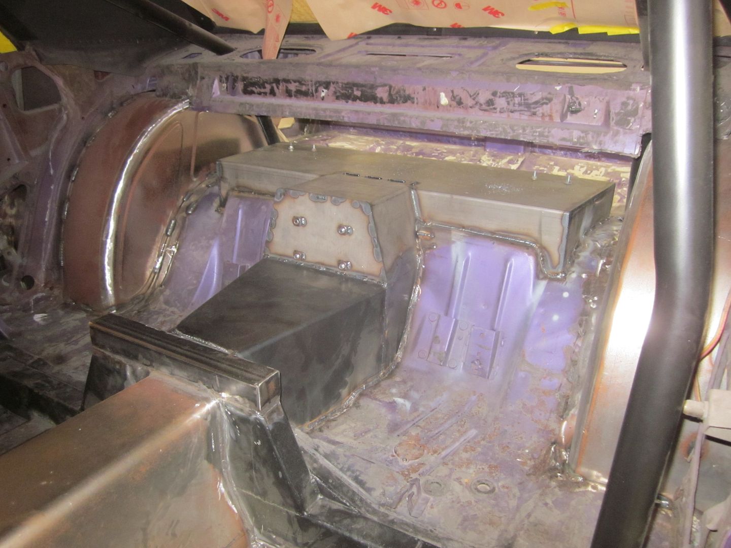

A few more progress pics..
Got all of the driver side qtr panel done with inner well complete yesterday! I am really looking forward to seeing this car on the ground...
http://i1015.photobucket.com/albums/...ps6b698236.jpg

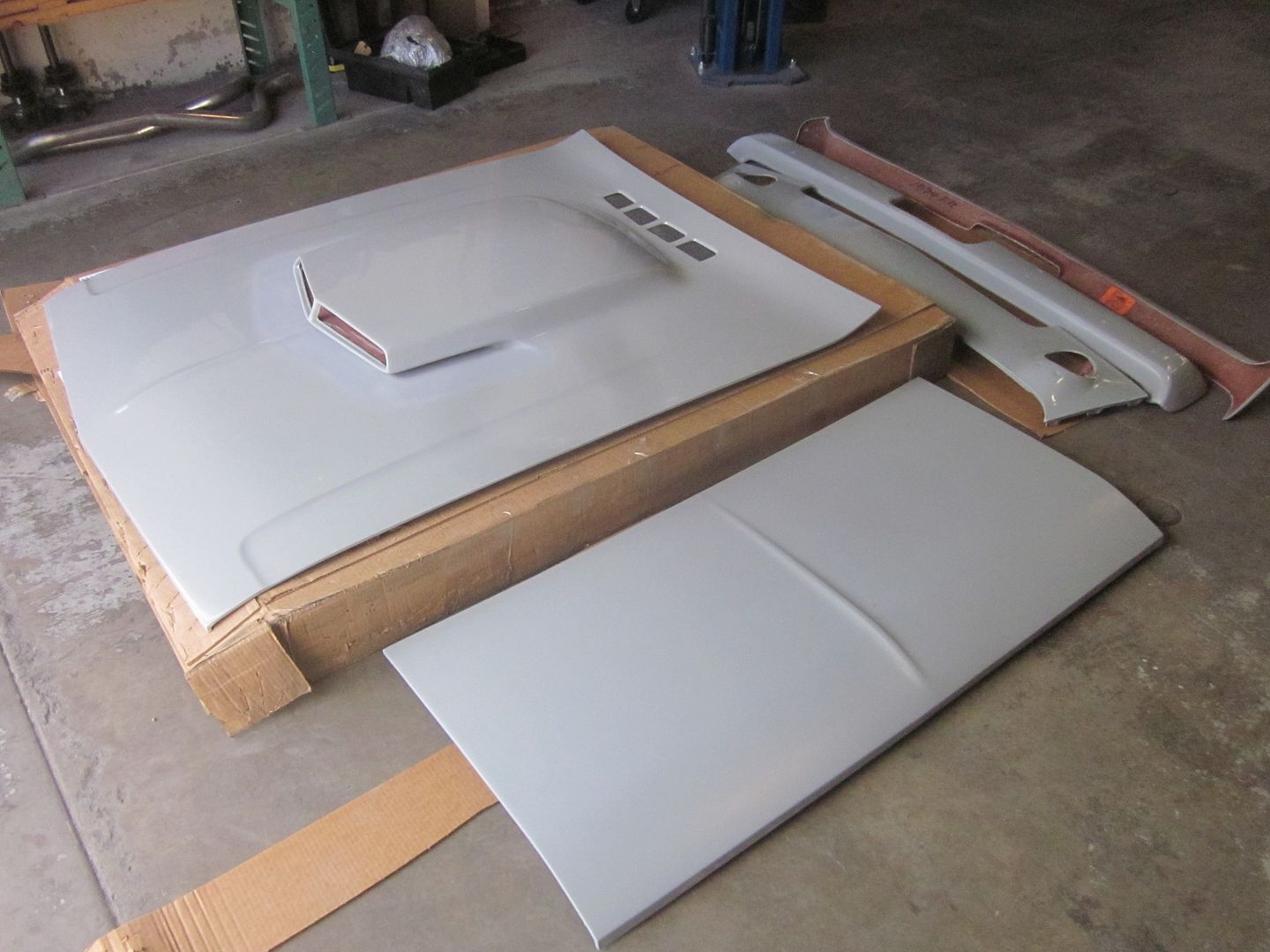

Just got all of our fiberglass pcs from AAR..
http://i1015.photobucket.com/albums/...psa686230f.jpg

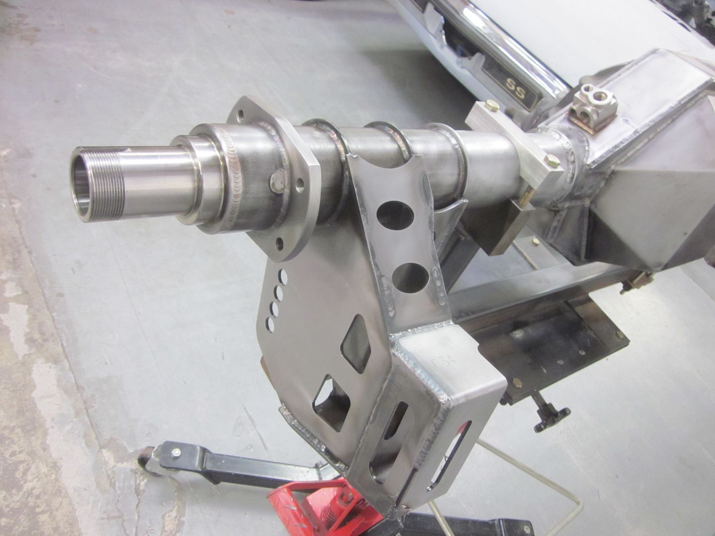

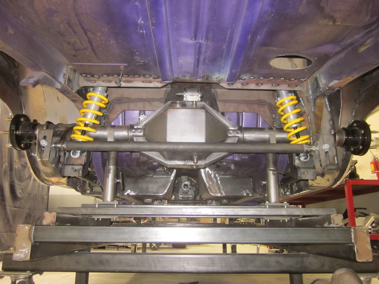

Cris@JCG 07-05-2013 02:10 PM

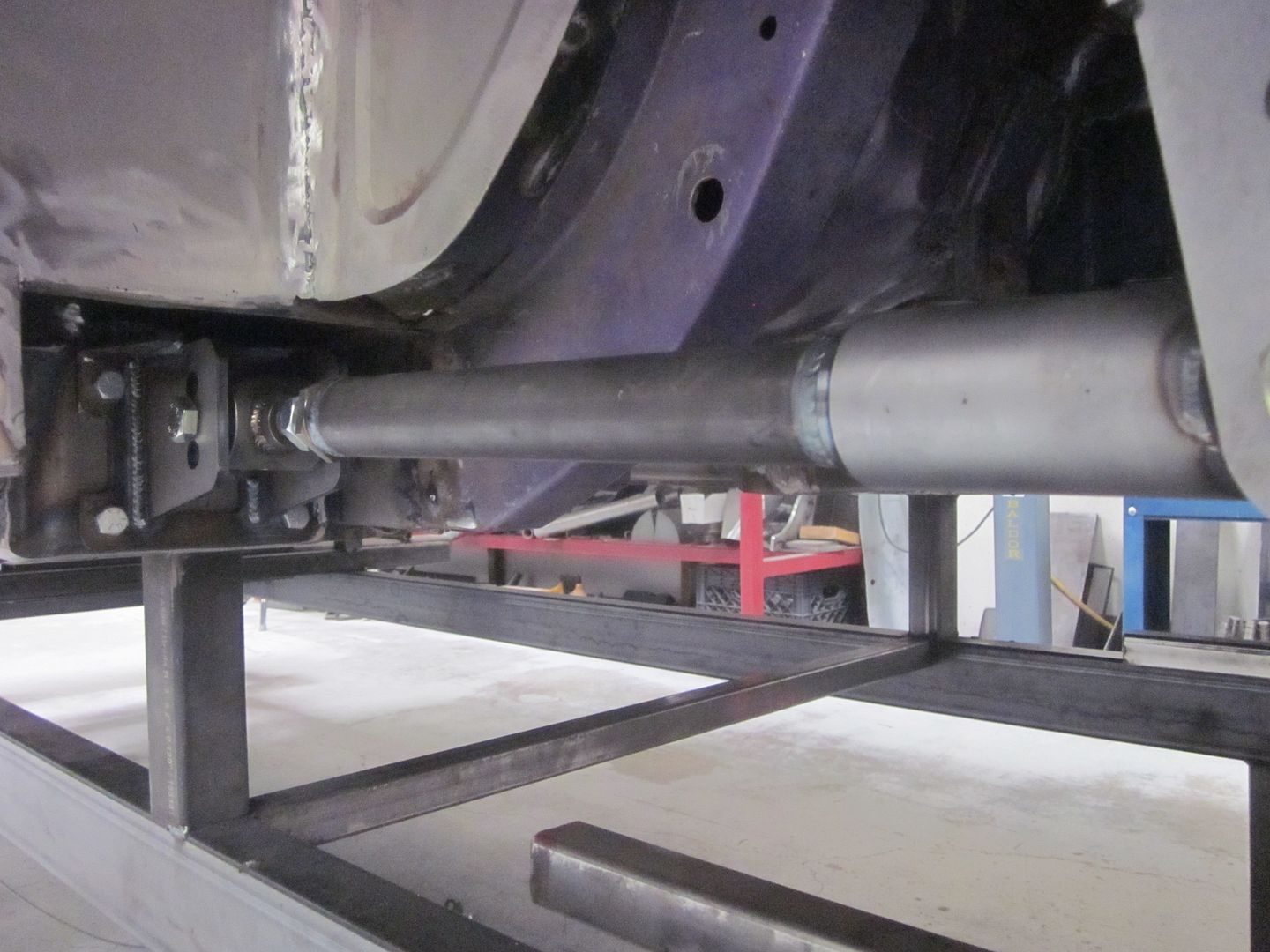

WE got some suspension in the Challenger this week… Next week we cut it off the jig..
http://i1015.photobucket.com/albums/...ps73825bdc.jpg
http://i1015.photobucket.com/albums/...psd10629d1.jpg
http://i1015.photobucket.com/albums/...ps5f0a65dd.jpg
http://i1015.photobucket.com/albums/...ps94c52561.jpg
http://i1015.photobucket.com/albums/...ps7b342a0a.jpg
http://i1015.photobucket.com/albums/...ps101221c6.jpg
http://i1015.photobucket.com/albums/...ps5a37544f.jpg
