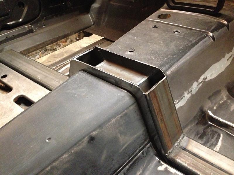

MX145 06-17-2013 09:48 PM
1 Attachment(s)
Cut the crossmember down on the hump section 5/8". Should look a little better when finished off with some 1/8 plate.
Attachment 40078

MX145 06-18-2013 11:00 PM
1 Attachment(s)
Crossmember finished.

frankv11 06-22-2013 07:53 AM
Originally Posted by MX145 (Post 487694)
Not so high above the transmission tunnel now.
Nice work on cross member. I think you mentioned you'll be running a t56 and if so , you may need to cut about 3/4" on the top front to clear shifter. It also depends on setback of you motor and height of body mounts . You are definitely taking care of business
KEEP IT UP
MX145 06-22-2013 09:04 AM
1 Attachment(s)
KEEP IT UP
Frankv11. What do you think about taking a notch out of the crossmember and filling in with angle iron? I'm running 1/2" solid body mounts and using the factory small block engine mounts for now. Here's a terrible sketch of what I'm thinking. Lol. I figure worse case when I get the t56 in there I will have to notch the entire top section of the xmember around the shifter area but this way would retain some more strength if it works out. Like you said. Its all about the height and set back. Sure would be a lot easier if I already had the transmission so I can measure it out.

MX145 06-23-2013 10:17 PM
1 Attachment(s)
Added the notch on the bottom side of the top center.
MX145 06-23-2013 10:20 PM
1 Attachment(s)
Filled in the inside open ends with some 1/8" plate. Should be ready for permanent installation.

MX145 06-23-2013 10:27 PM
Originally Posted by frankv11 (Post 488911)
At this pace you'll be done in no time. Cross member & frame connector look good
Thanks Frankv11. What do you think of the notch? Does it look like it will work? I'm going off of pictures and posted measurements as I don't have a T56 yet. I notched it 1".

MX145 06-23-2013 10:37 PM
1 Attachment(s)
Final crossmember install. I used blocking under the car to make sure the seat pans and crossmember were level before tacking

frankv11 06-24-2013 11:55 PM
I would say so but It's tough to call it. I liked the 2nd drawing just to play it safe. But what do I know I been working on my exhaust for close to a year now.

MX145 06-25-2013 08:29 PM
Nice welds on the frame connectors
I agree the second option is safer. However when I got to looking at it before I started cutting I didn't want to make a sharp 90 corner since it would be visible. I decided the notch would look better and be easier than trying to make a compound radius'd corner. I don't think I'll be lucky enough to come across a magnum I can afford so hopefully this fits the smaller T56.
