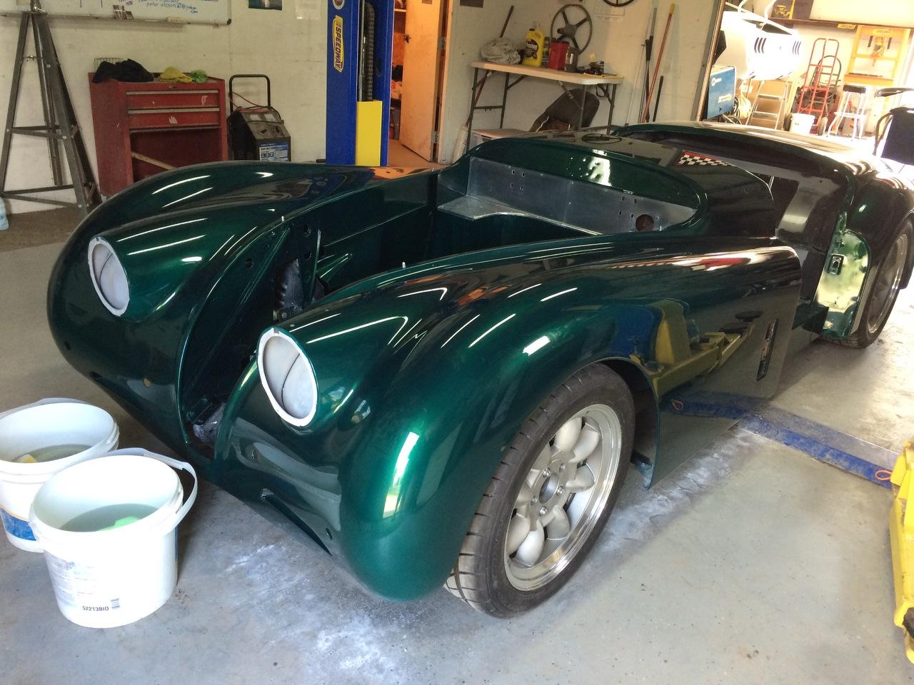

mfain 11-05-2014 08:36 AM
2 Attachment(s)
Update: The project is still alive - it just took a while to get it out of body shop jail.
Attachment 51202
Attachment 51203
Pappy
waynieZ 11-05-2014 08:42 AM
Attachment 51202
Attachment 51203
Pappy
That's the most common theme on most everyone's build! The motor looks sweet with the 8 stack induction.

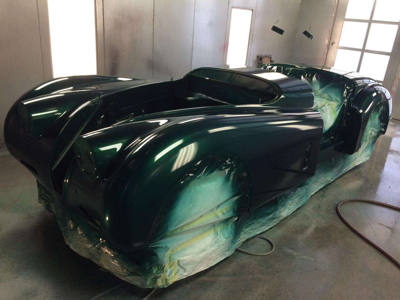

mfain 06-12-2015 01:12 PM
2 Attachment(s)
Let the color sanding begin. The LS motor should look great surrounded by a sea of green.

Attachment 54617
Attachment 54618

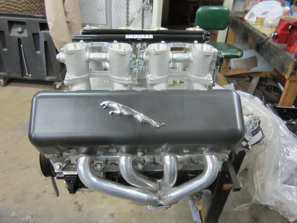

GregWeld 06-12-2015 09:10 PM
Make sure to have ALL the linkages disconnected when adjusting the 8 stack using the Manometer to set the flow up. That includes the CROSS link adjuster.
If you need help just let me know. I've done a zillion of 'em. It super simple if you have experience and know what you're doing.

The computer is a FAST EZ EFI. it all came in the package from Inglese. By the way, Greg (Weld), when setting up the airflow is there a difference between the old mechanical set-up and EFI on a computer?
Pappy
GregWeld 06-15-2015 09:31 PM
Pappy
Well --- the key is to have all the air valves sync'd up - using the manometer. But of course - you have to get the motor running.... via the handheld programmer of the EZ EFI.... which is pretty dang obvious when doing the set up windows... You just answer the questions - Engine cubes - injector size - Fuel pressure etc... it walks you thru the steps. Then --- when you fire up for the first time -- and the engine comes up to temp (over 140*) the computer will start to alter the fuel tables. Once you have a decent idle --- you'll want to go and measure each air valves flow with the manometer and adjust accordingly.
The thing that people do with an eight stack is to look at all the adjustment "screws" and start to fiddle with them setting idle RPMS or whatever.... and not realize that the entire system (all 8) are then being messed with!
If you don't disconnect the cross linkage - whatever you adjust on one side is messing with the other side.
The beauty of the Inglese set up is that each butterfly in each air valve is easy to adjust on the butterfly linkage (very small set screw and collar on the shaft) - if the pair is out of sync (two valves per pair).
You've got to get all of them flowing within 1 of each other.... then when you hook up the cross linkage -- double check them all and if anything - it's usually one side is now higher or lower than the other side. This can then be adjusted by turning the cross link shaft whichever way it needs to go....
Now you're ready to go for a drive -- and the key there is to try to hold a "load" /"RPM" and let the computer settle on the A:F at that spot - then increase the load/rpm to another place and let it settle in there -- and so on. It takes the computer a minute to settle in using the O2 sensor. Once you get some 'gross' adjustments in - it just gets smoother and smoother... as you drive. It's a pretty slick little setup. But you have to have the MECHANICAL part sorted out - and then the computer can do it's thing.

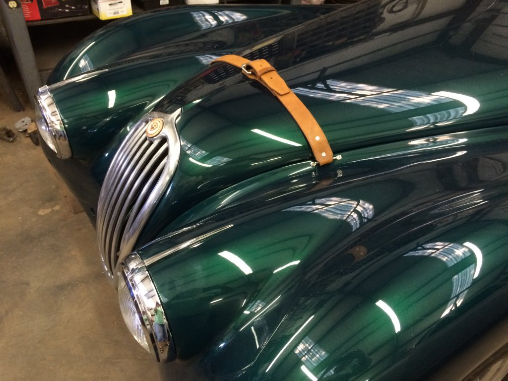

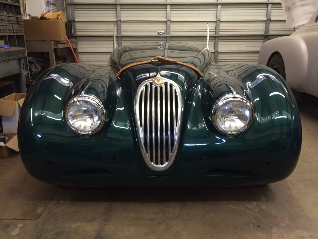

mfain 07-19-2015 06:54 PM
Update
2 Attachment(s)
Well the vintage look certainly belies what is underneath!
Attachment 55069
Attachment 55070
Pappy
WSSix 07-19-2015 07:06 PM
Great touch! Is it functional or are you hiding a true hood latch under the hood?
mfain 07-19-2015 07:24 PM
Nope - totally functional.
Pappy
waynieZ 07-19-2015 08:40 PM
Sweet! I can't say it enough I love this build!
