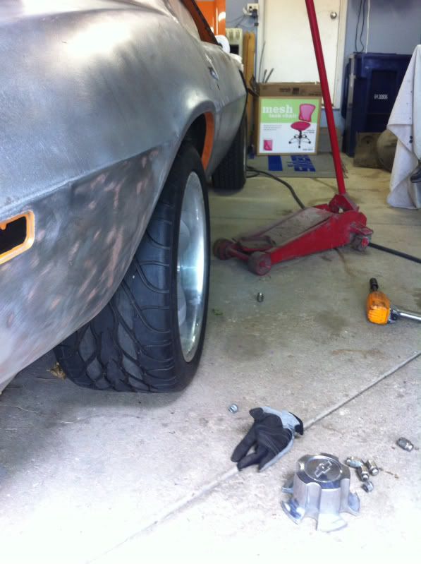

car is coming very nicely,you will be satisfied with Brians vent,put one in mine with fuel tank and rear axle and works great
OLDFLM 10-31-2013 05:55 AM
Originally Posted by carbuff (Post 513751)
From past experience, it's pretty tough to get a 315 to fit without cutting a wheel well lip and pounding in the seat buckle bump if you have one. Even then, it's still tight, but the panhard will help. We'll stick one up and see what it looks like to you. :) Maybe next weekend if you can wait that long?
Our 'birds have more room than Camaros fwiw...
Rick D 10-31-2013 05:59 AM

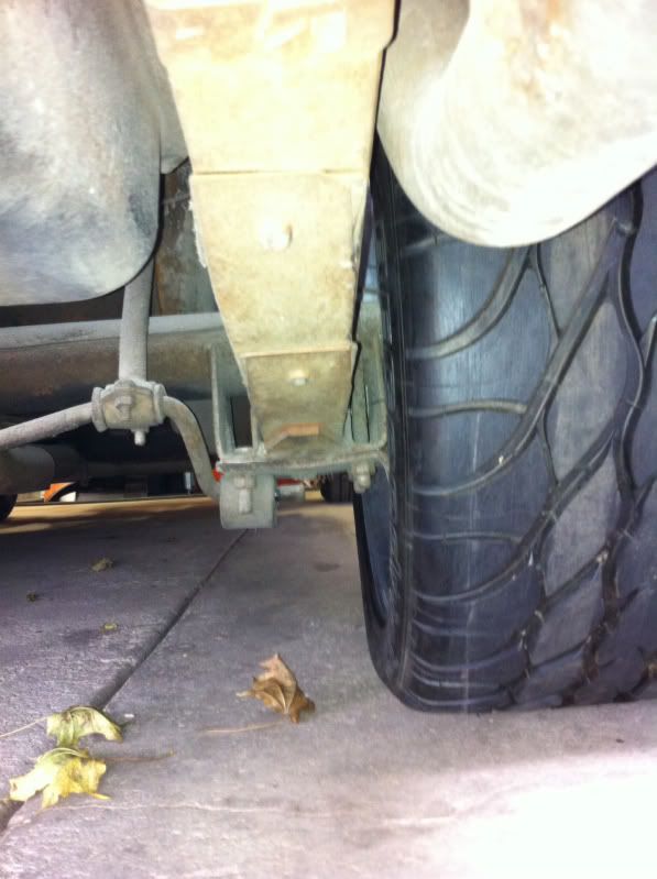

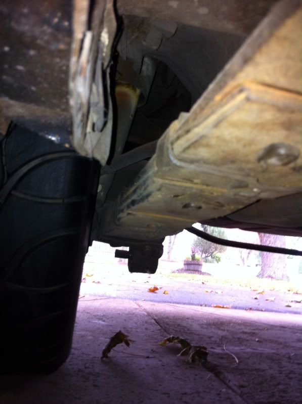

You can fit a 295 in the rear with out mini tubs, I have them on mine and still have the leafs in the car. If you roll the lips you have some room.
Rick D 10-31-2013 06:02 AM
Here's a few pictures
http://i79.photobucket.com/albums/j1...psff546c2f.jpg
http://i79.photobucket.com/albums/j1...ps8ad07ea8.jpg
http://i79.photobucket.com/albums/j1...pscba35439.jpg
http://i79.photobucket.com/albums/j1...psf1ee9bff.jpg

gerno 10-31-2013 11:48 AM
The 295's fit in there nicely but of course I need to push my limits and get as big as I can. My wheel wells are already rolled and the leafs are now gone so I have some more space. It still looks like I'll be ordering some tubs.
If I get the GTO for a good pricing I could change out the accessory drive as needed to make it fit. I need to decide by Friday night if I'll be going down that path since I assume the car won't last too long. It's would only be worth it if I could get the engine other parts for basically a net cost of 0.

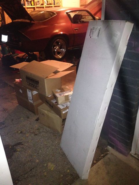

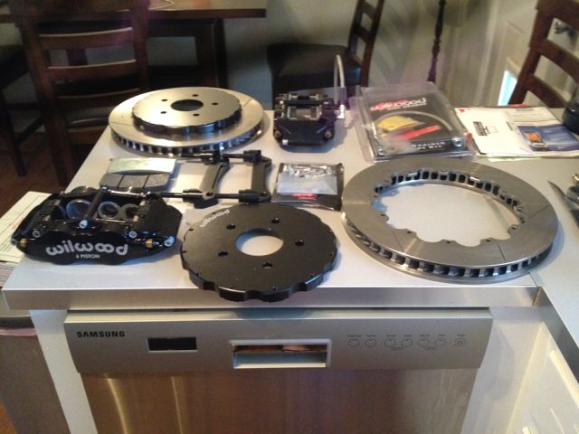

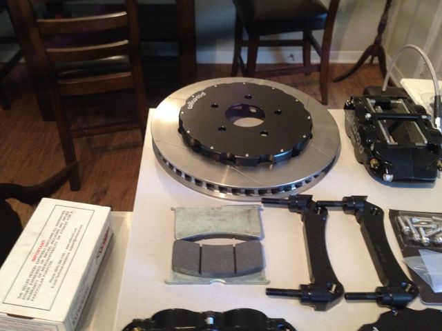

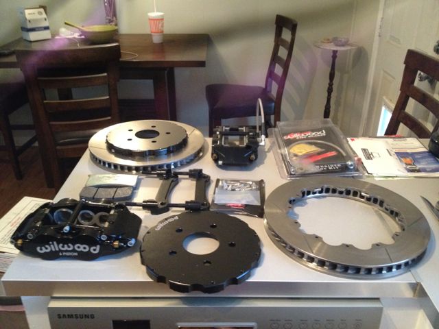

gerno 11-02-2013 10:44 AM
5 Attachment(s)

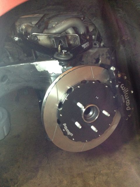

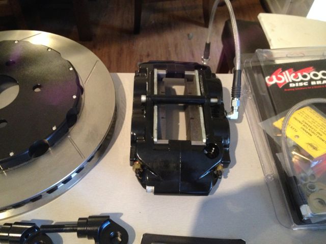

New front brakes are in. Unfortunately the Speedtech front end parts won't be here until Monday from installation but these are still nice to look at.

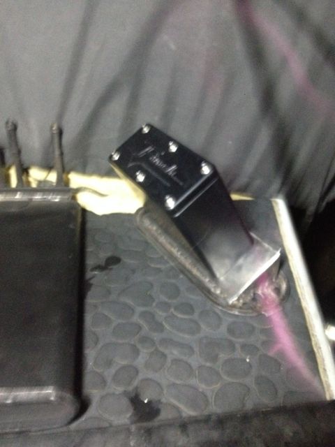

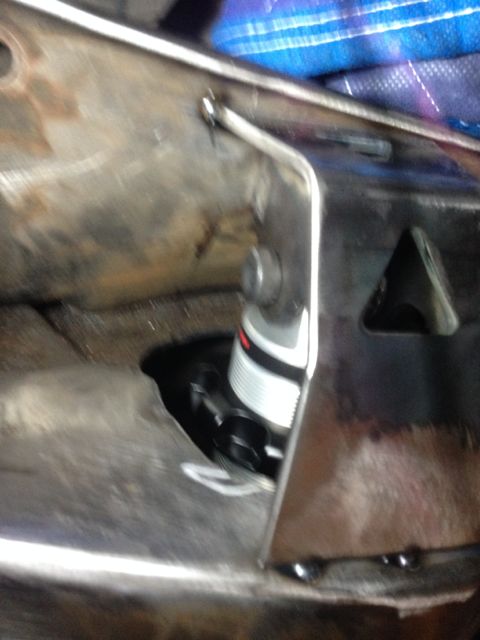

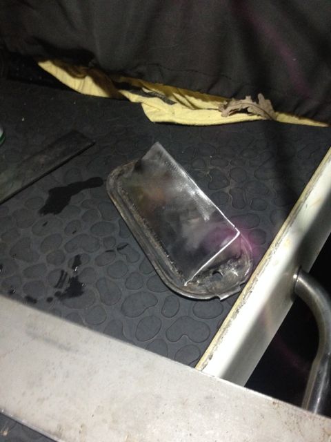

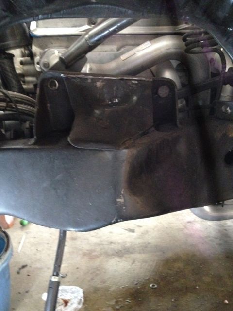

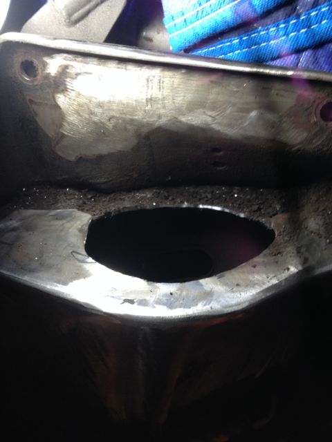

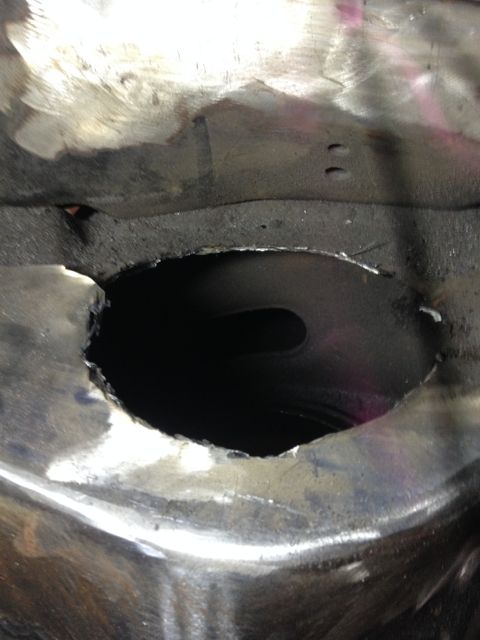

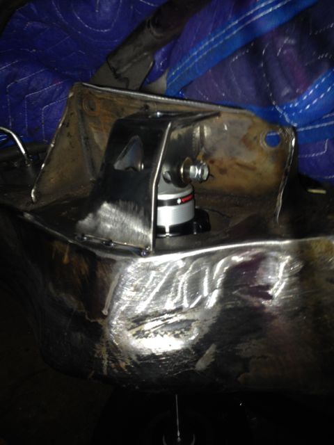

gerno 11-04-2013 01:56 PM
10 Attachment(s)

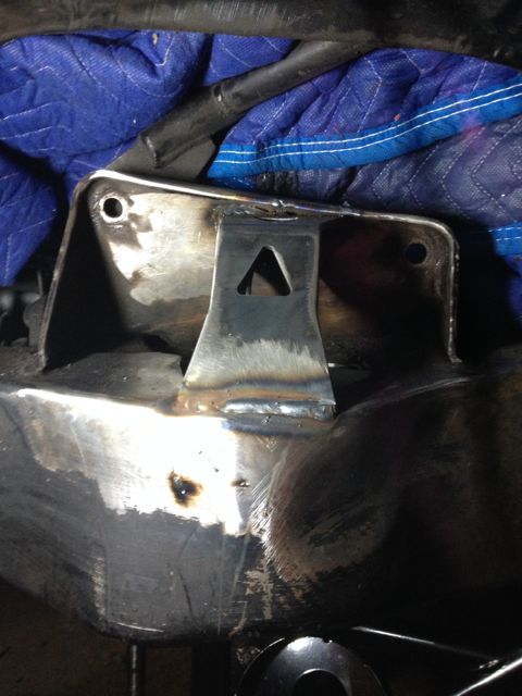

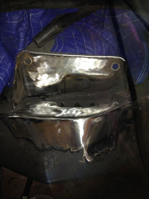

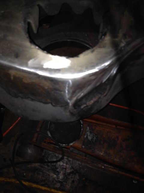

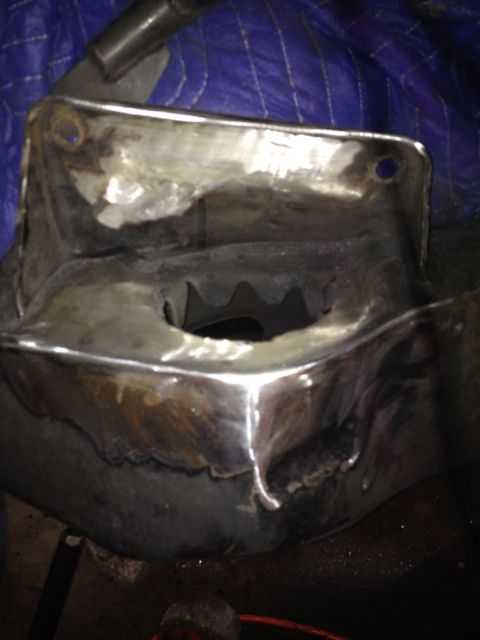

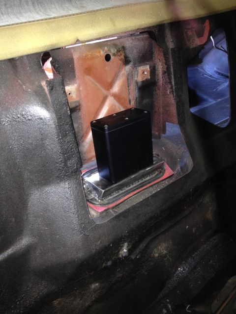

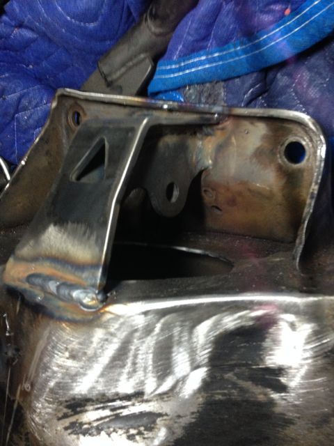

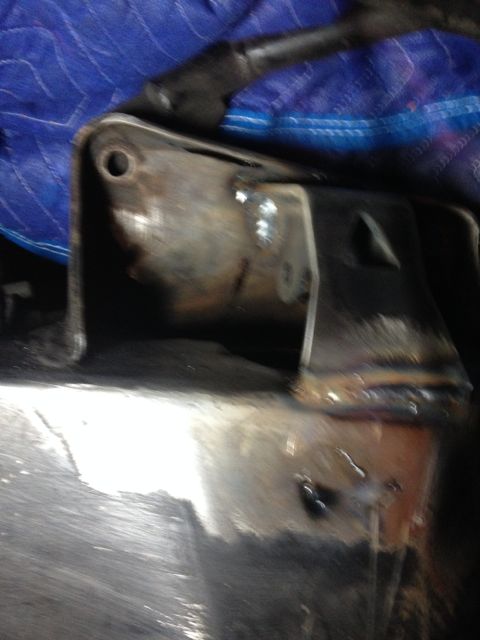

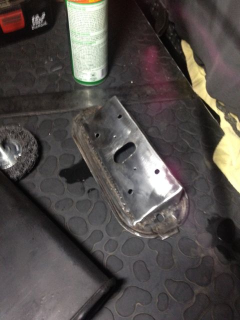

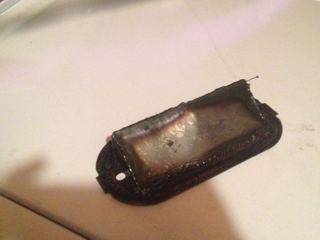

Did a little more work this weekend. I built a bracket to mount the new fuel/axle vent in the location of the factory vent (or whatever it is). I also started to modify the front subframe for the coil overs. Hopefully the new front end parts will be in today from Speedtech so I can test fit everything soon.

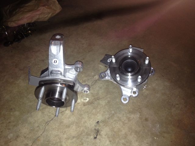

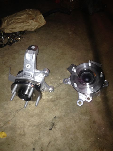

gerno 11-04-2013 07:51 PM
4 Attachment(s)

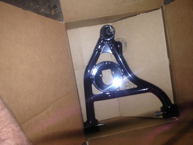

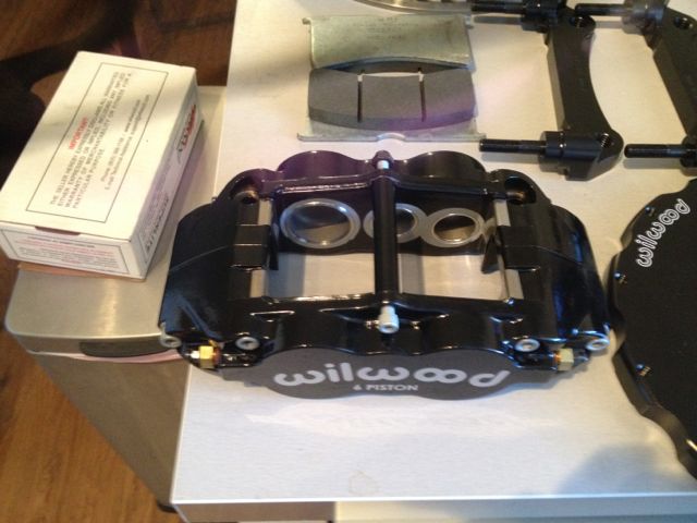

Some new parts are in....
I have to say the quality of all the parts is top notch but the spindles especially are impressive to me.
Attachment 42927
Attachment 42928
Attachment 42929
Attachment 42930

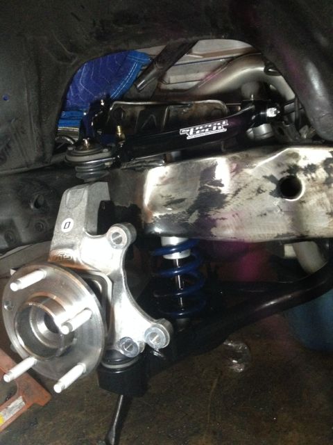

gerno 11-07-2013 08:03 PM
10 Attachment(s)

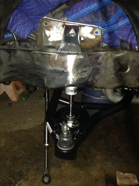

Made some good progress today with the front. The driver side front is mocked up and the Chicane mount is welded in. Everything was actually very easy to put in. I was nervous using the angle grinder to cut out the spring pocket but I found it was actually very easy when I did it from the bottom up.
One issue I ran in to is the bolts for the Caliper mounts are not exactly right. I thought they were 1/2" bolts and the threaded in just fine. Unfortunely looking at the thread after mocking them up it seems the 1/2" bolt is a little off. I'm going to head over to the GM dealer tomorrow and see if I can buy a few from them. The 1/2" bolts were also very lose in the spindle so hopefully the GM bolt fixes that too

In case anyone else is looking for the caliper mount bolt size, the Chevy factory C5 caliper mount bolts are M14x2x47. The Chevy dealer didn't have them in stock but Fastenal had some M14x2x50 grade 8 cap screws (actually the metric equivalent whatever that is). The 50mm bolt with a flat and lock washer is a perfect length and they not actually fit the bore in the spindles.

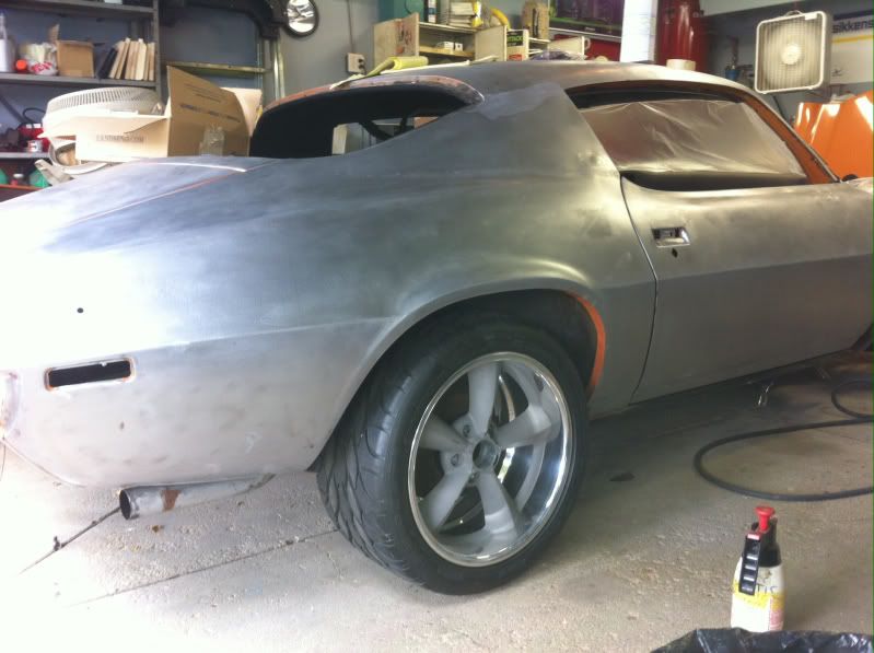

I'm finally getting to the point where I need to figure out the actual wheel/tire combo I'm going to run. I have the front fully welded in and all pieces mocked up. With my 275x17 rear wheels on the front there is loads of clearance with the new parts. I'm starting to lean to the 315/275 combo on a 11.5 rim for simplicity and ability to go to a 335 rear later if desired. The biggest debate is wheel choice. The LM20 CCW's seem like the best wheel for what I am looking to do in my price range. Now I'm just debating gold vs grey centers. Here is a rough photoshop of the gold on the car.

And an even worse attempt with Grey wheels. Thinking may have to try satin black centers.

Brakes will fit 17s but going to put 18s on the car mainly for looks. The photoshop is just to test what look I want, proportions aren't right
