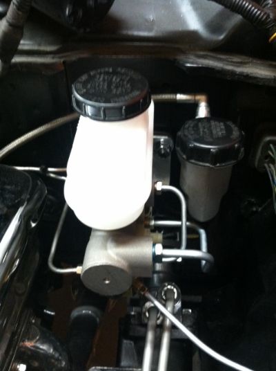

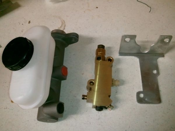

Brake lines were on the agenda so I did some research and found a Disc/Drum Ranger master cylinder. I also had a Master Power Brakes combination valve, and it had a non-functional bracket so I had to fab up a new one. I spent a few days learning how to bend and flare brake lines, as I had never done that before either.
http://i144.photobucket.com/albums/r...ps6ab2d838.jpg
The lines were really close to the Wilwood master cylinder, so it was a challenge.
http://i144.photobucket.com/albums/r...ps7e21b880.jpg
My Daughter and I built a radiator shroud from fiberglass, I think we found this idea on the H.A.M.B., we had done one before but this is the second generation. I will post one picture and a link, as there are several pictures and we were still working on it today.
http://i144.photobucket.com/albums/r...psa9913f40.jpg
Radiator Shroud
Bolts right up = needs some modification to work. :lmao:
Nice work Joe making those parts actually work.
The brake lines look nice. I was telling a buddy of mine with little to no actual building skills that bending and flaring lines would be a great first project. He still hasn't done crap. Of course I've seen some nice fab work from you and your daughter so those lines turning out that nice on your first try is no surprise.:thumbsup:
It sure is nice to see a Torino getting close to hitting the road.
