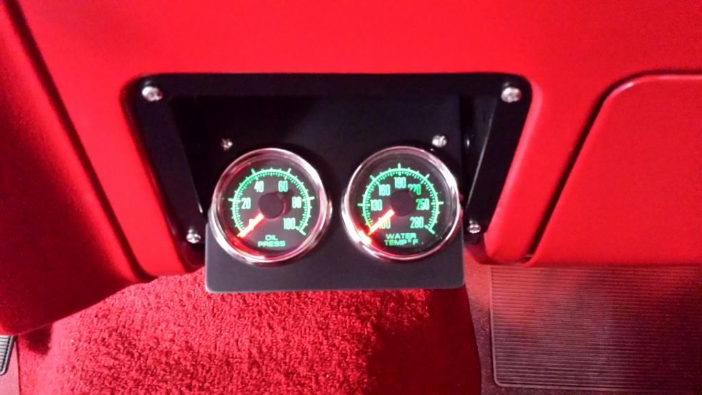

My car is a non-gauge, non-console car but I wanted to be able to monitor the new engine. I made this panel in the ashtray location and was able to do it without drilling any holes or cutting any existing wiring. I originally wanted to put the gauges inside the ashtray so I could close it up but there simply wasn't enough room for 2 gauges.

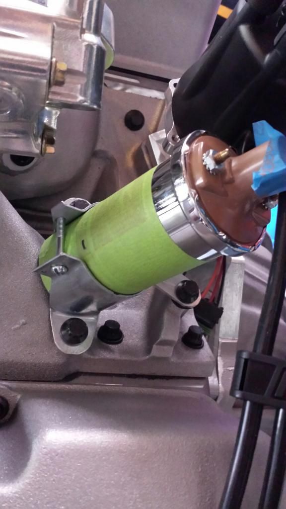

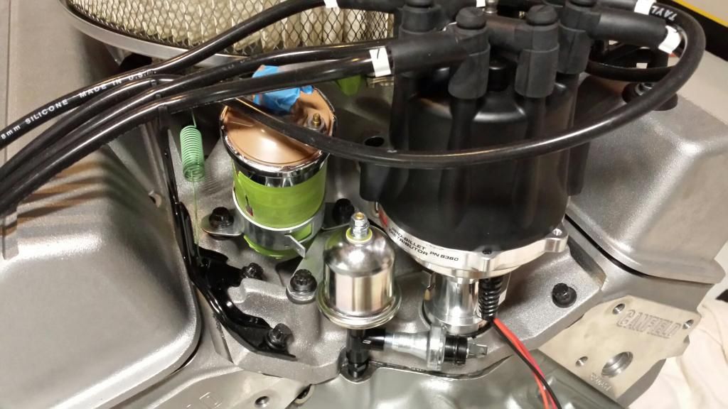

I tended to some small odds and ends today. I made a coil bracket to put the coil in the stock location to avoid holes in the firewall, etc. It clears the air cleaner base by about 1/8". I plan to use the stock throttle linkage, return spring, and wire separator (which attaches to the back manifold bolts). It's tough making everything fit like stock.
http://i162.photobucket.com/albums/t...sd23bb500.jpeg

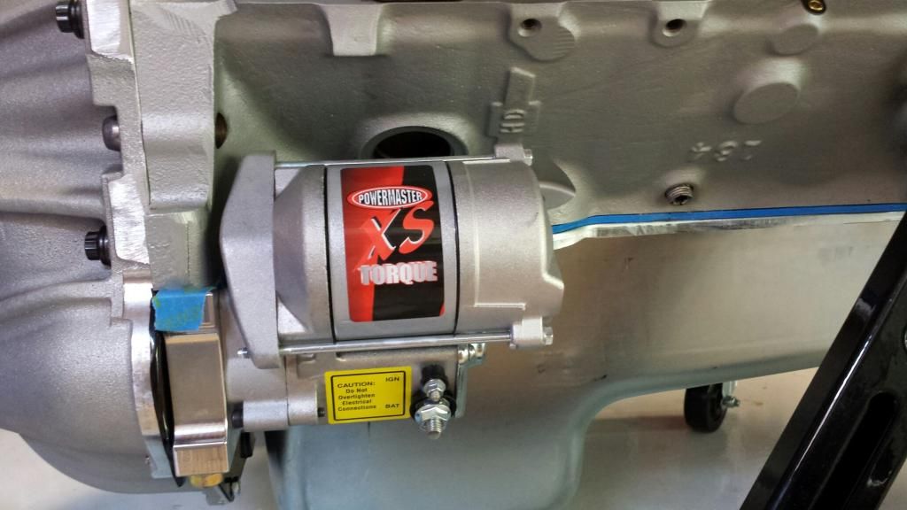

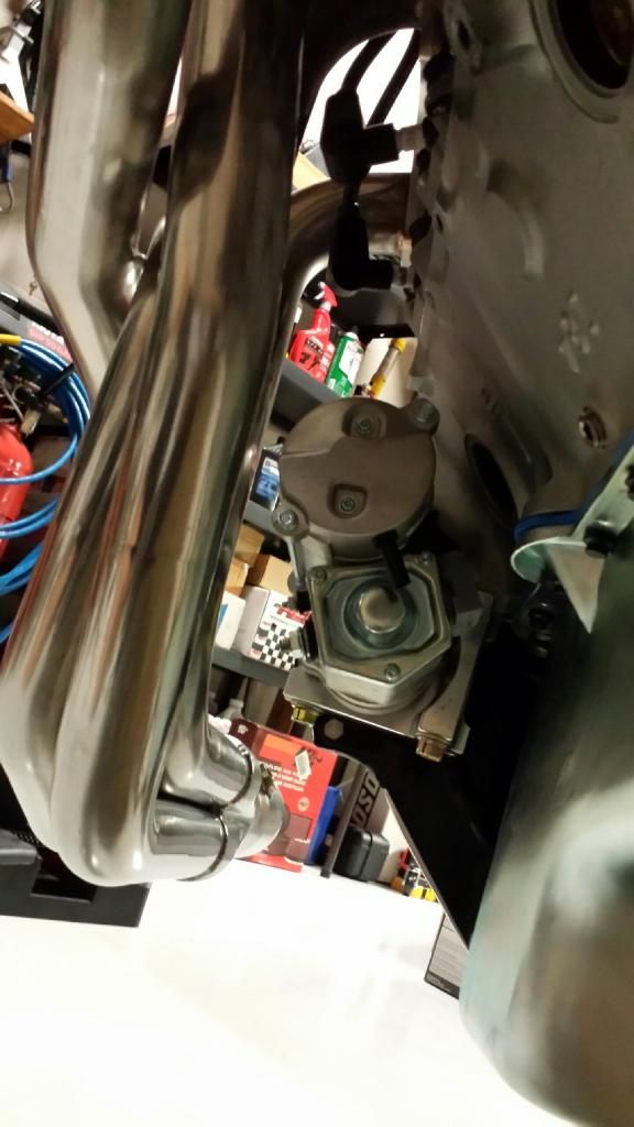

The flywheel dust shield required significant trimming to work with the 1 piece rear seal oil pan. But the starter is a really nice piece.
http://i162.photobucket.com/albums/t...s053dc100.jpeg

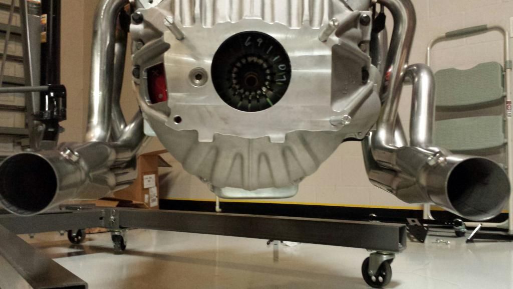

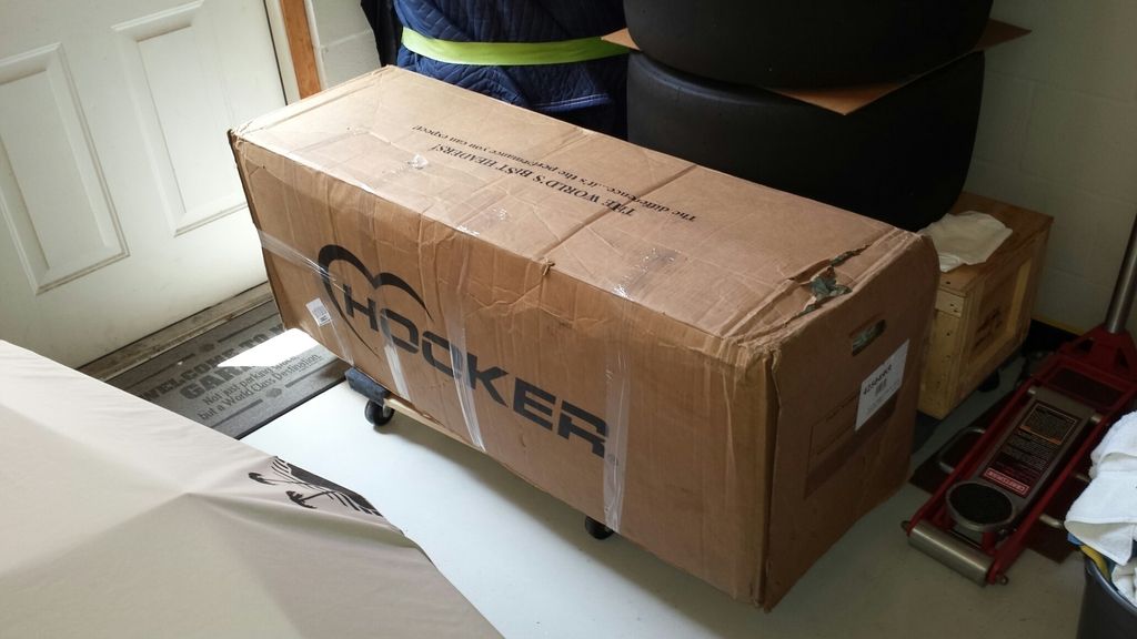

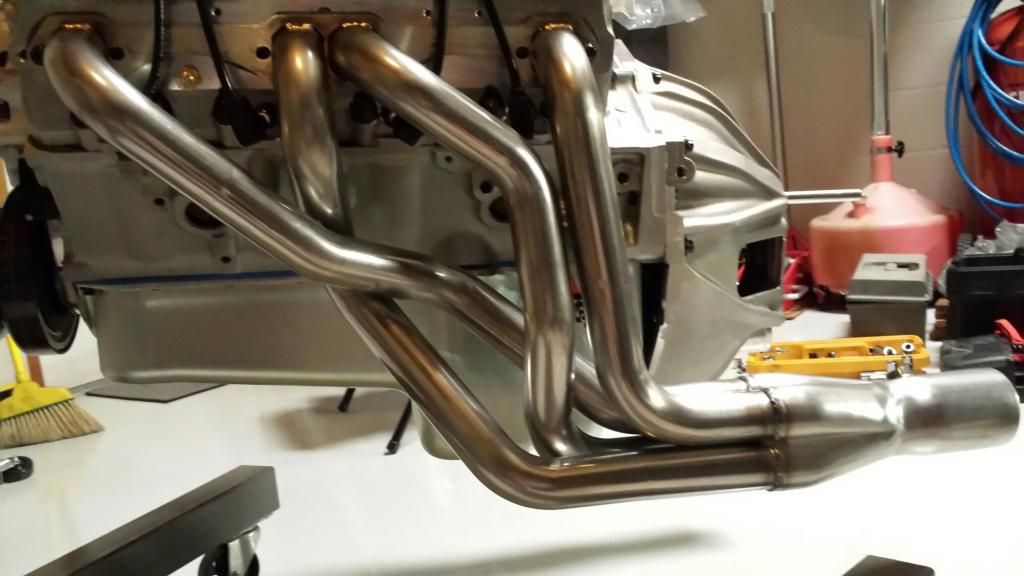

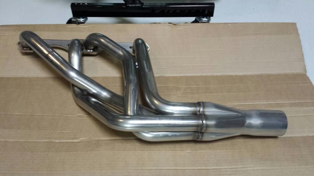

The new headers arrived yesterday. I decided to upgrade from my old Hooker 2131 Super Comps to the new Hooker 2105-7HKR. These are 304 stainless and offer much better ground clearance, better exhaust port alignment, and O2 sensor bungs. Plenty of room around the plugs with my angle plug heads.

Flash68 01-07-2015 11:41 AM
Cool stuff Neil.
What are the before and after primary & collector sizes on the Hookers?
Neil B 01-07-2015 12:47 PM
Originally Posted by Flash68 (Post 588646)
Cool stuff Neil.
No change. 1 3/4" primary to 3" collector for both the 2131's and the 2105's. But Hooker does make a stepped version 1 3/4" to 1 7/8" to 3.5" collector. The 2105's line up perfect with my big exhaust ports. I did not intend to upgrade the headers but then an exhaust company came on board with the build/show, so the only thing left from the old motor was the headers. LOL.

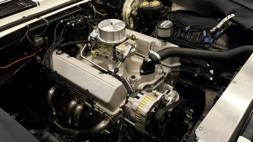

I'm no fabricator, but I spent more time than I care to admit getting everything to fit the way I wanted to on the back side of the intake. The stock throttle rod will pass just to the left of the coil and the vacuum line to the brake booster will tie into the custom bung on the backside of the runner.

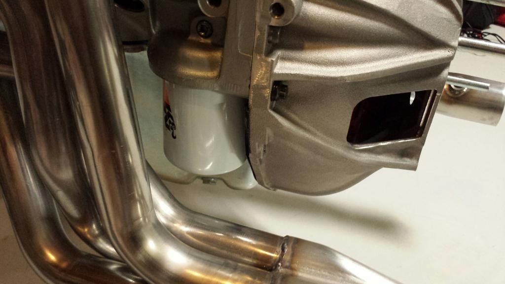

Neil B 01-15-2015 06:42 AM

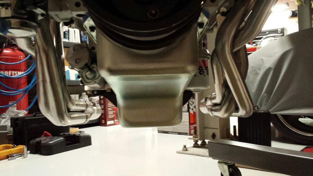

I did a test fit on the new headers. Good clearance everywhere so far.
http://i162.photobucket.com/albums/t...sc390bca5.jpeg
http://i162.photobucket.com/albums/t...s8eb473be.jpeg
http://i162.photobucket.com/albums/t...s3199dddb.jpeg
http://i162.photobucket.com/albums/t...s2c9e20e5.jpeg
http://i162.photobucket.com/albums/t...s7a4b86d9.jpeg
http://i162.photobucket.com/albums/t...s56805ce5.jpeg
http://i162.photobucket.com/albums/t...s12110bec.jpeg

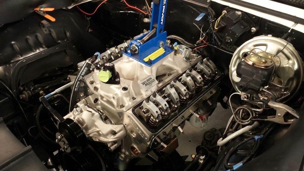

Nothing left to do put re-prime it and check the valve lash. The car goes to the production facility tomorrow. I will let everyone know about the show details and air dates as soon as possible.

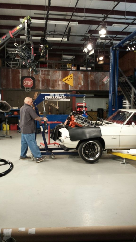

Neil B 01-20-2015 07:24 AM

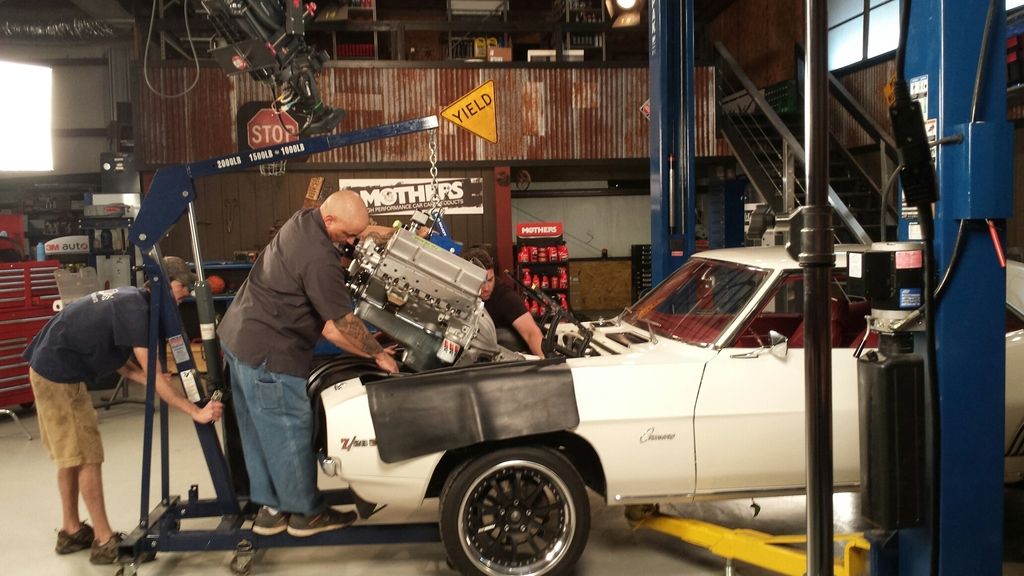

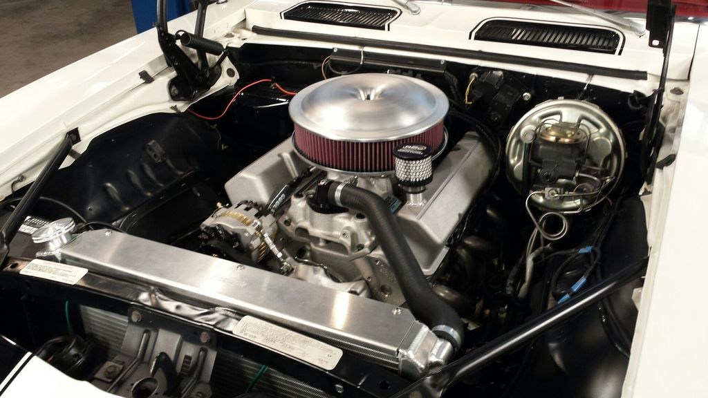

The car is on the set! I'm excited to tell you that the engine swap will be performed on the Velocity Channel's show called Car Fix. Jared and Lou will be turning the wrenches. Filming will occur next week for Episode 1 of this season. Air date will be sometime in March.

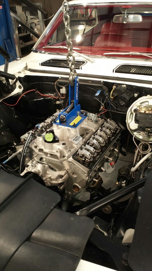

Neil B 01-29-2015 11:52 AM
Hey guys, we finished filming the episode today. The entire production crew was awesome and made us feel very welcome. Stay tuned to Velocity and watch for the new season to begin in March!

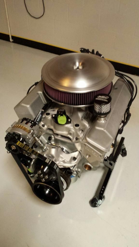

March Performance makes the bracket and pulleys. I got them in black powder coat finish. The bracket was not designed to work with the CS130 alternator I wanted to run, so I had to modify it.

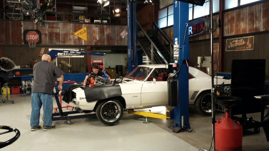

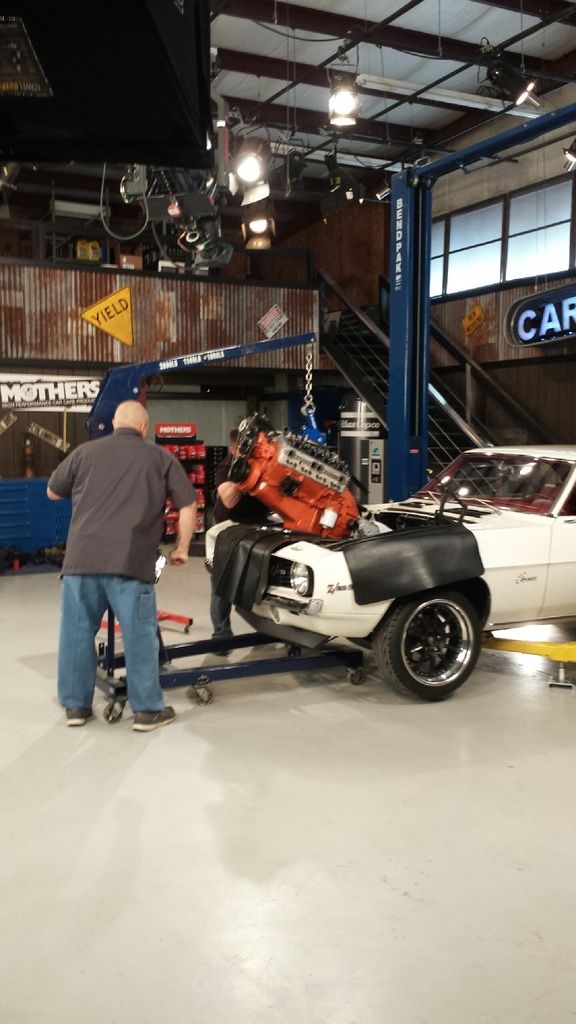

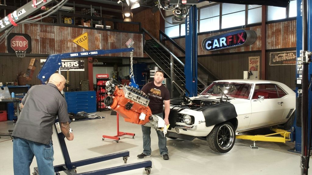

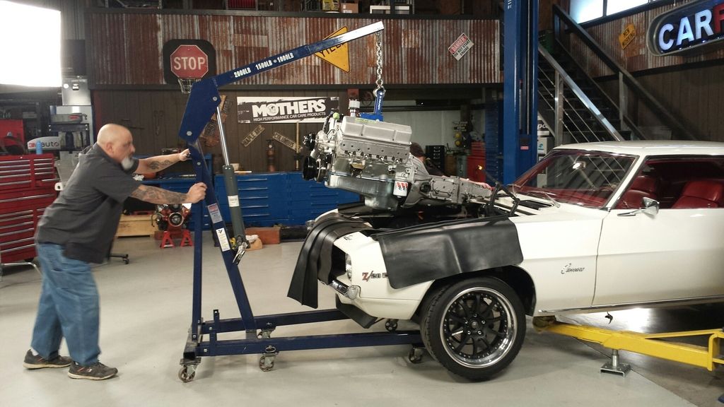

Neil B 05-08-2015 11:39 AM

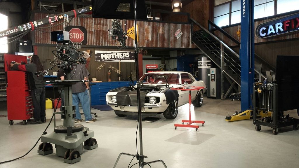

Hey guys, the show has been televised a few times now. Here are some pics from the production. What a great experience all the way around!

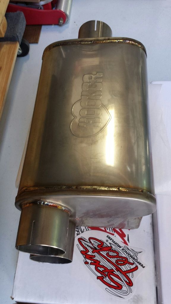

Neil B 05-26-2015 12:44 PM

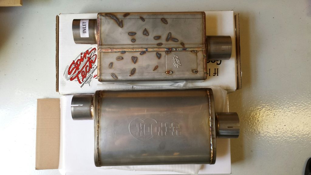

My SpinTech mufflers arrived today. I had them custom made in 304 stainless with 5 spin traps instead of the normal 6 traps. Some of the baffling on the side of the muffler casing was also left out. This should put the sound level somewhere between a Sportsman muffler and a Pro Street muffler design. I went with the Sportsman case size to match the size of the Hooker V304 mufflers that came with the exhaust system. The overall muffler length and inlet/outlet offset of the two muffler designs is identical so they should bolt right up. The Hooker mufflers are also very nicely constructed, but I had my heart set on a chambered-style exhaust note.
http://i162.photobucket.com/albums/t...svdlrp8d5.jpeg
http://i162.photobucket.com/albums/t...shghv50hw.jpeg[/URL]
Moose 05-26-2015 01:45 PM
hope the spin techs work out for you.. mine didnt.. fell apart after 2 years.
Flash68 05-26-2015 01:46 PM
Neil I bet that's gonna sound TOUGH! Love the Spintechs... had have 2 sets and love the sound. Definitely unique sound.
Neil B 05-26-2015 01:54 PM
How did yours fall apart? Mine appear to be of high quality and are very ruggedly built.
