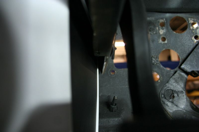

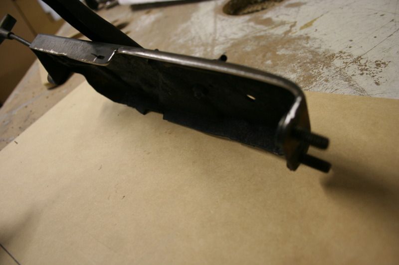

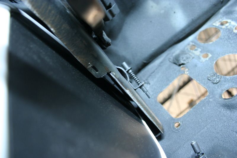

TheShopLLC.com 03-11-2015 10:22 AM
E brake
Originally Posted by Nativefx (Post 597952)
Do you have any pictures of your tweeter setup, and where did you move the park brake?
thanks, Jake
A quick trim to the e brake and the kick will slide right in, as far as tweeters, if you can get them up higher in a pillar or door panel that would be best, if not, run a coax component in the kick.. Here are a few pics of the e brake.. We can pop a hole under the 6.5 for a tweeter there is plenty of room.. Thanks for the feed back guys

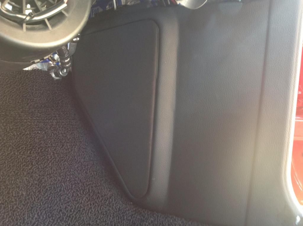

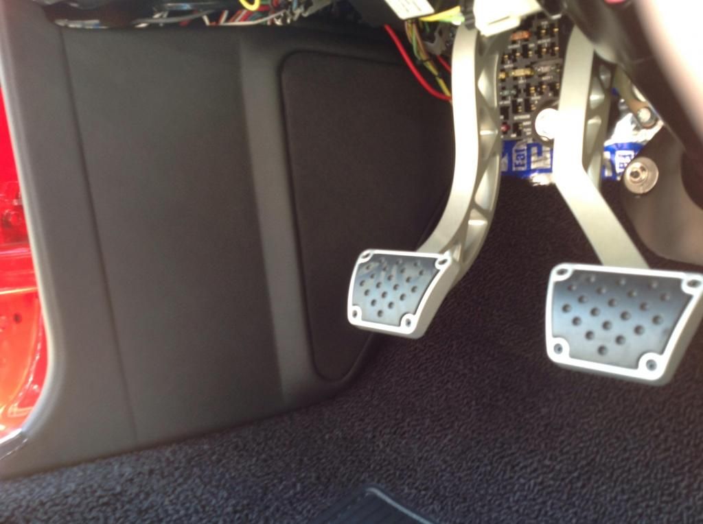

ADY 09-15-2016 09:45 AM
Installed the kick panels in my '68 Camaro and they look great the speakers sound awesome as well.
Below is my feedback on my install:
  1. Definitely have to notch the bottom of the stock e-brake bracket.
  2. Works with the factory high beam switch, but very tight. I put a few washers under one side to angle the switch away from the panel.
  3. I took off the double sided tape for the speaker covers and used velcro instead so I don't risk breaking the cover when i have to remove the panel in the future.
  4. At least for my 6.5" speakers the cutout in the panel wasn't big enough to allow me to install them after installing the panel, so I'd recommend enlarging the cutoff as much as possible.
  5. I had to cutout a small piece from the top of the panel b/c it was hitting dash support; didn't like I had to do this after the panel was already wrapped, but at least the rough edge isn't noticeable.

Awesome install and love the feed back! Thanks a ton!
