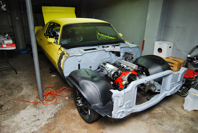

I had a chance to pick up my inner fenders after they were undercoated and painted. Also was able to get my parts back from the anodizing shop on Friday. This meant getting all of the accessories installed and mounting up the inner fenders and core support.
Ran into some issues with the power steering pump. That will have to wait until I get some spacers machined. I wasn't running the car with an accessory on the top drivers side before and therefore had no belt interference. Now that the alternator is going to be there, I need to move the ps pump further down. Luckily it looks like my KRC bracket can just be flipped and all will be good.

Thanks for the kind words. It really is a shame that we all lost touch with the demise of the chat room over there. I have been trying to get work done in between field assignments, however, I haven't had much time at home.
These are the latest pics:
https://lh5.googleusercontent.com/-m...428_140232.jpg
https://lh4.googleusercontent.com/-2...428_140220.jpg
https://lh4.googleusercontent.com/-Q...428_140209.jpg
https://lh5.googleusercontent.com/-q...428_140135.jpg
As soon as I get home, I hope to plumb the fuel system and get my EFI installed!!!

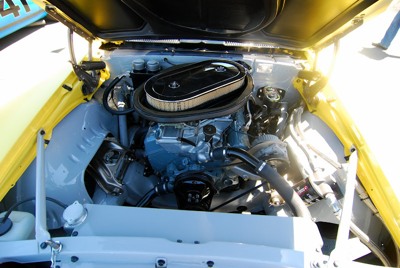

Inspired by the early SCCA Trans Am Camaros. Now only if I could swing a TRACO built small block to complete the look...
https://lh6.googleusercontent.com/--...0/DSC_1682.JPG
