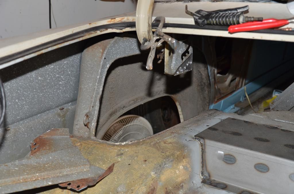

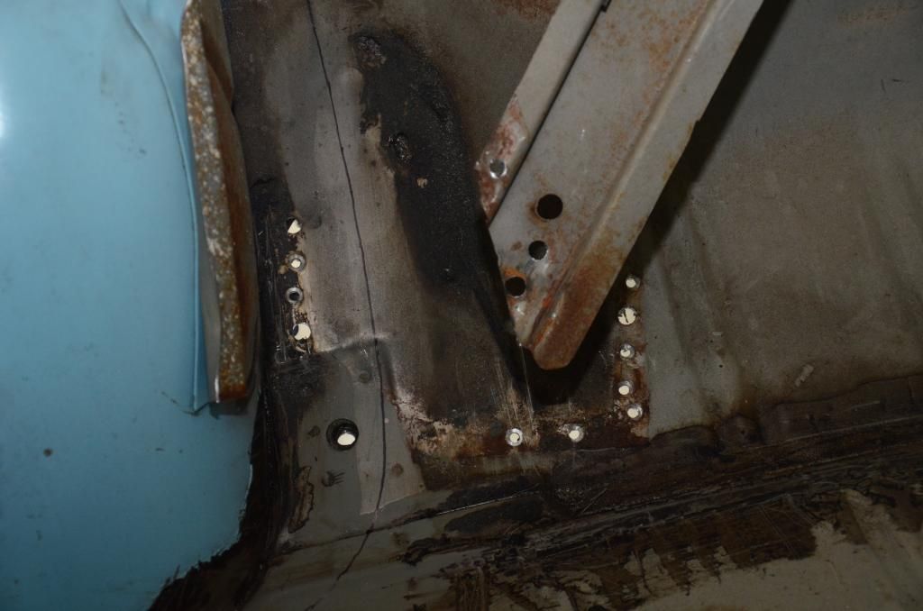

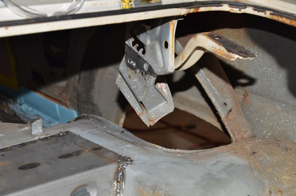

New update with pretty new parts :)
http://i249.photobucket.com/albums/g...e.jpg~original
http://i249.photobucket.com/albums/g...7.jpg~original
http://i249.photobucket.com/albums/g...f.jpg~original
http://i249.photobucket.com/albums/g...9.jpg~original
wiedemab 04-28-2014 07:50 PM
That is a thing of beauty!!!

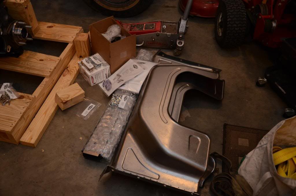

More goodies delivered today.
DSE ford 9" with quadralink brackets narrowed to 52 1/4" and moser engineering 31 spline axles
http://i249.photobucket.com/albums/g...d.jpg~original
http://i249.photobucket.com/albums/g...a.jpg~original
Jay Hilliard 05-01-2014 05:27 AM
Awesome. Those inner fender panels are very nice. Wish I could tig weld like that.

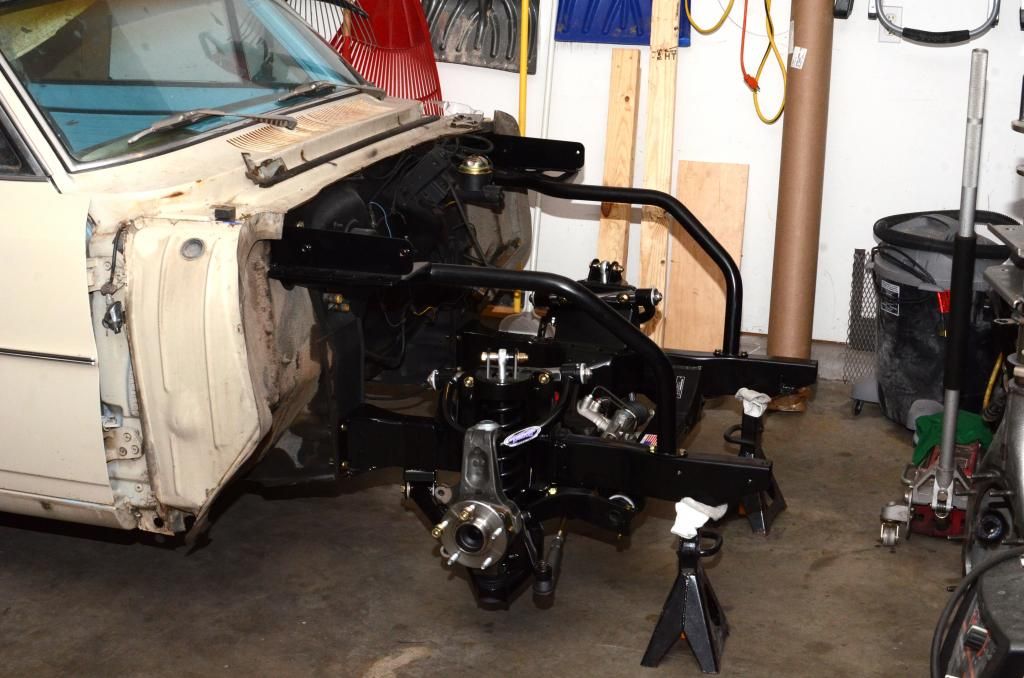

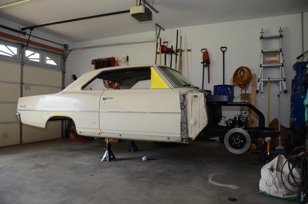

kevin_l 05-20-2014 06:28 PM
FINALLY got to work on the car a little today. Dad came over to lend a hand and we got the front end swap accomplished in a few hours. We had to elongate the holes on the car to fit the subframe, but it worked out ok.
http://i249.photobucket.com/albums/g...2.jpg~original

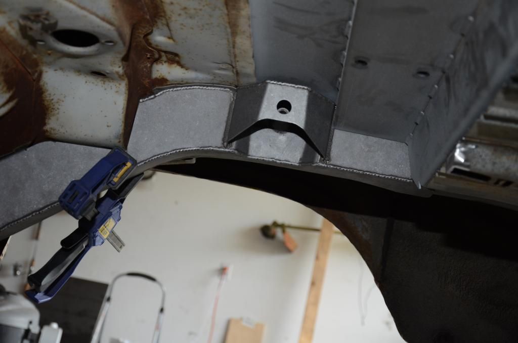

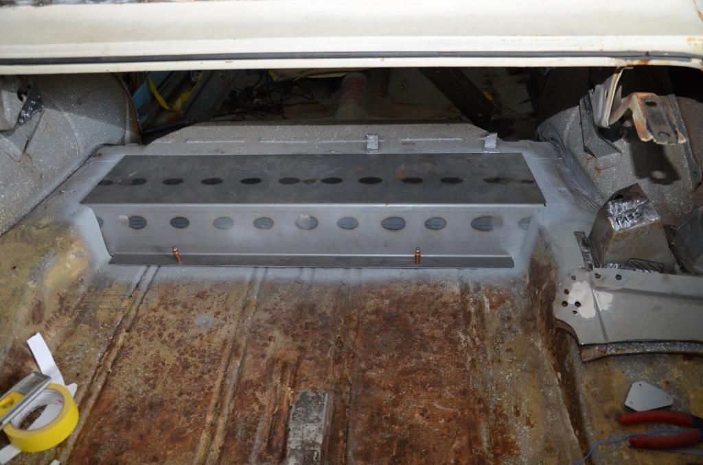

kevin_l 06-03-2014 09:09 AM
Some more updates.... Not much left of the old car now. :eek:
Finished pulling the interior, removed the stock rear end and leafs, got the rear seat braces drilled and pulled. Also had to drill and remove the stock pinion snubber, the bump stops and began drilling the transport tie downs when the drill stripped out its gears. :mad:
Mocked up the sway bar bracket and inner frame rail sections.
http://i249.photobucket.com/albums/g...c.jpg~original
http://i249.photobucket.com/albums/g...3.jpg~original
http://i249.photobucket.com/albums/g...b.jpg~original

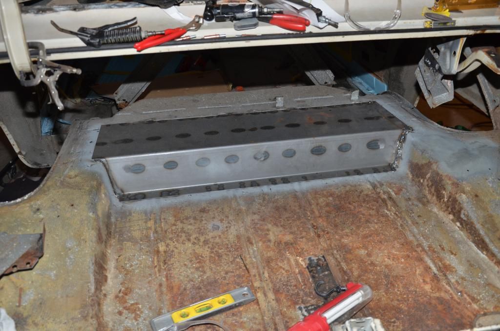

Pretty quiet in here but I'll keep posting updates.
Got the sway bar mount welded in before running out of gas on the mig.
Also, rough cut out the wheel tubs getting ready to make some extra room.
http://i249.photobucket.com/albums/g...4.jpg~original
