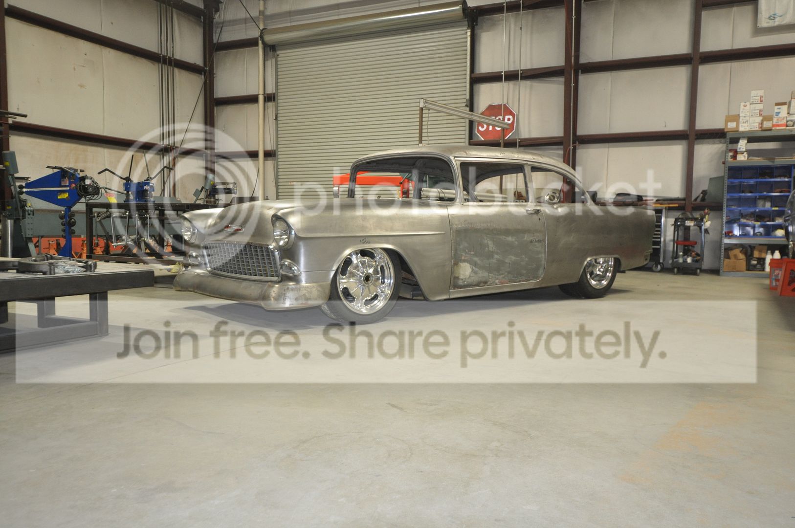

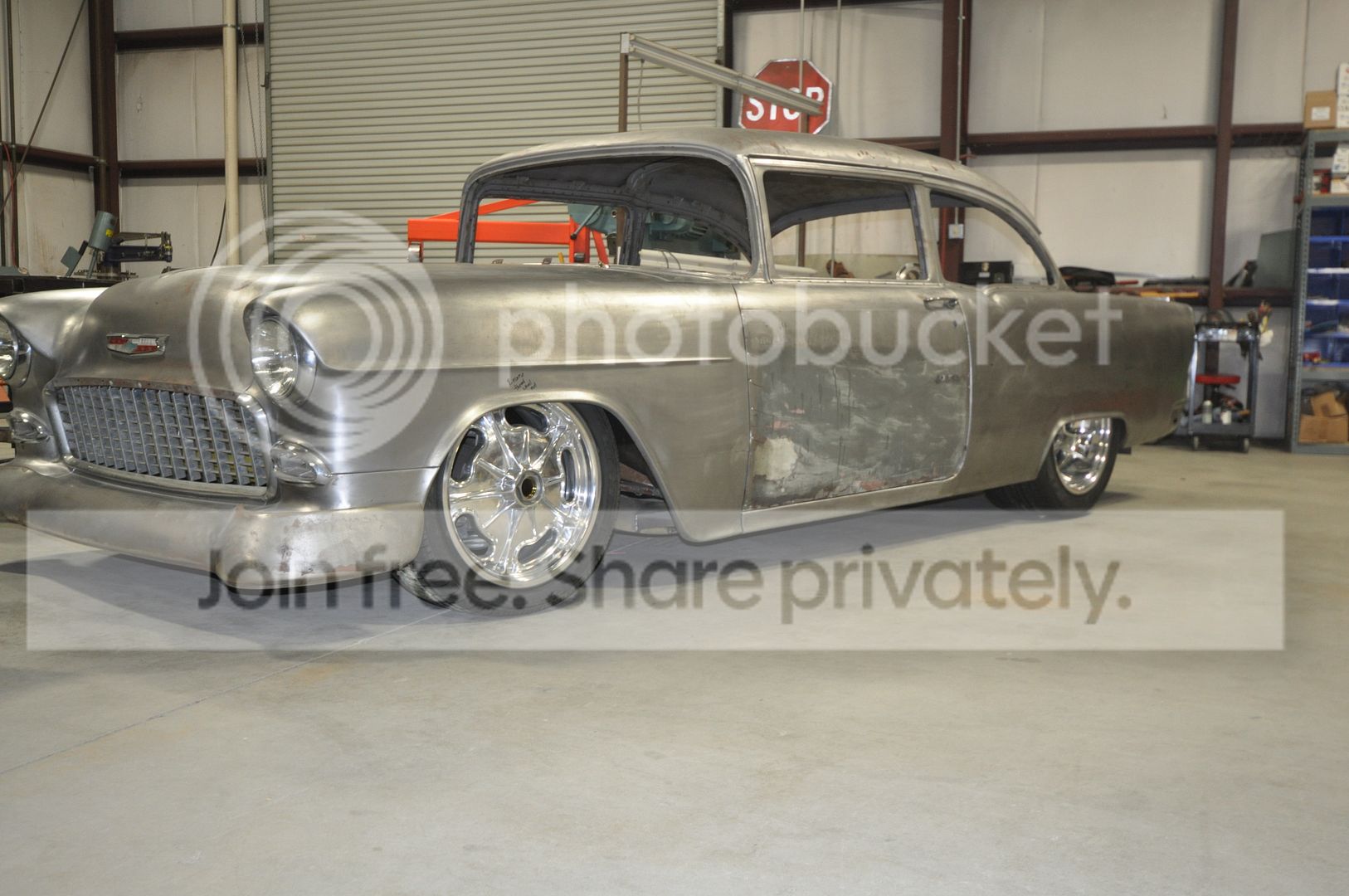

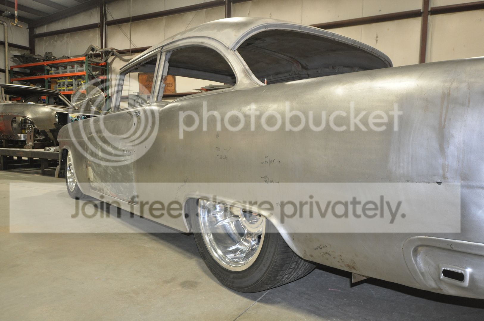

ironworks 11-17-2014 03:02 PM
Sorry I'm just getting around to doing an update. Things have been pretty busy around here with SEMA and everything else.
This 55 is going to be one bad ass car. Everyday I get more and more excited about this project. The wheels and stance on this car are really cool.

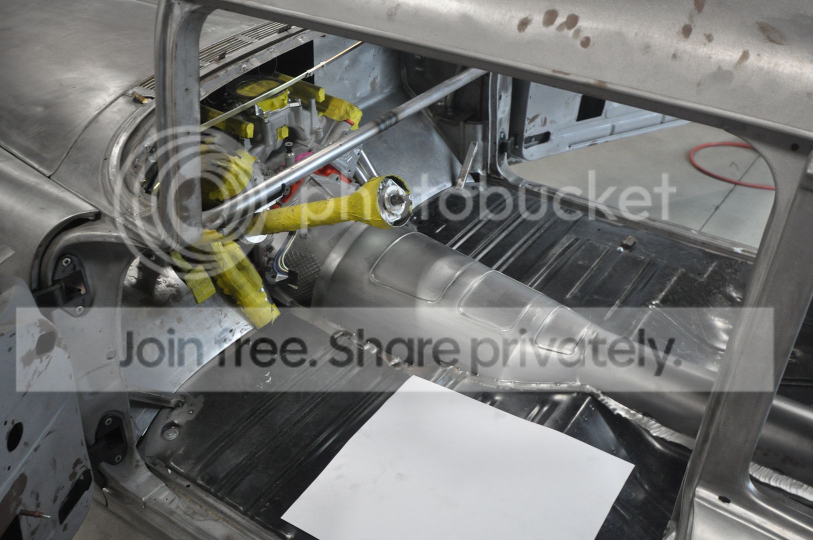

We got the Dash moved back to clear the large engine set back.
http://i616.photobucket.com/albums/t...16-2014009.jpg

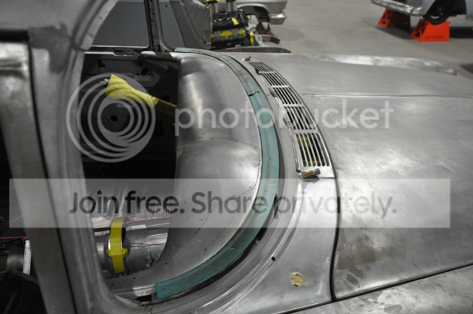

We are getting the transmission and driveshaft tunnel set up.
http://i616.photobucket.com/albums/t...13-2014018.jpg
Here is the direction we are going with the engine compartment. We are working with Vortech Superchargers on doing a complete custom blower housing to get the old school look even more. We are also working on the valve covers to get the perfect something that should have been done but never was vibe.
http://i616.photobucket.com/albums/t...gine_150_2.jpg
http://i616.photobucket.com/albums/t...gine_150_1.jpg
The wheels on this project were designed by Eric Black and myself. The front are supposed to look like 18" spindle mount wheels. The rear are build to look like the wheel that would have accompanied the Spindle mount wheels on a Gasser in a 19" wheel. The front half of the wheel hoops were machined from solid chucks and the rear hoop is from a 3 piece style wheel.
http://i616.photobucket.com/albums/t...13-2014024.jpg
http://i616.photobucket.com/albums/t...13-2014022.jpg

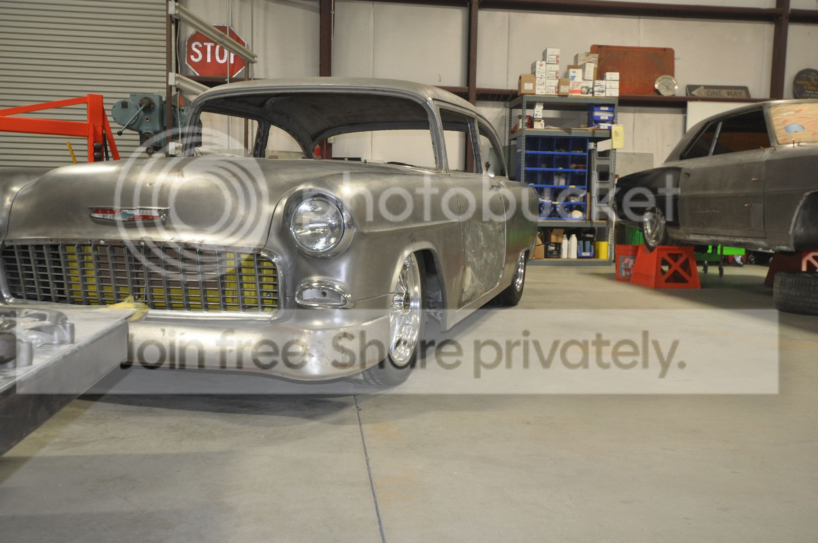

The Stance
http://i616.photobucket.com/albums/t...13-2014013.jpg
http://i616.photobucket.com/albums/t...13-2014014.jpg
http://i616.photobucket.com/albums/t...13-2014015.jpg
http://i616.photobucket.com/albums/t...13-2014016.jpg
http://i616.photobucket.com/albums/t...13-2014017.jpg
Time to get to work fitting the doors and building the new door skins to align with the shape of the body and get the under hood stuff dialed. The plan is to display this car in bare metal with all the billet parts at GNRS in January.

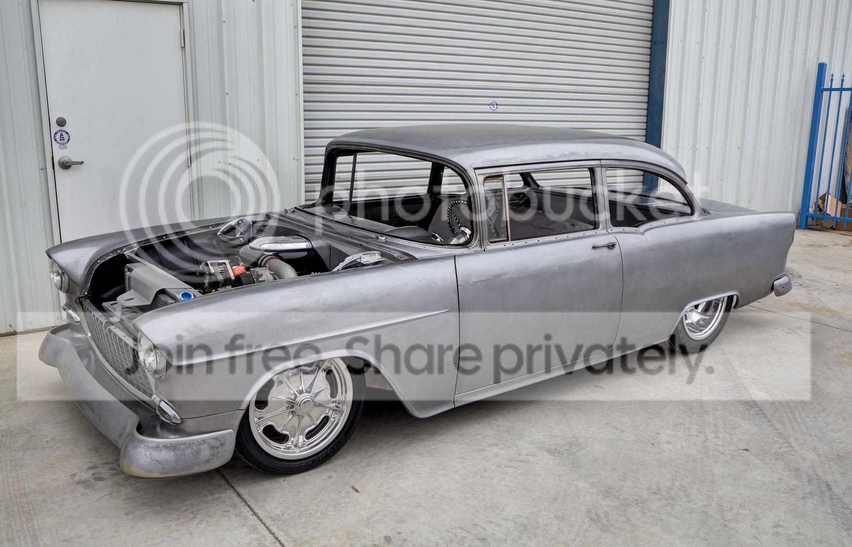

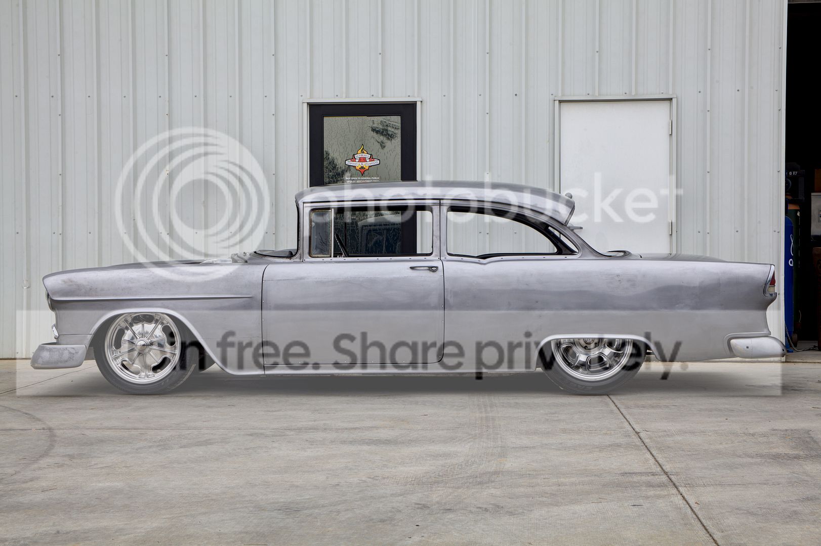

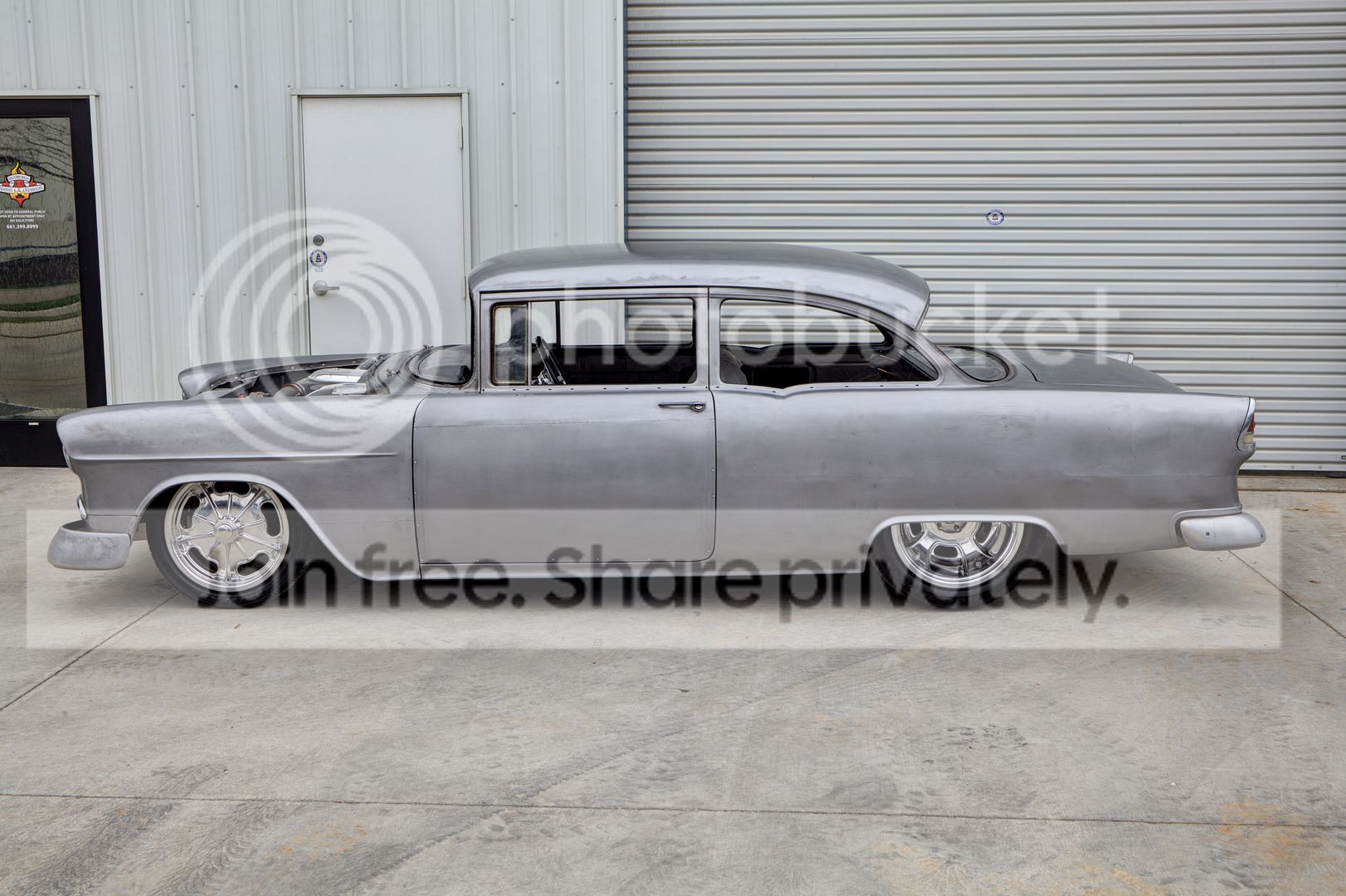

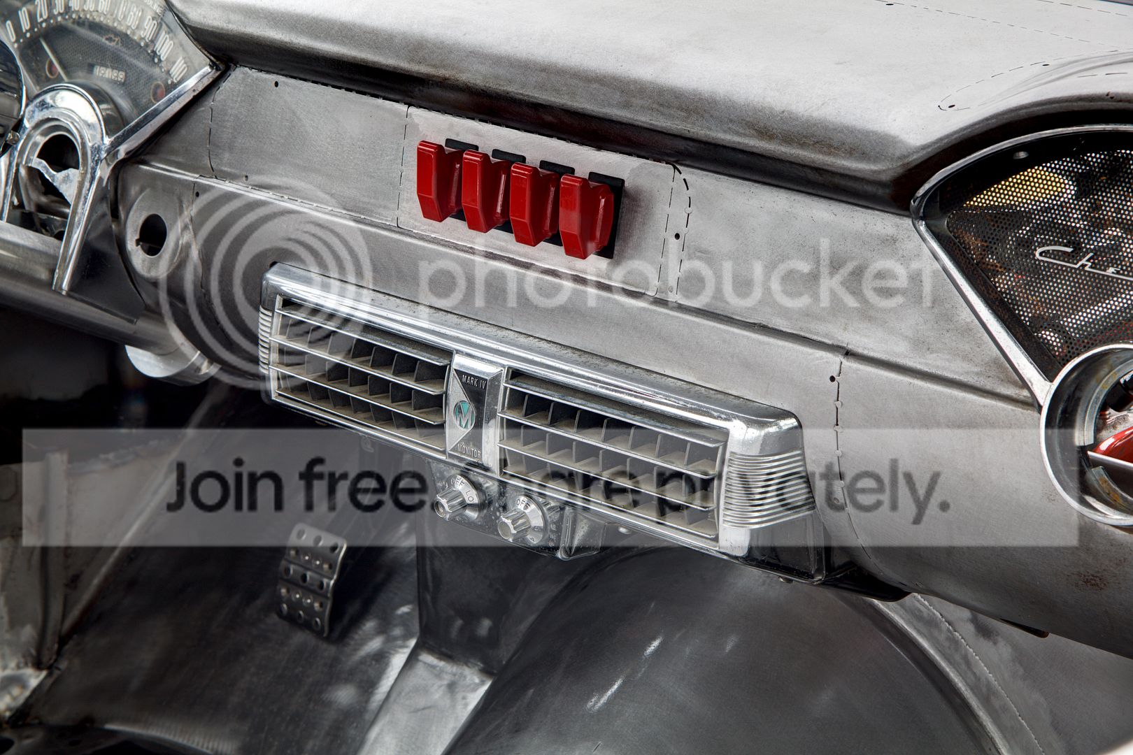

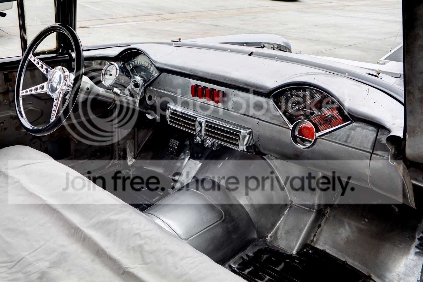

ironworks 01-30-2015 03:18 PM
http://i616.photobucket.com/albums/t...rs-prep-02.jpg
http://i616.photobucket.com/albums/t...rs-prep-16.jpg
http://i616.photobucket.com/albums/t...rs-prep-15.jpg
http://i616.photobucket.com/albums/t...rs-prep-14.jpg
http://i616.photobucket.com/albums/t...rs-prep-04.jpg
http://i616.photobucket.com/albums/t...rs-prep-19.jpg
http://i616.photobucket.com/albums/t...rs-prep-18.jpg
I'm pretty excited about this Hot Rod.

The engine air box & 'under dash" a/c set-up is freakin cool.

The under dash ac is a great idea. Keep up the great work, guys!

As always beautiful work. Under the hood looks great! I like the old style A/C built into the dash.

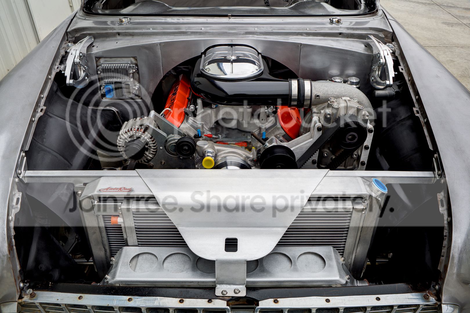

Ricochet 02-02-2015 07:50 AM
This is the money shot for me!
The details throughout are killer. I thought this show was kind of cool also...I like seeing the LSX through the mesh.
ironworks 02-02-2015 08:42 AM
We still need to finish the firewall. I think we lowered the bumper brackets after this picture was taken. I was contacted on Saturday to do a Baremetal photo shoot for a major magazine in the studio later this month.

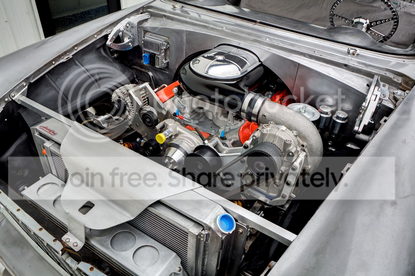

ironworks 02-03-2015 05:52 AM
Here are some detail shots of the engine. You can see the DBW throttle body will be mounted on the firewall for packaging issues. We also made the Vortech Super Charger brackets. You will see them in .125 steel and then in 1/2 plate once the design was completed. The boot on the super charger was source from a big rig truck. Lots of cool details going into this. We still have to get the power steering pump bracket to fit into the opening behind the blower belt and the rack and pinion.
http://i616.photobucket.com/albums/t...15-2015003.jpg
http://i616.photobucket.com/albums/t...15-2015004.jpg
http://i616.photobucket.com/albums/t...15-2015005.jpg
http://i616.photobucket.com/albums/t...16-2015003.jpg
Ketzer 02-03-2015 06:42 AM
Big a$$ cog drive on that supercharger = Win!
