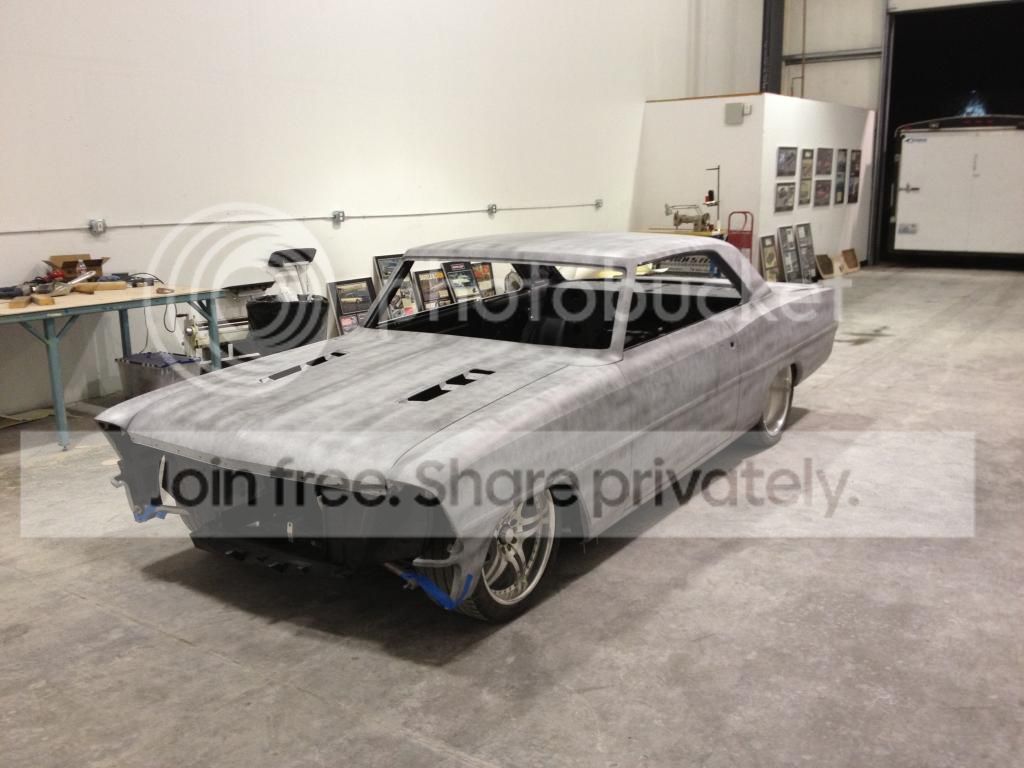

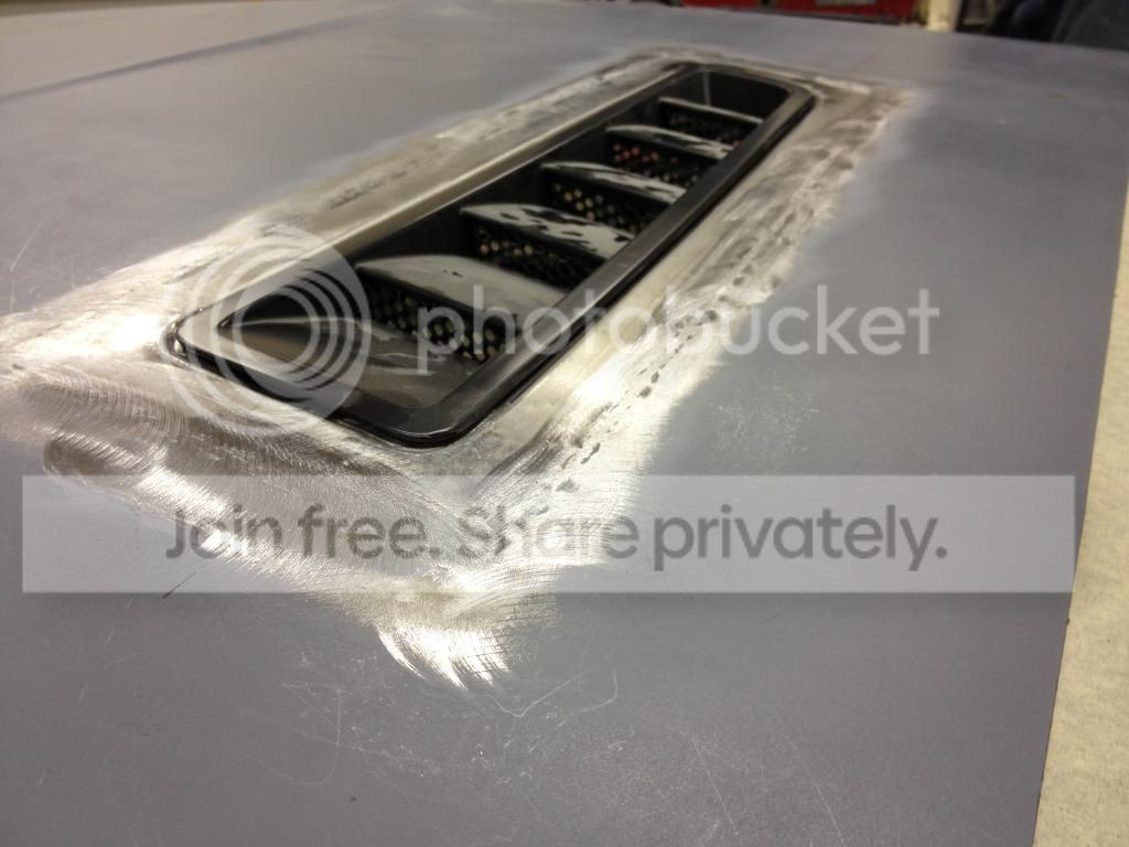

About mid way through bodywork, we decided the hood needed something...
http://i461.photobucket.com/albums/q...9812FA8F50.jpg
http://i461.photobucket.com/albums/q...DBC243DB93.jpg
We installed some vents... Its crazy how much this changed the car! It looks 1' wider than a stock Nova!
http://i461.photobucket.com/albums/q...FAE171C6BF.jpg

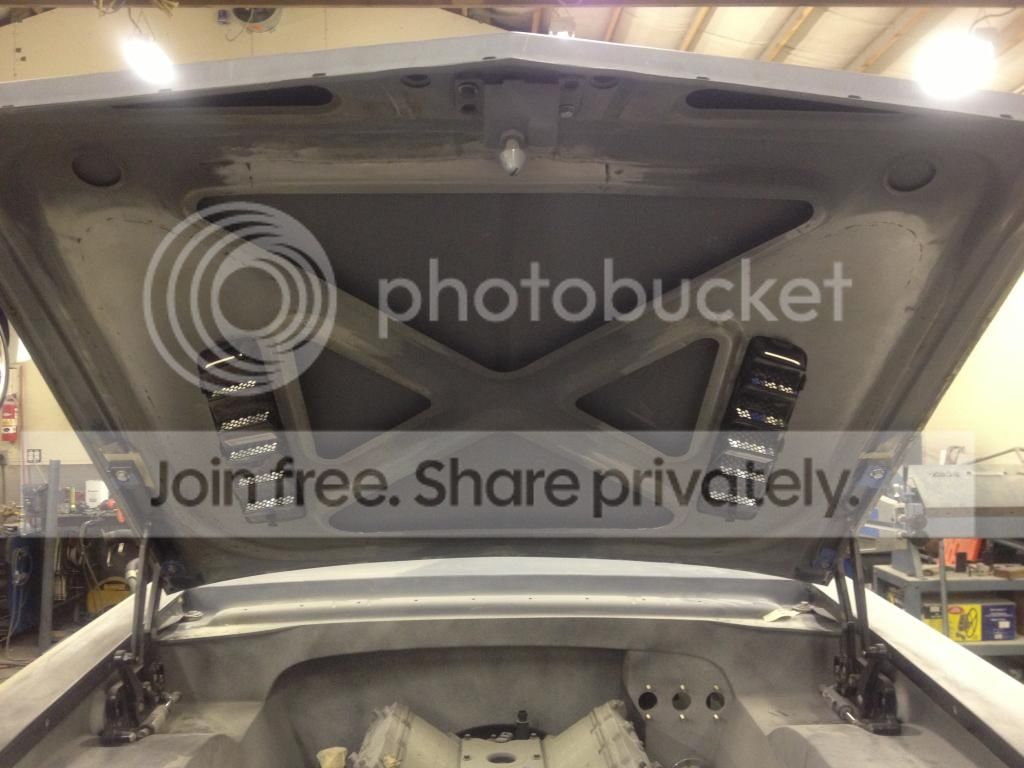

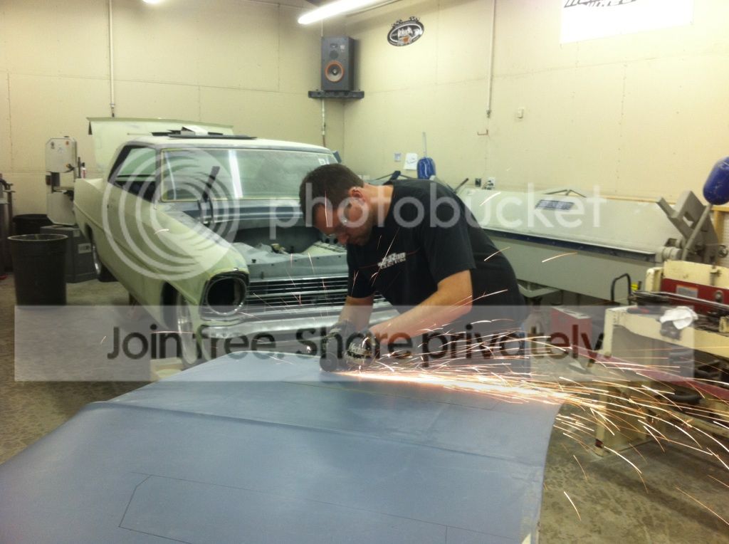

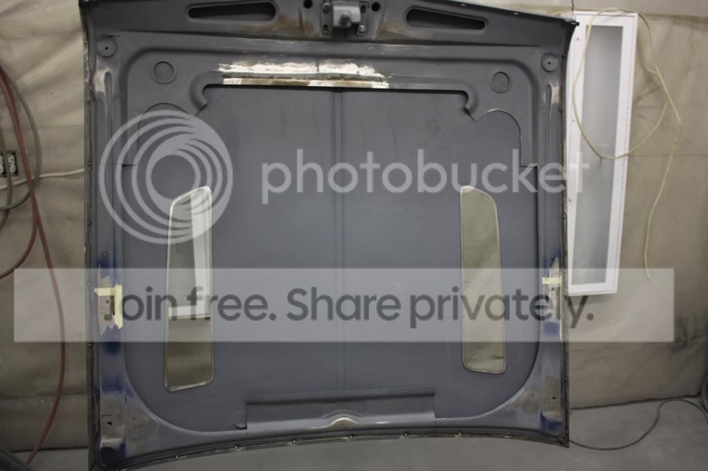

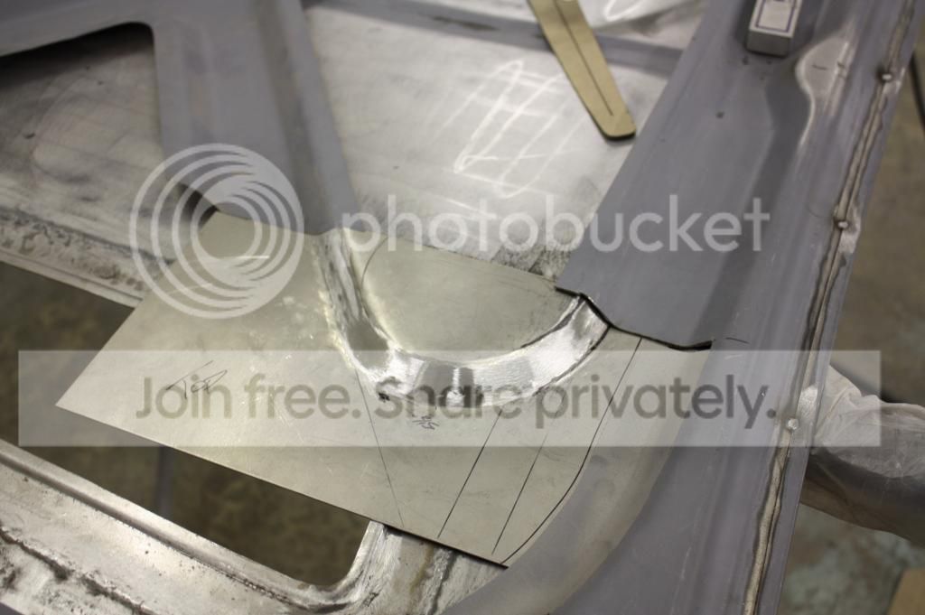

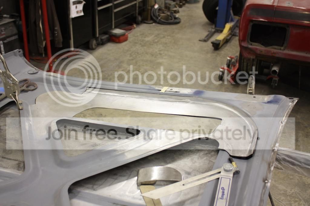

The hood was challenging...! Cutting and welding two large areas on an old hood skin, and trying to make the bottom structure look factory.
http://i461.photobucket.com/albums/q...F1AB06582D.jpg
http://i461.photobucket.com/albums/q...CC762C2BCB.jpg
http://i461.photobucket.com/albums/q...3E99C3789A.jpg
http://i461.photobucket.com/albums/q...a/IMG_2253.jpg
http://i461.photobucket.com/albums/q...a/IMG_2254.jpg
Once I got the structure fab done, we cleaned the bottom of the hood skin and sealed it. Most of the ares would be impossible to get to after the structure goes on.

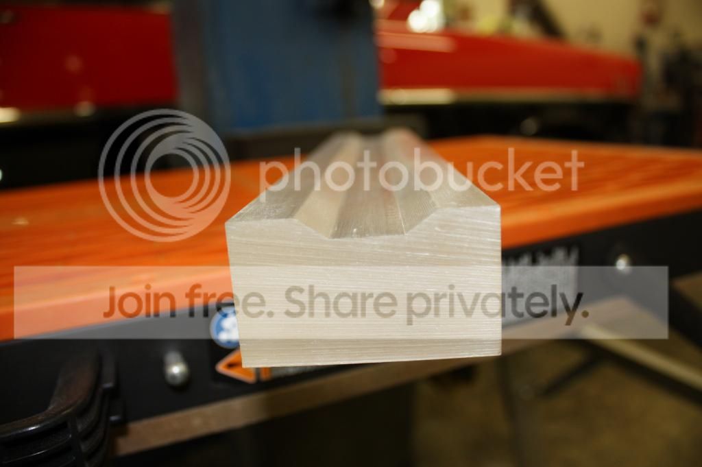

This is by far the most tedious/ time consuming car we have ever bodyworked! It looks so simple and square, but every edge, corner, and bodyline are as straight as they can be! We used a laser to make sure the bodyline was straight, it was difficult to "eye ball" with the crown of the quarters...
http://i461.photobucket.com/albums/q...A2415AA9BC.jpg
We had acrylic blocks machined with a sharp profile of the bodyline.
http://i461.photobucket.com/albums/q...a/IMG_2064.jpg

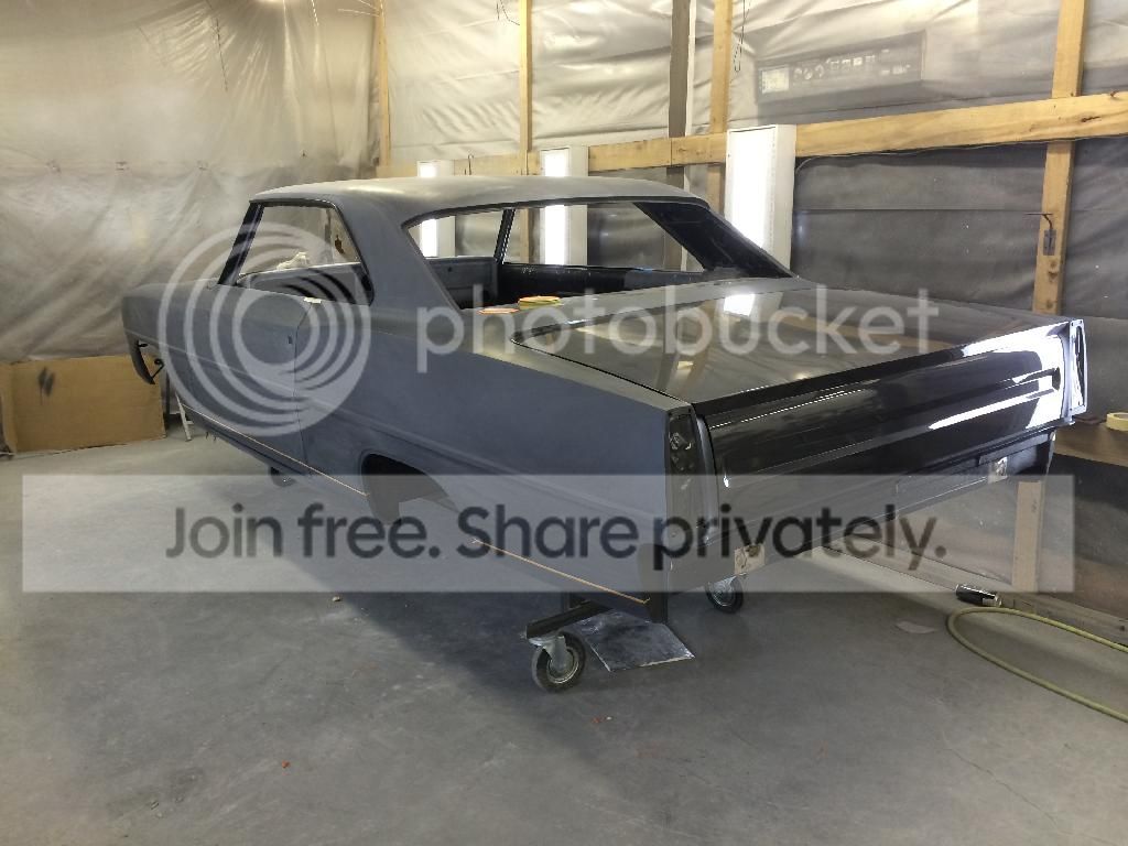

Hours and Hours of block sanding... we finally made it into paint!!!

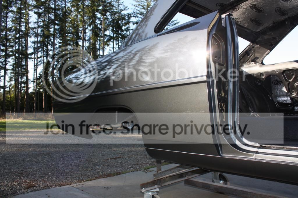

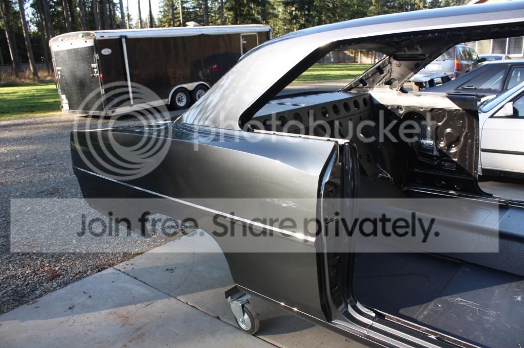

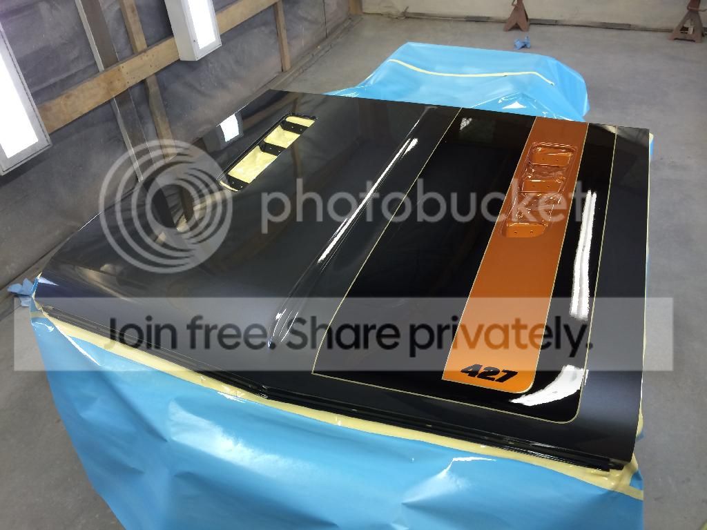

With the entire car painted, we sanded it down flat, and assembled the body. We are adding an asymmetrical stripe on the hood and trunk with a stripe running low on the sides... Jason Rushforth did a killer job on many of the subtle design features throughout the car.
http://i461.photobucket.com/albums/q...DED206C149.jpg
http://i461.photobucket.com/albums/q...06D5CE31EE.jpg
http://i461.photobucket.com/albums/q...8D0E9AE21D.jpg
http://i461.photobucket.com/albums/q...16D29BA81B.jpg
http://i461.photobucket.com/albums/q...DF1EAE451B.jpg

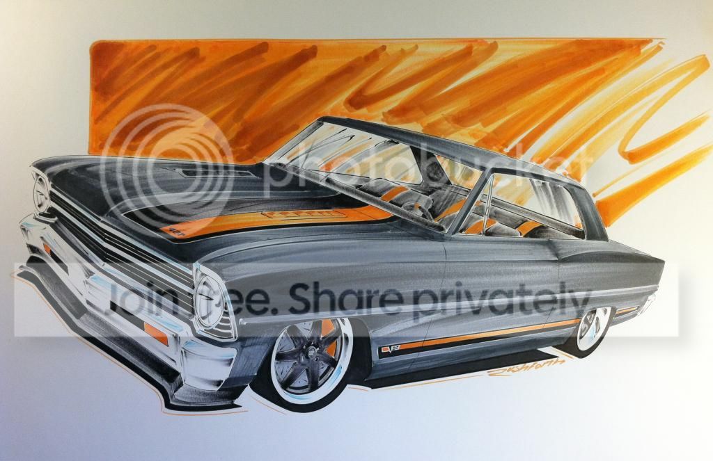

Rushforth just sent over the final rendering! I have to share!!!
We have worked together so much on this project! Its been awesome having him on the team!

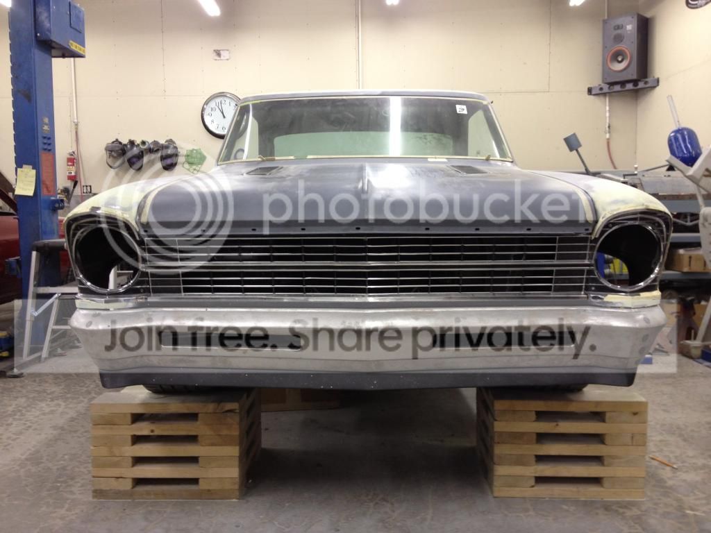

I know the finished product is the goal but this stage in the build is got to be my favorite to sit back and just stare at. Raw, could put a motor in it and drive it just like that. Great build, one of my favorite body styles.
Getting an idea for ride height...http://i461.photobucket.com/albums/q...a/IMG_0186.jpg
http://i461.photobucket.com/albums/q...a/IMG_0190.jpg

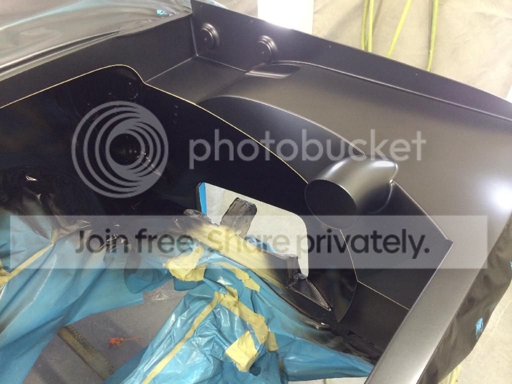

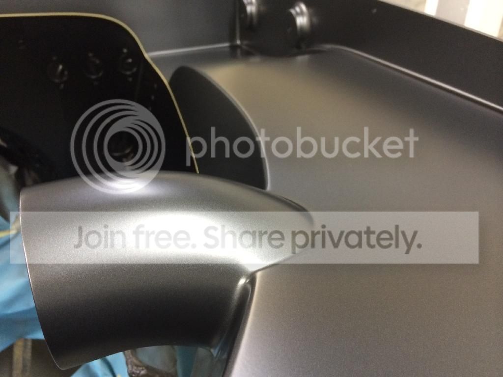

After the body was painted and graphics were on, we sprayed all our satin colors... The engine bay is two toned black and body color with our stipe color splitting them up, then a satin clear over everything...
http://i461.photobucket.com/albums/q...0B3A3AB2C6.jpg
http://i461.photobucket.com/albums/q...21749DC33D.jpg
http://i461.photobucket.com/albums/q...37FA4C5746.jpg
http://i461.photobucket.com/albums/q...43F67297BD.jpg

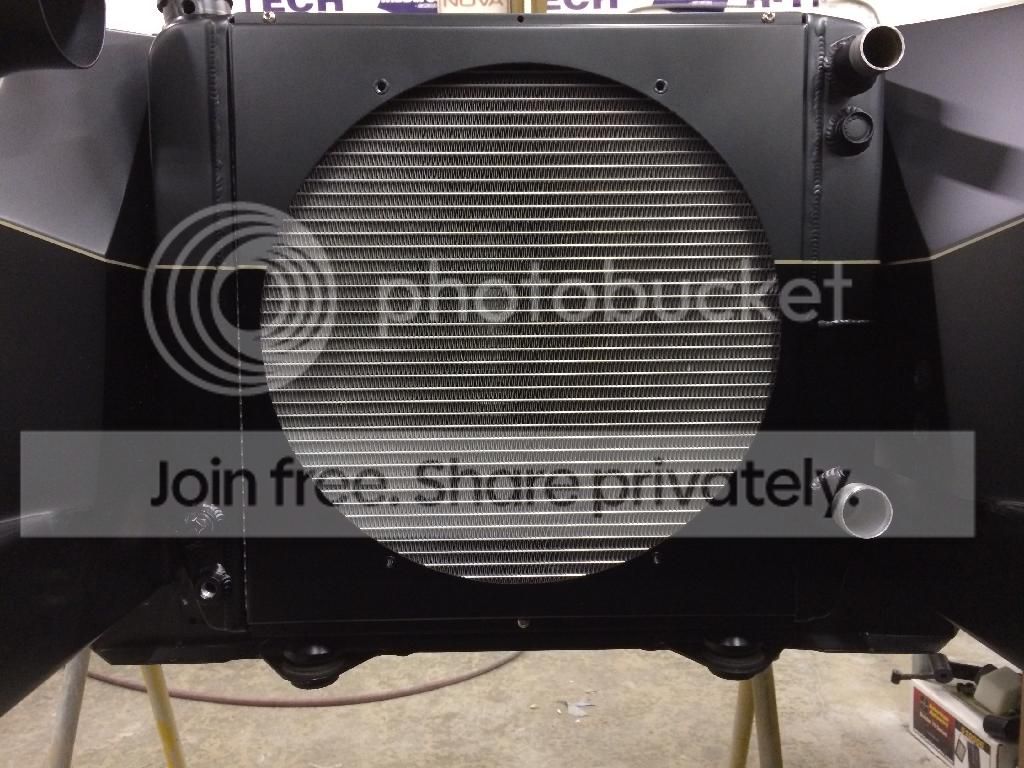

Radiator too!
