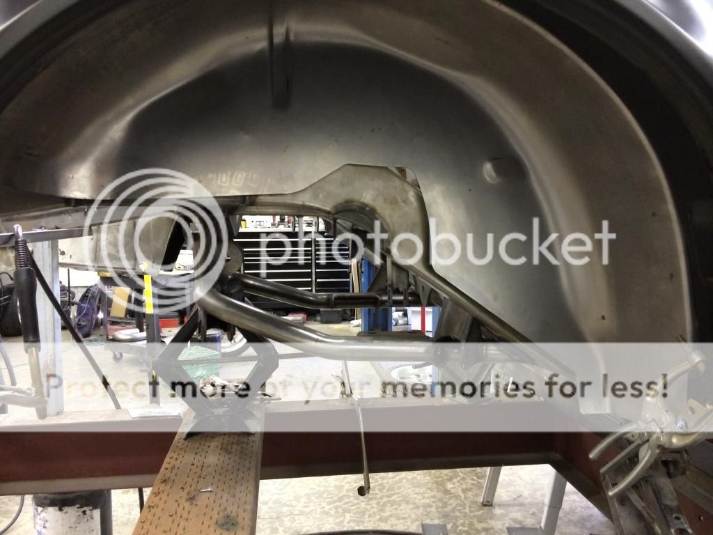

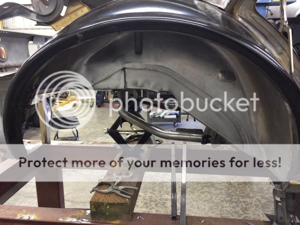

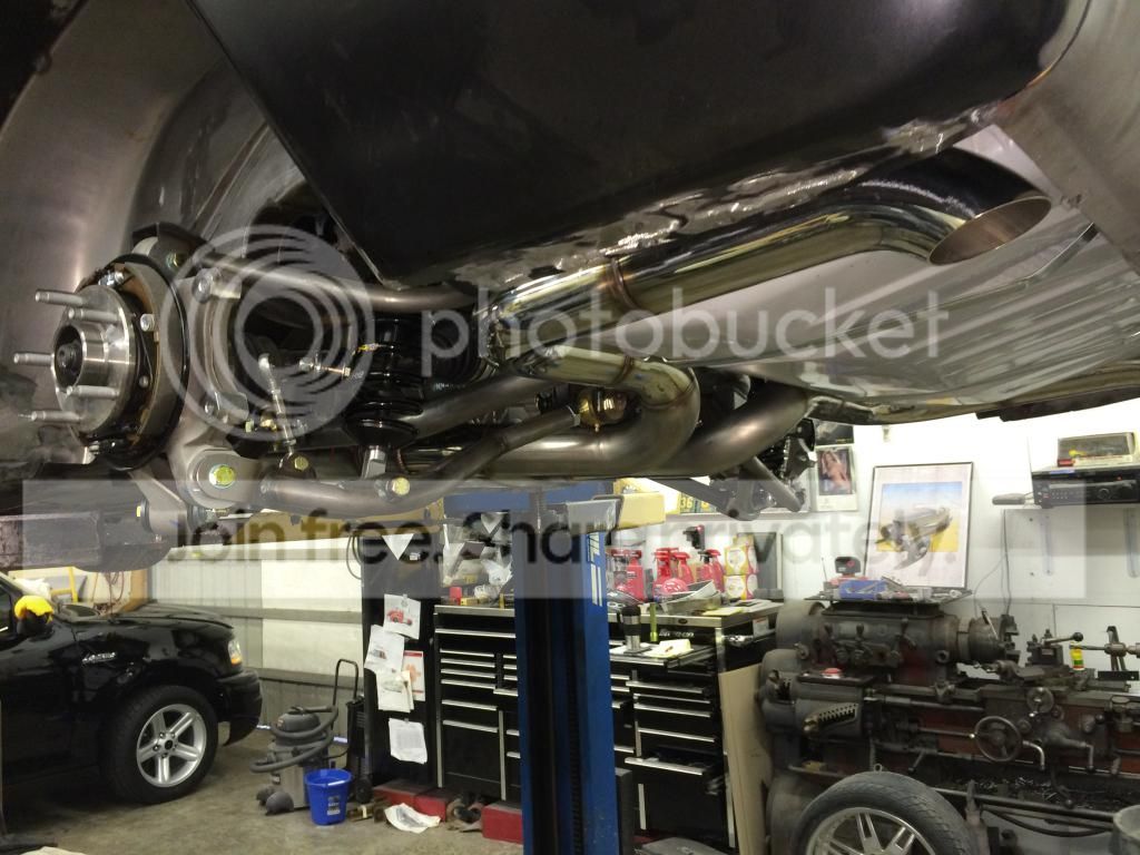

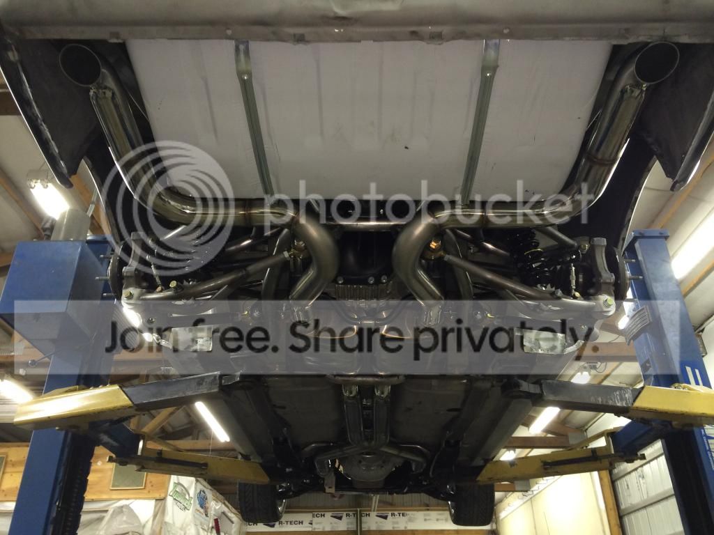

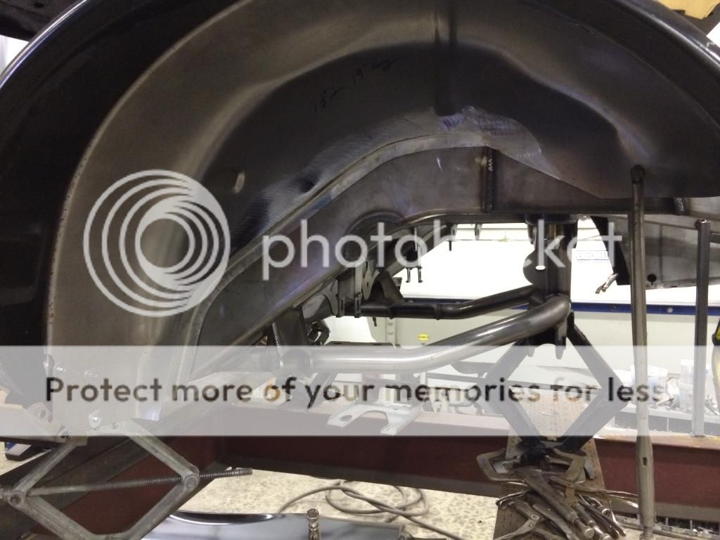

Here's a few pics of the rear suspension installed with the exhaust! There's a lot going on under this car!
http://i461.photobucket.com/albums/q...5EE43DB97C.jpg
http://i461.photobucket.com/albums/q...DDCF258911.jpg
http://i461.photobucket.com/albums/q...3B30FF7AEB.jpg
We're working on the fuel and brakes lines next...

waynieZ 12-12-2014 09:54 AM
I like the way you routed the exhaust, Beautiful work on the whole car.

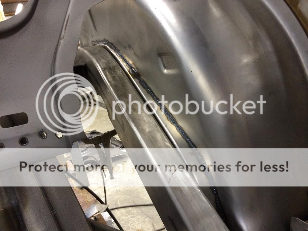

J-Rod&Custom 01-20-2015 06:00 PM
We have most of the Fab work done on the Camaro... We decided to clean up the bumpers a bit...
The rear got sucked into the car 3/4", narrowed 1 1/4", and the sides shortened 2". We have a nice 1/8" gap on everything now...

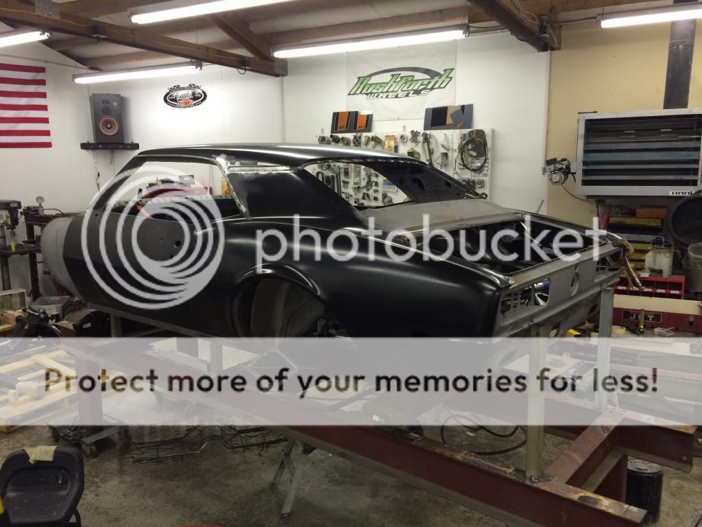

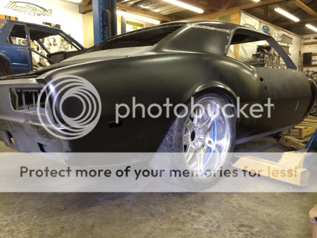

We have been busy in the shop!!!
The Camaro is progressing well, we hope to have it in primer in the next few weeks!

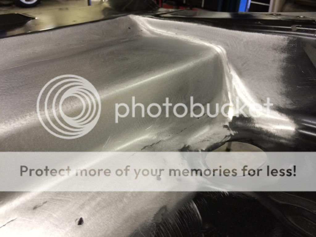

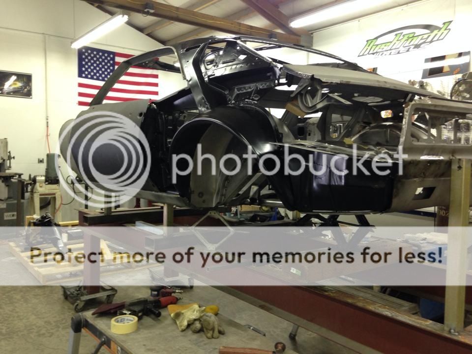

With all the Fab work done, we dropped it off to Northwest Powder Solutions again to have the body blasted before we start bodywork. http://i461.photobucket.com/albums/q...20822EB5BE.jpg

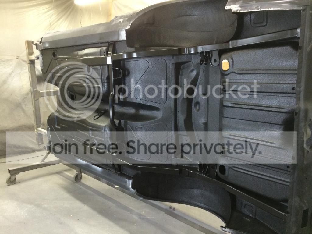

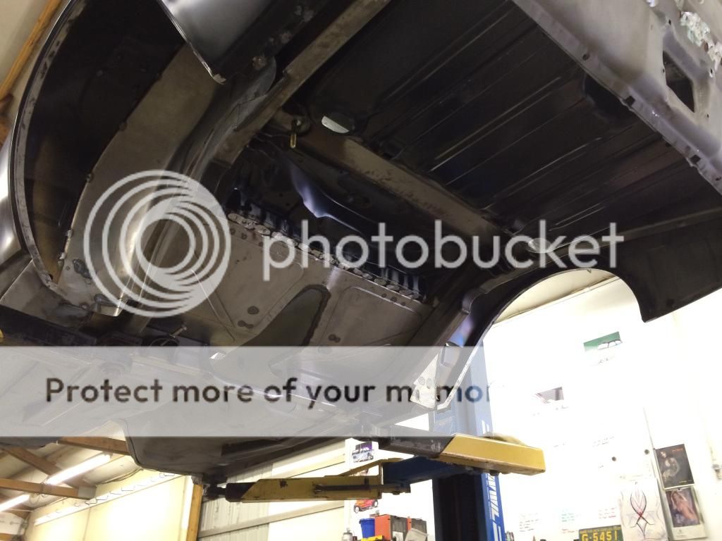

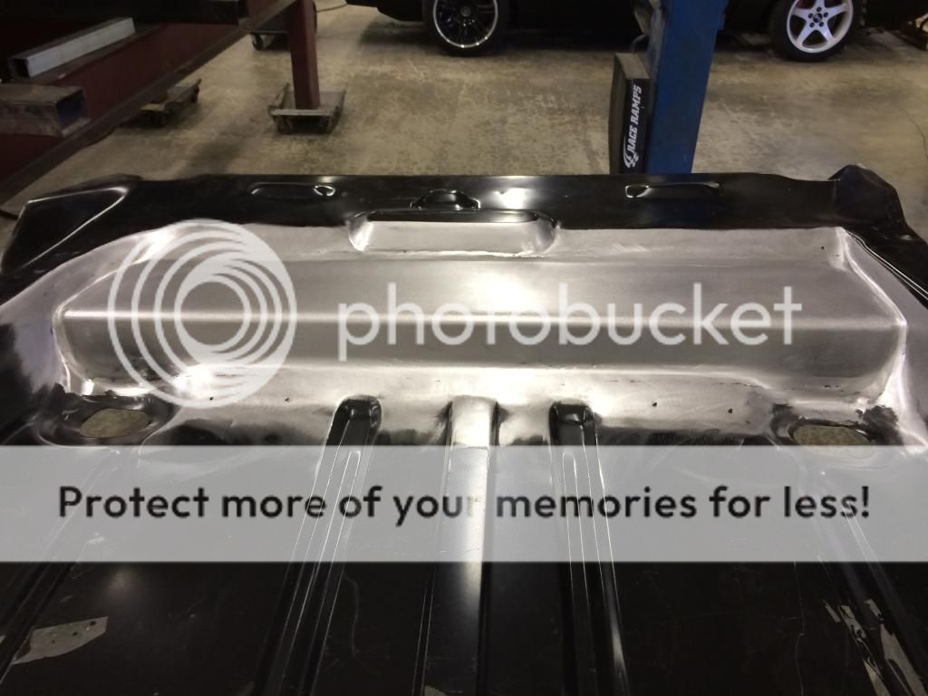

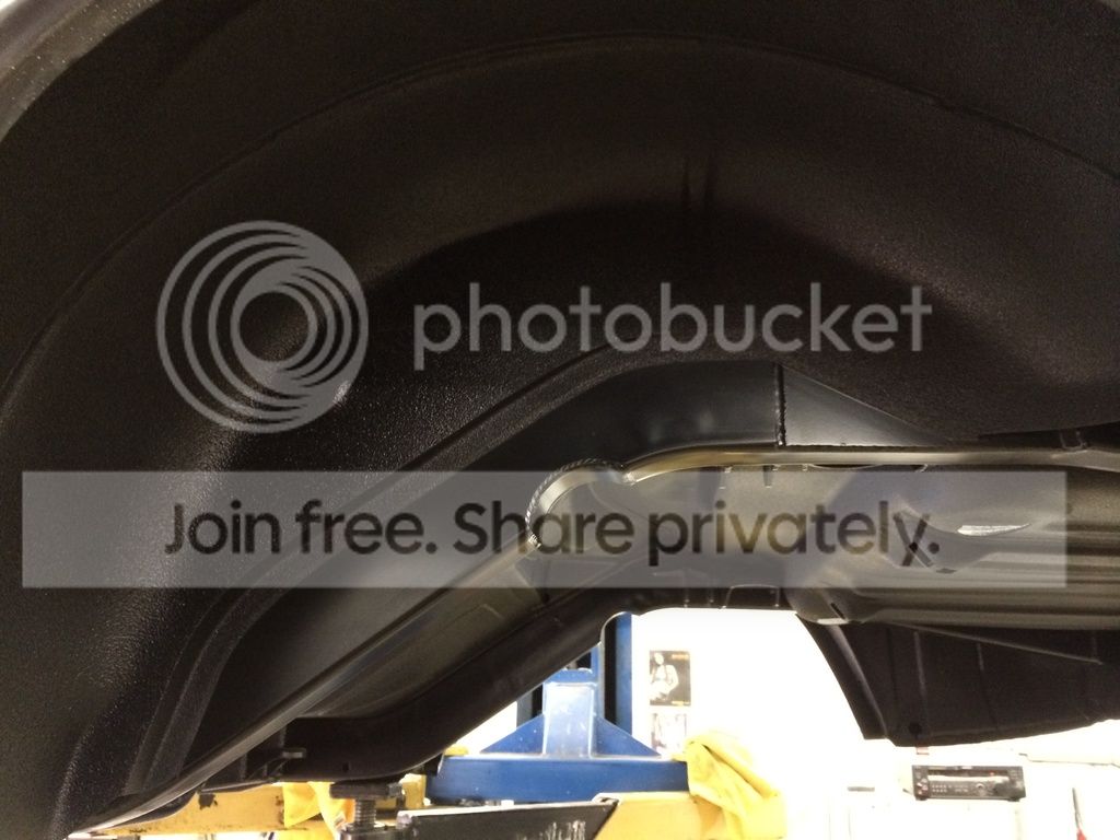

When we got it back, everything got sealed up and we started finishing the bottom and inside of the body. The frame rails got sprayed satin black then the floor inside and out got sprayed with bedliner.http://i461.photobucket.com/albums/q...23B135BEE0.jpg
http://i461.photobucket.com/albums/q...A9FF359DFC.jpg
http://i461.photobucket.com/albums/q...3B55508CE3.jpg
DOOM 03-20-2015 06:25 AM
