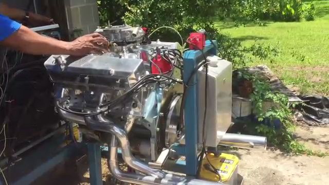

Here's a quick video of the engine running. Took the engine over to a friends shop, where I keep my engine test stand and we got it fired up. It has sit for several years after the dyno run so I wanted to make sure there were no surprises. Since I had to take it back out to rework the tunnel and since I haven't used my stand in quite a while I figured why not? My buddy get a lot of use out of it since he build race motors. lol.
Music to my ears!!!
It's back in the car as of last night. Now to put the tranny and driveshaft back in and on to wiring...

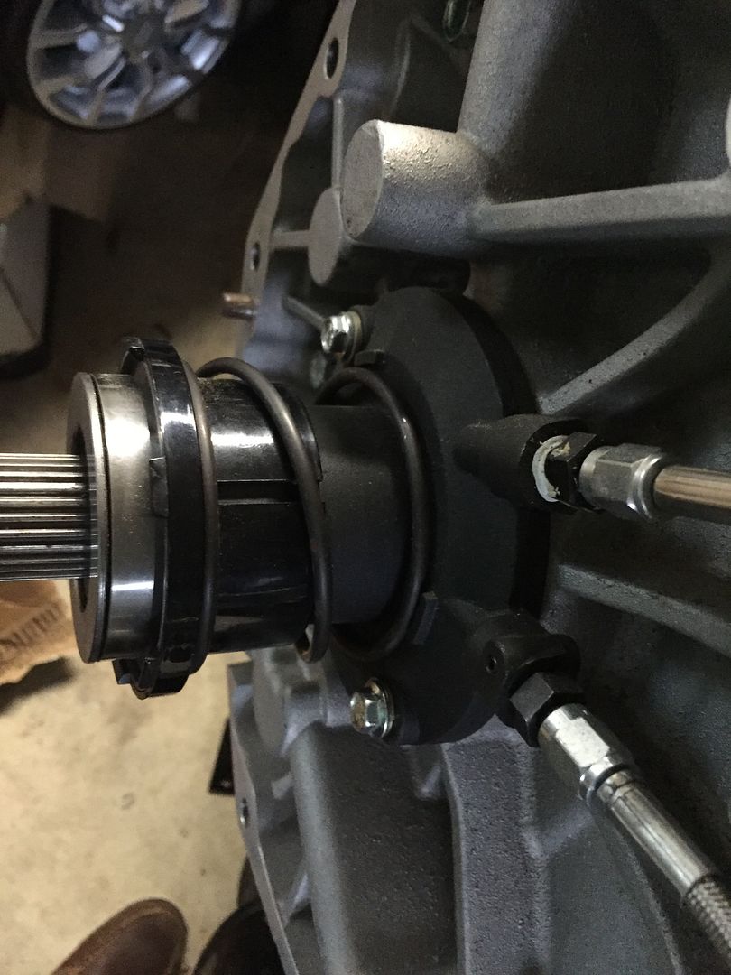

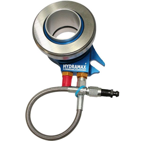

Sometimes it pays to take the car apart multiple times! American Powertrain didn't send throwout bearing shims with my kit, so I called them up back then and said.."what's up?" They were very accommodating and send a set immediately. The problem then became that the shims didn't fit. I looked at the instructions, scratched my head a bunch and then just realized there was no way they could fit the bearing I had so, I just set them aside and put the transmission in for the test fit. I thought to myself, this bearing has a spring on it so it must be self adjusting...but before I put it all back together for real, I need to check on this...
Now that I'm putting it all back together, I called American Powertrain to make sure I understood why this didn't fit per their detailed instructions. After a long discussion which ended up with me taking a picture of the bearing and emailing it during our conversation, AP realized someone packed a stock type T-56 hydraulic bearing in my kit instead of the Hydramax bearing. That was not going to work with this setup...
Stock type setup in this picture...
http://i213.photobucket.com/albums/c...psdxiusxgq.jpg
Hydramax in this picture.
http://i213.photobucket.com/albums/c...ps4qwemntx.jpg
As usual, they immediately sent the correct part out and it arrived last night. NOW, I can put the transmission back in the car.

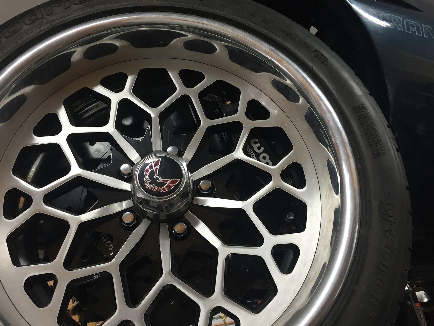

Making some more progress. Got the brakes worked out up front after shimming the caliper bracket out .280. Those calipers are VERY close to the front wheels as you can see in the pic but they are centered on the rotor.
http://i213.photobucket.com/albums/c...psyujwuocq.jpg
http://i213.photobucket.com/albums/c...ps5jhynn5p.jpg
I'll have to take a measurement but I'll bet a credit card wouldn't fit between those spokes and the caliper!
Even after all that I still have a problem. The valve stem now hits the top of the rotor. It's never easy. lol

Zoomin 07-25-2016 08:05 PM
Hate to hear about all the problems you're having with parts not working out or needing to be replaced. But on the other hand it's nice ce to know I'm not the only one.
I love those Wilwood hubs, it's a shame to cover them up.
And by the way, just ran a not the same issue with valve stem interference just this week....

What are you doing for your valve stems? Just the end is hitting so I'll get something shorter I hope that will work.
Zoomin 07-26-2016 11:36 AM
There's a couple options. One is a half-height stem which measures 3/4" from the outer wheel surface to the end.
Second is a button type valve which is a bump maybe 1/8" high which will definitely solve the problem but it's a pita to use. You have to unscrew the cap (button) and screw in a valve stem to adjust pressure. The screw in valve stems are small and are easy to misplace, but they do work.
Both are available at Jegs/Summit
Doug1 07-26-2016 12:18 PM
Looks like I need to take some measurements tonight on the valve stem. It Just clips the top of the caliper at the front and in the bar across the middle and again at the back, so slowly roating the tire I can hear three distinct clicks as it hit.
Working with Wilwood now and may go to a different caliper up front if I can work it out financially with them.

Ihad a similar problem with valve stem in Rushforths hitting calipers on 14" Baers. Luckily I checked before having tires mounted. I used the 3/4" metal valve stems. Think I got them from Speedway.

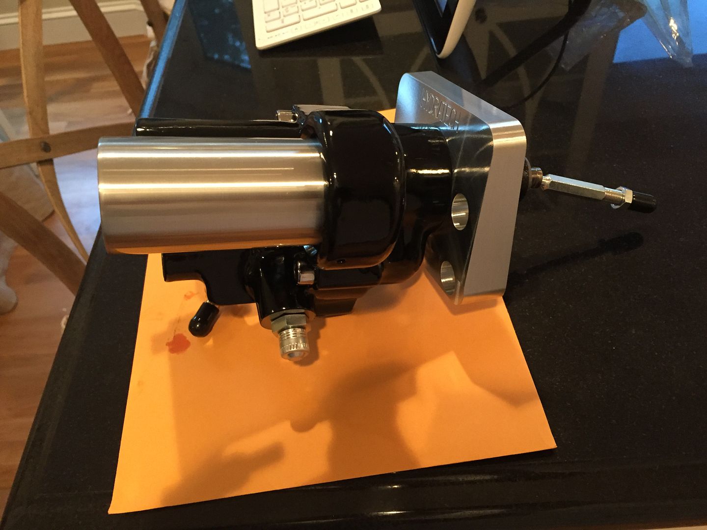

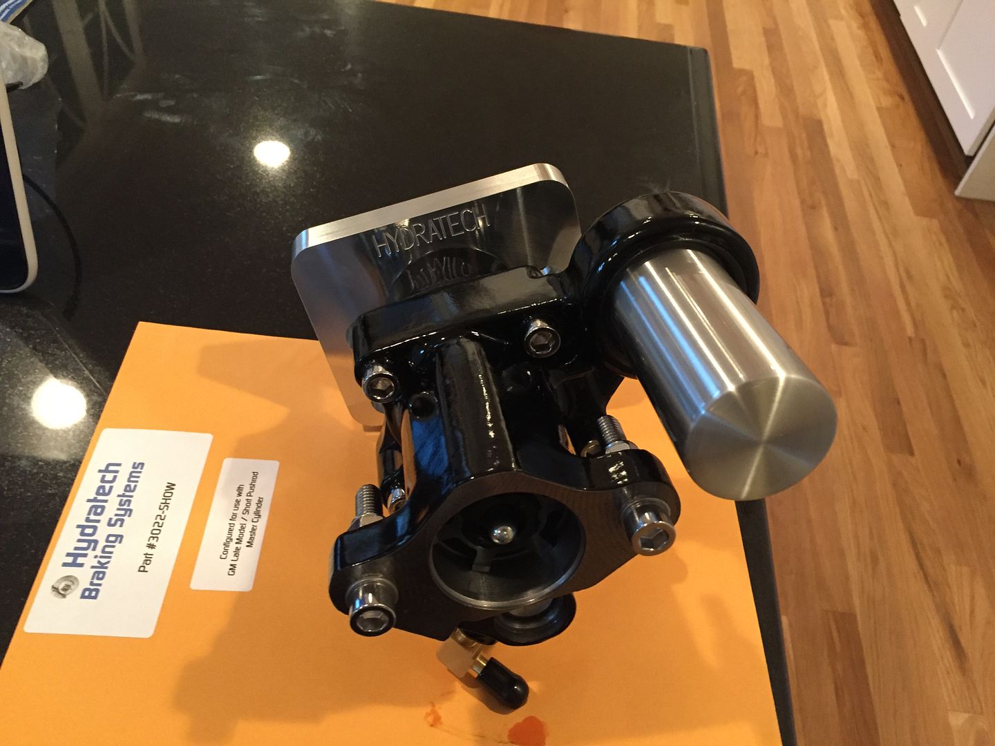

Doug1 10-05-2016 09:42 AM

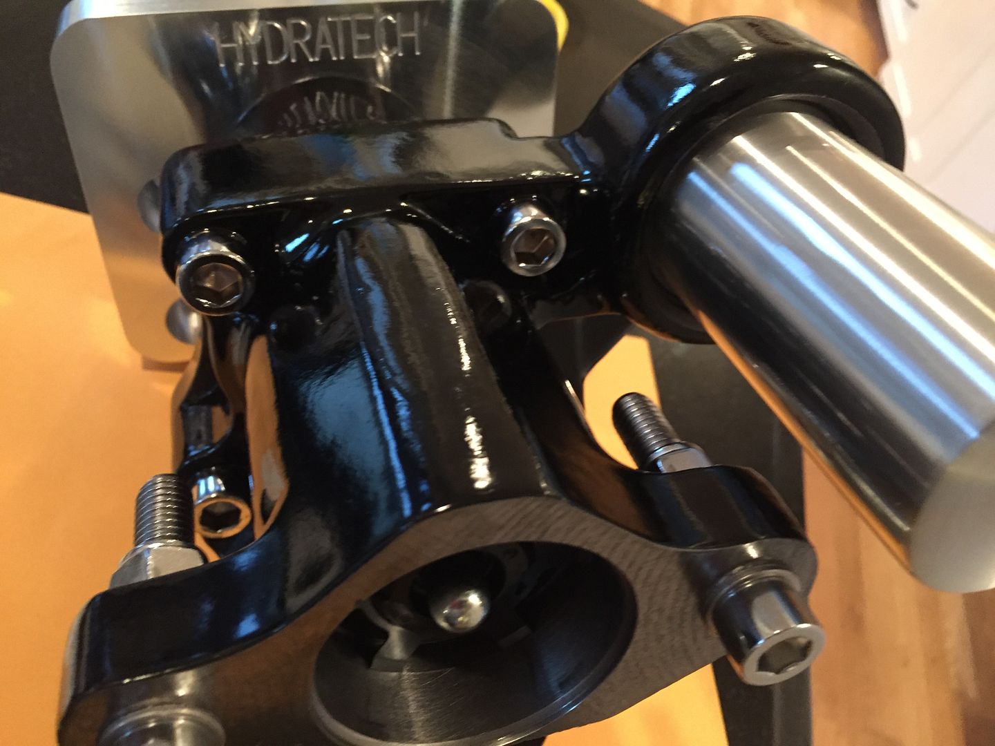

The Hydratech "show finish" kit finally arrived so now I can get to finishing the brakes.
http://i213.photobucket.com/albums/c...psb056as6w.jpg
http://i213.photobucket.com/albums/c...psdkjf0kdp.jpg
http://i213.photobucket.com/albums/c...pspv4cd0um.jpg
http://i213.photobucket.com/albums/c...psxusnvbvl.jpg

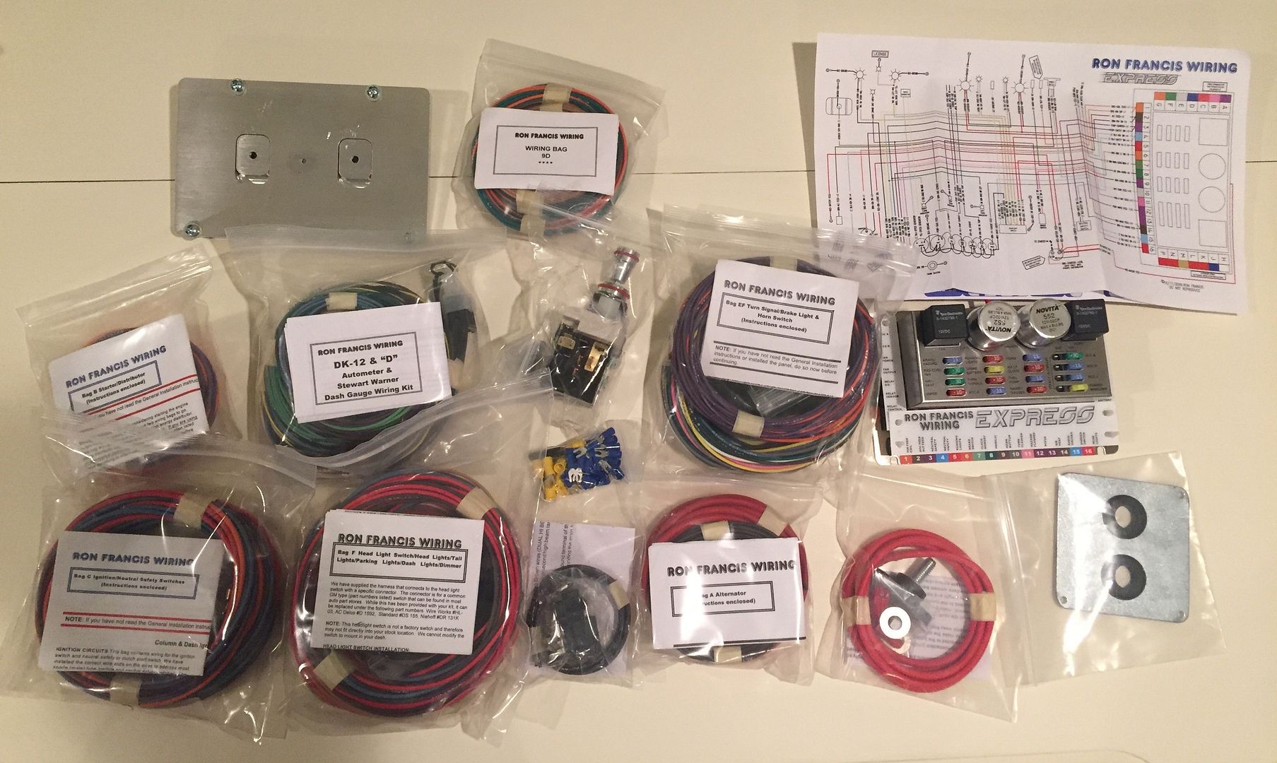

Made a little more progress, including getting the wiring ready to install. I ended up going with a Ron Francis harness that is being delivered today. I am going to mount it so that it drops down for service using a bracket they sell for that purpose.
I'll post more on that soon. In the meantime here are a few more photos to show progress...

The Ron Francis harness came in. Nice stuff from what I can see. Looks like some wiring this weekend!
http://i213.photobucket.com/albums/c...psqkhqtcde.jpg
