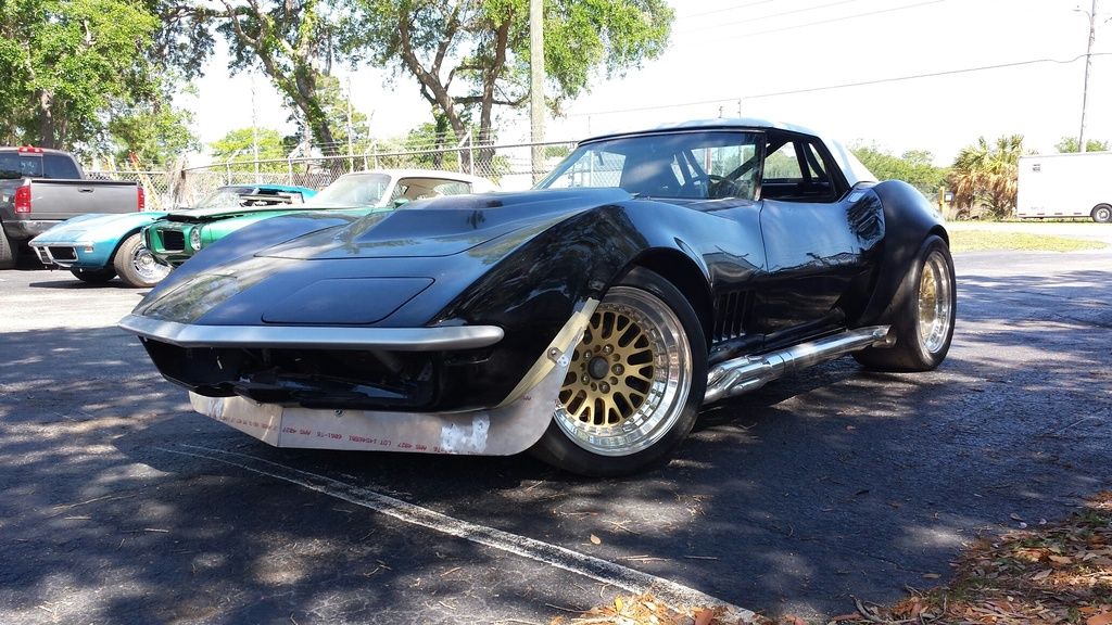

I was able to take a quick lap around the neighborhood today. I've been trying to knock some small stuff off the list before the car goes to the chassis shop next week.

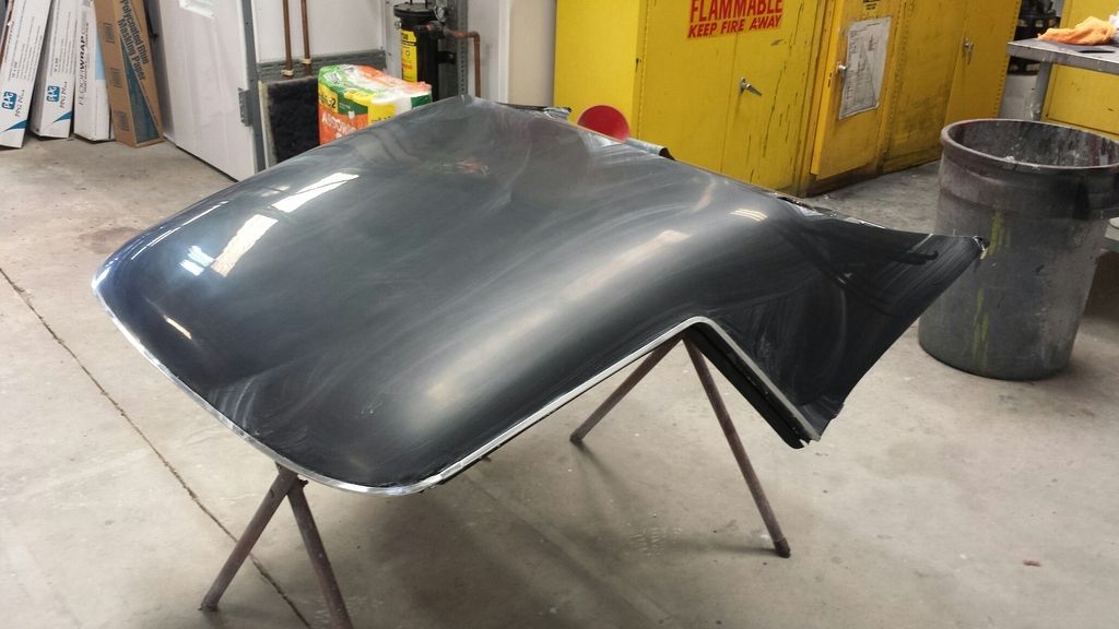

I took the car over to Tom Argue's shop today. Tom is going to do some misc. fabrication, paint the roll cage, and cut/buff the paint. I also found a suitable hard top for the car and it fit right up.

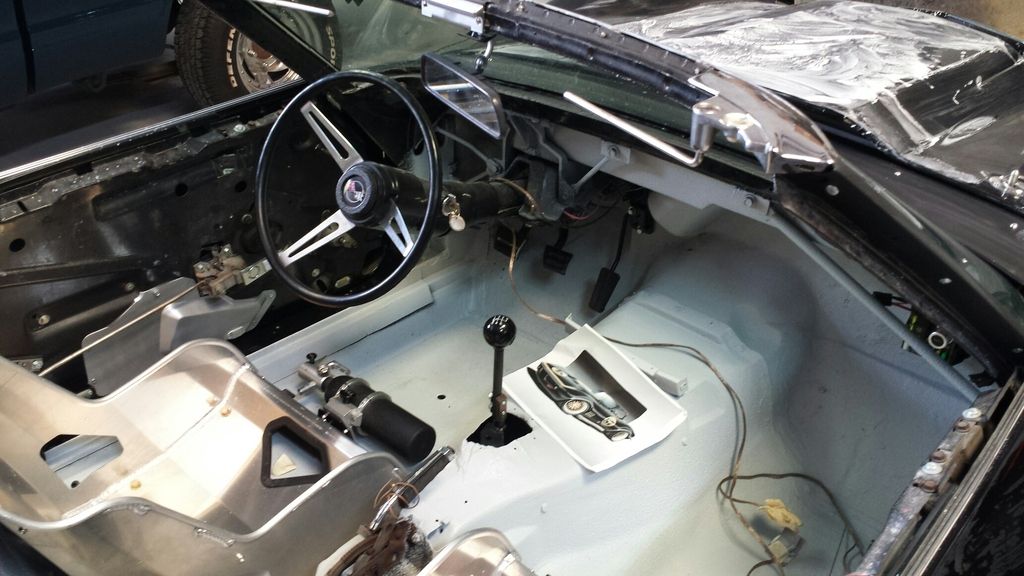

It's been a slow month on the build. I ran into scheduling issues with the chassis fab shop. I ended up having to use a different shop in order to keep the project moving. The car is now scheduled to go to Pro Fab Performance next week for the cage work. The car will then go back to Tom Argue for paint work and a few misc. items. I did receive my gauges from SpeedHut. I went with their Legacy Series. I was also able to mock up the center cluster with gauges and switch panel but it still needs to be painted.

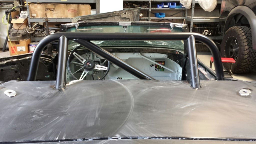

Neil B 02-26-2016 06:26 AM
Chassis work is finally underway. I was able to get the car over to Pro Fab Performance in Port Richey this week. They fitted the main hoop and we finalized the seat position yesterday.
http://i162.photobucket.com/albums/t...srvuihfv4.jpeg
http://i162.photobucket.com/albums/t...s0hxcsgrh.jpeg
http://i162.photobucket.com/albums/t...szi4hfwzt.jpeg

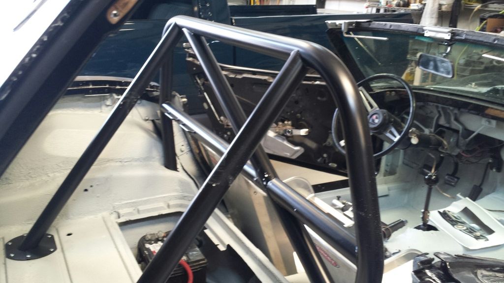

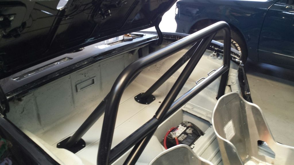

Neil B 03-01-2016 03:29 PM

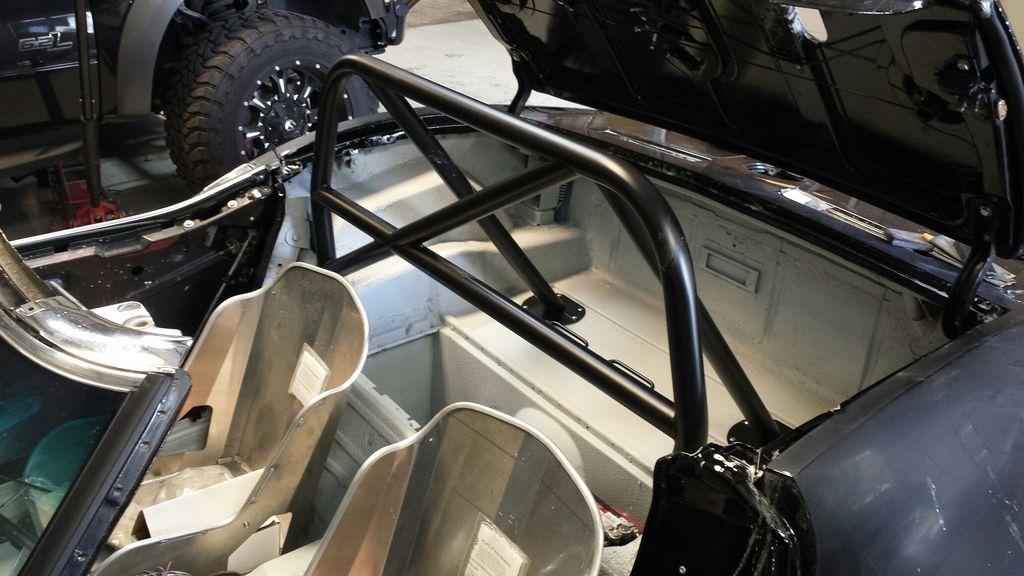

Pro Fab Performance completed the cage today and I am very pleased with the result. The car is now back at Tom Argue's to paint the cage and hard top, cut/buff, etc.
http://i162.photobucket.com/albums/t...sby39qtvv.jpeg
http://i162.photobucket.com/albums/t...s4vjhdhxq.jpeg
http://i162.photobucket.com/albums/t...sruzmlkg7.jpeg
http://i162.photobucket.com/albums/t...sltfiva33.jpeg
http://i162.photobucket.com/albums/t...sdbt0hvot.jpeg
http://i162.photobucket.com/albums/t...sbn8sy8to.jpeg
http://i162.photobucket.com/albums/t...sgm1v3zmd.jpeg

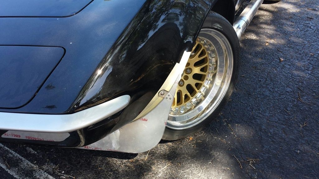

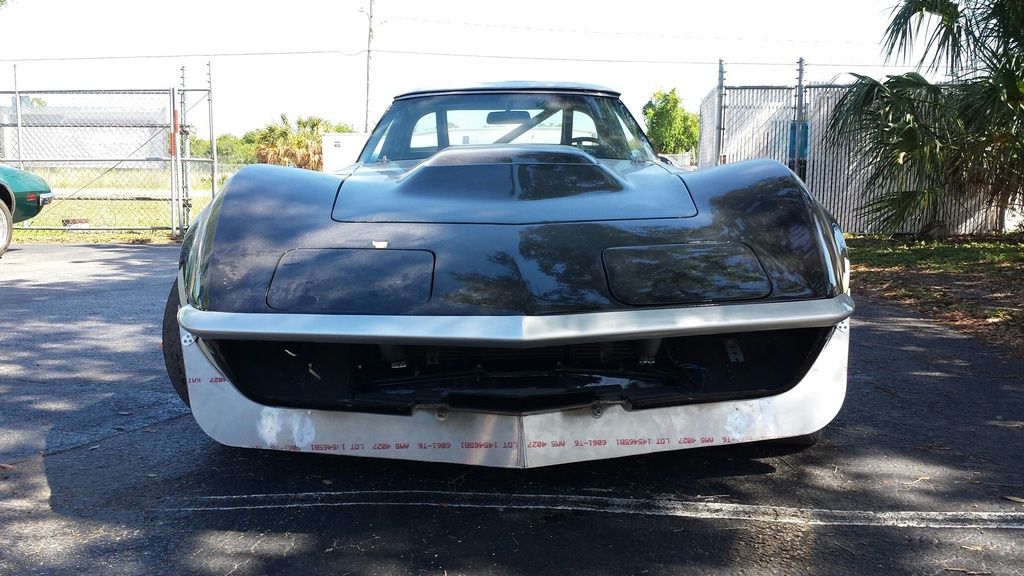

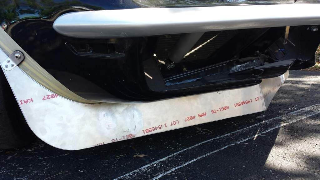

Fabricated front spoiler:
http://i162.photobucket.com/albums/t...slclf5lyt.jpeg
http://i162.photobucket.com/albums/t...sjo3ml7bj.jpeg
http://i162.photobucket.com/albums/t...smzrmrglz.jpeg
http://i162.photobucket.com/albums/t...shwqjiioa.jpeg

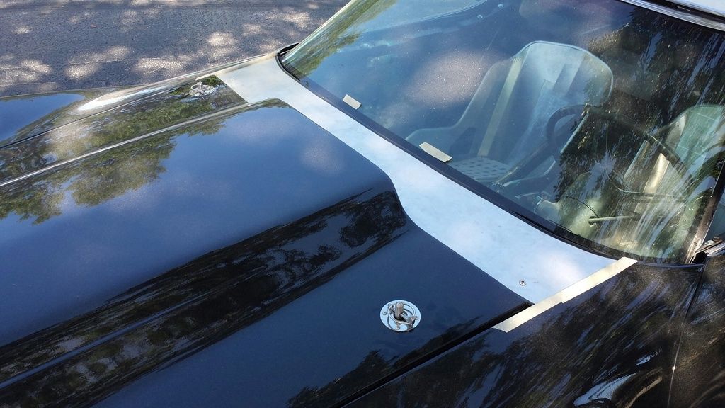

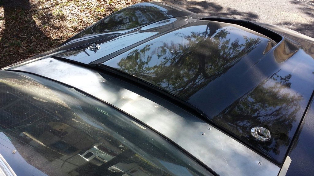

Hood pins and custom wiper closeout panel:
http://i162.photobucket.com/albums/t...shkc0odbu.jpeg
http://i162.photobucket.com/albums/t...sfedstp6d.jpeg

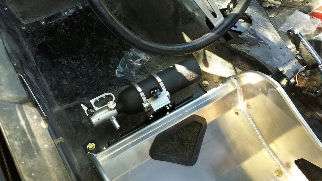

Halon Fire Extinguisher mount:
http://i162.photobucket.com/albums/t...sdwg657ns.jpeg

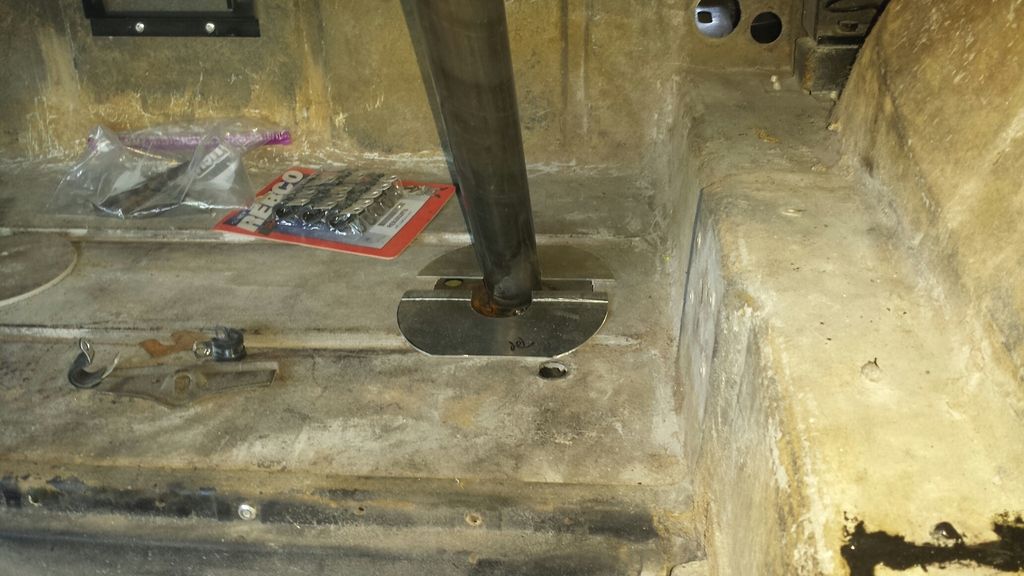

Plates to seal the cage mounting points:
http://i162.photobucket.com/albums/t...sia3ewzzq.jpeg

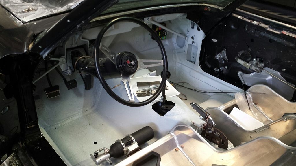

Interior finished in light grey bedliner.
http://i162.photobucket.com/albums/t...snrsug0it.jpeg
http://i162.photobucket.com/albums/t...s06bpjlcc.jpeg
