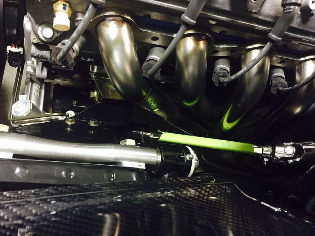

So its been awhile since any updates and a lot has got done. My transmission showed up from American Powertrain and was able to get bolted up with engine. I also ordered the LS swap headers from Kooks and was hope full they worked with the DSE frame. I really wanted an 17/8" primary tube but couldn't bring myself to the $2200 DSE ones. I was really happy to find out they fit perfect!

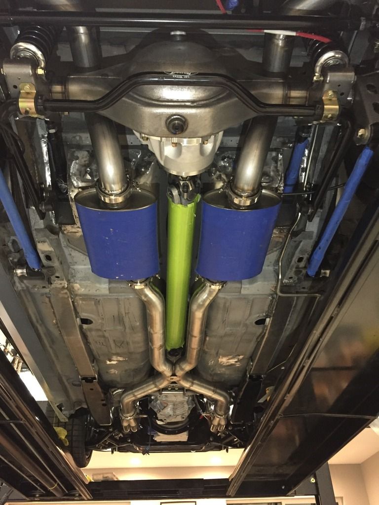

So I decided to remove the ball flange and install 3" V band clamps. Also ordered a cross over pipe and cross member from B&B very nice pieces.
http://i76.photobucket.com/albums/j2...ps7hicoefz.jpg
http://i76.photobucket.com/albums/j2...pszjxlle6n.jpg
Here is a shot of the pass side showing header clearance
http://i76.photobucket.com/albums/j2...psglfyimqy.jpg

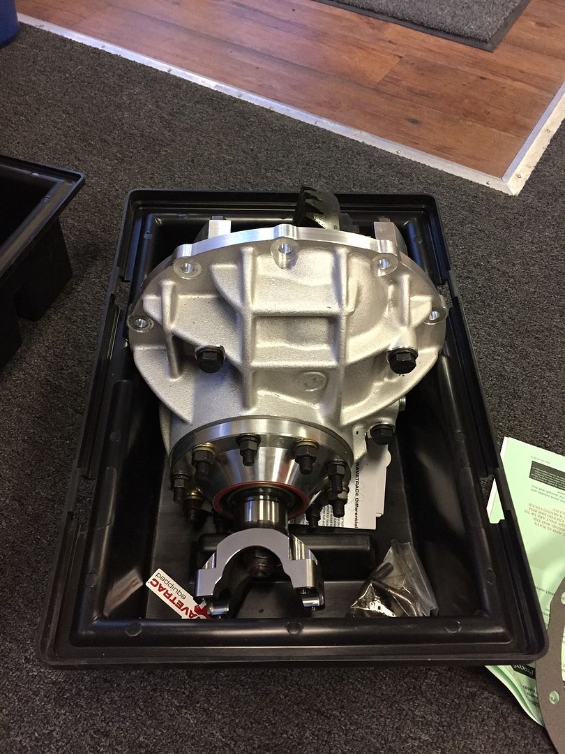

Very excited my third member showed up so now I can order my drive shaft and start exhaust. I went with 3.90 and the Wavetrac posi unit. Talking to a few guys running autocross the 3.73 was a bit tall in 2nd gear so hopefully this will be overall a good ratio.
http://i76.photobucket.com/albums/j2...psjdhinh9m.jpg

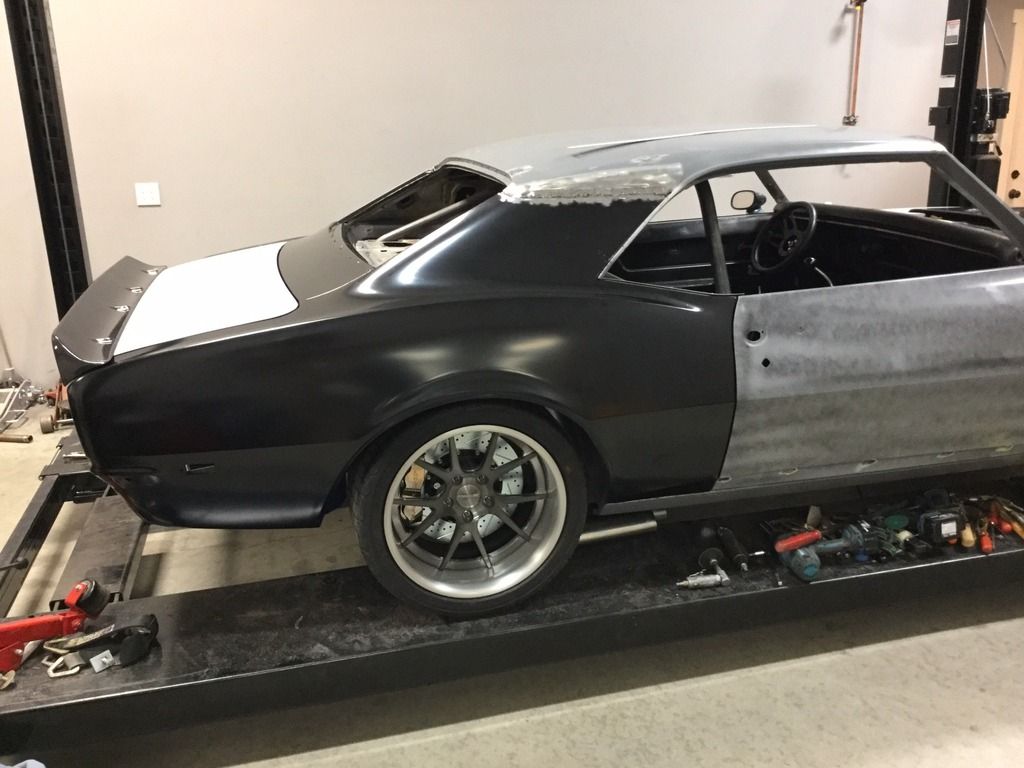

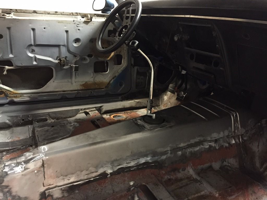

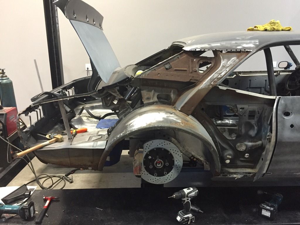

So it's been awhile since I've updated on here. I have got a ton of things getting checked off my list! First I was just going to patch the passenger side quarter panel then the more I looked at it I decided to change it out completely. Amazing how you do the second one twice as fast. The amd sheet metal is really a step up from the crap that was being produced by other companies. So as far as sheet metal all I have left is some gaping on quarter to trunk and trying to get the anvil carbon hood to line up the best I can. After I got the quarter done I moved onto raising up the trans tunnel to clear the T56 and bell housing. I used the tunnel kit from B&B very nice to start with btw. A lot of in and out and trimming before I could weld in place. http://i76.photobucket.com/albums/j2...pstfpt9tz5.jpg
http://i76.photobucket.com/albums/j2...pshngoxi4p.jpg
And yes I got all rust cleaned and epoxy primed and weld thru primed! I don't ever want to this again.
http://i76.photobucket.com/albums/j2...ps3u1vqjoi.jpg

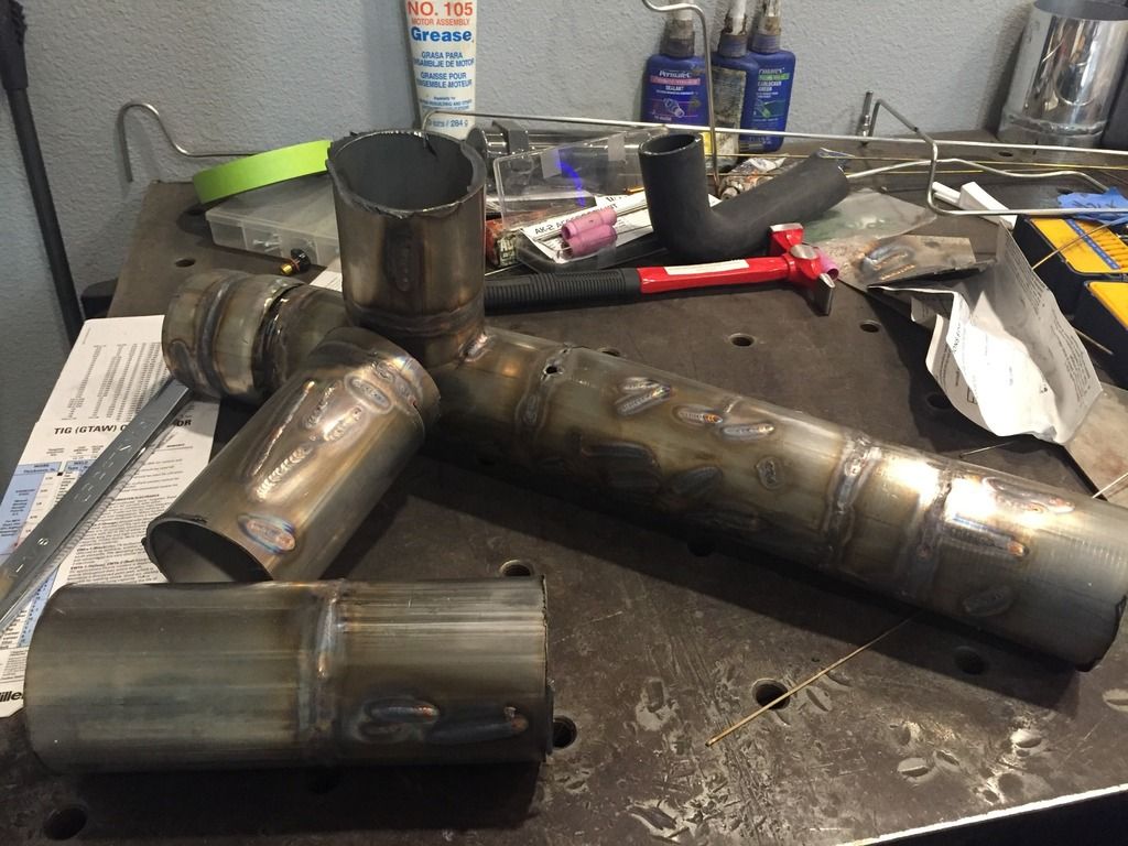

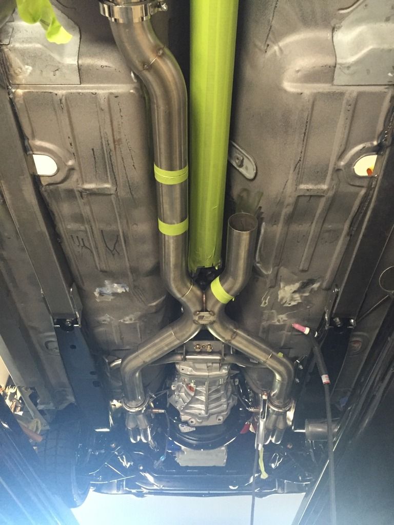

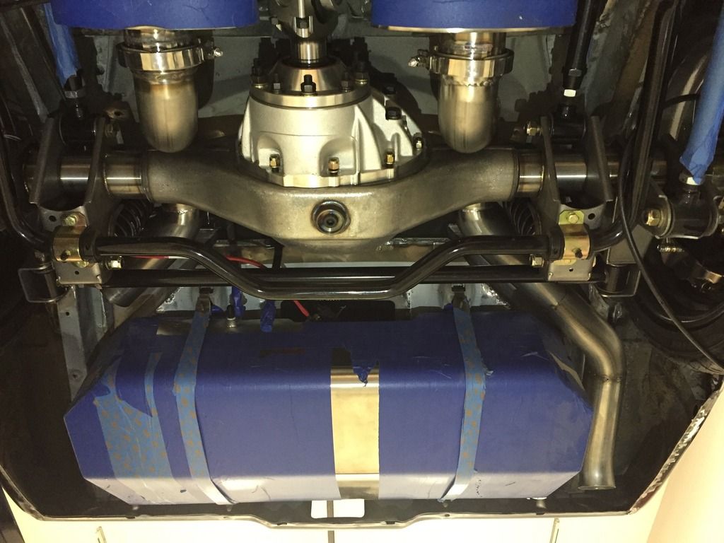

Ok so I thought that the quarters were a bitch..... Well let's just say the exhaust was close to 40hrs of burnt hands,flash burn,2 band saw blades,15 cut off wheels and more four letter words then you can imagine. But after all that I'm pleased with the way it came out.
http://i76.photobucket.com/albums/j2...ps5tz1kmb6.jpg
http://i76.photobucket.com/albums/j2...psmnmdzlbc.jpg
http://i76.photobucket.com/albums/j2...pstk78dqna.jpg

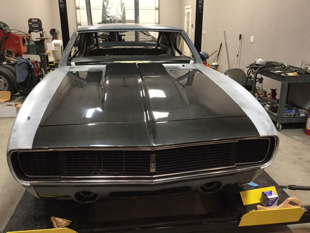

I'm hoping I can heat up the hood on passenger side corner to get it down a bit otherwise it's getting some Ring Bros hood pins or cut in some aero latches.
http://i76.photobucket.com/albums/j2...psh1mh9dig.jpg

Thanks! I used the Stainless Works rod builder kit and a set of the Borla mufflers and Summit 3" v band clamps. Before I started welding it up I practiced a lot and still not a pro by any means!
http://i76.photobucket.com/albums/j2...psxxuzsrk5.jpg

I agree. I think just getting everything tacked and lots of small welds is best approach. This material can move around a lot. Also lots of small cuts and a ton of patience. If you don't have a band saw a recommend getting one I got a cheep harbor freight one and put a good lennox blade and worked perfect. Also for the extra $ put the v band clamps on I like having it come apart separate pieces. Now if I can just find a painter I will be set!
