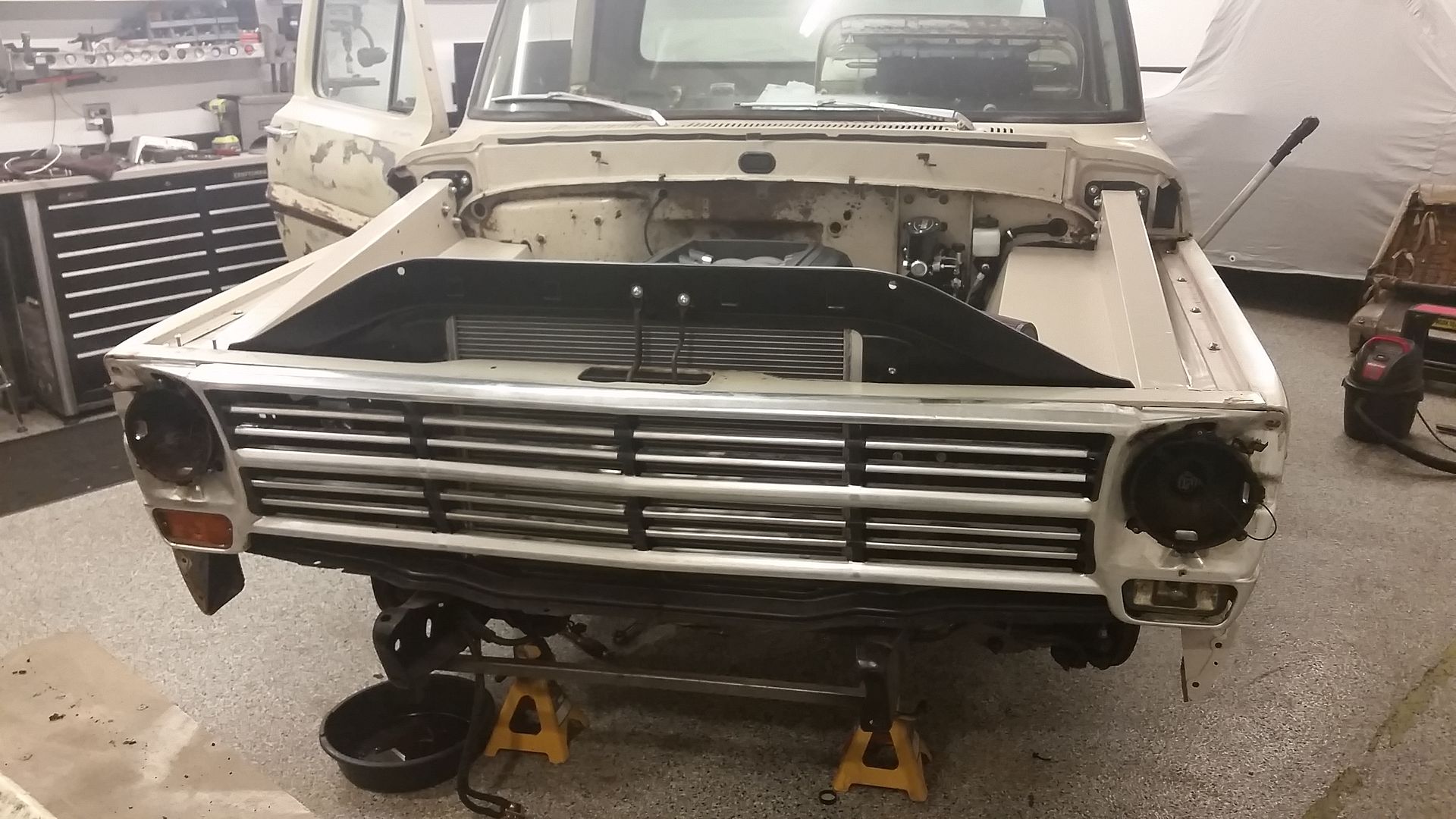

I picked up these lights a while back and was excited to get them in the truck. I have run them on several other cars and they are awesome. Replaceable H4 bulbs and excellent beam pattern.
http://i1133.photobucket.com/albums/...pscazdgvcc.jpg
Spent a little bit of time cleaning up the bezels, they still look like ass, but less dirty and cloudy now.
http://i1133.photobucket.com/albums/...ps1agqrtja.jpg
Went to put the bumper on and things up front might not be perfect. It took a little work with the porta power to push out the frame horn to get things to bolt together but I got it. I have a little more work to do to get things straight and square but pretty sure I can get it there.
http://i1133.photobucket.com/albums/...psrma7o1kh.jpg
And hot damn look at that, I have a frontend of an actual truck, It actually looks pretty good. I feel like you can tell even from the outside that there is more than just an old farm truck here.
http://i1133.photobucket.com/albums/...pszfawz1y7.jpg

hackster 02-01-2016 09:08 AM
Got the seatbelt for the drivers side all installed, bolted in the seat for temporary and checked it all out. With the stock foams int he seats they are very comfortable. Great seating position and easy pedal operation.
Got the hood on it and tried to line it up but the hood is pretty messsed up from opening going down the freeway sometime in its life.
Had a little bit of help from some friends and figured out why the speedometer was non operational. Turns out the information I got from Ford Racing was wrong and I had two of the wires on the sender backwards. He is a full time tech and we pulled up the wiring diagram from All Data.....It was awesome.
Swapped the two wires back and forth on the connector and Voila....working speedometer.
Now onto the bad news.
I have a noise in the engine that we are unable to locate. It sounds like spark knock or pinging but it sounds pretty mechanical sometimes as well. I pulled the pan a while back and inspected and there was nothing in there. I also did an oil change after running for a couple hours or so and there was nothing in there either.
So I needed to dig further to find said noise....its not healthy.
Pulled Passenger side cam cover to inspect.
http://i1133.photobucket.com/albums/...pstfwl2cdk.jpg
http://i1133.photobucket.com/albums/...ps7yajhrwl.jpg
http://i1133.photobucket.com/albums/...pslvc3fqup.jpg
I do not see anything wrong on anything that I opened up. The top end on this thing looks like its brand new but I am not a Ford trained technician.
I think it sounds like timing chain to me. The only thing I did see was some whitness marks on the backside of the timing chain that indicate its been running against some plastic, dark colored like black or dark brown. I am wondering if I have a chain guide/tensioner issue but am not too sure how to tell if I do or not.
Oil pressure is excellent 100 psi at startup and around 40 at a hot idle.
Could be spark knock because of the no cats, open exhaust and open element air filter...could be mechanical issues I have no idea at this point.
Any input? Its almost impossible to get video of it since it has to be running and driving.
Pretty sure at this point that I am not going to make Thunder Hill, I just am running out of time to do it all.
Super Bummed out.
Sean
