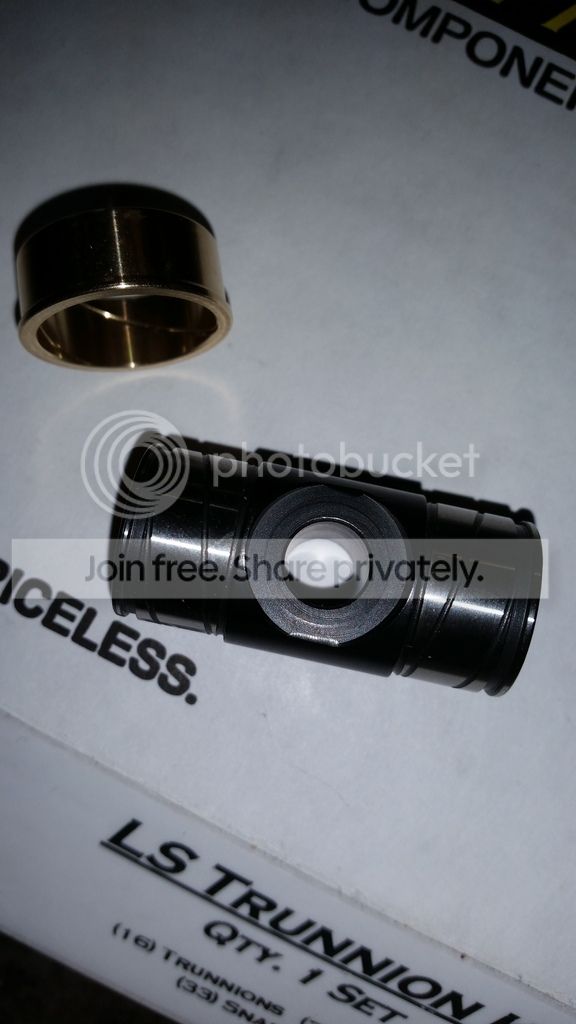

71RS/SS396 12-13-2016 04:19 AM
CHE bushing and shaft

samckitt 12-13-2016 06:05 AM
Originally Posted by 71RS/SS396 (Post 650459)
I have an blown up engine in the shop (we didn't build it) that I think died a slow death from all of the fairy dust being sent through it from the needle bearing upgrade. This engine had a mild performance cam with .600 lift, it had 12,500 miles on it.
Here's one of the trunion shafts out of the engine
That's exactly what I want to avoid.
samckitt 12-13-2016 06:08 AM
Originally Posted by 71RS/SS396 (Post 650482)
Looks like the bushing has a spiral groove too.
kevin_l 12-13-2016 11:02 AM
New or used?
71RS/SS396 12-13-2016 02:57 PM
Originally Posted by kevin_l (Post 650508)
New or used?
The ones in pic are new, I was just showing what they look like.
