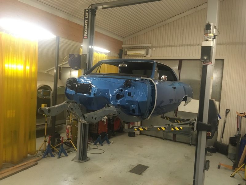

warhawkchevelle 12-04-2017 11:17 AM
Long time no see 😁
http://i88.photobucket.com/albums/k1...B8335191D.jpeg
Sprayed with Raptor-Liner
http://i88.photobucket.com/albums/k1...31713F7666.jpg
Seam-welding the frame completely.
http://i88.photobucket.com/albums/k1...6A79548F76.jpg
Testfitted the frame with alu bodymounts, fits good.
http://i88.photobucket.com/albums/k1...6966AC999A.jpg
Will build a new rear crossmember with a trailer hitch.
I have also ordered Baer brakes 14” with 6 piston calipers around.
Moser alu thirdmember with 4:11 and wavetrack differential.
Ron Davis radiator.
Hoping to receive suspensionparts before christmas vacation so I can finish frame modifications.
Will be better to update if someone is interested 😁

warhawkchevelle 12-15-2017 10:40 PM
Well, it doesnt look like I am receiving suspension parts in time for Christmas.
Speedtech delivered those parts in June I think, a Buddy of mine who ships container fell ill. So I told him to focus on health.
Found another shipper a while back which took over, but when you ship by boat it can easily get delayed.
Been superbusy at work, I install sprinklersystems and it has been total chaos last six months. So I am away from home and garage monday to thursdays, fridays I work at my dads mechanical industry so not much time over.
http://i88.photobucket.com/albums/k1...2B2BA40153.jpg
I atleast cut off rear crossmember yesterday.
http://i88.photobucket.com/albums/k1...3779565D6F.jpg
http://i88.photobucket.com/albums/k1...0C93B945CF.jpg
http://i88.photobucket.com/albums/k1...2D74E0B4AD.jpg
Cut some 3mm steel and bent them for a new 50x80mm rear crossmember.
We have a small version of dragweek here in Sweden called streetweek so I really need that hitch plus I like to go on caravan-trips :)
