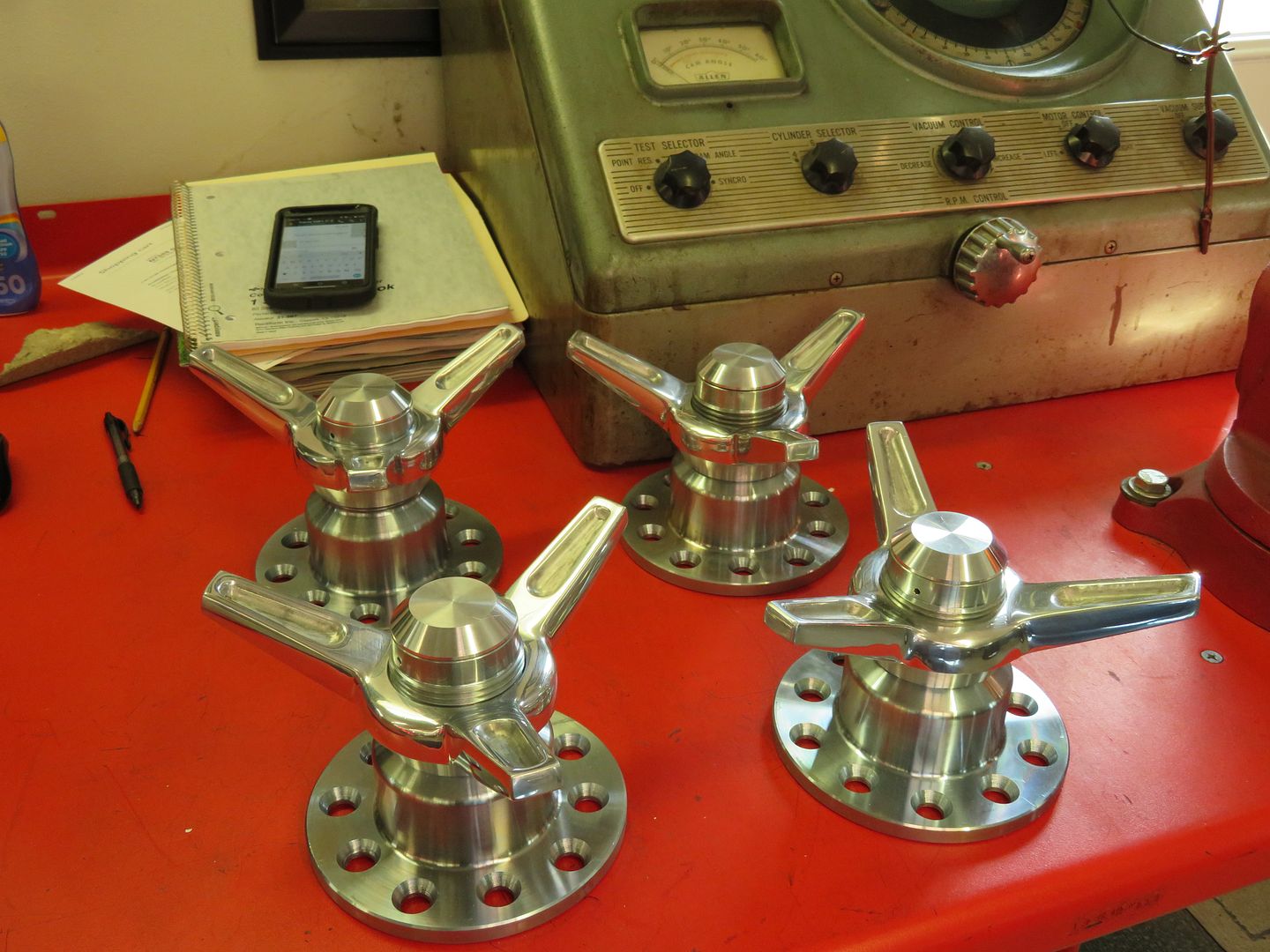

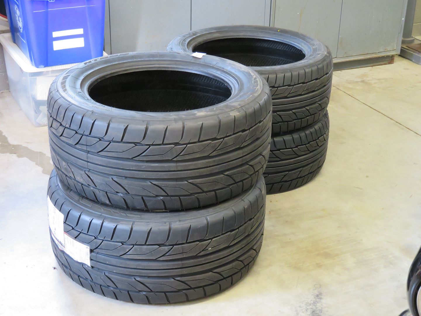

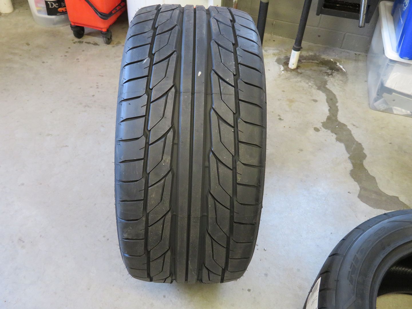

Still waiting on wheels. Tires came in as did the adapters for the wheels.
http://i1043.photobucket.com/albums/...psrx8skbwd.jpg
http://i1043.photobucket.com/albums/...ps5ivecaqz.jpg
http://i1043.photobucket.com/albums/...psxsd3nibk.jpg
214Chevy 04-02-2018 05:27 AM
Originally Posted by NAPA 68 (Post 674126)
Sweet knock-offs!! :bow::bow: What brand of wheels are those you'll be running?
NAPA 68 04-03-2018 05:39 AM
From these guys here................
http://vintagewheelsus.com/index.php...21e21953868c32
I have since found out they sublet the wheel work to someone else. I must admit, they have been good to deal with.
Tim

Nice on the powder coat!
Plus those knock off wheels are cool.
