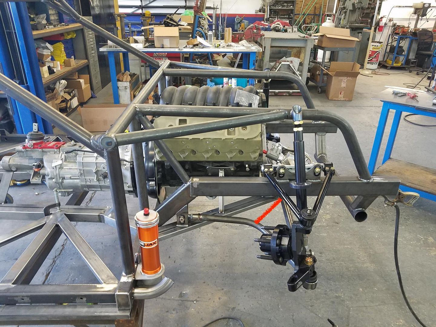

Hey Greg, maybe you know or Blake. What was the purpose of the independent links? How does it differ than having a one piece lower?
Seems a simple tube tying the two links together would solve the issue, but there must be a reason they don't?
https://i1060.photobucket.com/albums...psddql698j.jpg

Maybe Sutton ISN’T a suspension designer after all..... LOL

The way it is set up when you adjust the caster by lengthening the rear bent tube it pivots on the joint that is out at the ball joint so it needs to be independent or it will just bind.
