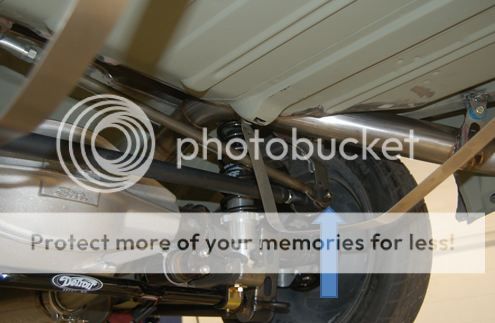

Stielow 12-26-2012 10:56 AM
Originally Posted by ratman67 (Post 453545)
mark can you post pics of these mods....pretty please...thx in advance, rm
I wrap 1/8 inch plate around the stock '69 frame rails and tie into the DSE cross car channel.
I add a brace to reinforce the pan hard DSE mount.
I also add a tube from the rear roll bar tube to above where the shock mounts
http://i439.photobucket.com/albums/q...ps44978522.jpg
http://i439.photobucket.com/albums/q...psb766478b.jpg
http://i439.photobucket.com/albums/q...ps29bc4b84.jpg
