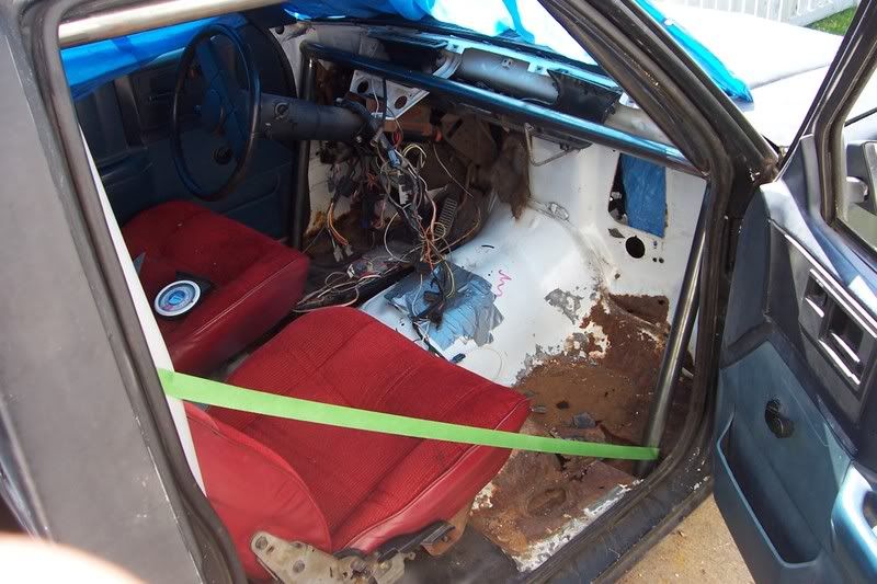

badmatt 10-15-2008 10:29 AM
dont midn the rust...
but heres a pic of how i layed mine out for 8.50 legal.. (converting to a 25.5)
this is an Sonoma, small truck but TONS of room
http://img.photobucket.com/albums/v3...t/100_1447.jpg
seriously dont mind the rust haha.
