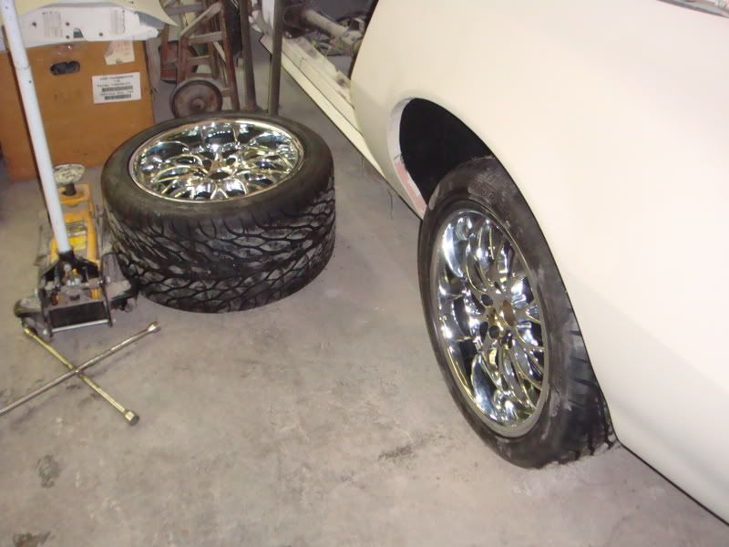

10Seconds 10-04-2008 04:14 PM

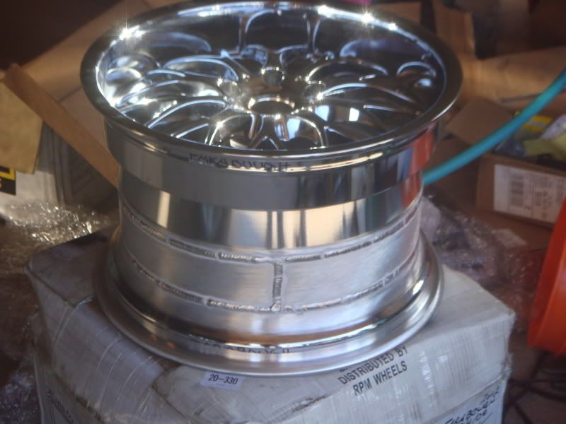

Progress has been slow, but it is being made. I finally got some wheels and had the rears widened so I am running 18x9.5's on the front and 18x12's on the back.
Here is a picture of the wheels after I widened the rears.
http://i168.photobucket.com/albums/u...A/DSC00363.jpg

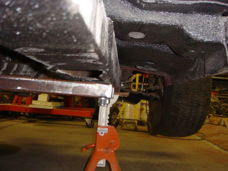

For the street I will be using these wheels and BFG 335/30 rubber. Here is a mounted picture:
http://i168.photobucket.com/albums/u...A/DSC00371.jpg
And another:
http://i168.photobucket.com/albums/u...A/DSC00367.jpg

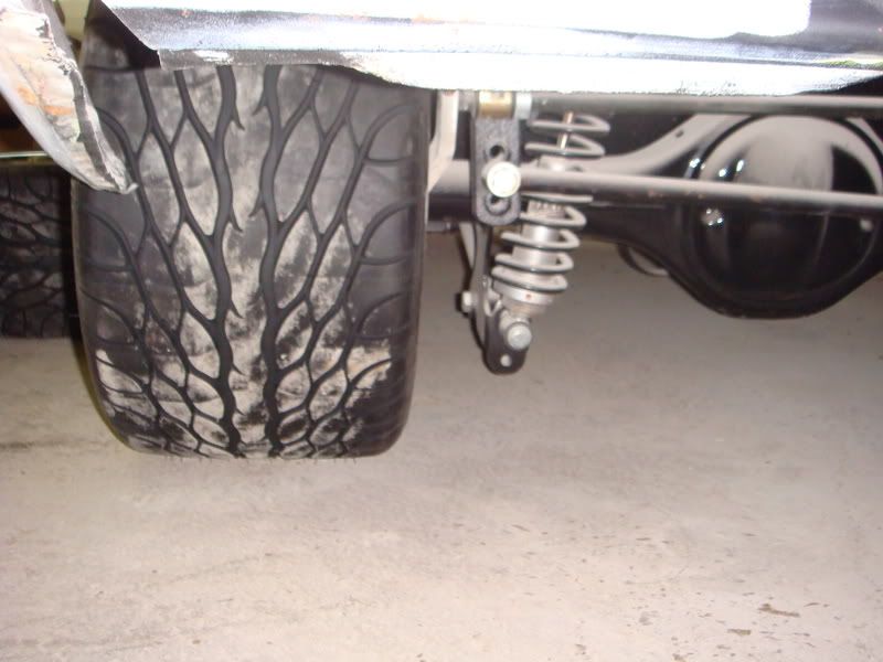

Obviously the suspension is jacked up right now, thats not going to be ride height.
And from the rear:
http://i168.photobucket.com/albums/u...A/DSC00370.jpg

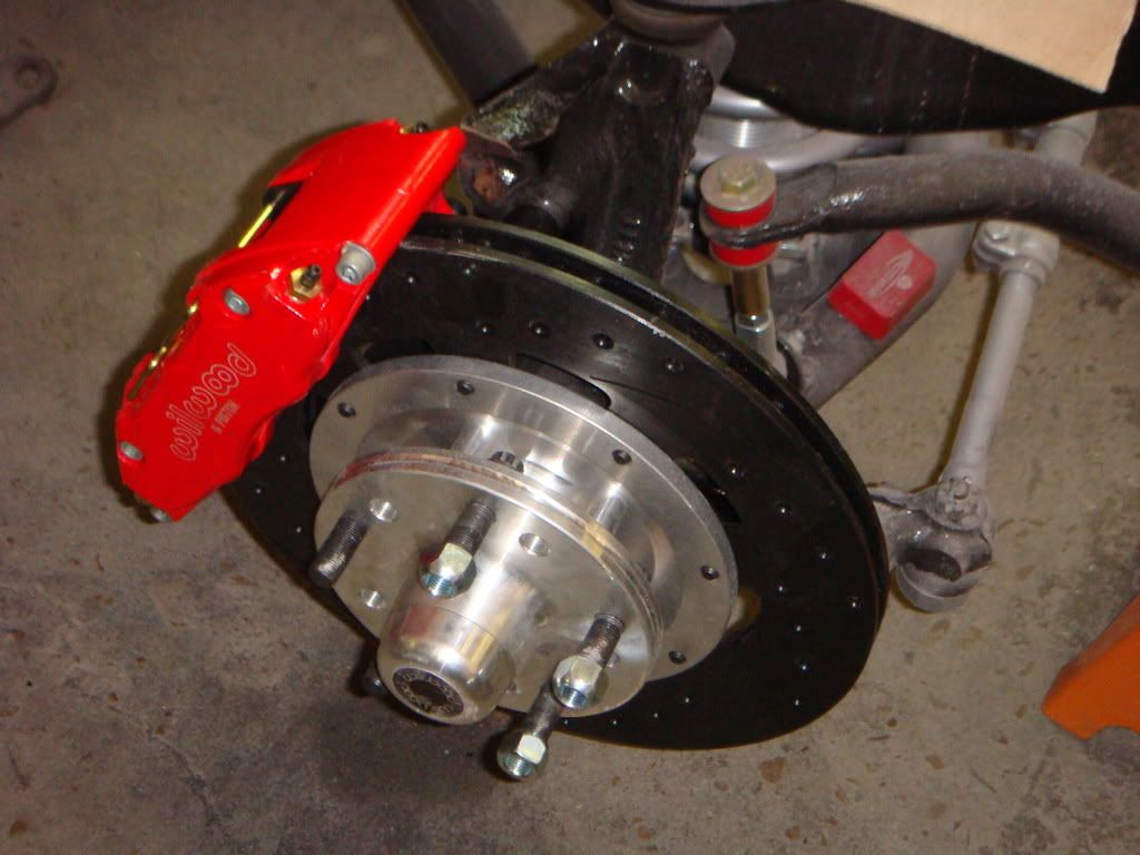

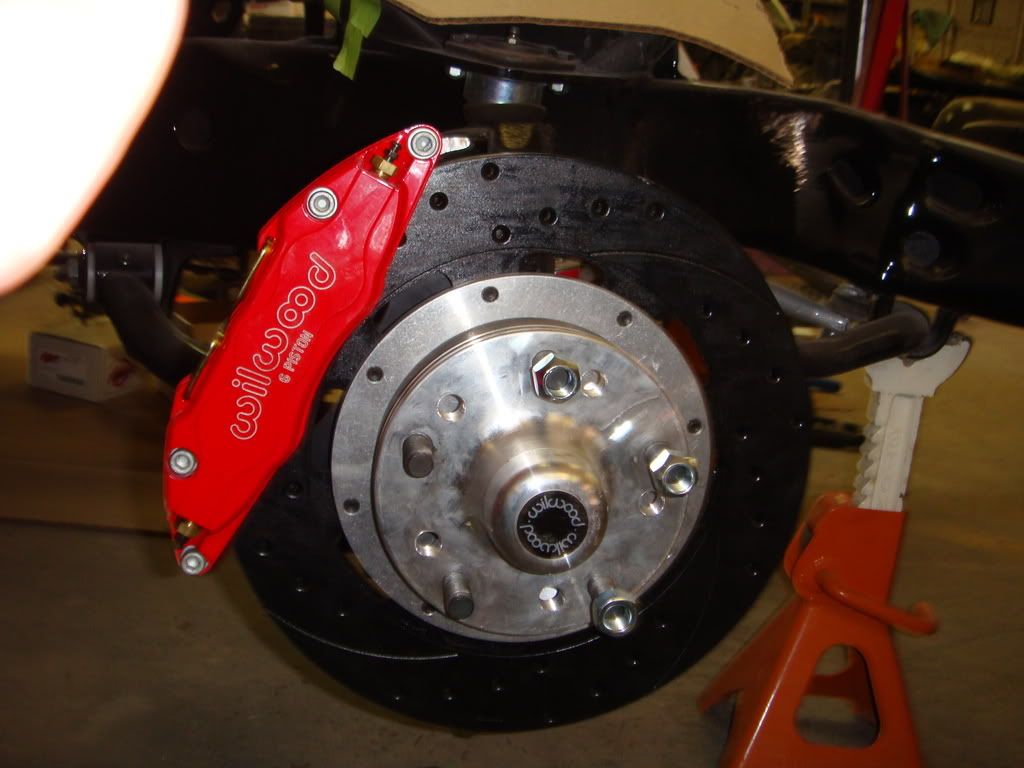

10Seconds 10-04-2008 04:32 PM
And after looking back through my build thread I realized I neglected to post up some pictures of my brakes too, so here they are. I went will the Wilwood setup (Thanks to Frank at Prodigy for getting me these, I think I was one of the first sets he sold of these and just now am getting in on the car.)
http://i168.photobucket.com/albums/u...A/DSC00206.jpg
And another:
http://i168.photobucket.com/albums/u...A/DSC00207.jpg

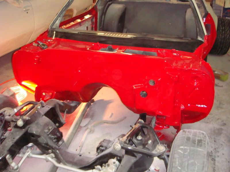

10Seconds 10-17-2008 07:29 AM
Ok, well despite the lack of responds here, I will continue to post my progress, as at least I am excited about it. Sheesh, next time I guess I should do a 69 camaro.

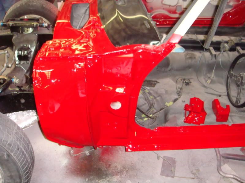

Anyways, we finally have some color on it!! Painted the firewall and jambs:
http://i168.photobucket.com/albums/u...A/DSC00372.jpg
http://i168.photobucket.com/albums/u...A/DSC00373.jpg
Anyways, I am excited, and its nice to see it coming back together again as its been over 4 yrs since I took it apart.

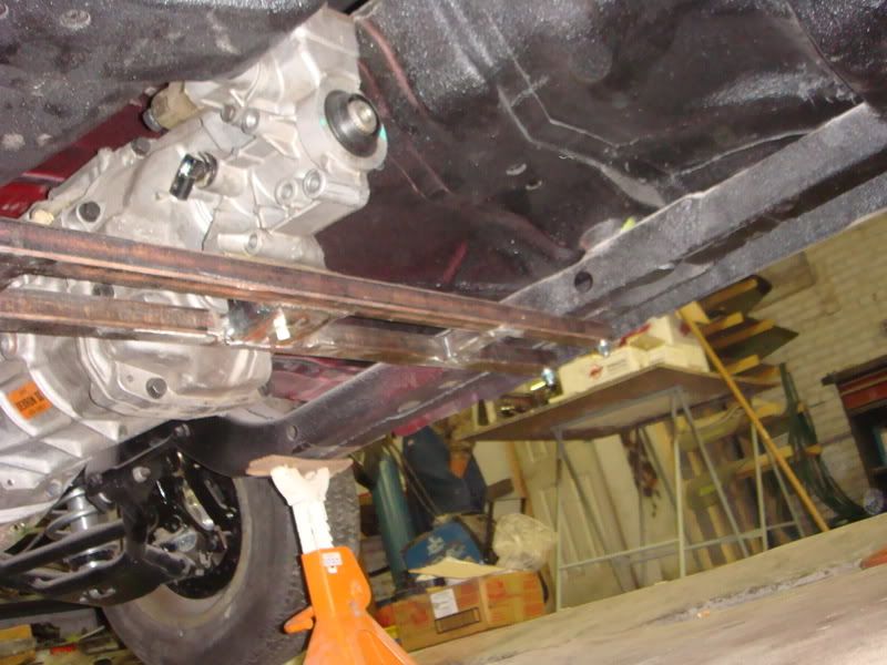

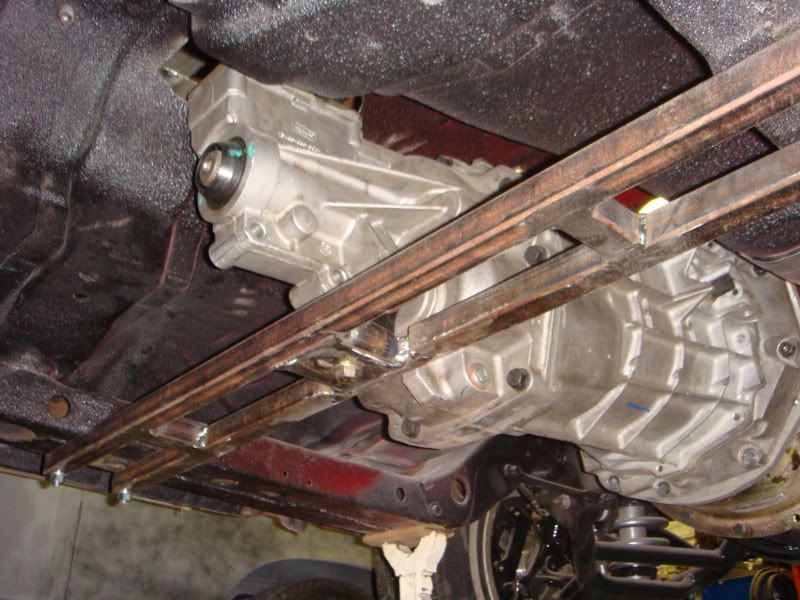

Here is my new trans crossmember for the T56. The old one was just the factory one with the ends cut off and reworked a bit.
I am not 100% sure on the design, so I am open for comments, but I do think it will work. I will clean it up and change the bolts for final install. It leave me plenty of clearance for my 3.5 oval tube exhaust to run over it, rather than try and have some fancy bends in the crossmember to allow it to go under. So the benefit is actually better clearance and a straighter shot from the headers.
http://i168.photobucket.com/albums/u...A/DSC00779.jpg
http://i168.photobucket.com/albums/u...A/DSC00780.jpg
http://i168.photobucket.com/albums/u...A/DSC00778.jpg
Thoughts?

syborg tt 03-11-2009 08:50 AM
The car is looking good.
One of the things that I would consider changing is the bolts. They hang down to low. Maybe weld a threaded sleeve into the subframe so all you have hanging down is the nut. You will gain considerable clearence which is going to be very important since I think you have this car pretty low to the ground.
I would just hate to see you snag a bolt on the ground and twist something.
As far as astetics go I personally like a tubular crossmember but that would require a tubing bender and plent more labor.

Does the transmission need to be at the level, or can it go up some? If you can move it up some, it will put your headers closer to the floor for more ground clearance. And I wouldn't want the crossmember hanging lower then the sub frame.

No, trans is in the correct spot, correct angle, as is engine, but really, I think clearance will be ok, hard to tell from picture.

Looking good! I think you are doing some fabulous work on the car. My only comment on this would be the trans crossmember. I'm just not feeling the boxed ladder set-up. I, like Syborg, think that the round tubing would look cleaner, but if you don't want to go that route, I just feel like that crossmemer should be inside/on top of the frame. If for whatever reason, a piece of road debris, bottoming out, etc... shears those bolts off, your tranny is going bye-bye. At least the other way, it is still there and you could possibly limp the car home.

IMO, it's way too low as thats a very vulnerable spot when entering driveways, going over speed bumps, loading/unloading a trailer, getting it on a 4 post lift, etc.

I agree with Marty about doing something with the bolts on the trans cross member. You could maybe put two pieces of angle iron on each end and use that as the mounting pad for holding the cross member to the frame.
10Seconds 03-12-2009 08:21 PM
Thanks guys, I appreciate the comments on the crossmember. I guess I probably knew that after seeing it done, but wasnt quite ready to make the call on it. I guess I will go try again.

First of all - killer build!! Like the work you are doing. Mini-tubs etc look great! In regards to the tranny X-member - I would opt for something different. Everything else on the car looks really nice and thought out. The tranny cross member doesn't keep up with the rest of the car - estically IMO. Not to mention hanging so low. Think of how many times you have looked at a killer car then look underneath and see the exhaust of something that just looks way out of place and walk away saying killer car...but.... I would look at Morrison or Chassiworks for their universal crossmembers. They make some nice weld ins as well as bolts ins. Once again. Killer build & look forward to watching it come togther. :thumbsup:

BRP Hotrods has a nice crossmember that may work for you as well.
10Seconds 03-23-2009 08:19 PM
Thanks guys, I will be redoing the crossmember. I just am leaving it alone for the moment and trying to get some other stuff done right now. I would love to find one to just buy and stick in, but no one has one that I can buy.
