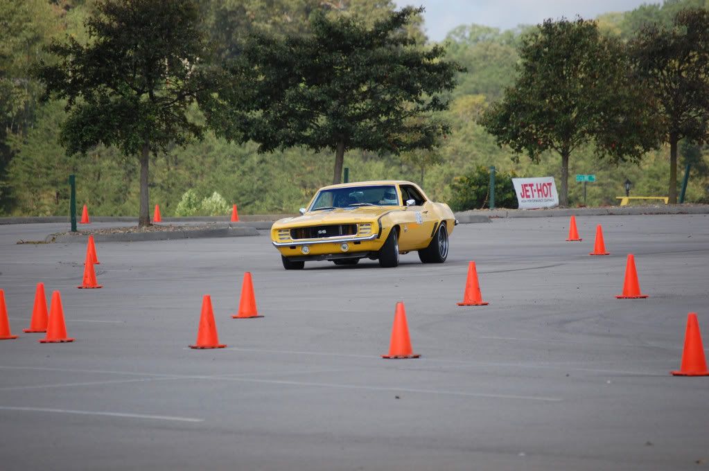

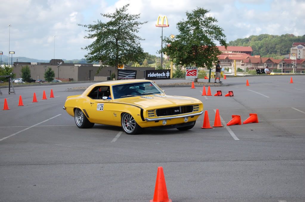

Payton King 10-24-2011 11:02 AM
Fianlly got around to posting again
It was a thrash getting the car back on the road for RTTH 7. Seems like there is always something. When I took it out for its maiden voyage, I knew right away that something was not right. The shocks were not where close in controlling the springs...I was running 700 lbs front and 550 lbs rear. Good thing about living in Charlotte is there are a lot of race stuff around. Bilstein is here, so I pulled them off and ran them up to have them checked. One was completely out of gas, valving was too light for spring rates. They gave me a pair of safety glasses and I proceeded to get an education on shock design. Mike revalved all 4 shocks on the spot and ran them on the shock dyno, it was quite an afternoon.
Got them back on the car and went down on spring rate to 550 front and 325 rear. It was a night and day difference in the car. I am running them in the middle setting and my 69 rides better than my wife's M3. What a difference the correct shock makes.
I did make RTTH but had only put 5 miles on the car before it hit the parking lot for the autocross school that I had signed up for at the event. I was getting use to the car and was getting faster every run I made. It was a little tight and I had a small mechanical issue the first day. I had Danny Pop make a 2 laps for his feedback. 2nd lap in my car that he has never driven knocked 2 seconds off of my best run. The car is capable, the driver is not.
Fixed the small problem, raised the watts one hole to free the car up and aired the tires down to 28 psi hot for the next day. Again every run I got faster and ended up running 12th out of 86 cars and missed the top 10 by .4x. A little more time getting use to the car and would have like to try some shock settings, I think I could have gotten there.
All in all a completely different car with the torque arm, shocks and new/better tires. My hat is off to Dan and his wonderful fab work and a well thought out rear suspension design from Jake.
http://i1138.photobucket.com/albums/...ics-221-X2.jpg
http://i1138.photobucket.com/albums/...ics-230-X2.jpg

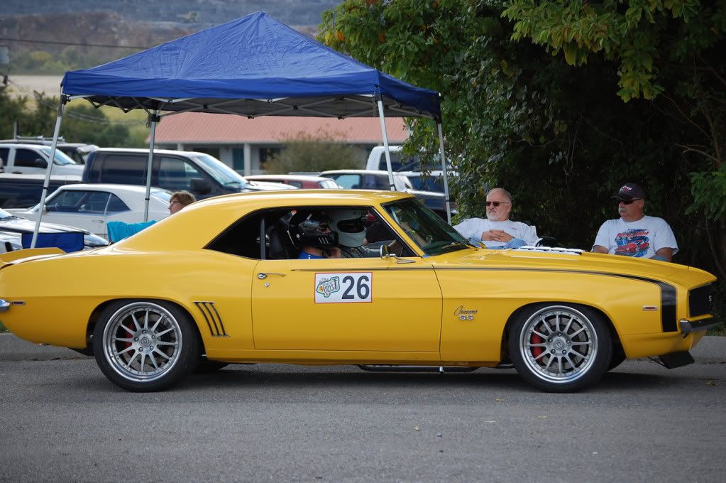

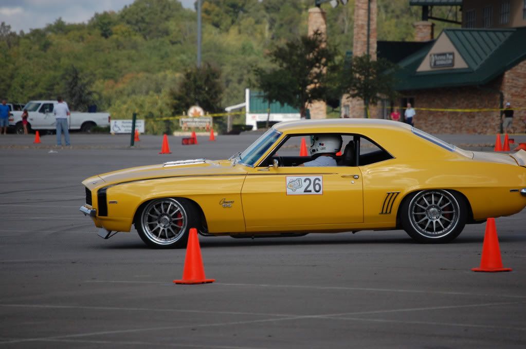

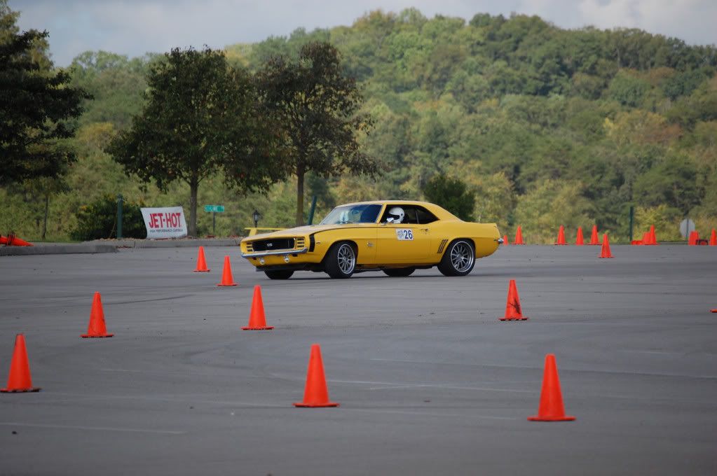

Payton King 10-24-2011 11:07 AM
More pics
http://i1138.photobucket.com/albums/...ics-227-X2.jpg
http://i1138.photobucket.com/albums/...ics-228-X2.jpg
http://i1138.photobucket.com/albums/...ics-229-X2.jpg
