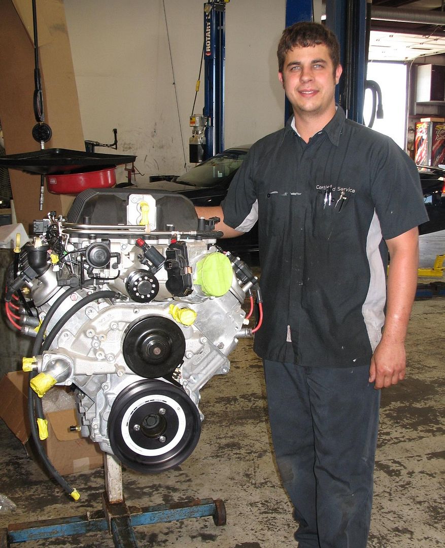

The engine upgrade parts supplied by Thomson Automotive have been installed by Tony, my favorite, fully certified Chevrolet technician. Tony is the only person I would let work on my Z06 and my daily driver.
He takes great pride in everything he does and he loves his work. In fact, everyone I have talked to at Weber Chevrolet in Waterloo, Ill. treats you like they are glad to see you. I have purchased brand new cars from both Mercedes and Lexus. They have nothing over the customer service and attitude I experience in Weber's service department.
Here's Tony looking proud of his work, like the engine is his baby. (Actually, he and his wife are expecting their first real baby very soon!)

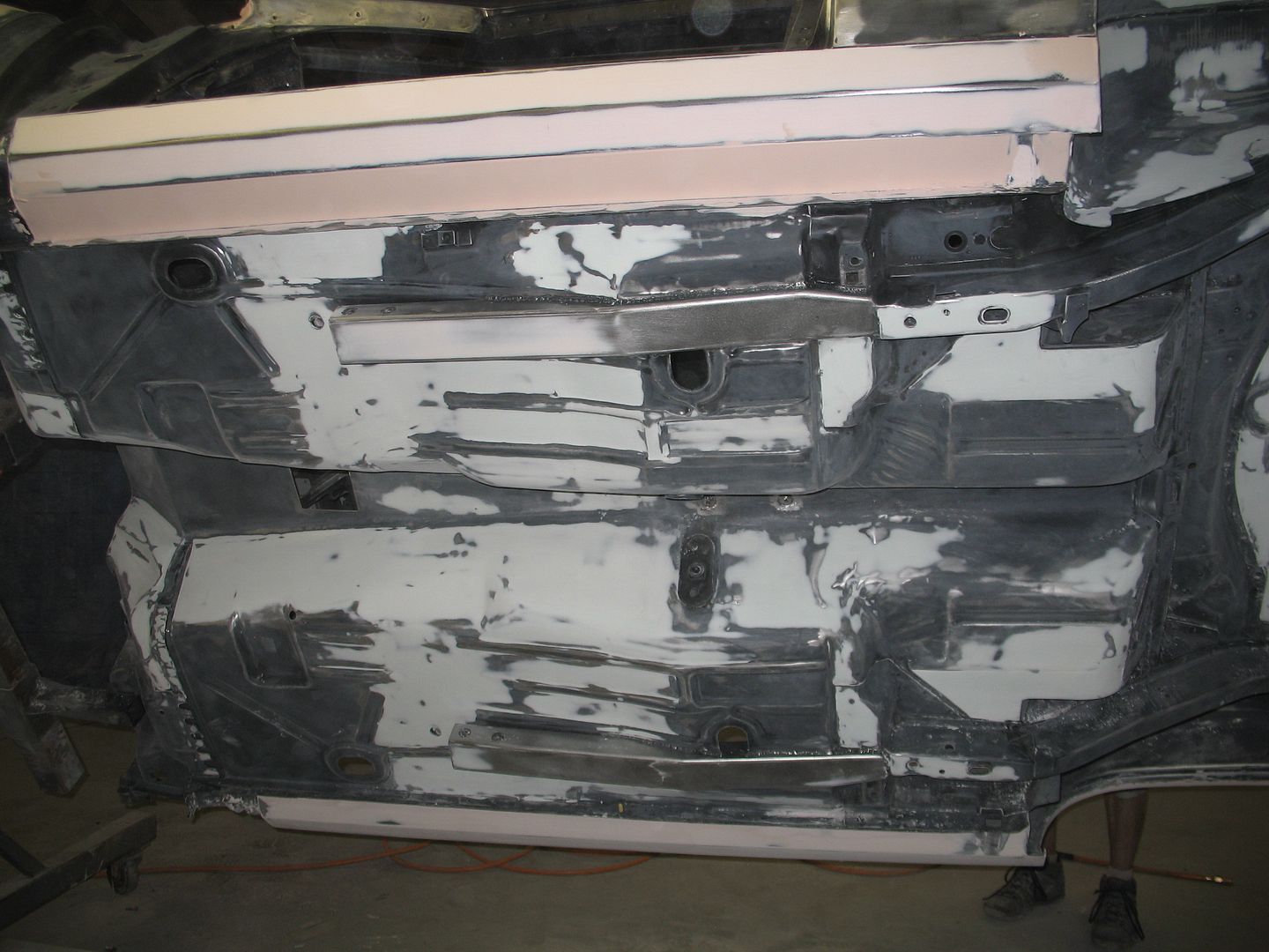

While delivering the engine so they could paint it all up nice too, I snapped a few pictures of Nathan and Zach's handywork preparing the body tub for paint.
When I noticed how they are making sure the rockers are perfect all the way around to the floor pan I complimented Nathan. He calmly replied that he has noticed some body men can get a little lazy in those areas and that has always been a pet peeve of his.
http://i1140.photobucket.com/albums/...ps78d69435.jpg

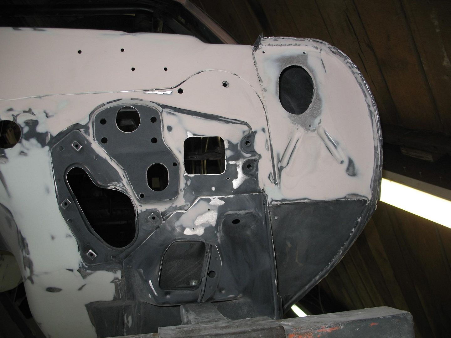

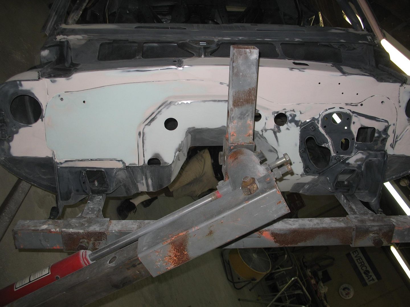

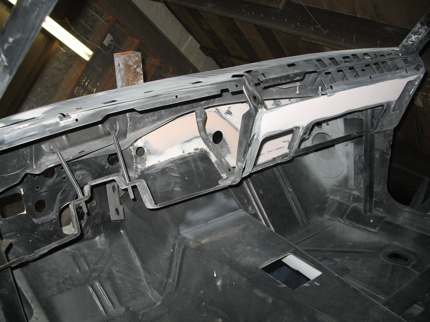

I love how the firewall turned out. We had to recess it a bit.
http://i1140.photobucket.com/albums/...ps359f2ae5.jpg
http://i1140.photobucket.com/albums/...psbb1440e6.jpg
http://i1140.photobucket.com/albums/...pse39bca99.jpg

Great pics!! Everything looks great. A couple of questions:
1) What update did you do to the engine.
2) What is the custom grill made of...fiberglass, metal, carbon fiber, etc.? (can't tell by the pics)
Lous69 07-13-2013 07:34 AM
Engine upgrades include Cam, valve springs, injectors, pulleys, solid coupling, damper and matching tune by Dave Mikels who works very closely with Brian at Thomson Automotive.
Dave and Brian are great to work with too. They sent the parts overnight delivery just to make sure we could get them installed in time to avoid any delays in body and paint. I especially appreciated their willingness to help us out because their main business is selling complete engines not selling parts.
Dave helped us figure out how to do a lot more with the ECM than just tune it for the performance mods. He also helped us enable things like reverse lock out using vehicle speed sensing, PWM fan control and AC compressor pressure sensing for cooling fan control.
