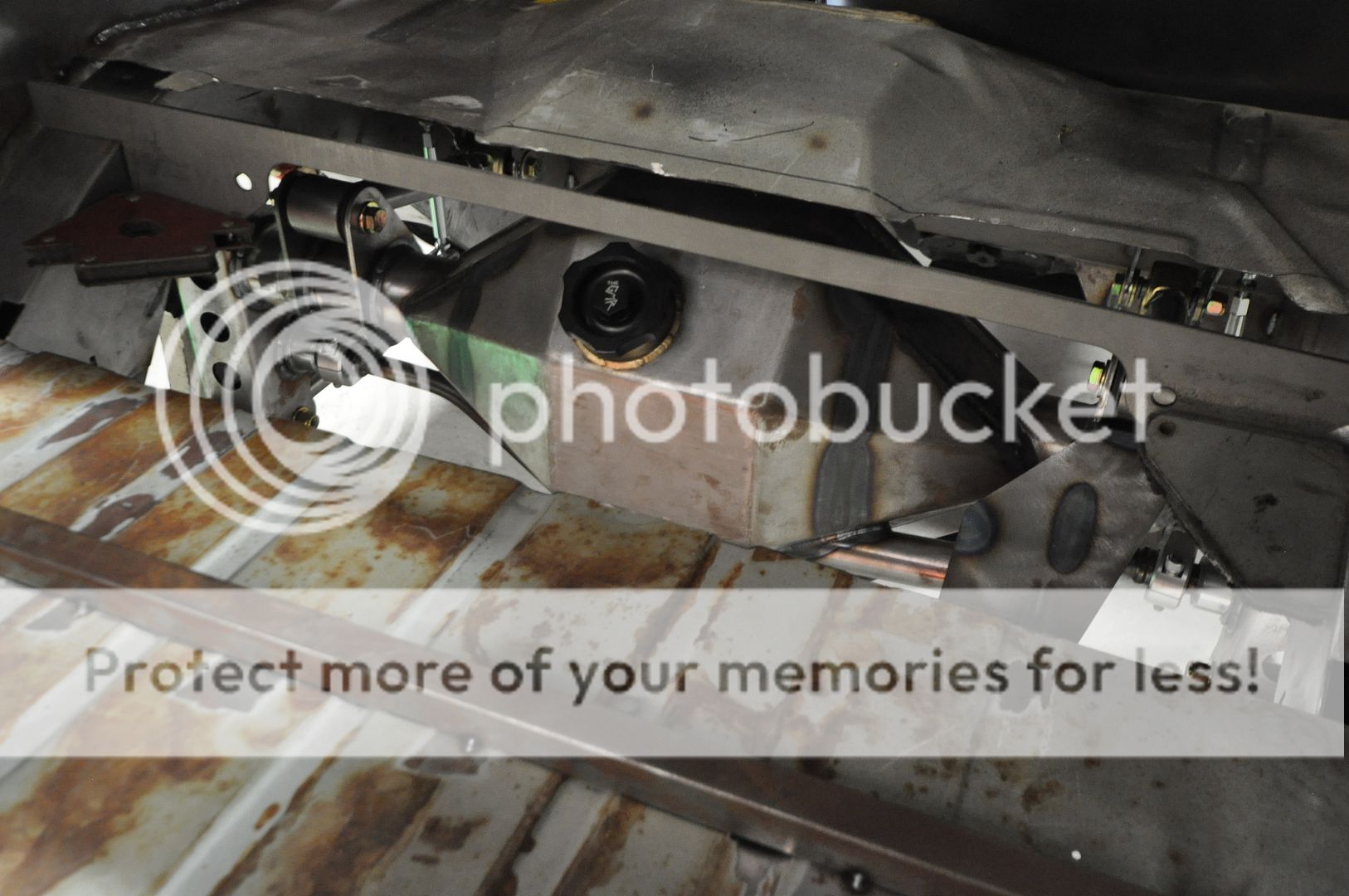

Our chassis bolts right to the car but it does require floor mods for clearance.
Drive shaft tunnel, for the lowered ride height and the trans tunnel for the bigger trans.
http://i616.photobucket.com/albums/t...ps7ec02d9e.jpg
The rear floor behind the axle housing will require some mods to the floor. We cut out this section to just replace a big section instead of cobbling up some patched up sections. Just nicer results.
http://i616.photobucket.com/albums/t...toshoot027.jpg
Then work has to be done to the inner fenders. This is probably the biggest task. They only need to be widened for running a 10 front wheel if needed. I'm looking at having these made from carbon and glass. Running an 18" front wheel instead of a 19 will minimize this work quite a bit.
http://i616.photobucket.com/albums/t...ps4c40ab4b.jpg
In my opinion the ride height is what sets our frames apart from the other out there. We do not sacrifice ground clearance for this stance. Plus we also work to helps solve other issues on the car. There is no way anybody is going to get there car this low without a drive shaft tunnel. Our frame has a 4 inch beam height under the rocker and the later model Chevelles do not suck up the frame as deep as the early model units. But we have done some extra work to add strength and minimize visual impact of the frame on the side of the car. You can barely see it in these pics and it is still baremetal not powdercoated black yet.
