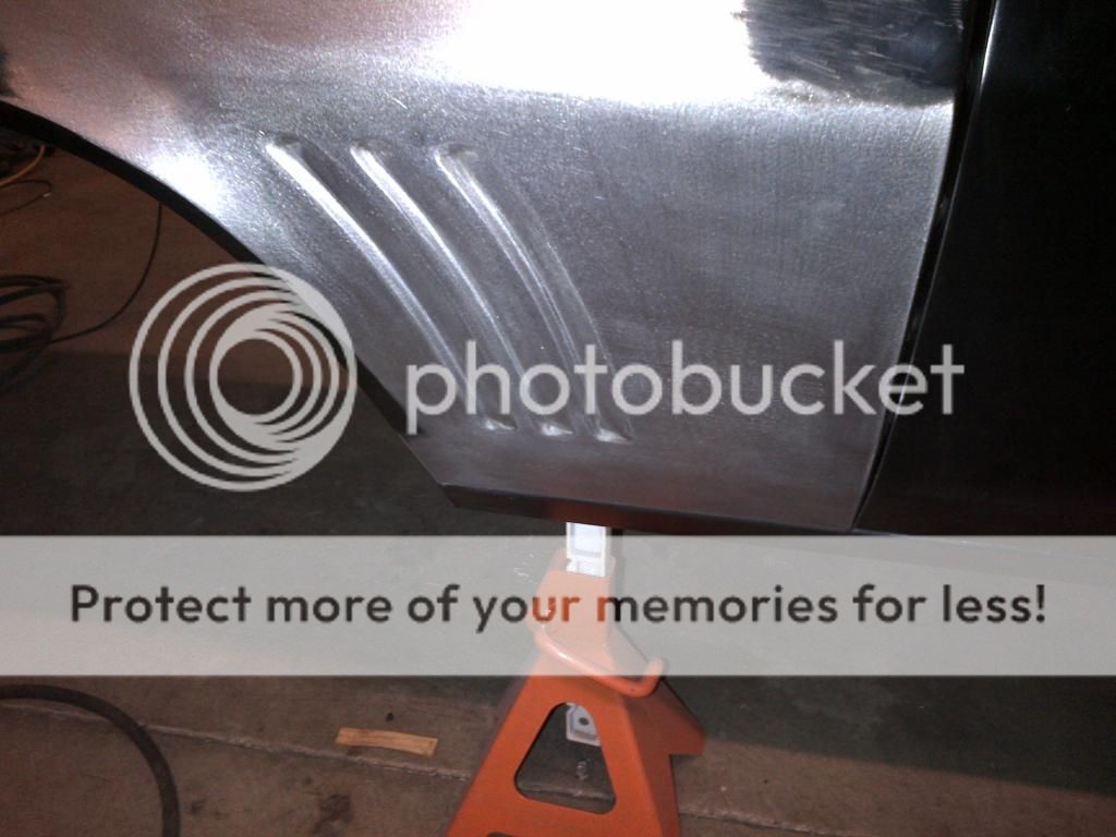

Matt replaces the wrinkled quarter panel with an OE gauge sheet metal. We cut the gills out of a stock quarter to get a crisper stamping. When Matt is done you won't be able to tell we replaced it.
http://i439.photobucket.com/albums/q...psdb798f99.jpg
http://i439.photobucket.com/albums/q...pse169e578.jpg
