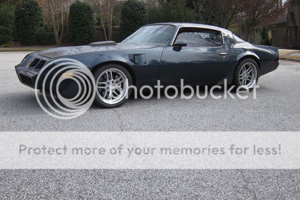

Originally Posted by WSSix (Post 625033)
The last thing I did was to dearch the rear springs. I just couldn't stand how high it sat in the rear. I've brought the rear down about 1 inch and it looks so much better to me. Ground clearance is still great.
http://i472.photobucket.com/albums/r...ps7fjokg6g.jpg

I am thoroughly impressed. By your ride height and your bravery to go that low!
I got some info on PT that my front air dam should be lower for aerodynamic purposes, so I took some measurements and they are a fair amount higher than I realized. So I can go lower, but I wasn't expecting to see yours THAT low. I've seen 4.5 - 5" as the general consensus as far as a practical ground clearance number.
I've got my exhaust tucked up nicely too, so I'm not as worried about that stuff as I am the front crossmember. You got that slammed!
WSSix 10-06-2016 08:03 PM
Thanks Woody. I appreciate the kid words. I need to take some more measurements now that it's been a while since I did all the work. Things settle and I'm not sure where I'm at now with ground clearance. I don't scrape or bottom out on anything so I'm good in that respect. Is it optimal for handling? I have no clue. I'm not at the stage where I can judge that. With the driving I have done, it ride and handles fine.
