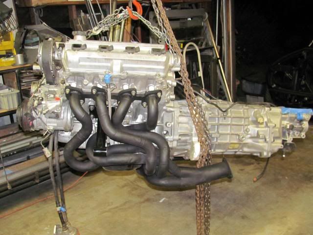

Panteracer 04-20-2015 01:14 PM
Rampage
1 Attachment(s)
Mark when can I send my bird over for the header mods:)
would love to do it on the bird but not a lot of room
Herb Adams modified his Oil Pan to get them on his first Firebird
Pic of my Pantera headers... easy compared to what you did
Bob
