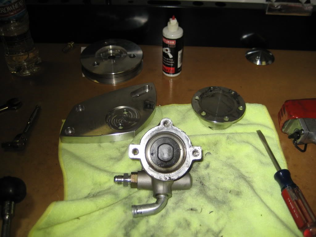

Thanks Tony....I got out and tore down the right side of the engine. While I thought it was the elbow that leaked, it ended up being a failure out the rear of the pump. The fluid was a little nasty. I turned the wheels back and forth forcing most of the fluid out of the rack. Now that I have it tore down this far, I'm thinking it sure would be easy to plumb in the oil cooler lines down the drivers side pan rail and order that new ron davis radiator. The prolbem is my next race is 2 weeks away.
http://i200.photobucket.com/albums/a...1969/002-6.jpg
http://i200.photobucket.com/albums/a...1969/006-2.jpg

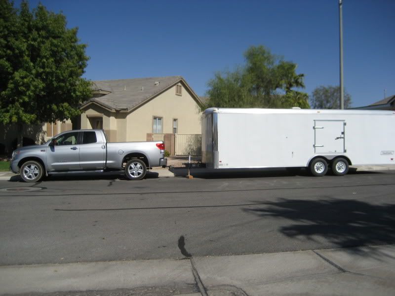

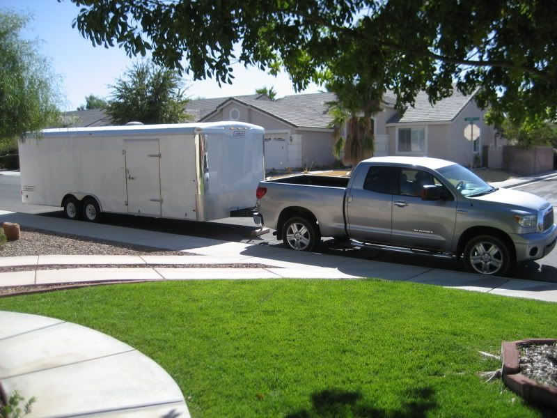

It's been a busy few days. Flew into Phoenix on Friday morning and bought a 2007 Tundra limited at a great price from a private owner. I just happened to run across a 24' trailer in the Laughlin area and said what the hell. Here is my new rig to run the car around the US! Now I just need to sell two trailers and a Tacoma! :rolleyes:
http://i57.photobucket.com/albums/g2...railers007.jpg
http://i57.photobucket.com/albums/g2...railers009.jpg

Nice looking rig Todd. Send me some details about that Tacoma.
70rs 10-11-2009 07:18 PM
Nice work Todd!! Now you have it all dialed in. Very cool. That trailer looks like a blank canvas. Any chance of a "Payback" paint scheme or logo?:thumbsup:
skatinjay27 10-11-2009 07:47 PM
that ends up just being a big sign to crooks (look what i got in here!)
man todd your living the dream!:thumbsup:
