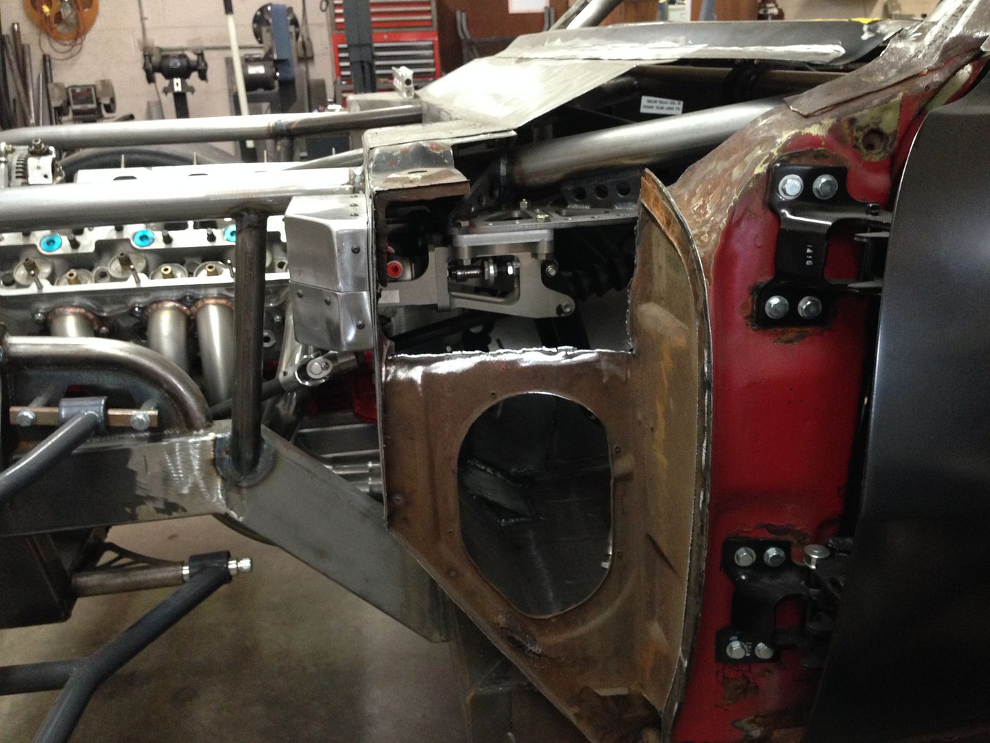

Where I left off...we are removing some of the driver's side cowl area. Here are some photos of the pedal box
http://i1138.photobucket.com/albums/...psbkwm3pco.jpg
http://i1138.photobucket.com/albums/...ps926g8pzy.jpg
http://i1138.photobucket.com/albums/...pscqyxfuf7.jpg

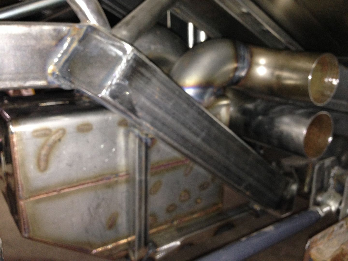

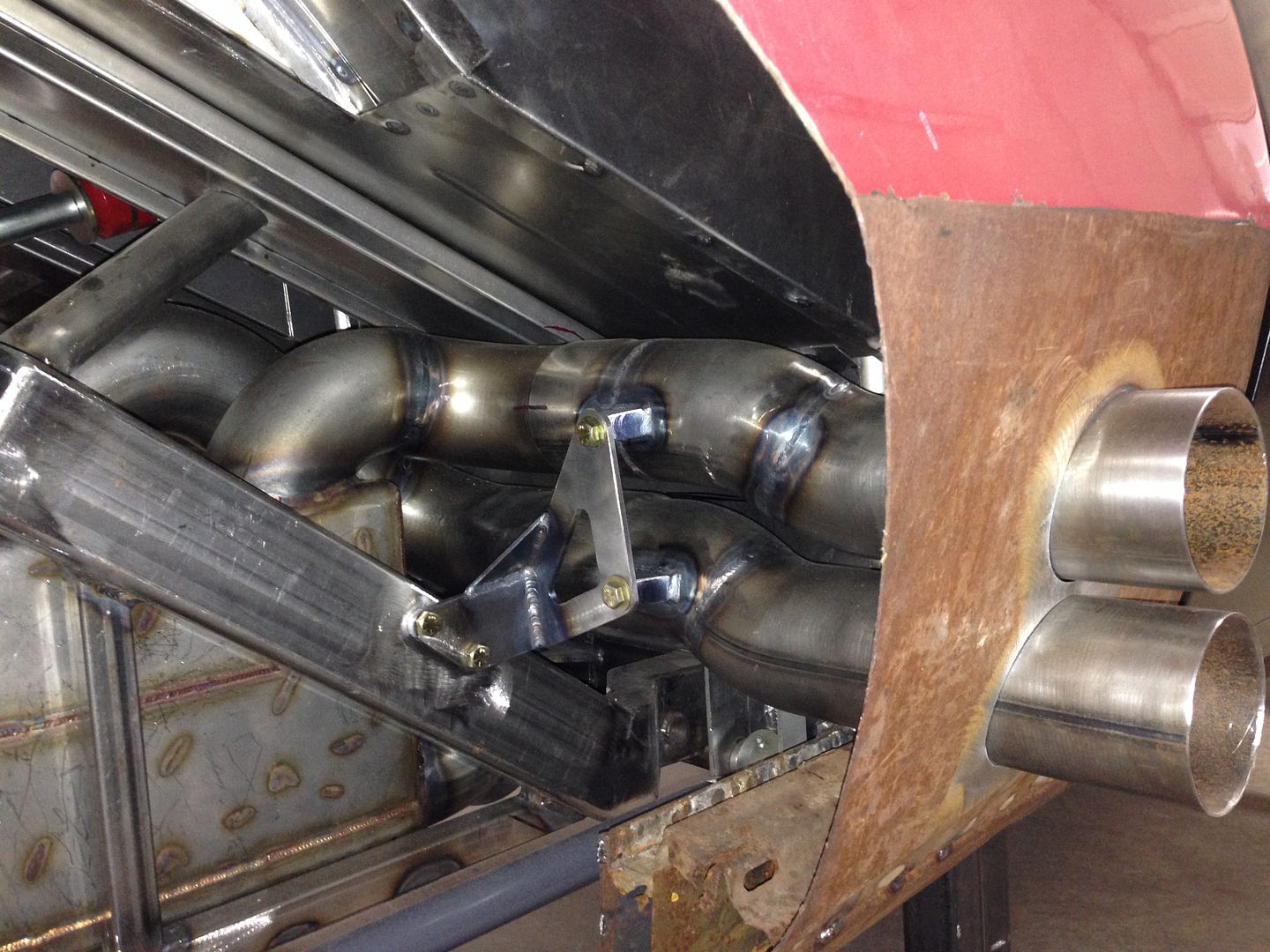

My custom mufflers came in from Spin Tech. 3.5 inlet and 3.5 outlet. Here is the tricky fab work from Pettigrew
http://i1138.photobucket.com/albums/...psd7twwgpc.jpg
http://i1138.photobucket.com/albums/...pslmbnregt.jpg
http://i1138.photobucket.com/albums/...psjovib9xl.jpg
http://i1138.photobucket.com/albums/...psfonqvffp.jpg
Payton King 01-18-2016 03:19 PM
http://i1138.photobucket.com/albums/...psj8nkvdki.jpg
http://i1138.photobucket.com/albums/...psb8syv5f8.jpg
http://i1138.photobucket.com/albums/...psuk984ked.jpg
http://i1138.photobucket.com/albums/...pstjdhlf1o.jpg
http://i1138.photobucket.com/albums/...psh9ukhpyz.jpg
Payton King 01-18-2016 03:31 PM
This is the other side making the transition from oval to round tube.
http://i1138.photobucket.com/albums/...psuyrno2dv.jpg
http://i1138.photobucket.com/albums/...ps6n1mjlsr.jpg
http://i1138.photobucket.com/albums/...ps6a3qm8mz.jpg

Payton King 01-24-2016 10:31 AM
As low as this car sits, 4 inches at the frame at the firewall and 4.5 inches at frame in front of rear wheels, we were going to need to cut the front fenders. This is the first rough cut just so we can get the wheels on. I am going with Sutton's high travel low roll strategy and will be traveling the front wheel 3.75 inches.
http://i1138.photobucket.com/albums/...pszisj44yx.jpg
http://i1138.photobucket.com/albums/...pspwajvd5e.jpg
http://i1138.photobucket.com/albums/...psudtxnyd5.jpg
http://i1138.photobucket.com/albums/...psggokqojk.jpg
Payton King 01-24-2016 10:37 AM
http://i1138.photobucket.com/albums/...ps738wfafq.jpg
http://i1138.photobucket.com/albums/...psu3vffk7g.jpg
http://i1138.photobucket.com/albums/...psr3xwiqpz.jpg
http://i1138.photobucket.com/albums/...psmxi0a9tk.jpg
Payton King 01-24-2016 10:44 AM
http://i1138.photobucket.com/albums/...psk0c2uh9z.jpg
http://i1138.photobucket.com/albums/...ps9zbq1ytn.jpg
http://i1138.photobucket.com/albums/...ps8hxihwab.jpg
