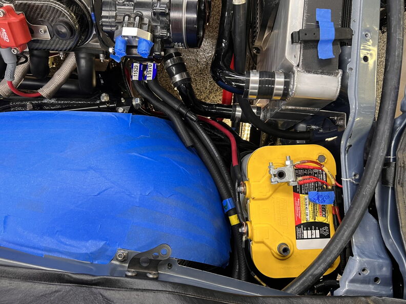

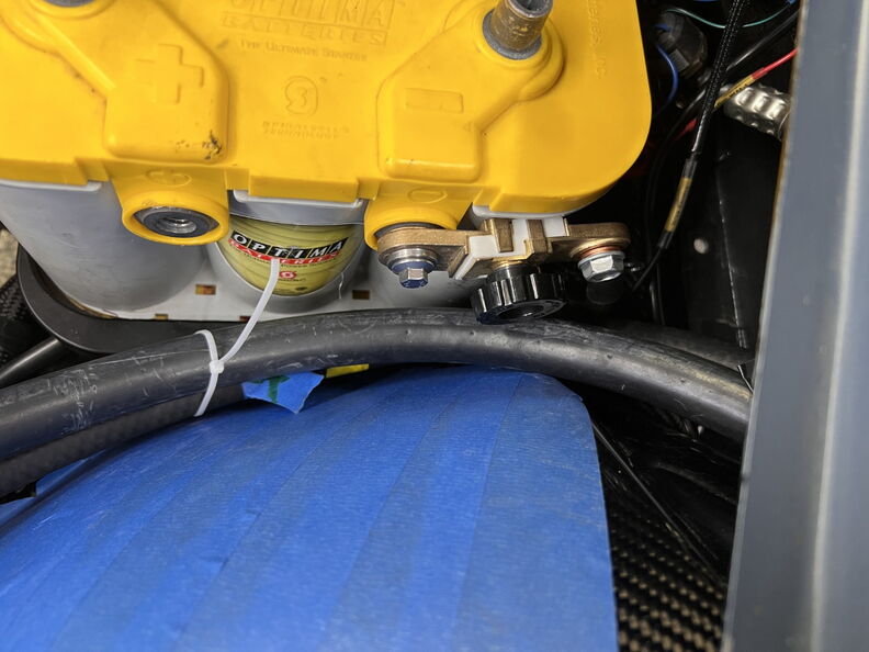

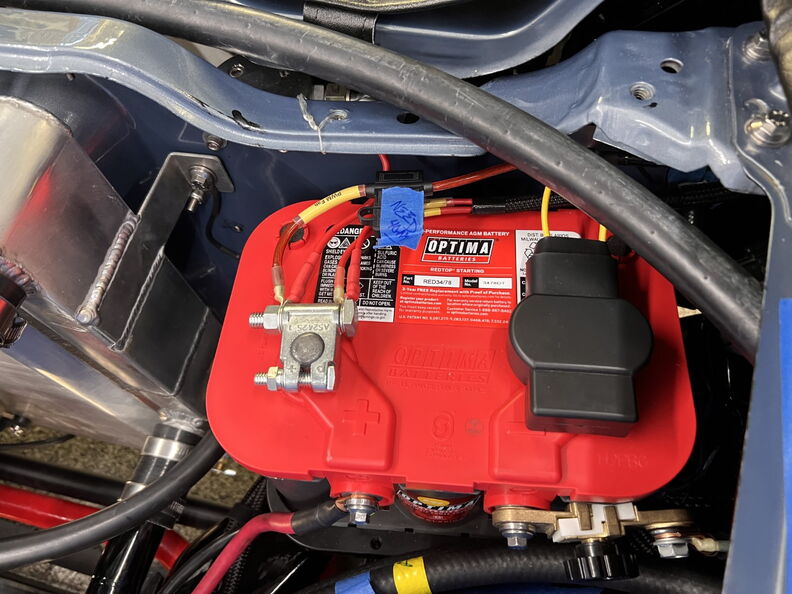

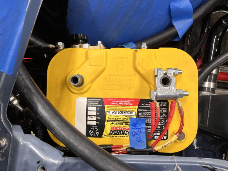

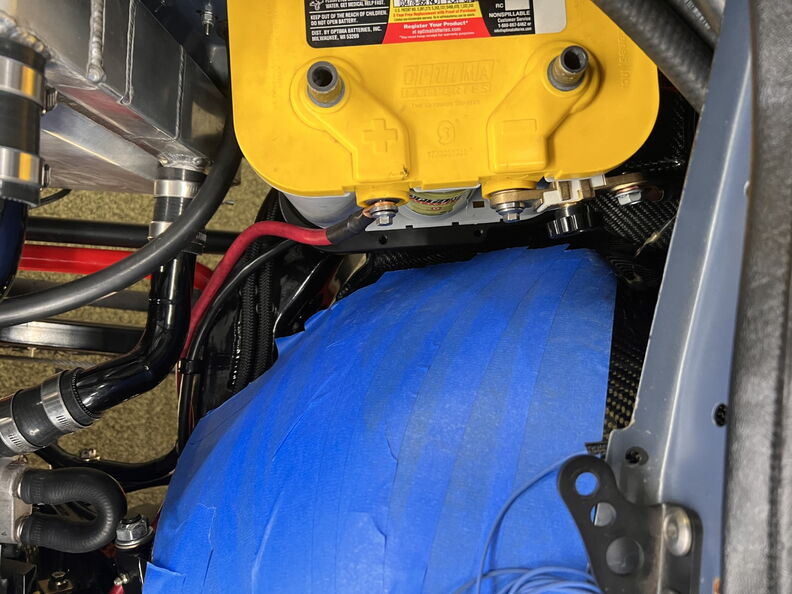

Vintage Air Hose Routing and the Battery Shut off is in the way. (( 03-19-23 ))
Well, sometimes things don't go as planned.
http://garagescene.net/_data/i/uploa...f4c8a21-me.jpg

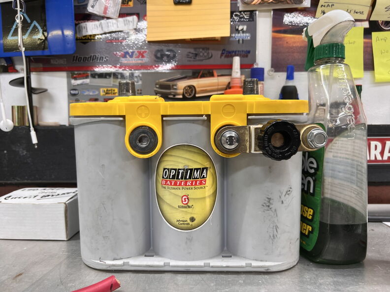

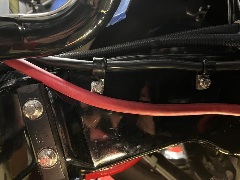

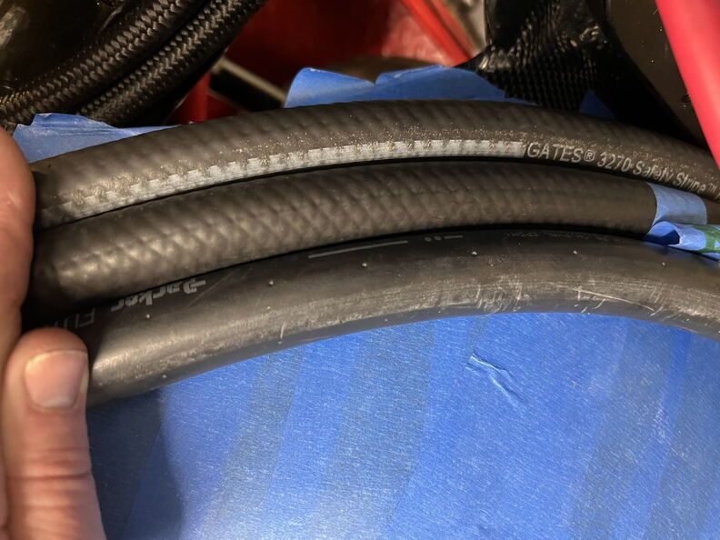

I had the battery disconnect on the Negative terminal and since it hangs so low it actually hits the hoses.
http://garagescene.net/_data/i/uploa...552e79c-me.jpg
http://garagescene.net/_data/i/uploa...7ad749d-me.jpg
http://garagescene.net/_data/i/uploa...b28b955-me.jpg
I think I found the solution.
http://garagescene.net/_data/i/uploa...ff452e1-me.jpg
http://garagescene.net/_data/i/uploa...21880e0-me.jpg

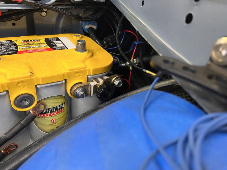

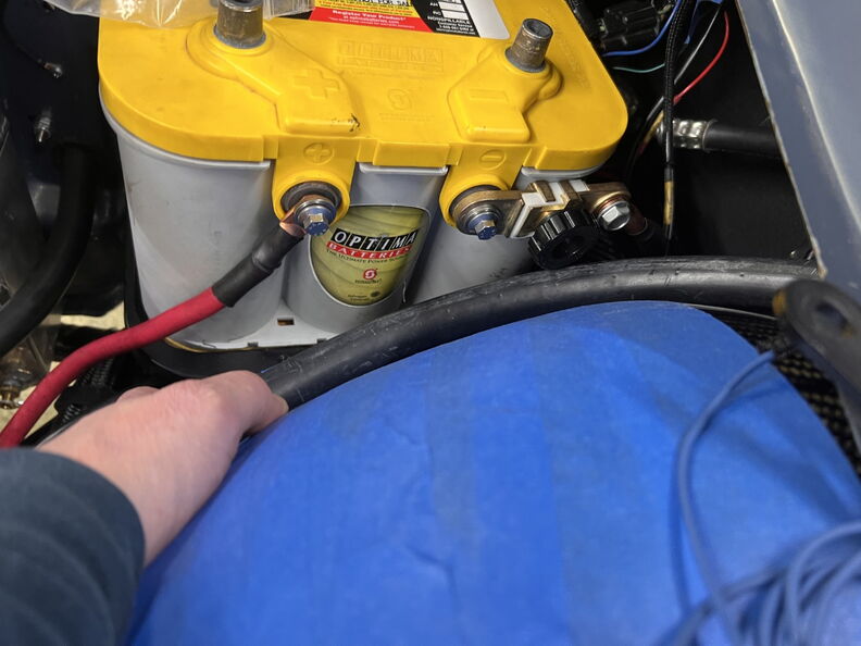

Next up is the battery hot wire.
http://garagescene.net/_data/i/uploa...029d3be-me.jpg
I ran the ground wire under the battery tray which will eventually be wrapped in a TechFlex Abrasion wrap to protect the wire.
http://garagescene.net/_data/i/uploa...f880575-me.jpg
Building the new ground wire.
http://garagescene.net/_data/i/uploa...aa721d7-me.jpg
http://garagescene.net/_data/i/uploa...56a4230-me.jpg
http://garagescene.net/_data/i/uploa...233b288-me.jpg
Originally I had the positive wire secured to the chassis and now it looks like it is going to be the ground wire.
http://garagescene.net/_data/i/uploa...d42d593-me.jpg
http://garagescene.net/_data/i/uploa...7229435-me.jpg
http://garagescene.net/_data/i/uploa...b3004be-me.jpg

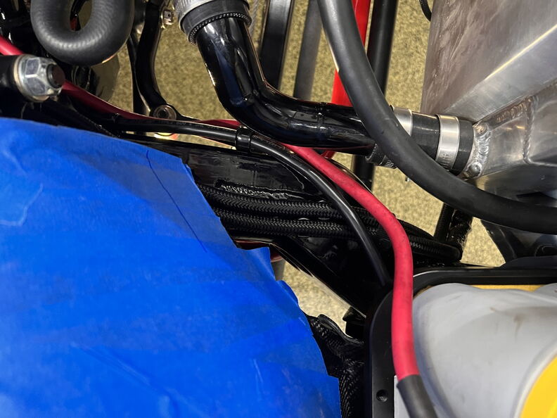

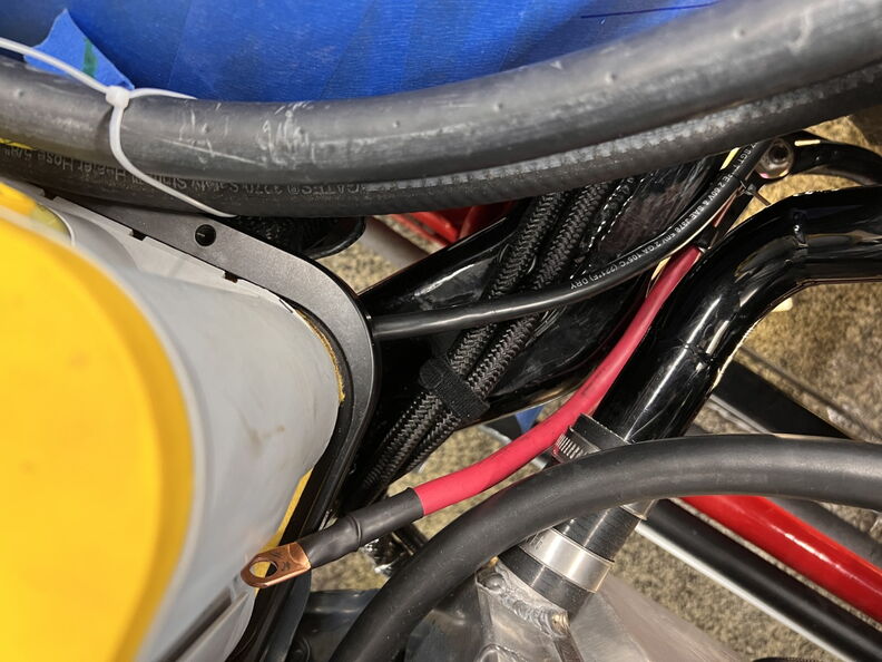

Still trying to figure out the Positive wire routing.
http://garagescene.net/_data/i/uploa...c50cd8a-me.jpg
Holy **** it works.
http://garagescene.net/_data/i/uploa...ccb1d8b-me.jpg
Plenty of space.

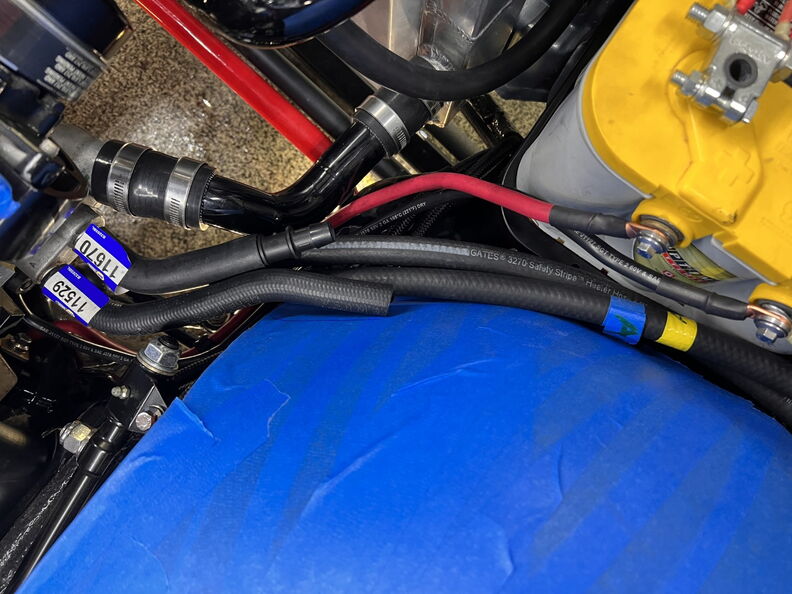

http://garagescene.net/_data/i/uploa...7155c7f-me.jpg
Now I just need to find a cool way to secure the hoses together.
http://garagescene.net/_data/i/uploa...9f24d61-me.jpg

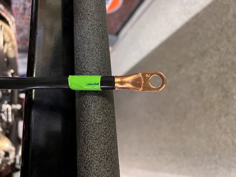

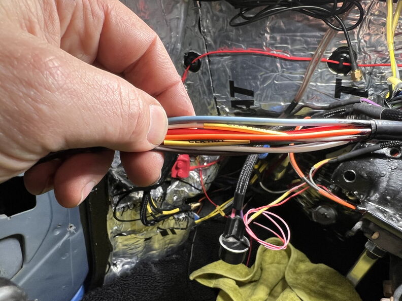

DRJDVM's '69 03-26-2023 06:34 PM

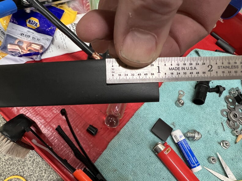

More questions about the label maker.... what labels are you using? Is it actually a tube that you are sliding over the wire then the clear heat shrink over that?
Saw the link for the actual label maker.....
syborg tt 03-26-2023 07:27 PM
The good news is you’re printing directly on the heat shrink. Then you slide the clear heat shrink over the shrunk printed yellow heat shrink.
https://uploads.tapatalk-cdn.com/202...92c62971a0.jpg
https://uploads.tapatalk-cdn.com/202...56a16efeb5.jpg
https://uploads.tapatalk-cdn.com/202...a42db35b22.jpg

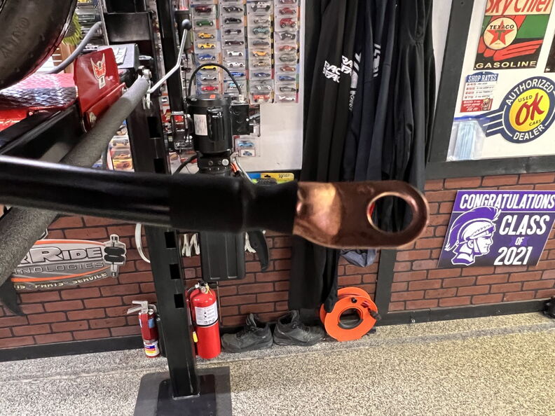

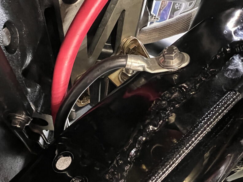

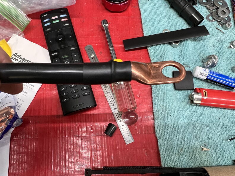

Finishing Up the Ground Wire (( 03-19-23 ))

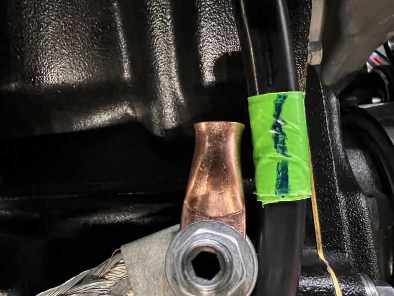

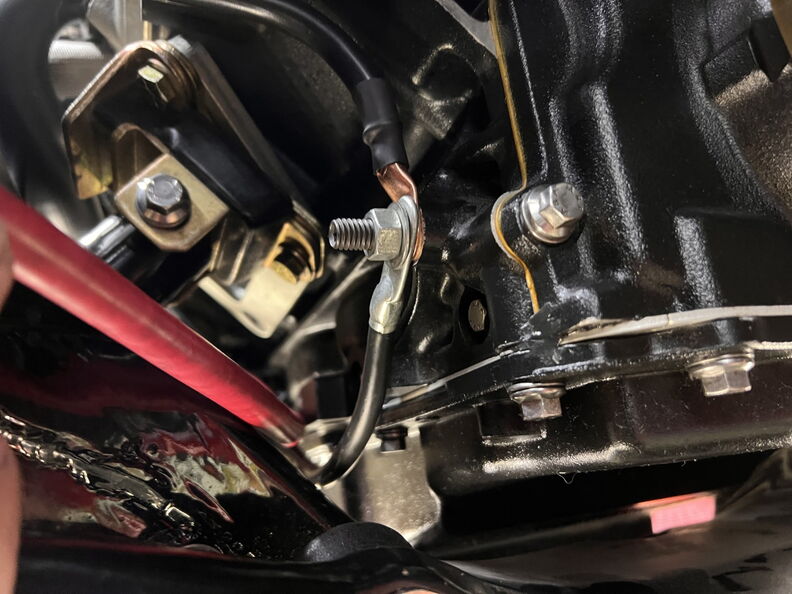

Making the final ground wire termination.
http://garagescene.net/_data/i/uploa...96c805a-me.jpg
http://garagescene.net/_data/i/uploa...a796530-me.jpg

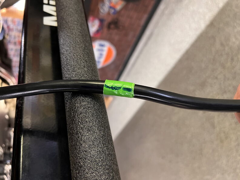

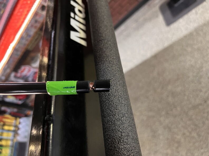

Don't cut it to short...Don't cut it to short...Don't cut it to short...
http://garagescene.net/_data/i/uploa...f76cbc5-me.jpg
Reference mark for the terminal orientation.
http://garagescene.net/_data/i/uploa...4e849f7-me.jpg
http://garagescene.net/_data/i/uploa...1b7cbcd-me.jpg
http://garagescene.net/_data/i/uploa...c0d35e6-me.jpg
http://garagescene.net/_data/i/uploa...8aa888f-me.jpg
http://garagescene.net/_data/i/uploa...2845a84-me.jpg

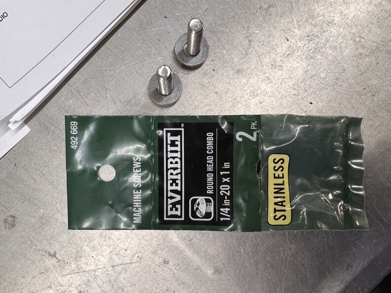

Since I can't find my 12 point sockets I am going to temporarily use these.
http://garagescene.net/_data/i/uploa...56cfe25-me.jpg
I need to change the angle for this Ring terminal.
http://garagescene.net/_data/i/uploa...f0c1e1a-me.jpg
This ground runs up to the block.
http://garagescene.net/_data/i/uploa...3790eb2-me.jpg
http://garagescene.net/_data/i/uploa...c806d25-me.jpg
http://garagescene.net/_data/i/uploa...f05db49-me.jpg

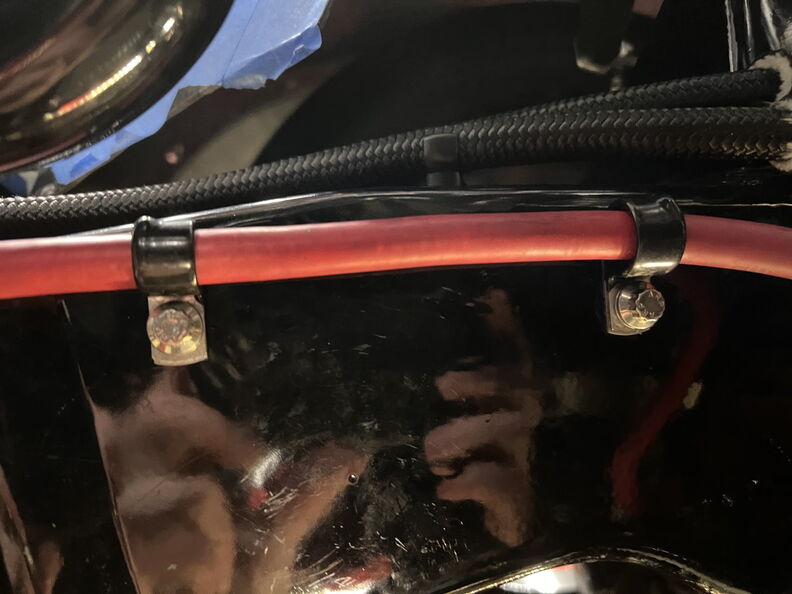

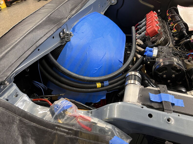

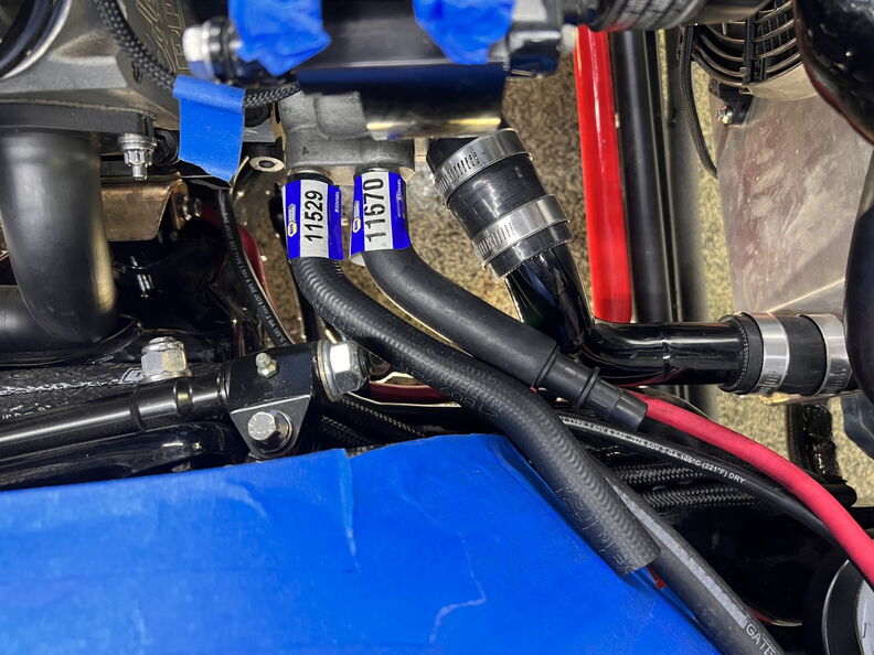

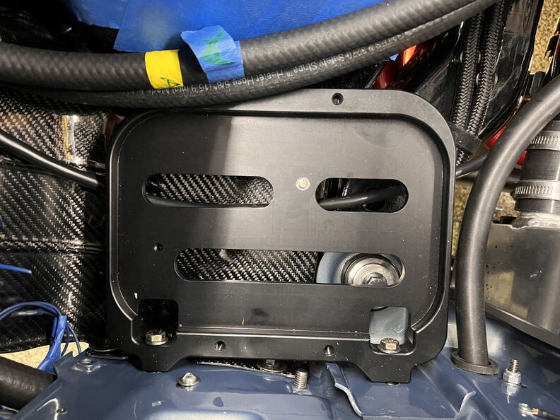

First up I am finally securing the heaters hose in the inner fender.
http://garagescene.net/_data/i/uploa...c5cda49-me.jpg
http://garagescene.net/_data/i/uploa...56d3037-me.jpg
http://garagescene.net/_data/i/uploa...c682c0e-me.jpg
Close up view
http://garagescene.net/_data/i/uploa...6140085-me.jpg

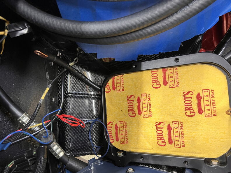

Well I couldn't do it so I moved on to the battery ground wire that is now neatly tucked under the battery tray.
http://garagescene.net/_data/i/uploa...c5a7f7f-me.jpg
http://garagescene.net/_data/i/uploa...7e360b9-me.jpg

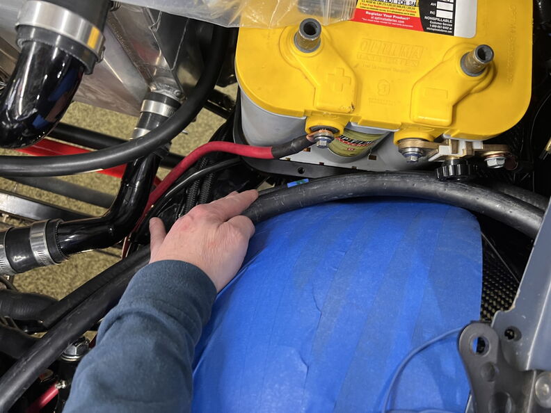

With the battery wire sitting so close to the lower radiator hose I decided to wrap it in DEI Heat Wrap.
http://garagescene.net/_data/i/uploa...baecb98-me.jpg
http://garagescene.net/_data/i/uploa...43c21a4-me.jpg

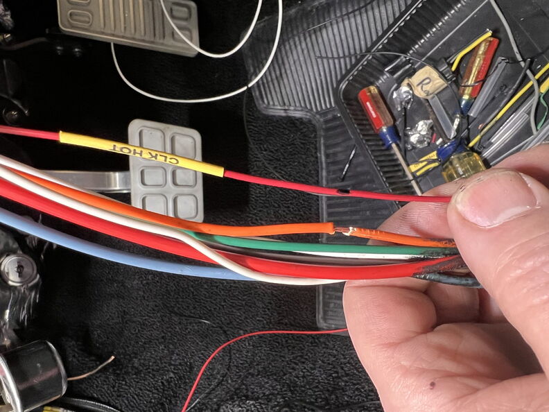

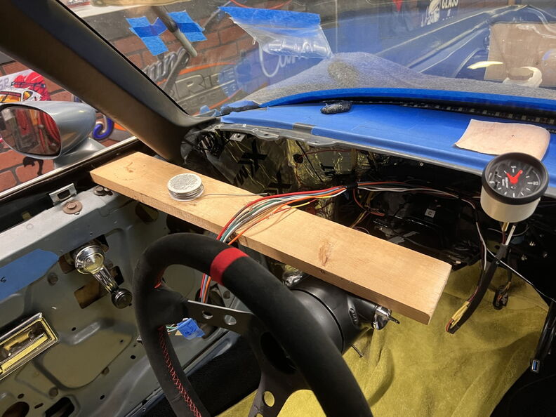

Final Autometer Clock Wiring (( 03-19-23 ))
I am pulling power and lights on from the headlight switch for the clock.
It has been a long long time since I center stripped a wire.
http://garagescene.net/_data/i/uploa...529cf49-me.jpg
I twist connected the wires and the Autometer Clock powered up. Yahooooo
http://garagescene.net/_data/i/uploa...22293d6-me.jpg
Of course I labeled everything first.
http://garagescene.net/_data/i/uploa...f46af28-me.jpg
My new desk for the next twenty minutes
http://garagescene.net/_data/i/uploa...2dfedb9-me.jpg
