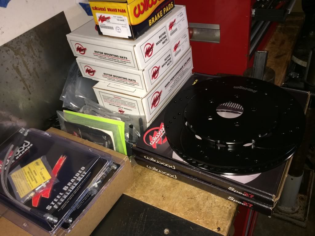

Brown truck dropped these off.

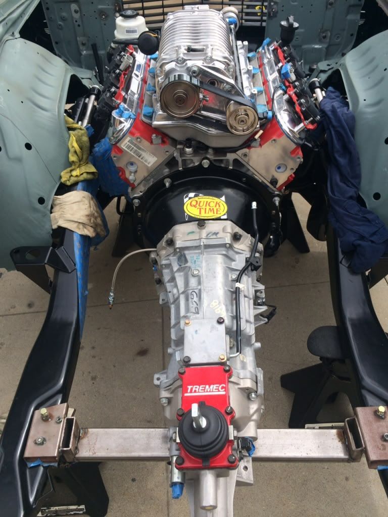

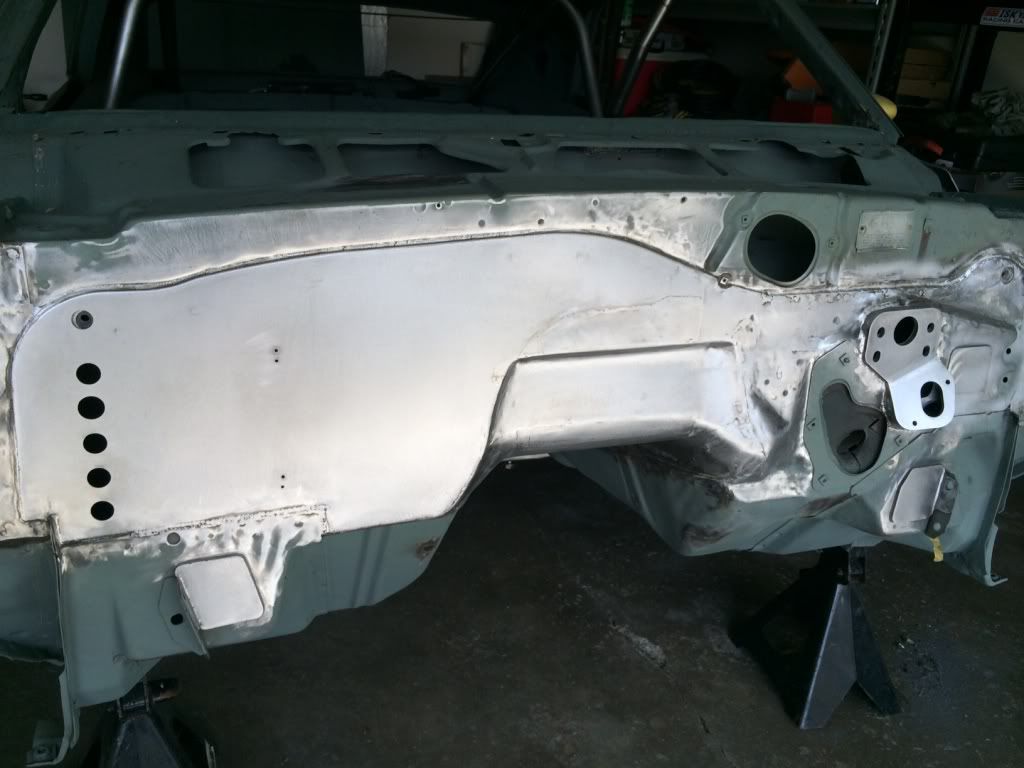

Got firewall done " again " minus a few holes. AC fits in perfect. Clutch bracket is set. Cut trans cross member a bit. Looking for a good entry location for engine harness and battery cable. Put it all back together to double check clearances.http://i1232.photobucket.com/albums/...ps67c70553.jpg

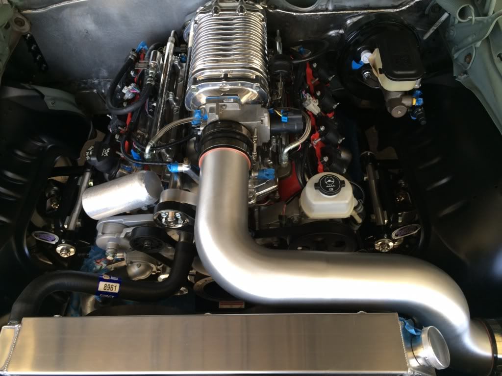

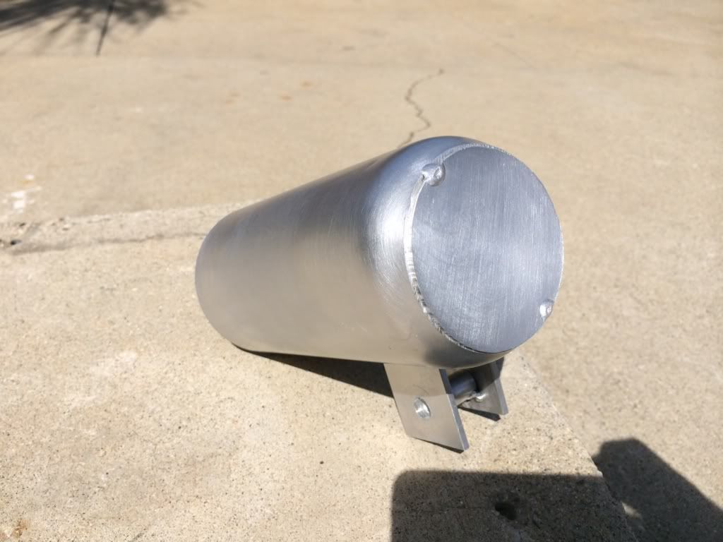

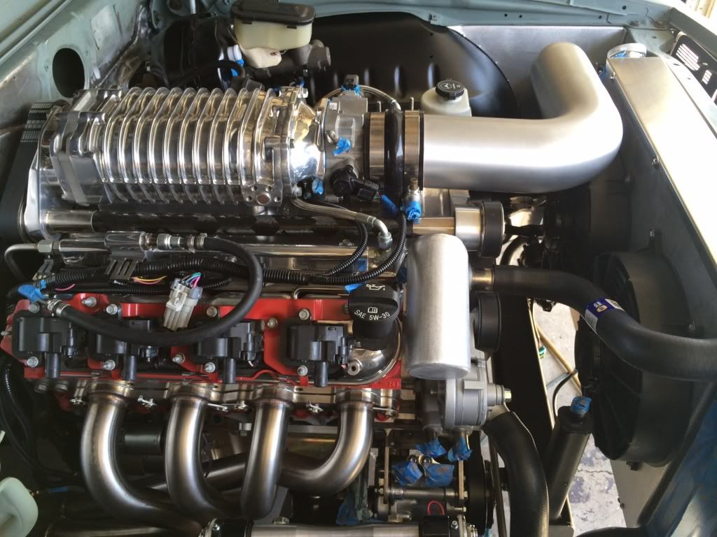

So I got a bunch of other stuff done . Centerforce aluminum flywheel and dual friction clutch is done , mastmotor sports oil pan is in , oil filter relocation unit from JCG ( tx Chris ) .filter& AN oil lines done , power steering lines ( tx XRP ).

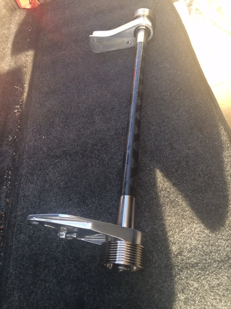

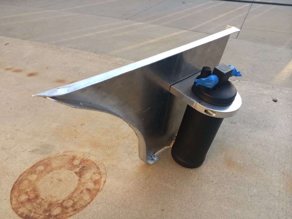

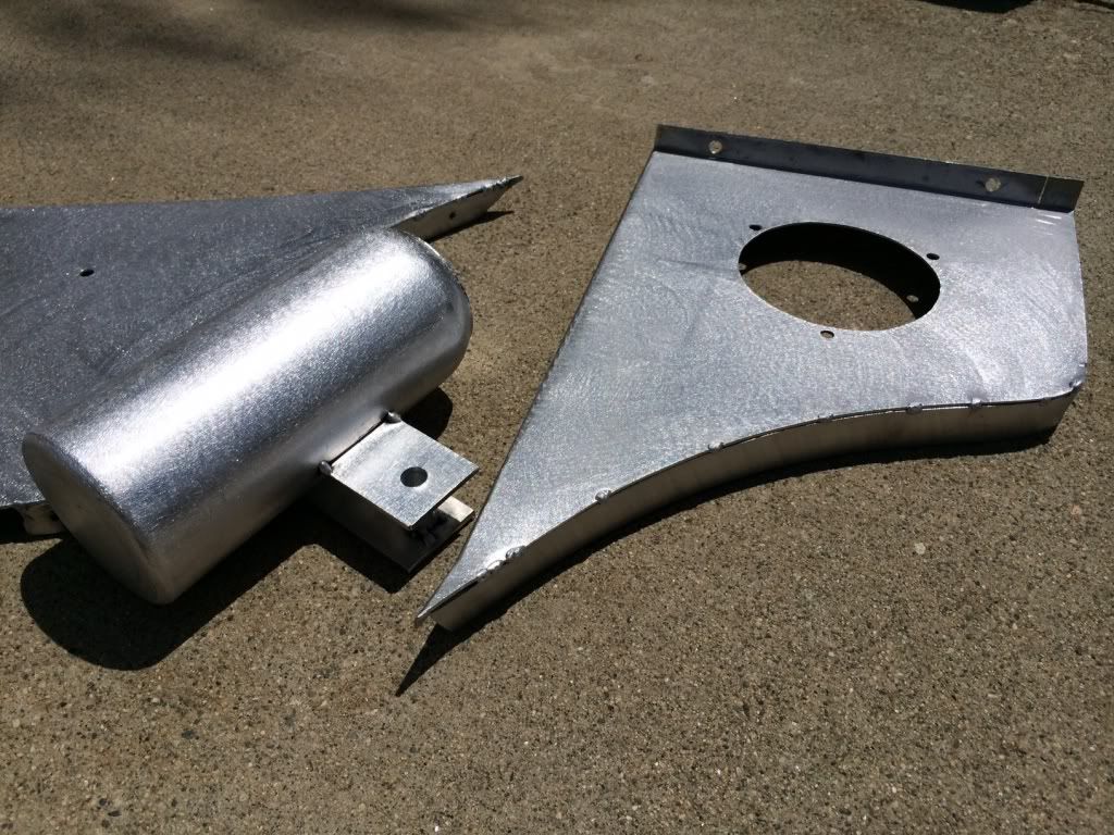

AC and heater lines , ran and plug harness to make length adjustments , built a cool bracket and location for + power block. Built aluminum close out panel to match passenger side, it also holds AC dryer. Upgraded to carbon fiber SC shaft and smaller pulley, AC condensor is done , heat exchanger clerance position and mods done , building an expansion tank from an old AC dryer.

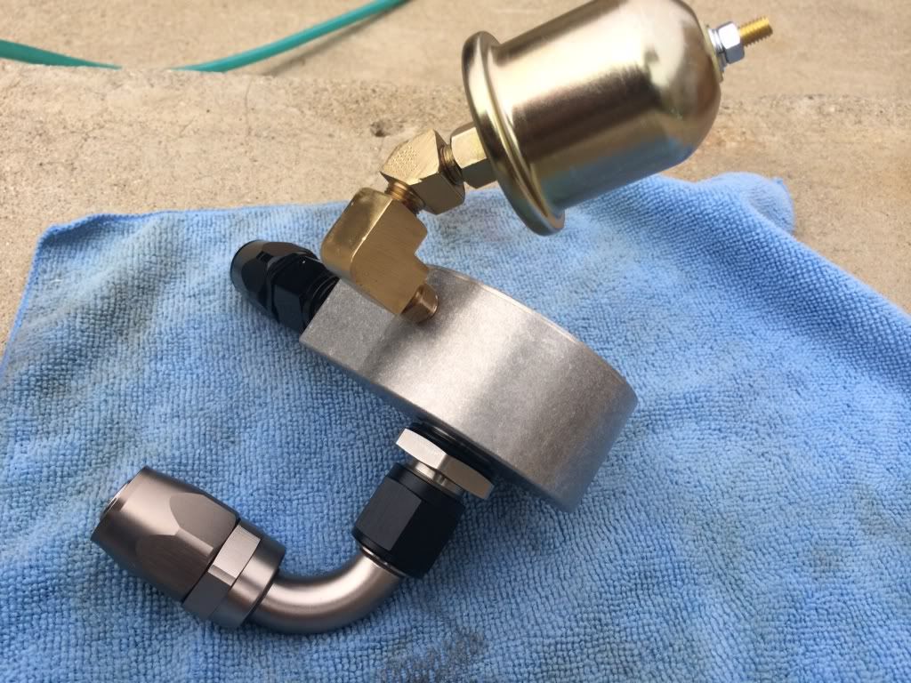

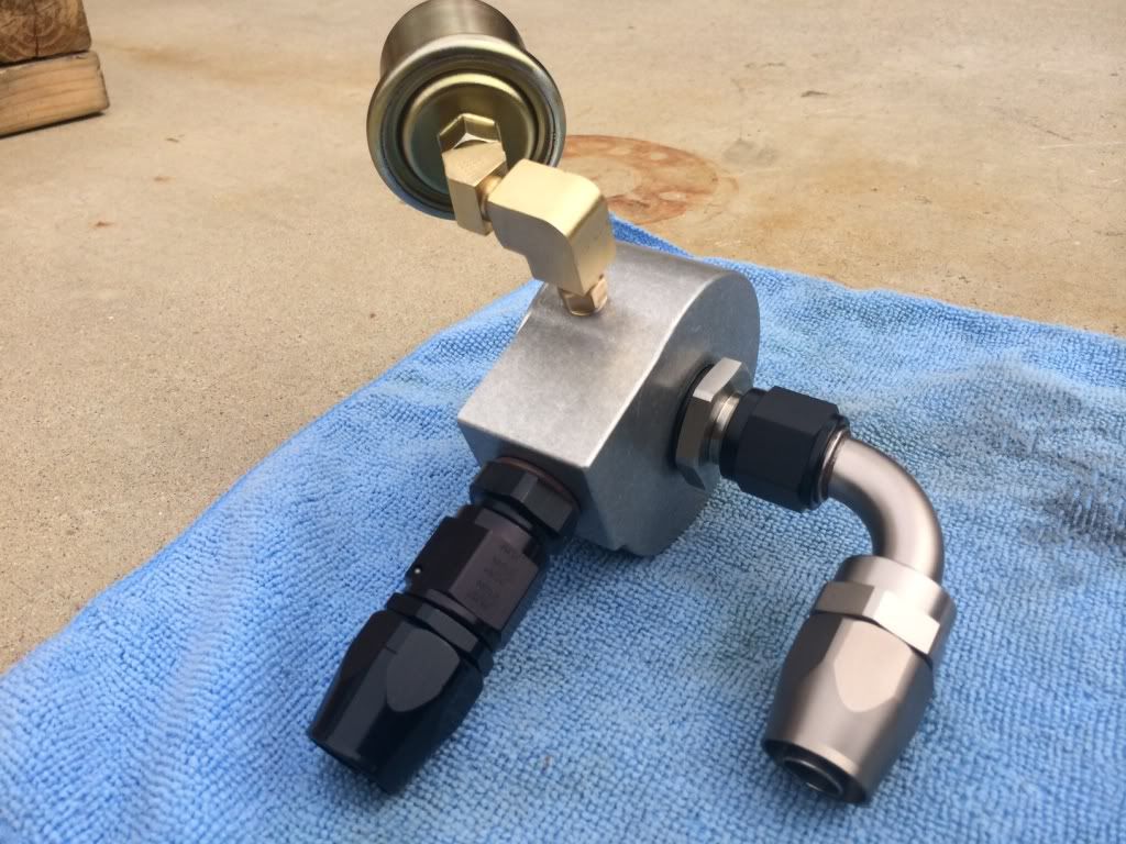

Hope to get accurate oil pressure reading on this
http://i1232.photobucket.com/albums/...psbb6bd9aa.jpg
Was able to squeeze this guy in there ( tight fit with headers )
http://i1232.photobucket.com/albums/...ps88845630.jpg

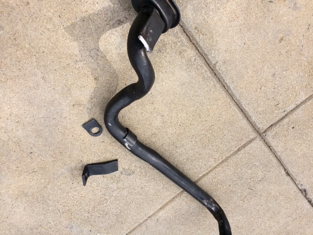

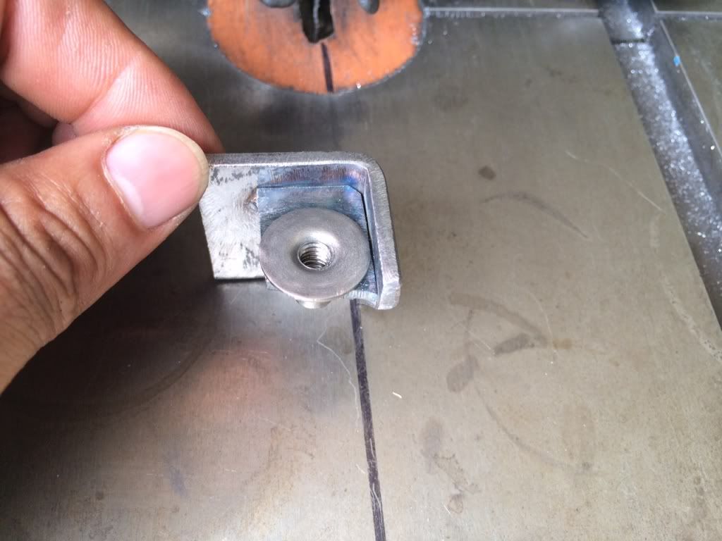

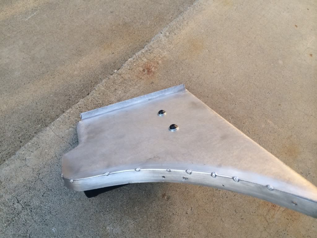

Those two screws will get deleted. Got a miller spoolmate can't weld but can tack. Will send to a buddy for tig ( make it pretty )

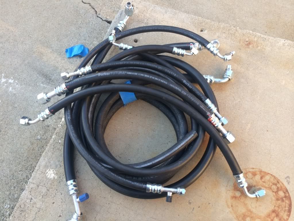

Pile of hoses
