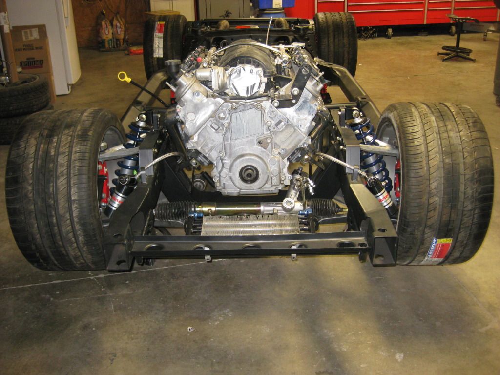

Big tars on the front are just sexy. Looks good Scott.
:thankyou: Just following down your path.:thumbsup:

JB64CHEVELLE 02-08-2013 09:23 AM
Have you ever thought of putting this front together in a kit form for guys to clip the fronts of there Chevelle. This one is great, I just wish I could stuff 275 on the front of my 64 Chevelle.:thumbsup:
214Chevy 02-08-2013 10:13 AM
Scott, that front shot if the frame is just so mean looking. Great progress...keep going!! :thumbsup:
coolwelder62 02-08-2013 10:49 AM
I can build this clip as a weld in unit only.If you want a complete chassis,Rodger @Ironwork's build's those.I don't want to step on his toe's.Later on this spring I am going to build a jig to do the weld in clip's.They will run about $4500.00 shipped w/a splined sway bar,bent sway bar arm's,end link kit,hardware kit,Ride tech coil over's,dropped steering arm's,and Instruction's & temp holding jig.It will use std C-6 componet's,and DSE Or fox bodied rack.:thankyou:
JB64CHEVELLE 02-08-2013 11:55 AM
That's very tempting. I have the DSE speed kit 3 now but would love to get a good size tire up front. Keep us posted on the weld in kit and I will keep :G-Dub: on it!
dave96dcm 02-11-2013 09:25 AM
Forgive me if it was already mentioned but what will you be running for static caster and camber?
coolwelder62 02-11-2013 10:10 AM
The camber will be set at 1degree neg.caster 5.5-6degrees.The upper A-arm bolt's are not tight in these photo's.
