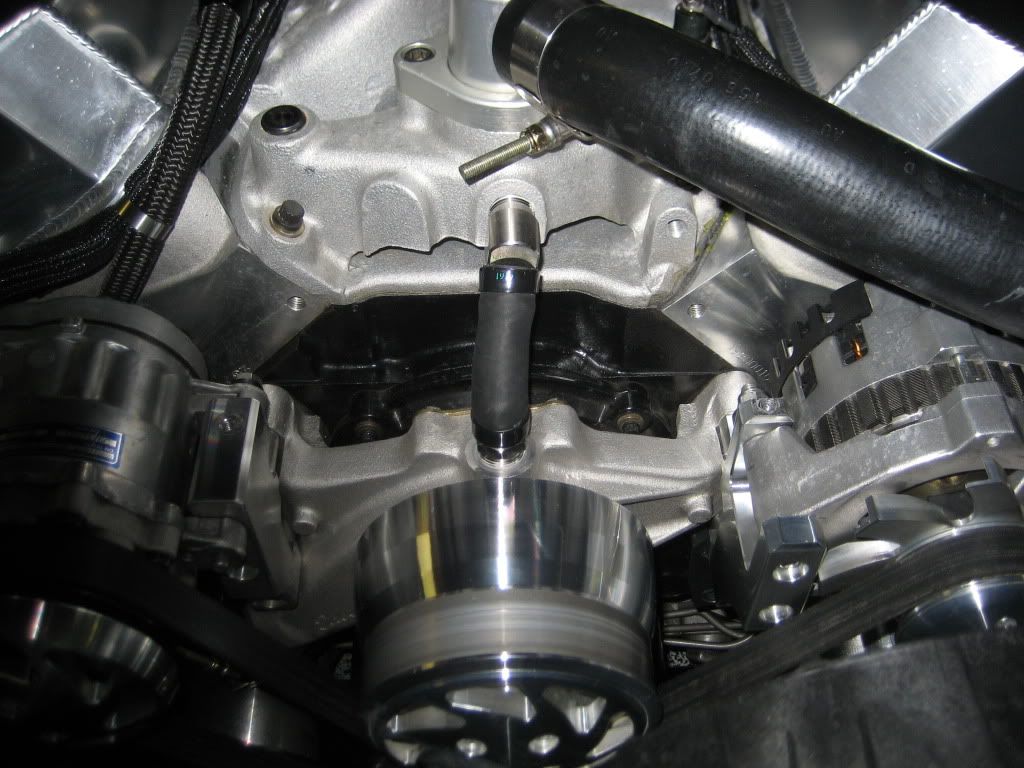

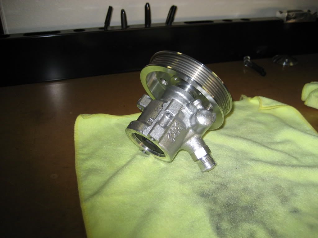

I'm back on the road as of tonight. I couldn't just replace the power steering pump. I had to make a couple other changes.
The turn one pump wasn't up to my standards cosmetically. It looked like it was painted, then assembled. I got some high temp aluminum type paint and think it turned out pretty damn nice. Almost to nice compared to my cast accessories. Anyway, the pump is working fine. I like the finish so much, I wouldn't mind painting my block this color. I also now have AN connections on both ends of my feed line with matching hose to my oil, fuel, breather hoses. Turned out really nice.
http://i200.photobucket.com/albums/a...1969/002-7.jpg
I've had an intermittent air bubble since I've built the car that belches and makes a mess. It's happened after 5 miles and after 75. I found that plugging off the hose from the intake to the water pump is more than likely the problem. I did it for cleanliness and so I could use my Payback plate. The purpose of the hose is to allow the water to circulate through the block while the t stat is closed. It's also supposed to prevent water pump cavitation while the stat is close. To end a long story I couldn't just use hose clamps and some cheap fittings. I had to buy stainless fittings and shrink clamps. Turned out pretty cool. Now I just need to redesign another plate and the march plate will go on for a while. The plan is when I go to my Ron Davis radiator to go 16AN hose and fittings on both radiator hoses.
http://i200.photobucket.com/albums/a...1969/003-7.jpg

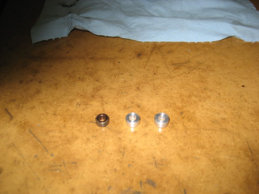

Always chasing the best drivability with a holley carb. I found a guy that makes custom advance bushings. I tried the largest but it locked up my advance which I don't want. I had to pull the distrubutor to get that little booger out once it locked up the advance. It afforded me the chance to check my distributor gear wear. I had a bronze gear failure about 900 miles ago which was the wrong gear installed by my engine builder. The new melonized gear looks perfect. Anyway, I installed the second largest aluminum bushing which allows me 23 degrees initial timing with 36 total. Car like all the initial I can give it. I had the largest bushing from MSD which is 18.
http://i200.photobucket.com/albums/a...1969/006-3.jpg
