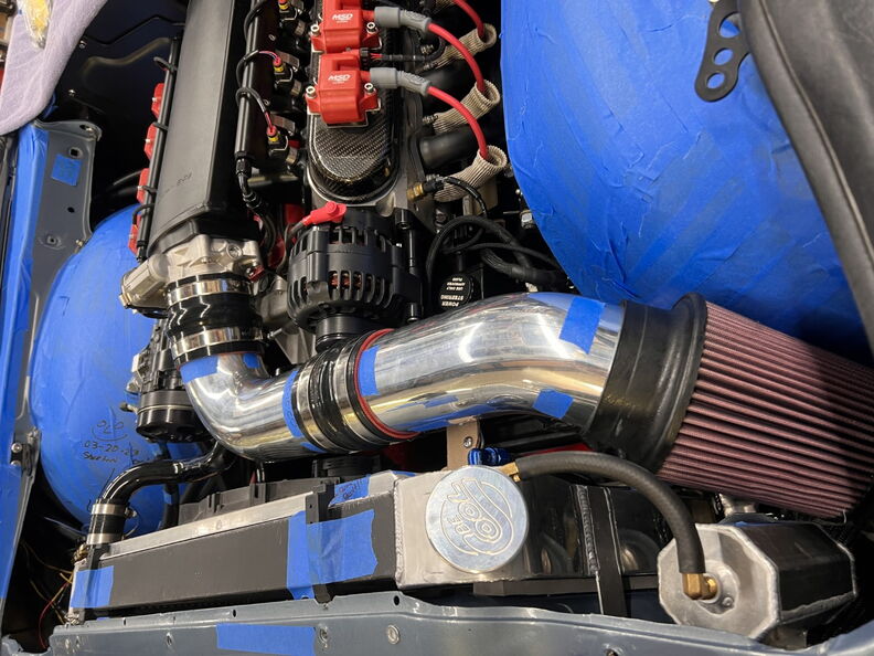

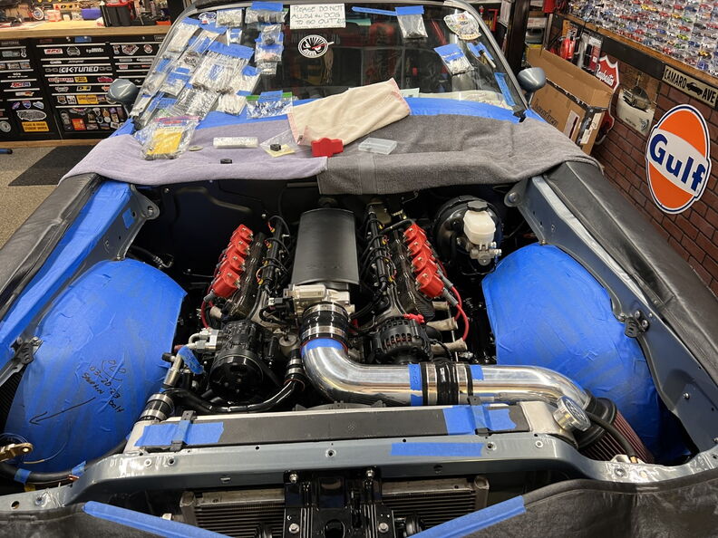

Mocking Up the intake tube for the last time before I make the final cuts.
http://garagescene.net/_data/i/uploa...881a5c8-me.jpg I need to take off at lease an inch off of the end going into the throttle body and at least 2" off the end going into the hump hose by the radiator. http://garagescene.net/_data/i/uploa...e69935f-me.jpg You can see that I will also be cutting the 2nd half of the intake tube as well. http://garagescene.net/_data/i/uploa...3b16157-me.jpg |

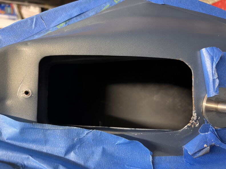

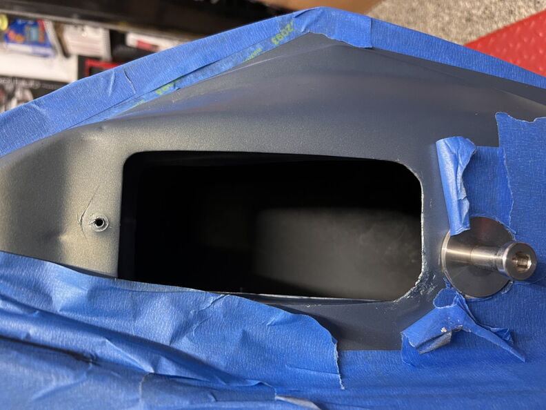

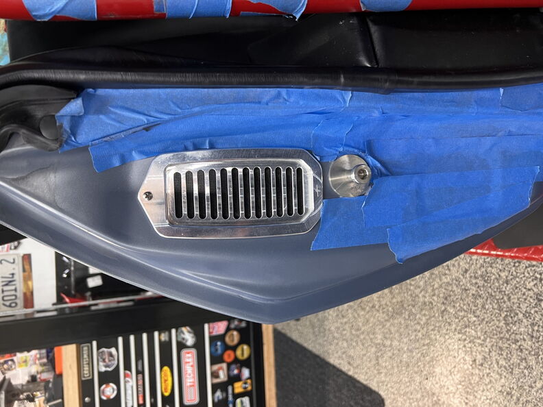

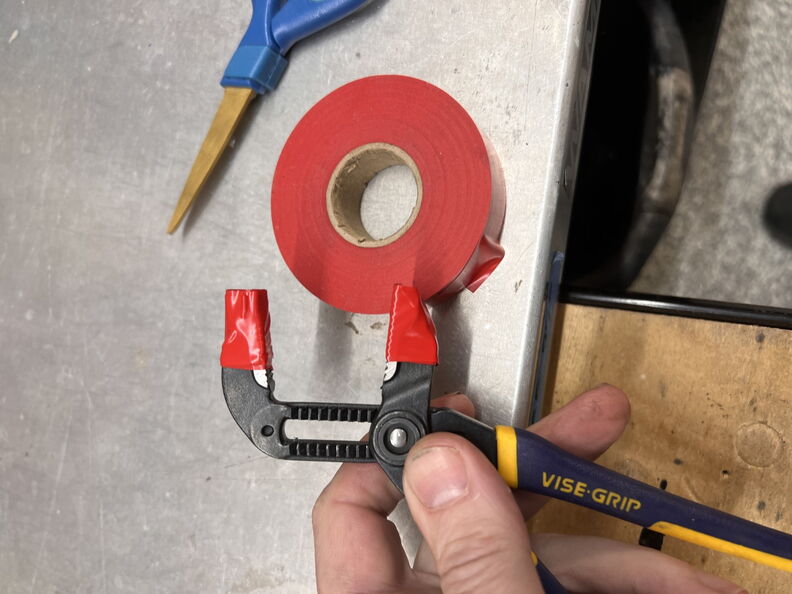

http://garagescene.net/_data/i/uploa...c5417f1-me.jpg Somewhere along the way of me sticking my hand in this hole the paint got chipped and the metal got a little bent. http://garagescene.net/_data/i/uploa...4b5a261-me.jpg I modified my Vise-Grips as not to cause any more paint damage. http://garagescene.net/_data/i/uploa...b6418aa-me.jpg Good Enough http://garagescene.net/_data/i/uploa...48d3b8a-me.jpg http://garagescene.net/_data/i/uploa...abb27e0-me.jpg |

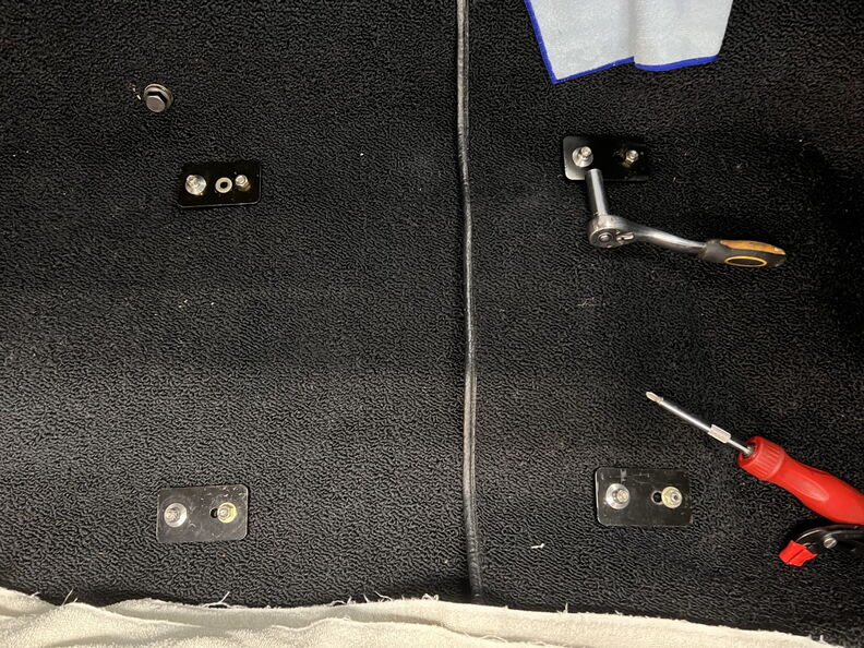

Seat Set Back Plates (( 06-16-23 ))

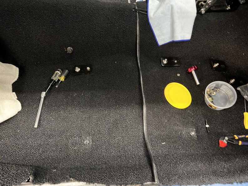

Okay, Yes I know I am short however I like to sit back from the Steering wheel and apparently I drive with the ball of my foot.

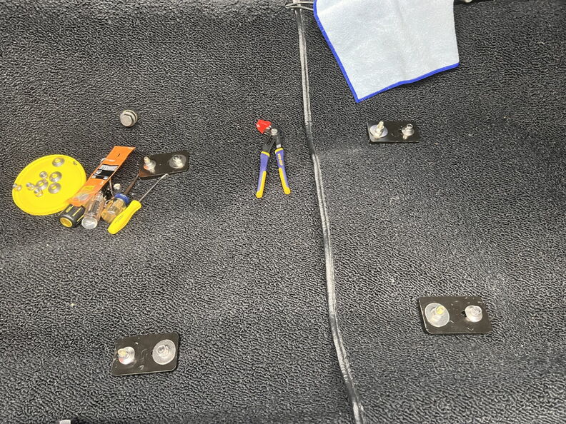

http://garagescene.net/_data/i/uploa...a219906-me.jpg They say it is all about the details so the Zinc coated bolts are going to have to go. The funny part is the only people that will ever notice the Zinc coated bolt will be the people looking at the underside of the car. http://garagescene.net/_data/i/uploa...e442276-me.jpg The main purpose is to have studs so I don't have to try to get the bolts into the floor through the carpet. I also like the idea of not having to kneel on the seat stud. |

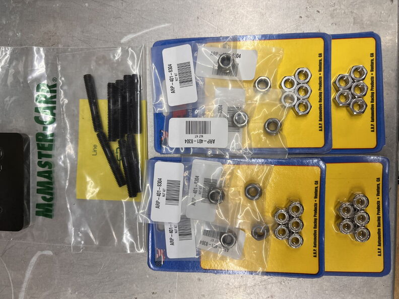

Seat Studs (( 06-24-23 ))
Continuing on with the Seat Stud Project.

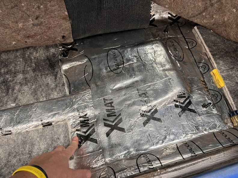

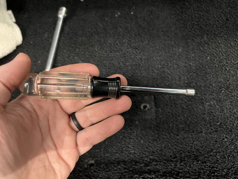

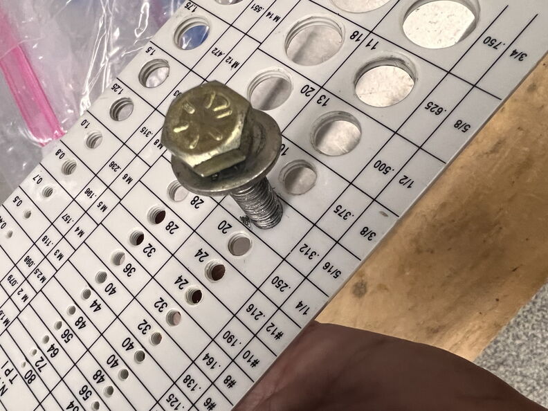

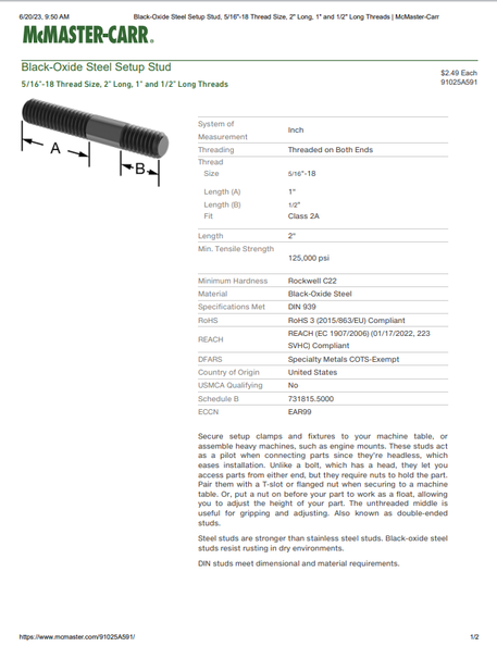

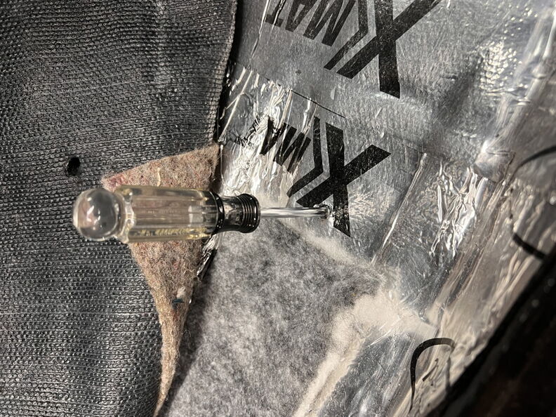

Here is what I came up with. http://garagescene.net/_data/i/uploa...f443ab0-me.png http://garagescene.net/_data/i/uploa...8a81488-me.jpg http://garagescene.net/_data/i/uploa...805864b-me.jpg Since, I am using studs I will need to make sure none of the sound deadening in the threads. The tool of choice is a nut driver and all you have to do is gently move the sound deadening back. http://garagescene.net/_data/i/uploa...519dcdf-me.jpg Just stick in the hole and wiggle it around. http://garagescene.net/_data/i/uploa...f0e27be-me.jpg Studs are in now i just need to smooth back the sound deadening. http://garagescene.net/_data/i/uploa...824d88a-me.jpg Quick trip to the local Ace Hardware for some fender washers. http://garagescene.net/_data/i/uploa...98adc10-me.jpg Brackets are back in. http://garagescene.net/_data/i/uploa...3803057-me.jpg |

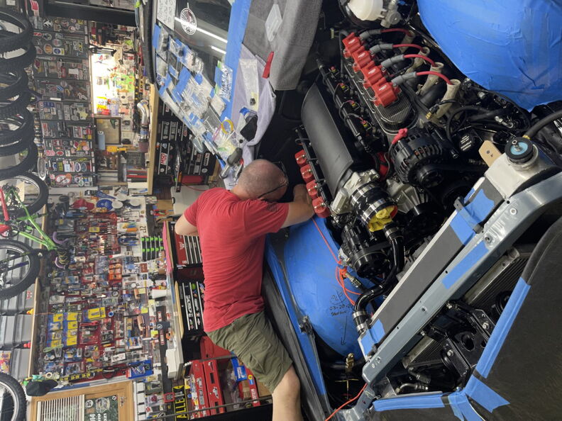

Today I will be working with the one arm man. I needed to get him out of the house so he could feel somewhat human again.

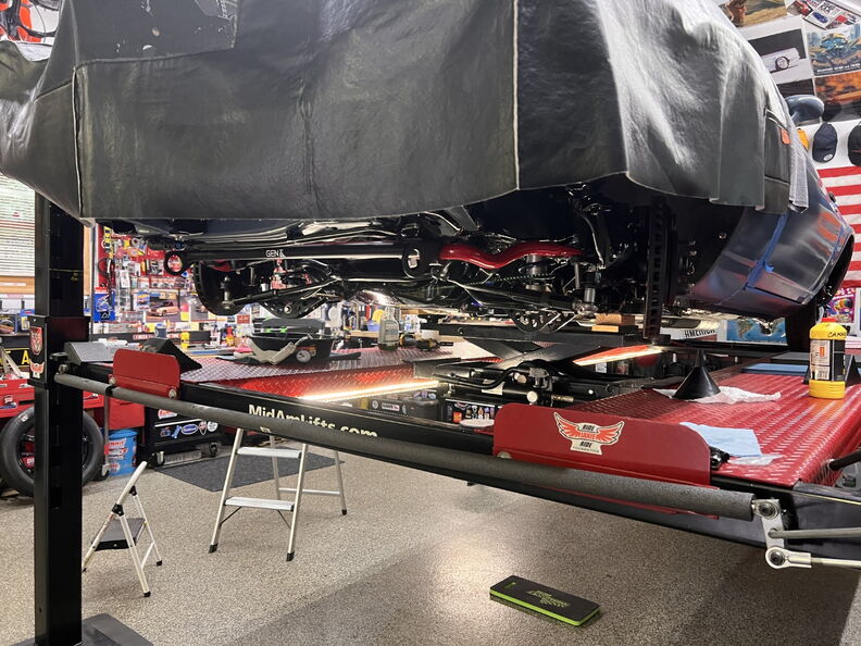

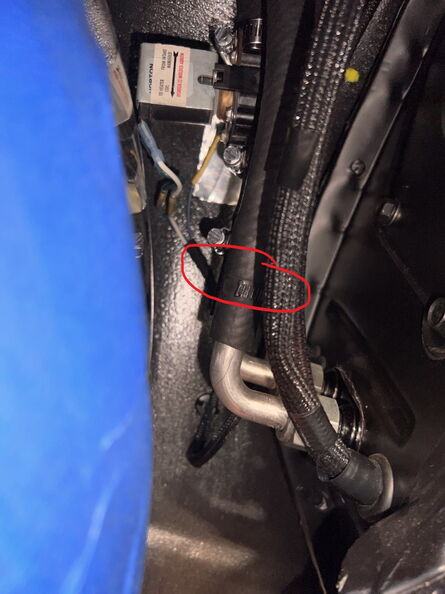

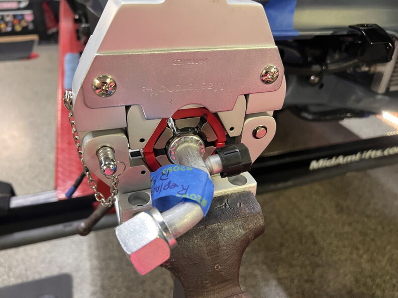

Since the line was in the car and I wasn't removing it we went to plan "B". We ran the line through a small hole right above the inner fender and out under the headlight. http://garagescene.net/_data/i/uploa...75144e0-me.jpg We raised the car up just high enough to let the line reach the crimping tool. http://garagescene.net/_data/i/uploa...b8d5558-me.jpg Finally crimped and attached to the AC compressor. http://garagescene.net/_data/i/uploa...7cbe0f1-me.jpg Next Up filling the car with distilled water. http://garagescene.net/_data/i/uploa...cf8f170-me.jpg |

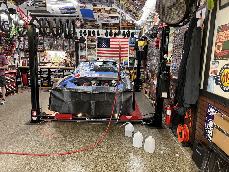

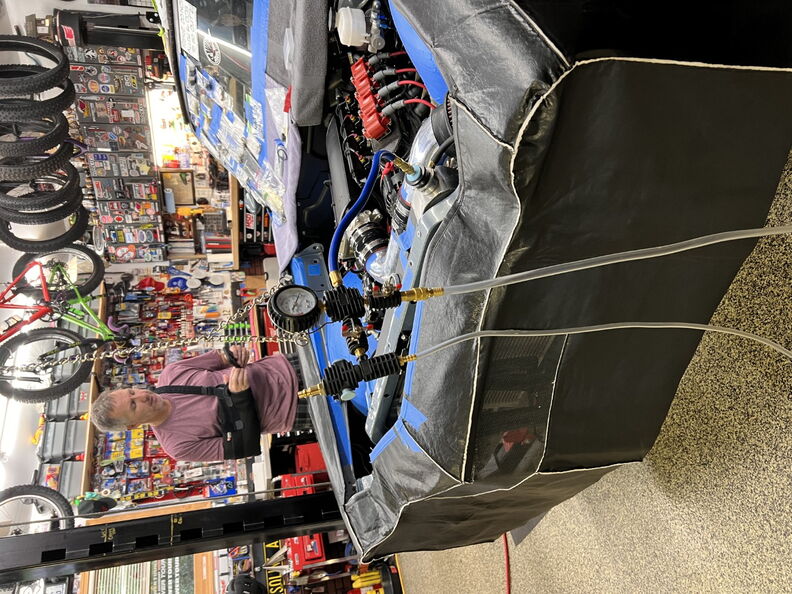

Vacuum filling the Cooling System (( 07-02-23 ))

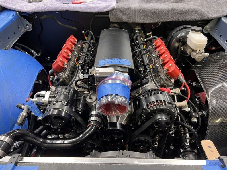

Let's just say this was a big learning experience.

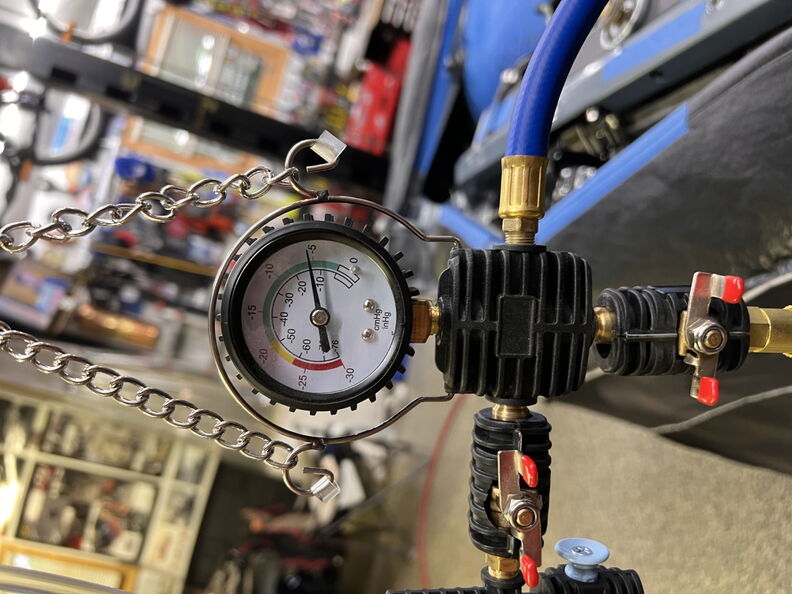

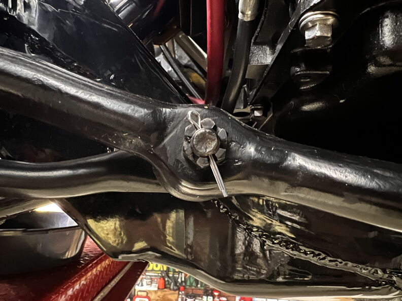

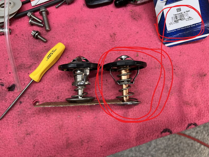

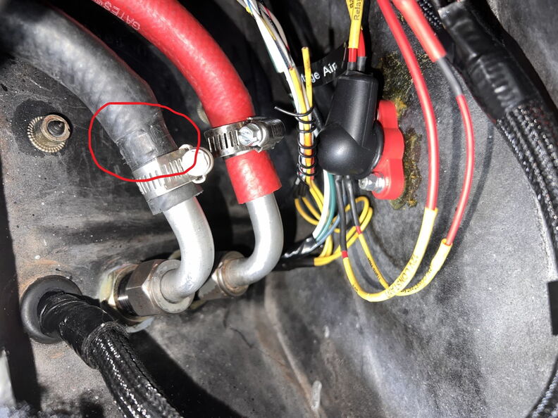

http://garagescene.net/_data/i/uploa...607b427-me.jpg Per the instructions we made all of the connections an applied Air to create a vacuum. Well, we were only able to get 5 bars which is not even close to the 20 we need. This meant we had leaks and most likely more then one. http://garagescene.net/_data/i/uploa...215cb8f-me.jpg Found leak number one. Apparently I had the clamp to close to the end of the hose which caused the leak. http://garagescene.net/_data/i/uploa...9fbdb09-me.jpg Leak number 2 & 3 had the same issue. http://garagescene.net/_data/i/uploa...9b94935-me.jpg yes this one sucked to get to http://garagescene.net/_data/i/uploa...4ba6fd7-me.jpg Years ago I made this block and it is the exact same height as the lift and man did it come in handy that day. http://garagescene.net/_data/i/uploa...897eea5-me.jpg I moved all of them down and this issue has been resolved. http://garagescene.net/_data/i/uploa...1543d89-me.jpg Next up with the thermostat housing. http://garagescene.net/_data/i/uploa...d515505-me.jpg http://garagescene.net/_data/i/uploa...f62f480-me.jpg Well, this one was all my fault. I picked up a thermostat for and LS1 not remembering that this motor has the Wagner front drive and a new water pump. So let's just say it leaked. http://garagescene.net/_data/i/uploa...2745633-me.jpg http://garagescene.net/_data/i/uploa...3c771c2-me.jpg Back to Filling and yes this to we hit 20 http://garagescene.net/_data/i/uploa...b6ae506-me.jpg http://garagescene.net/_data/i/uploa...3cfaff9-me.jpg Eventually I plan to add coolant so I am leaving the rope up for that day. http://garagescene.net/_data/i/uploa...f892537-me.jpg If you are only going to do this a couple times this is what I used. It is definitely not a commercial grade item but for $40.00 it worked. ADAFIRST Coolant Vacuum Refill Kit, Cooling System Radiator Vacuum Purge & Fill Tool Kit https://www.amazon.com/gp/product/B0...1?ie=UTF8&th=1 |
