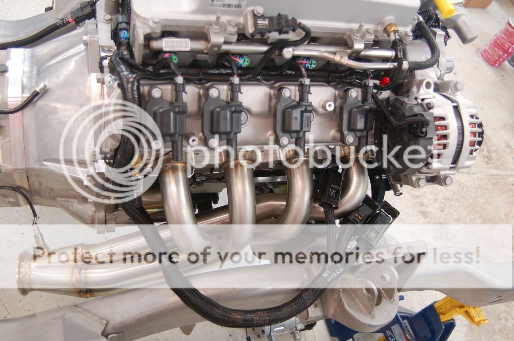

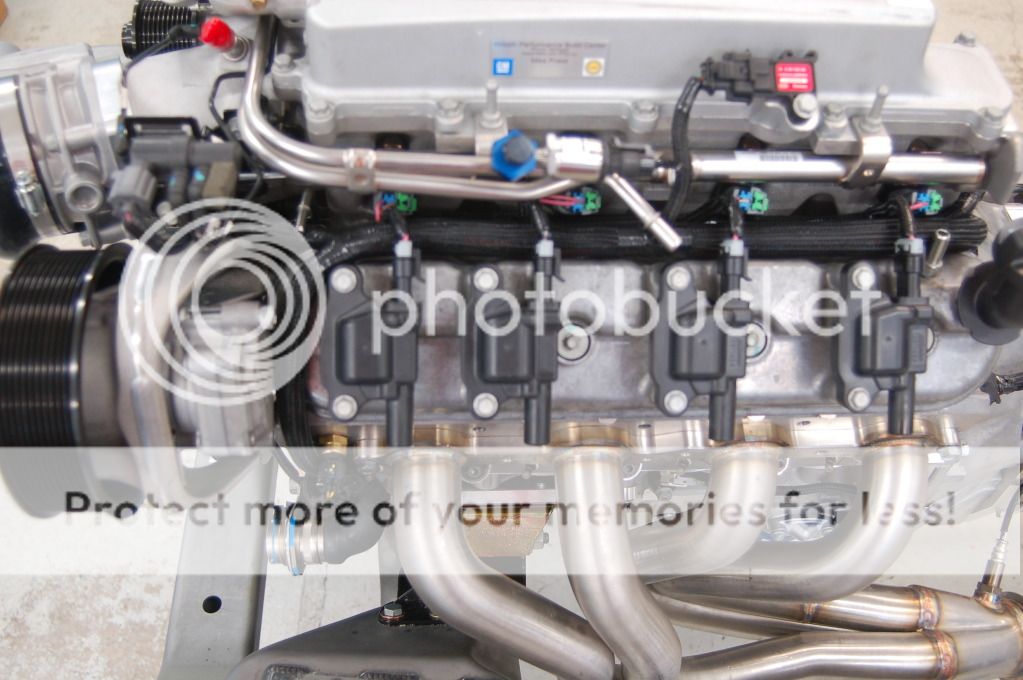

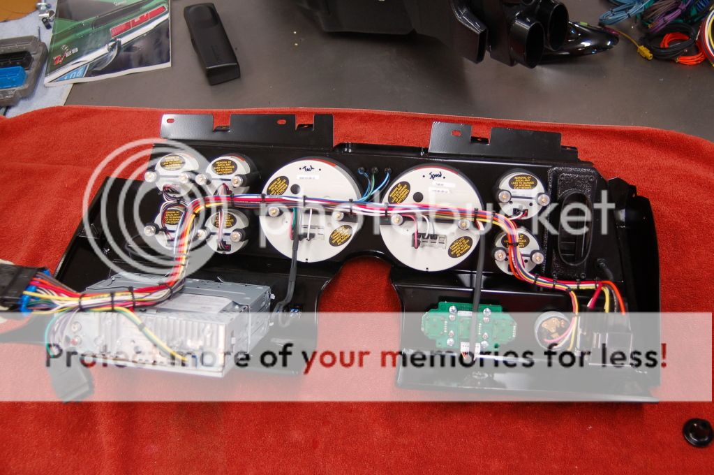

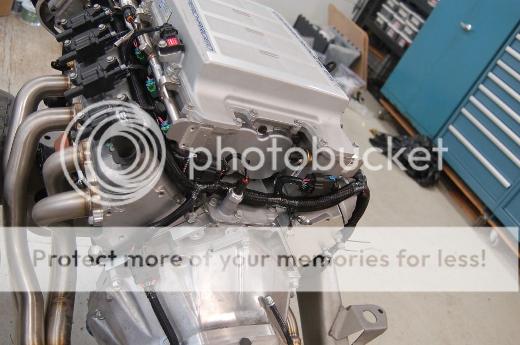

Engine harness, Dash harness and axle harness done. 80 hours work.......
http://i439.photobucket.com/albums/q...I/DSC_4323.jpg
http://i439.photobucket.com/albums/q...I/DSC_4322.jpg
http://i439.photobucket.com/albums/q...I/DSC_4321.jpg
http://i439.photobucket.com/albums/q...I/DSC_4320.jpg
http://i439.photobucket.com/albums/q...I/DSC_4319.jpg
Mark
nvmyss 07-15-2012 10:34 AM
Looks nice and clean.
coolwelder62 07-15-2012 12:38 PM

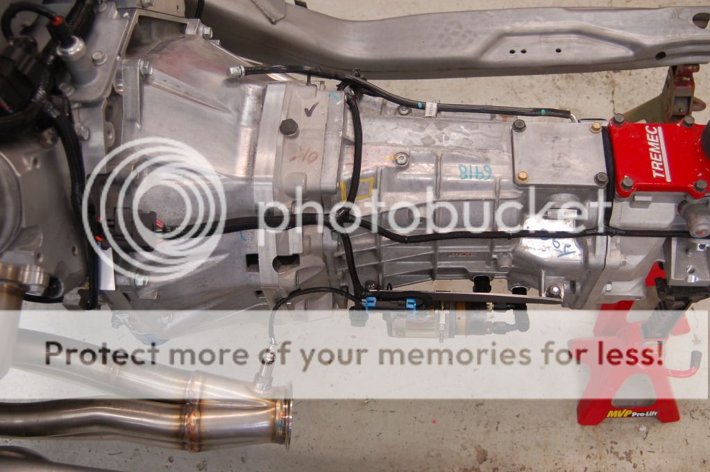

Mark,What is the spacer for between the bellhousing and trans.Is the clutch setup thicker than stock.Wiring is extra clean.:thumbsup: :thumbsup:
waynieZ 07-15-2012 12:43 PM
Beautiful work on the wiring, I love details like that.
Stielow 07-15-2012 12:52 PM
Originally Posted by coolwelder62 (Post 424919)
Mark,What is the spacer for between the bellhousing and trans.Is the clutch setup thicker than stack.Wiring is extra clean.:thumbsup: :thumbsup:
The spacer is .850" thick to allow the stack up to be correct to run a LS9 twin disk cllutch in front of a TR6060 with a 2002 style bellhousing. D&D Perfromance made the spacer and sells them.
I'm on the edge on the stock LS9 clucth but it drives great with very low effort and a great feel.
We build all the wiring from scratch. If you start with a GMPP LSA harness it is much easier.
Ryan Kuhlenbeck also wired Red Devil and we used that as a templete for this build.
The VanNus's (Dutchboys Restoration) is starting to shoot color tomorrow so I'm getting closer to getting the car back.
Mark :lateral:

Did D&D performance do any tricks on the inside of the transmission, or is it stock from the factory? Also I see an oil pump for the trans, are you just using the fill and drain ports to remove the oil or is there some sort of spray bar in there?
