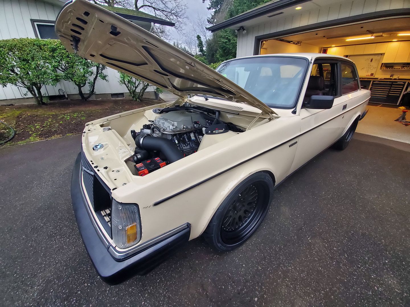

Thanks, thats kind of the idea behind my builds, how would the factory have done it but cleaner.
Its a 1983 volvo 242 DL. Yep, chopped down factory latch to work with the flathood.
Tinkered with the car this weekend a fair bit, did a lot of little **** that nobody cares about. Got the wiring redone for the VSS directly into the Racepak as well as pulled the wiring from the dash for the oil pressure sender. Apparently you cannot get oil pressure through can bus on this particular racepak dash.......even though everything I read says you can. I also can get oil pressure on HP Tuners so I know its available on the can network. Frustrated with that.

As I recall, I think (not fully sure) the e38 computer, at least in some applications, only sends a basic oil pressure signal that amounts to some or none, but not how much. This is why I went with a mechanical pressure gauge instead of trying to use the computer's input.

Where did you tap off of the engine for the oil pressure? Just curious and seriously thinking about a mechanical oil pressure and gauge.....the sender for the race pack is ****ing giant.

I used the G-Plus manifold (much like far higher-priced Mishimoto crud) thingy that goes above the stock oil filter location. Its four ports cover the gauge sender, turbo oil supply, and my oil cooler's in and out needs. It's the absolute pinnacle of Chinese manufacturing and value, and I say this in the most serious way possible. G-Plus stuff is freaking awesome--that's me being a product shill.
I still have the standard oil pressure thing for the computer behind the intake, I think . . .

I just ordered one before you posted this. I think its some chinese stuff but not sure who, I ordered from Summit. Gotta get the secondary switch installed and wired up this week so the racepak oil pressure works.

Chopped off the tailpipe next to the fuel tank and got to installing some more Vibrant U bends, V bands and the Borla Muffler.
It made a world of difference in volume and tone, there is no more drone and the car is plenty quiet. Sounds good at idle, quiet on the freeway.

Got the brakes bled and rolled the rear fenders a little more for some reason the rear axle creeped forward a little bit so I extended the lower control arms to push it back by .125".
Then I drove it, I put fuel in it and drove it. I drove it to Wilsonville for Cars and Coffee and back home, tweaked the rear a bit, checked the fluids, retorqued the wheels and checked things, ran some errands in it, drove out by the air port for a car meet with the stance kids to check things out. Went over it again to check for things to be tight and normal. I adjusted the shifter to better fit seating position and its dialed now.
Then I took it out and actually "drove the car" its good, torque is really good, pulls to limiter. I have a little bit of a soft pedal, think I am going to go through and rebleed the entire system this week and make sure I dont have any remaining air in there. The brakes work great, but pedal has a little more travel than it had before pulling and swapping the rearend.
