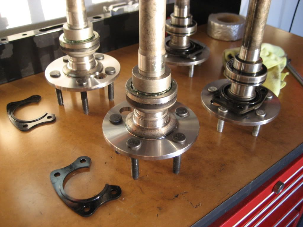

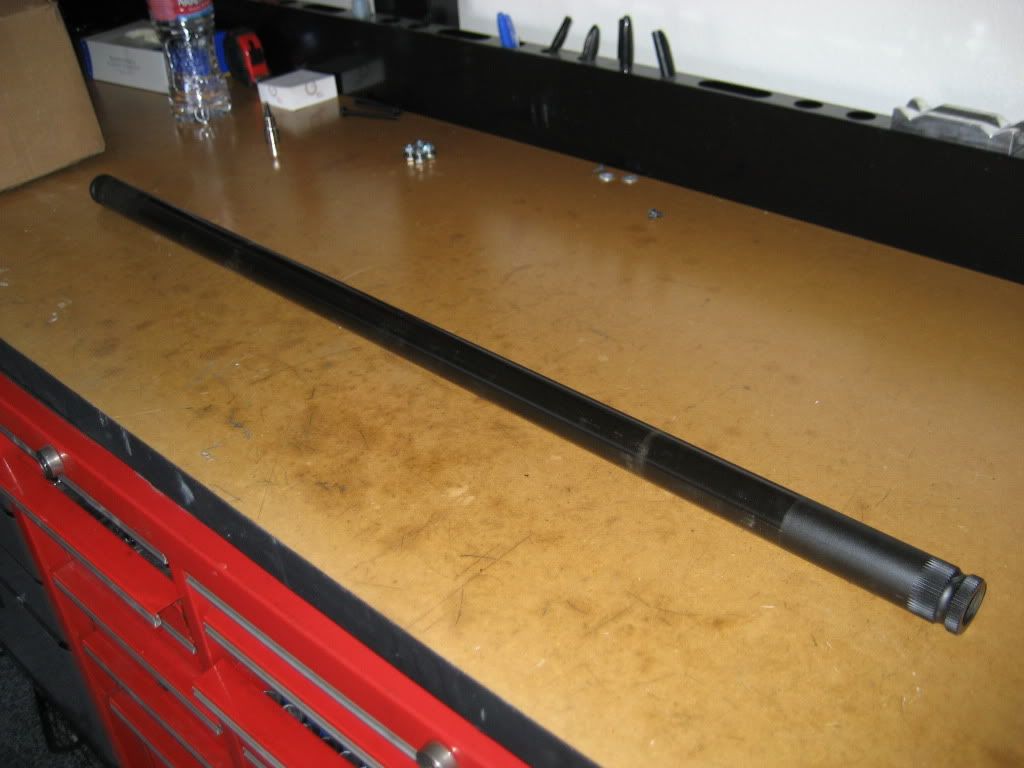

I recieved my new Moser 33 spline axles with tapered bearings tonight. How foolish to think I'd be cruising tonight. :rofl: The are machined wrong for my brakes and ultimately backspacing. The bearing needs to move towards the axle flange. They are only .100 off but I'll either need to find a local shop that can turn down the axles another .1 or send them back to Moser. Driving to the Optima challenge isn't looking to promising to say the least. The good new is there is NO end play now. I also have the updated Wilwood plates pictured that were redesigned with a taller lip and thicker material. They were nice enough to send them to me for free fo rall my trouble in the past.

Vegas69 10-29-2009 09:54 PM
I'm not going to pay to overnight axles just to drive out there. It's not like I'm racing. I could stick the old axles back in but I already removed the axle seal on the passenger side since the tapered bearing are lubricated with gear oil. If it happens, it happens. I decided to save myself a few bucks by using the wilwood plates vs. the currie plates pictured on the old axles. Of course I measured to make sure the tolerance was the same. I would've needed to pay to have the old bearings pressed off and the new tapered bearing pressed on. I'm interested to see why Moser machined this set differently. Stay tuned...

Well Moser stepped up to the plate and said the axles must have been machined wrong. They are going to cover shipping both ways and new bearings. I quadruple checked measurments and they will go back for have an additional .095 shaved off them. It's a week each way for shipping plus a week for machining. I put it back together yesterday so I can drive it in the meantime. I just happended to have an extra axle seal in my spare parts box. This is the best time of year and I don't want to miss the optima challenge in the car. So I'm back in business and swapping axles isn't that big a deal.

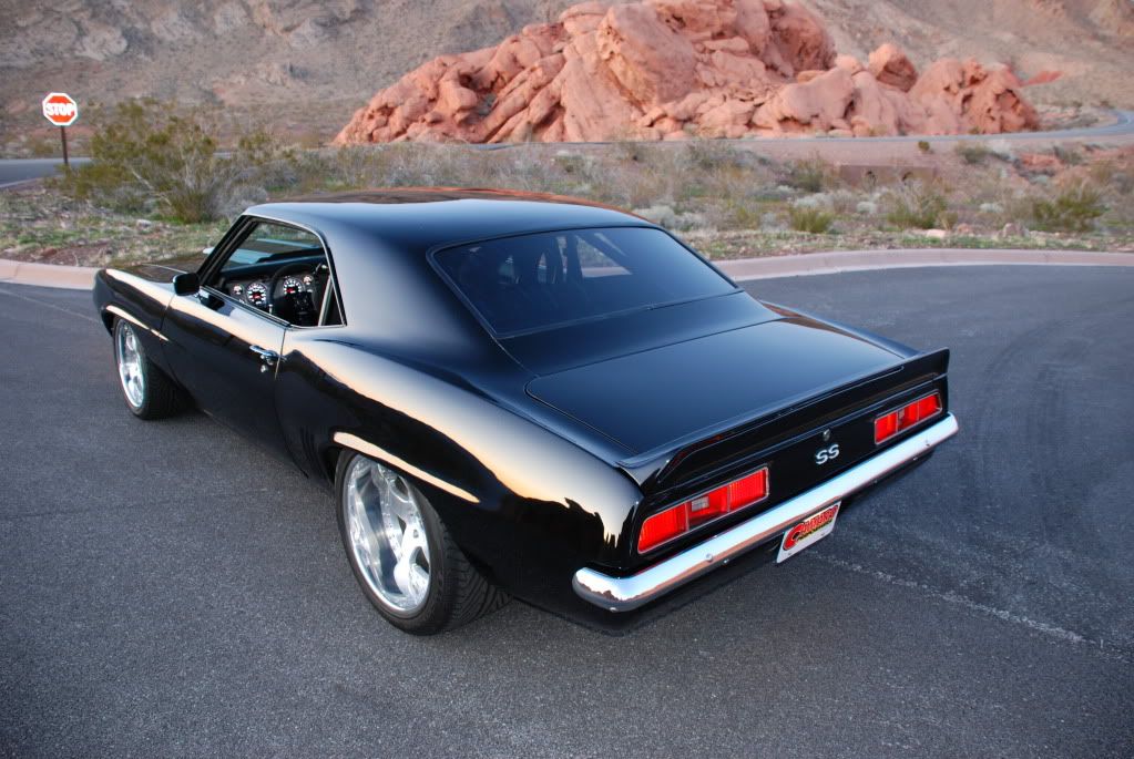

Vegas69 11-18-2009 05:28 PM

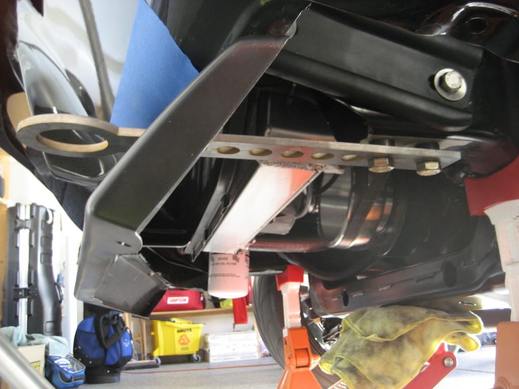

I've got my tow hook fabricated and ready for paint. I drew up a sketch and stopped by my trusty water jet guy. I alos cut the spacers and ground them down to size. More work than it looks like! I have a new spoiler on the way and will notch it. My current is broke on the passenger side anyway. It will be fire engine red. I'll post up some photos when it's done.

waynieZ 11-19-2009 12:56 PM
That picture DFRESH posted the paint looks awesome arrow straight too. Nice job on the tow hook.
awr68 11-19-2009 04:45 PM
Nice work Todd!!
tony byram 11-19-2009 06:04 PM
That car is beautiful! Laser straight! Kudos on the paint! :thumbsup:

I must have missed what prompted you to switch to a new tapered axle bearings.....and new axles. What is the advantage to those bearings?
Vegas69 11-19-2009 09:31 PM
I'm getting mild brake pad knock back on the street and wicked knockback on the track. Tapered bearings are designed to take a side load better. The axles showed up today and I'm racing next Sunday so I'll report back my experience.:thumbsup:

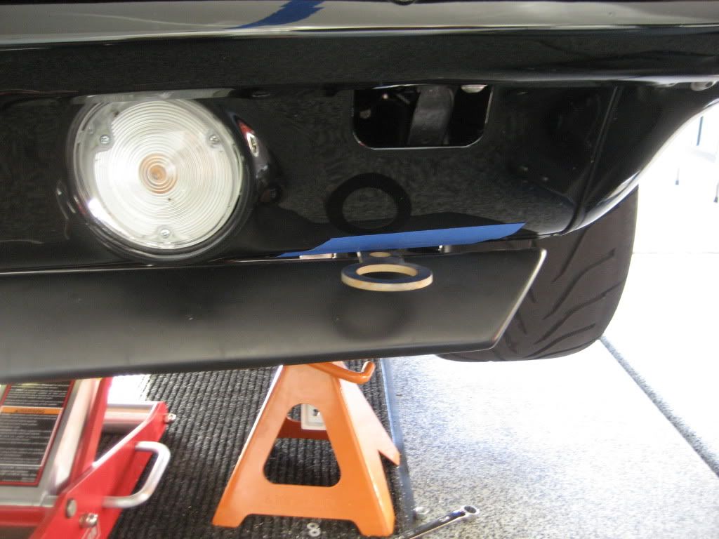

Finally recieved my new spoiler and was able to install my tow hook after some drilling and notching. I'm diggin it!

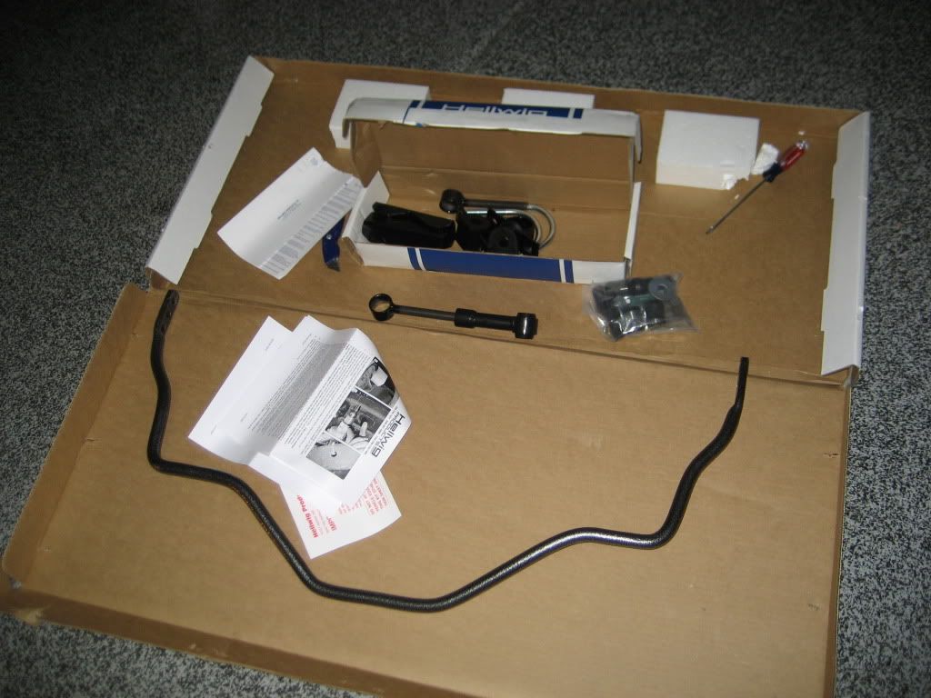

I decided to start really fine tuning the car. I bought a larger front sway bar and also purchased an adjustable rear sway bar from Frank @ Prodigy. The new front bar is installed but the rear won't make it on for the race Sunday. The end links won't work for me due to my fuel lines so I'm using some custom bracket and my own end links yet to be determined. My goal is to loosen the car up some when I autocross.

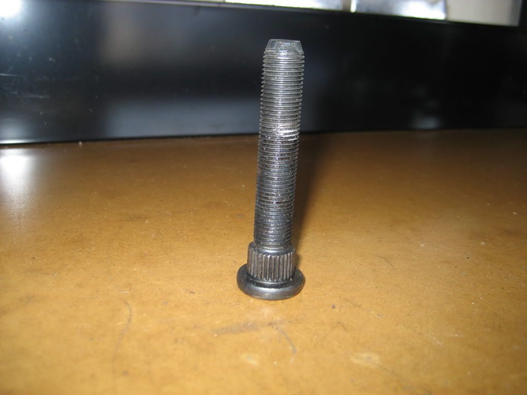

My new tapered bearing moser axles came back in after they were re machined. They fit perfect with my brakes now but one of my studs got boogered up in the lathe so I had to swap out one stud. Of course I had the axle bolted in when I noticed. :mad: They are in and the brakes are back together. She's almost ready for the race Sunday.
