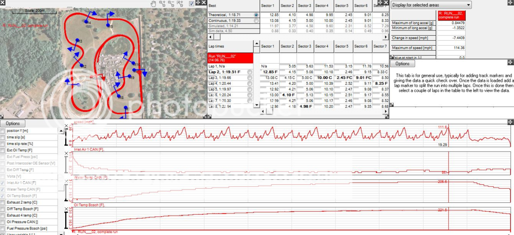

We had a good test at Waterford. I had some good data and some not so good data.
The cooling system worked great.
The ambient air temp was 87 F. On a 15 minute session the oil temp stabilized at 207 F and the oil temp was 231 F.
http://i439.photobucket.com/albums/q...psikmgi5mp.png

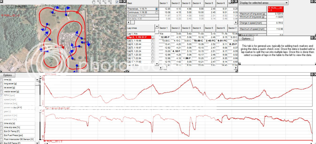

Now the bad news the fuel pressure is still falling off with high load.
http://i439.photobucket.com/albums/q...psqaj3kuxz.png
All this data is off my built in Race Technologies dash. It is nice to look at data after the test and have to relay on looking at the dash.
will69camaro 09-08-2015 06:55 AM
That's an excellent output for the track day. Got some decent logging done.
Oil/Water temp look great for the temp and track duty. What is your prediction on the falling fuel pressure?
Stielow 09-08-2015 10:48 AM
The car voltage is staying rock solid at 13.4 volts. I think I need to add another boost a pump or go to bigger fuel pumps. I will add two channels to my data logger to look at voltage at the pumps and make sure that is not the issue.
I also need to check the calibration of the sensor. I have chased data before to find out it is a sensor.
The learning curve on the fuel system on the E-85 has been a little rough but the results on track look very good so I’m sticking with it.
On the positive side the C&R cooling stack look like they work well and the bigger intercooler bricks are also keeping the inlet air temps down.
Mark
