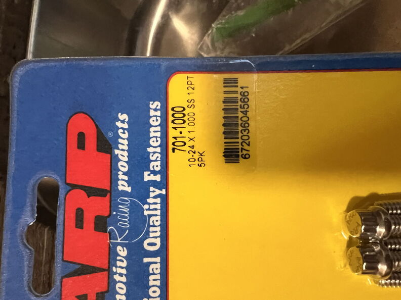

Door Pull Hardware (( 08-04-23 ))
Sticking with the ARP theme I ordered more bolts.
These will be used to Red Pull Straps.
http://garagescene.net/_data/i/uploa...ce728d9-me.jpg

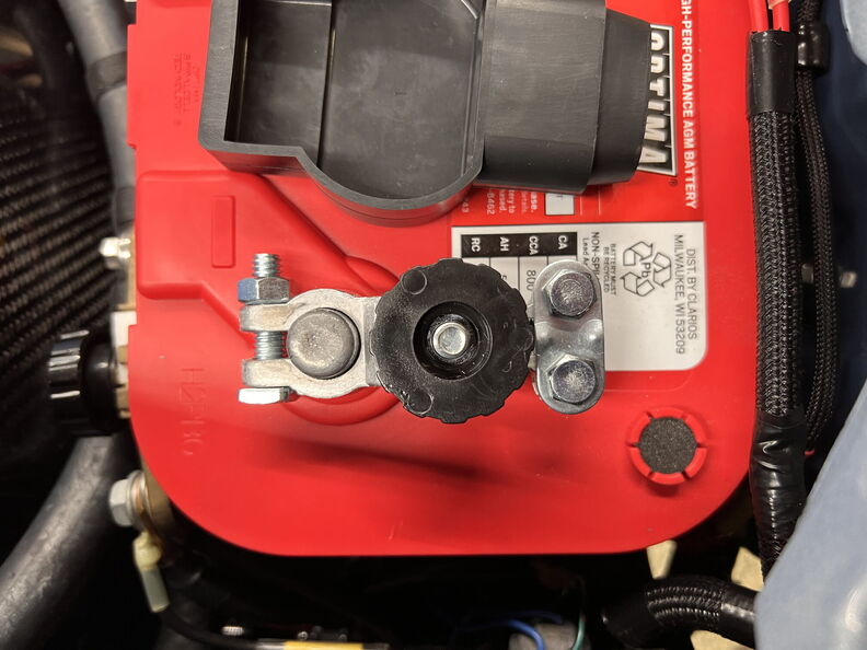

Final Battery Wiring (( 08-05-23 )) Well Maybe ???
Trying to decide if I want to move the battery shut off to the top or leave it on the Side Posts.
http://garagescene.net/_data/i/uploa...91de067-me.jpg
I also noticed it was bent and preventing which was preventing it from actually killing the battery.
http://garagescene.net/_data/i/uploa...7efa8d0-me.jpg
I added SAE washers to the top post wires so they would stop moving when I tightened the bolt.
http://garagescene.net/_data/i/uploa...fd4ea5b-me.jpg
http://garagescene.net/_data/i/uploa...aeff106-me.jpg
http://garagescene.net/_data/i/uploa...0075124-me.jpg

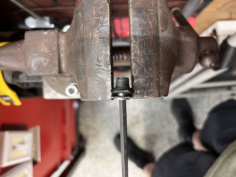

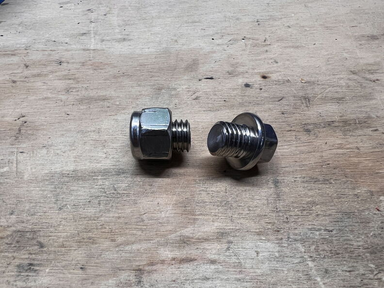

Kinda funny Mike and I were talking about this bolt the other day and yes it seized up while we were installing it.
http://garagescene.net/_data/i/uploa...c5796a5-me.jpg
camcojb 08-07-2023 05:45 PM
1 Attachment(s)
I learned long ago to use anti-sieze on all stainless bolts and nuts. Learned the hard way that is. :lol:
Part of the reason I went to zinc plated bolts in my latest build, plus I like the OEM look.

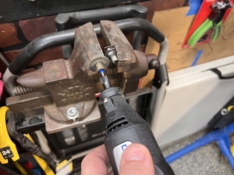

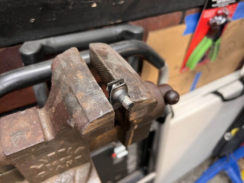

Inner Fender Bolt (( 08-05-23 ))
Just being safe here.
This inner fender bolt was protruding into the area near where the coolant hoses are. So just to be safe I shortened the bolt a little bit.
http://garagescene.net/_data/i/uploa...aed1eec-me.jpg
http://garagescene.net/_data/i/uploa...4553b51-me.jpg
Whatever you do don't let that hit your hand.
http://garagescene.net/_data/i/uploa...3e081d2-me.jpg
I quickly pulled the bolt out before it fused it self to the clip.
http://garagescene.net/_data/i/uploa...ff32ea4-me.jpg
and the good news is my hand is healing for the cut off wheel.
http://garagescene.net/_data/i/uploa...09d3e8a-me.jpg
Trust me we put on anti-seize however I can confirm it was not enough
camcojb 08-08-2023 05:31 PM
In the late 70's I had a 71 Camaro with a small block and 6-71 blower. I remember installing some Moroso anodized aluminum blower studs in the new Weiand intake by hand. Next day I went to remove them and several were like welded in place. Couldn't believe it, destroyed them getting them out. That's when I first learned about anti-sieze and the reason for using it lol.
