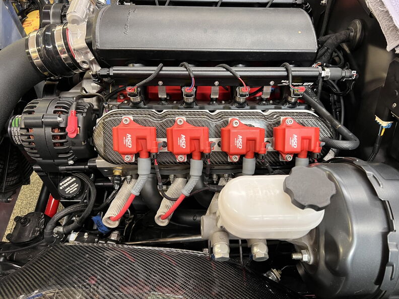

GM LSX Tall Valve Covers (( 09-23-23 ))

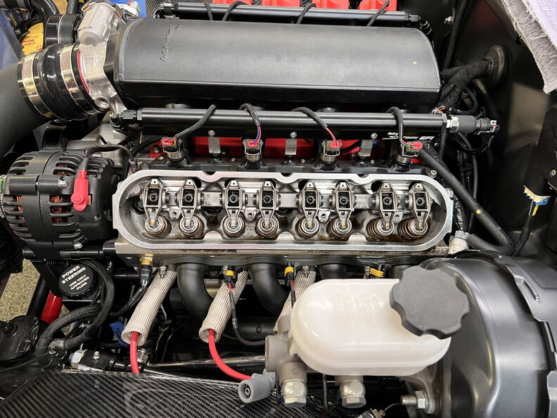

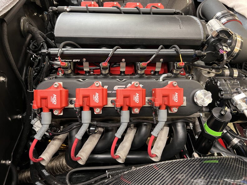

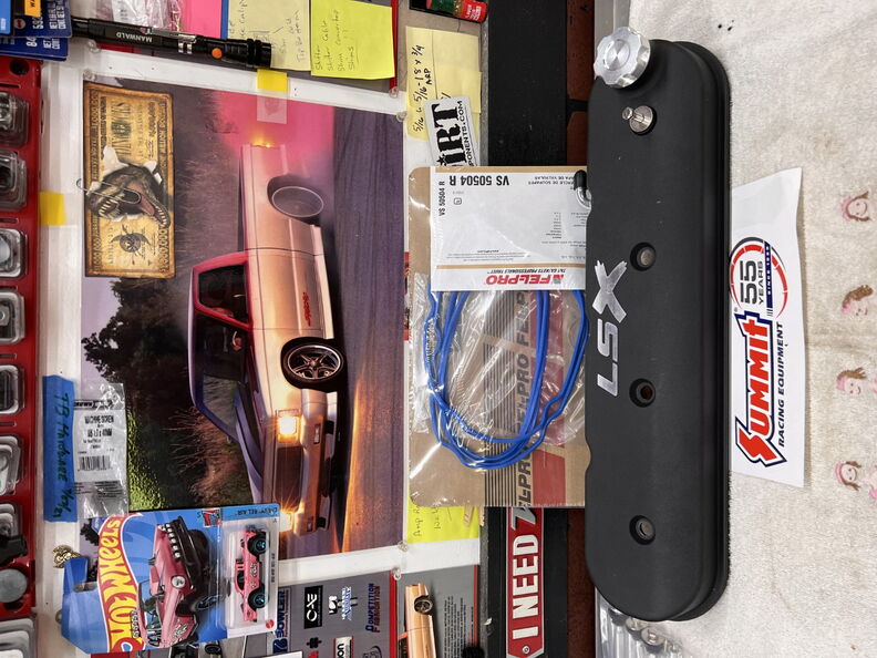

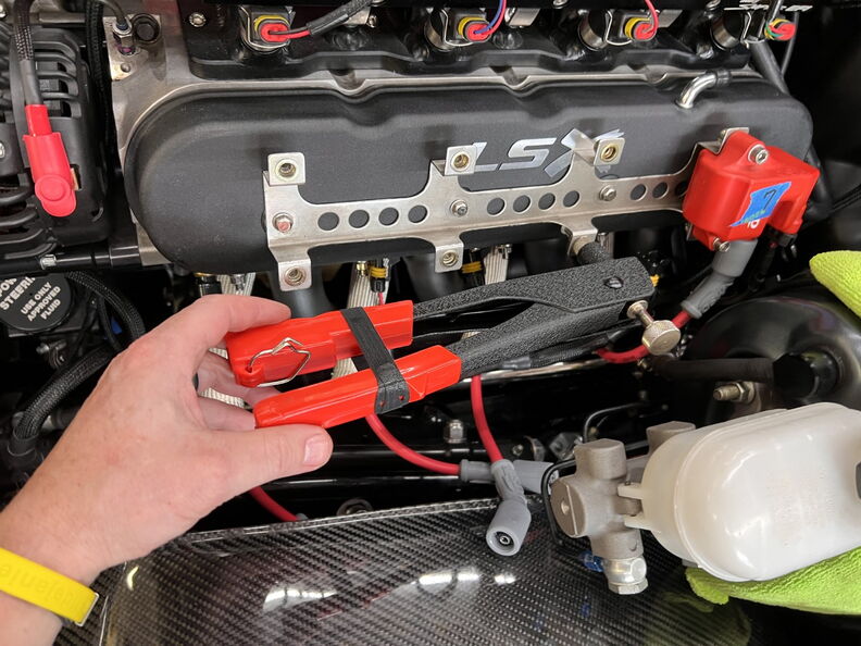

Good news the second set of Valve Covers arrived.
http://garagescene.net/_data/i/uploa...65c8600-me.jpg
These are so much nicer then the last set.
http://garagescene.net/_data/i/uploa...5a56eda-me.jpg

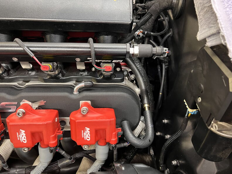

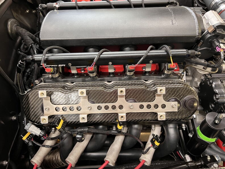

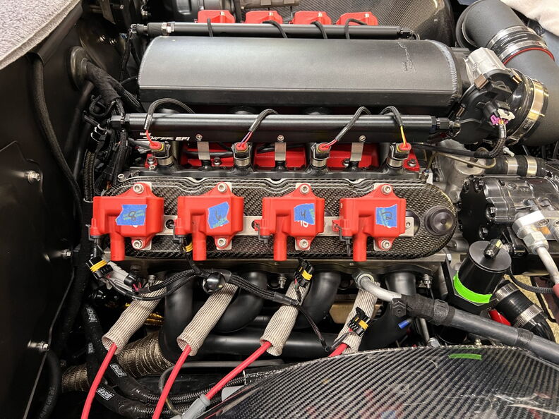

Coils coming off again.
http://garagescene.net/_data/i/uploa...171a021-me.jpg
http://garagescene.net/_data/i/uploa...8b18608-me.jpg
Now this is how a valve cover should look.
http://garagescene.net/_data/i/uploa...39e5288-me.jpg
Need to fix a loose blind nut.
http://garagescene.net/_data/i/uploa...fd22dbc-me.jpg

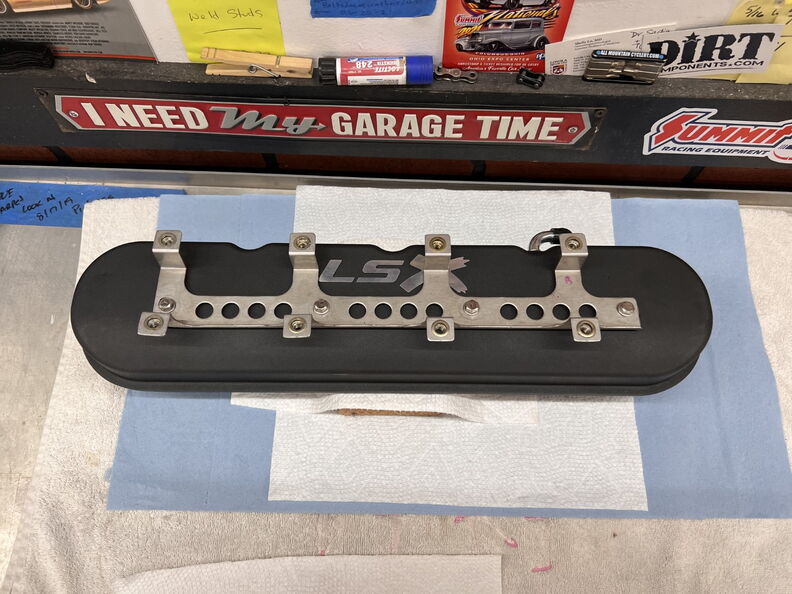

I moved over the coil mounts from the Carbon Valve Covers.
http://garagescene.net/_data/i/uploa...259660a-me.jpg
Torque to proper spec.
http://garagescene.net/_data/i/uploa...4e0ba0a-me.jpg
http://garagescene.net/_data/i/uploa...d1fe7e3-me.jpg
http://garagescene.net/_data/i/uploa...67854f0-me.jpg
Drivers Side
http://garagescene.net/_data/i/uploa...9a06d47-me.jpg
Since I didn't show this on the Passenger Side I did put a little bit of oil on the hardware.
http://garagescene.net/_data/i/uploa...edecbe5-me.jpg
http://garagescene.net/_data/i/uploa...18a0547-me.jpg
Sucks to have to cover up the LSX logo
http://garagescene.net/_data/i/uploa...5309dfa-me.jpg
http://garagescene.net/_data/i/uploa...fb85e0f-me.jpg
Ugh, I missed a loose blind nut.
http://garagescene.net/_data/i/uploa...76875d0-me.jpg
Need to redo this line.
http://garagescene.net/_data/i/uploa...60ef3ad-me.jpg
http://garagescene.net/_data/i/uploa...dde793c-me.jpg
http://garagescene.net/_data/i/uploa...1a0cc29-me.jpg

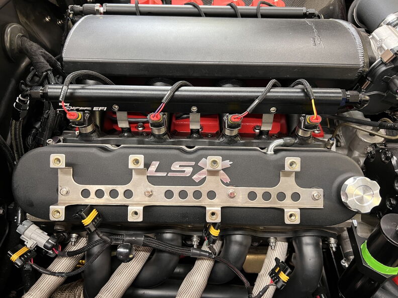

Good News they don't leak.
http://garagescene.net/_data/i/uploa...72e5ed2-me.jpg

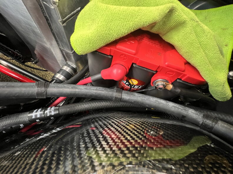

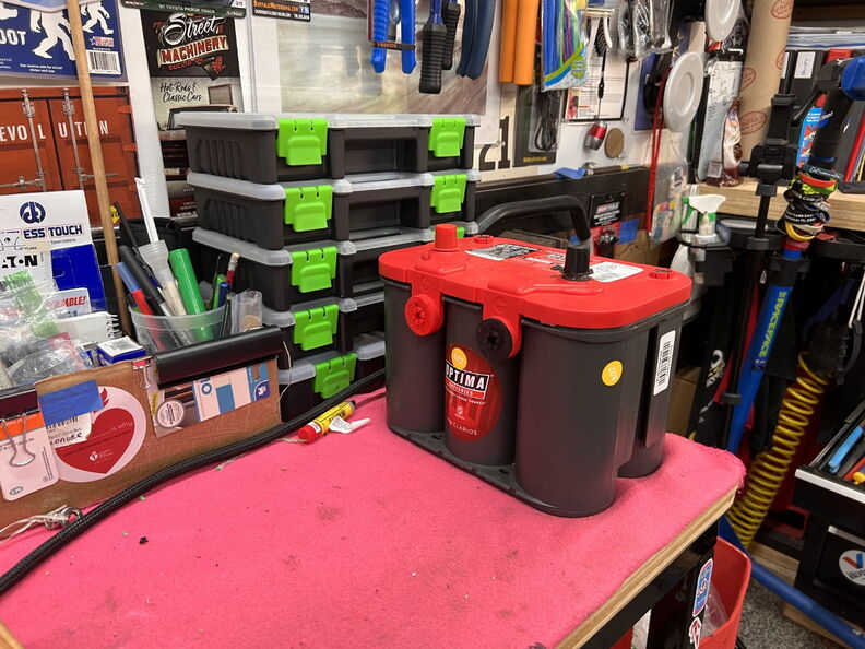

Optima Battery has been discharged and recharged (( 09-24-23 ))
So the optima battery is back and it is fully charged. I dropped it off at my buddy's shop so he could use the big Optima
charger so it could be reconditioned and charged back up.
http://garagescene.net/_data/i/uploa...1424a41-me.jpg
http://garagescene.net/_data/i/uploa...f6e7df1-me.jpg
I am getting tired of taking this battery in and out.
However, I am getting really good at it.
http://garagescene.net/_data/i/uploa...dbdc9f0-me.jpg
http://garagescene.net/_data/i/uploa...da6cf86-me.jpg

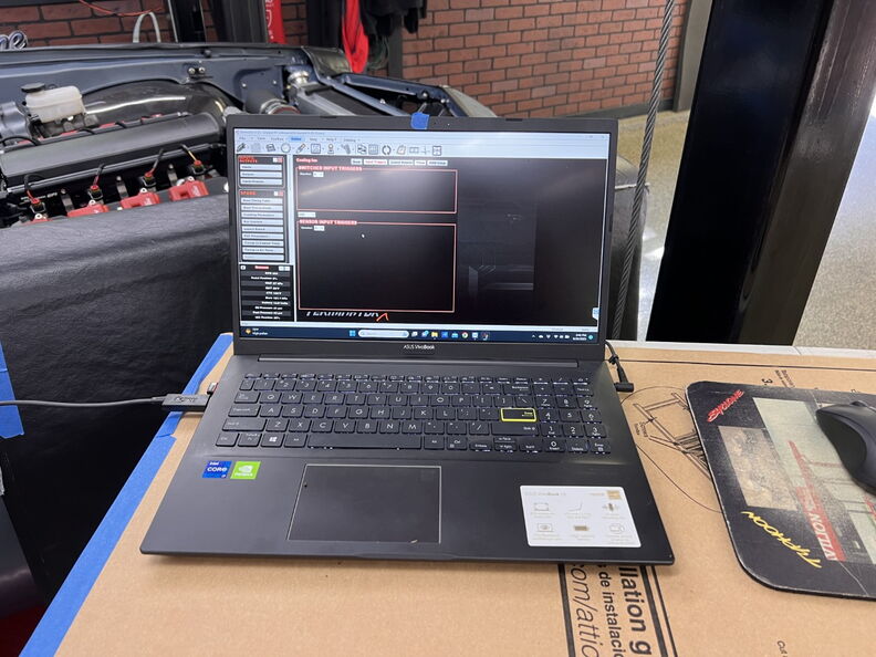

Dr EFI Andrew is in the house ''Virtually'' (( 09-29-23 ))
Well, Andrew is back in the house and it's a Friday.
http://garagescene.net/_data/i/uploa...f35a876-me.jpg
http://garagescene.net/_data/i/uploa...c1c83c1-me.jpg

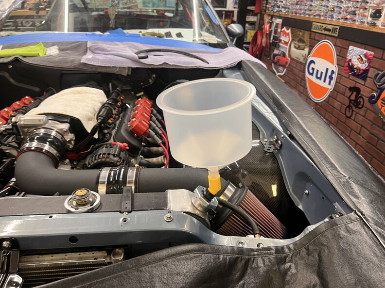

Andrew was kind enough to log back into my car and tweak the tune just a little bit. He confirmed my PWM fan connection
to the Holley worked and we figured out that my thermostat wasn't opening.
We also assumed that there was still air in the cool heads and he sent me out to get the Funnel fill set up.
http://garagescene.net/_data/i/uploa...dac8a51-me.jpg

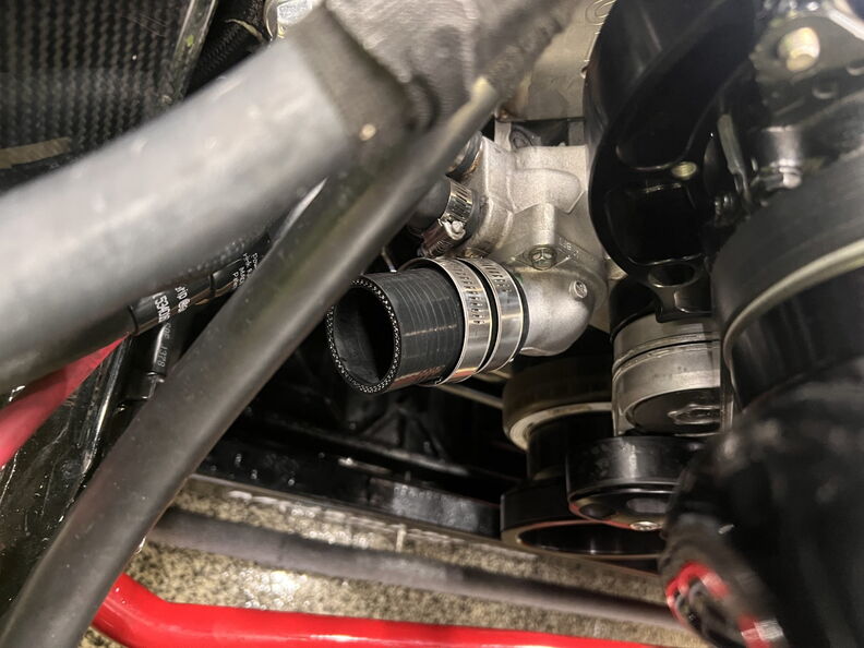

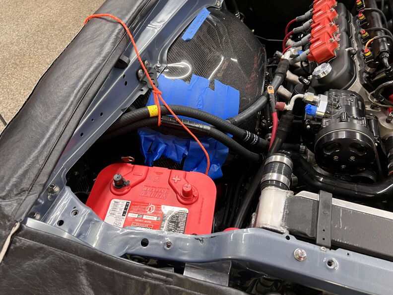

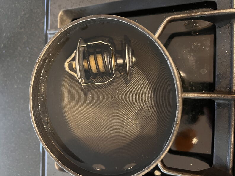

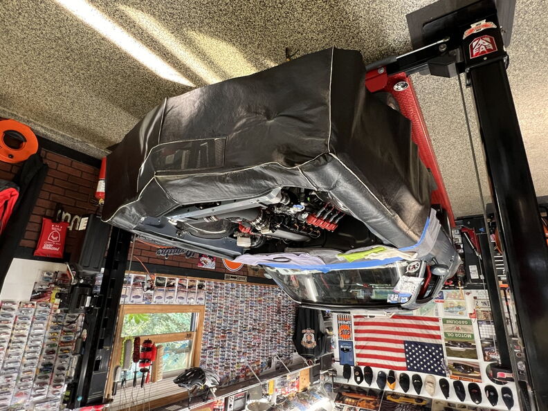

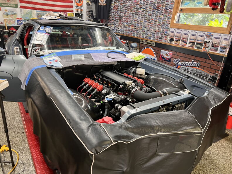

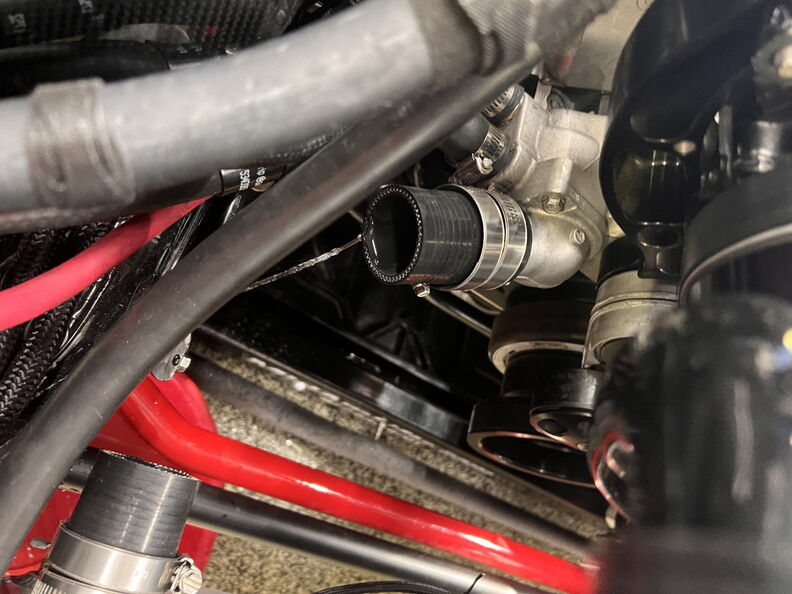

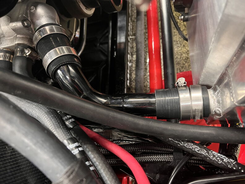

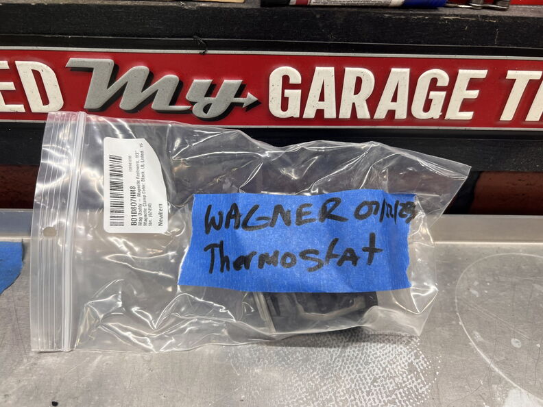

Swapping the Thermostat (( 09-30-23 ))
Back in the garage and plan to change out the thermostat.
http://garagescene.net/_data/i/uploa...c7ee57e-me.jpg
please don't tell my wife.
http://garagescene.net/_data/i/uploa...5c2269d-me.jpg
Here we go again.
http://garagescene.net/_data/i/uploa...b93e056-me.jpg
So, as I was taking the Thermostat housing out one of the bolts fell directly behind the battery against the core support.
http://garagescene.net/_data/i/uploa...2586c8c-me.jpg
Thank god the bolt was steel and I was able to fish it out from behind the battery with a magnet.
http://garagescene.net/_data/i/uploa...9f1b678-me.jpg
Housing is back on and I hope this works.
http://garagescene.net/_data/i/uploa...d486cb1-me.jpg
While I was there I finally put the cover on the positive terminal.
http://garagescene.net/_data/i/uploa...17a6013-me.jpg
Back together again.
http://garagescene.net/_data/i/uploa...78db60f-me.jpg

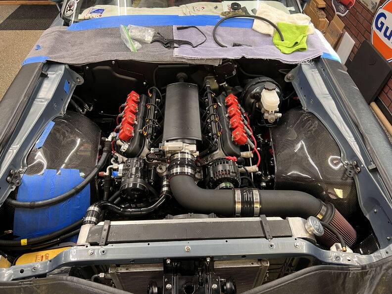

Picked up the Funnel Fill kit.
50 Dollars at Advanced Autoparts and the China Knock off is $20.00 on Amazon.
http://garagescene.net/_data/i/uploa...3792868-me.jpg
I can't believe how well this works.
http://garagescene.net/_data/i/uploa...92ca3dd-me.jpg
http://garagescene.net/_data/i/uploa...108442e-me.jpg

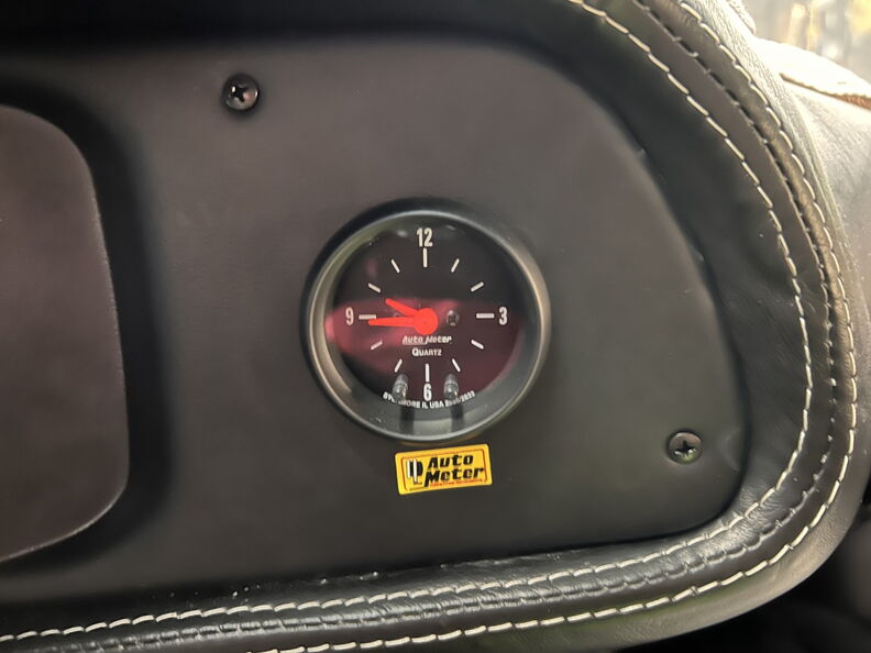

Clock works
http://garagescene.net/_data/i/uploa...9276aec-me.jpg

andrewb70 10-02-2023 05:43 PM
I forget where I saw the funnel being used for the first time, but after I tried it, I was sold.
Andrew
