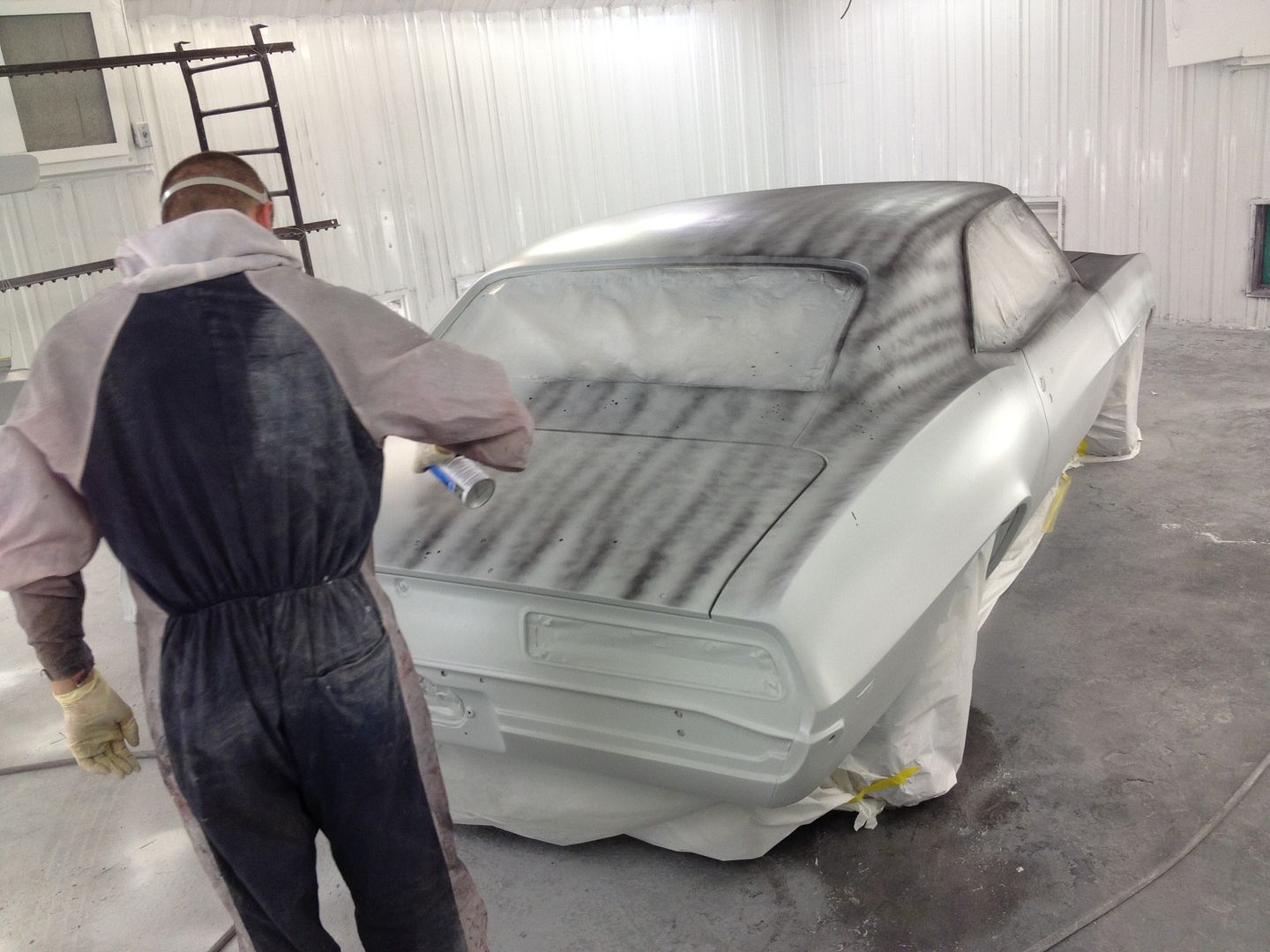

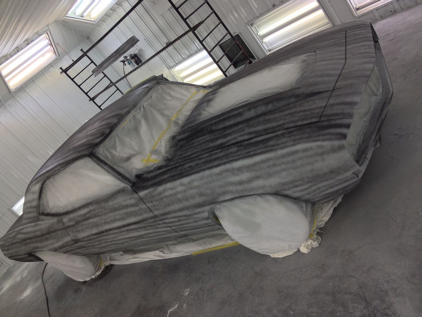

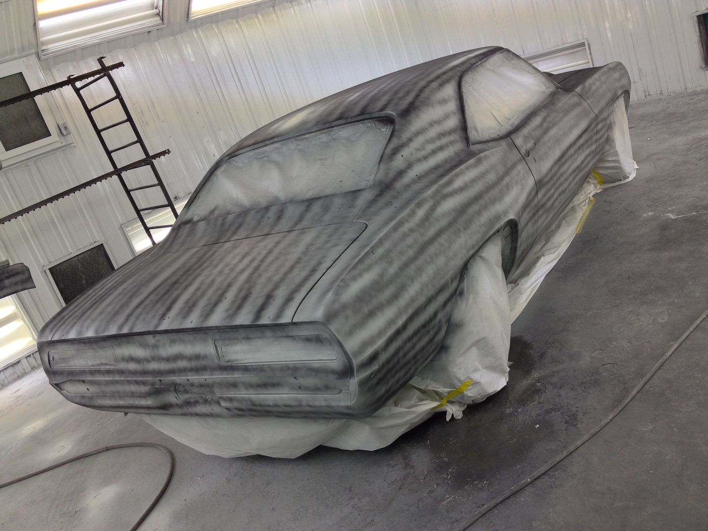

Things continue to progress. After some trial fitting of the grille and passing one of Kelle's tough quality control scans, Nathan applied the Evercoat Super Build 4:1 polyester primer and guide coat.
http://i1140.photobucket.com/albums/...ps3ff42438.jpg
http://i1140.photobucket.com/albums/...psbd35ccfb.jpg
I kind of like the custom, hand painted, zebra racing stripes. hehe
http://i1140.photobucket.com/albums/...psffc91cb4.jpg
http://i1140.photobucket.com/albums/...ps933b9532.jpg
http://i1140.photobucket.com/albums/...ps6c2ef6ab.jpg

If you look at the third and forth pictures fast they look like drawings instead of photos. I drool every time I see that hood! Nice progress guy's and Kelle.
