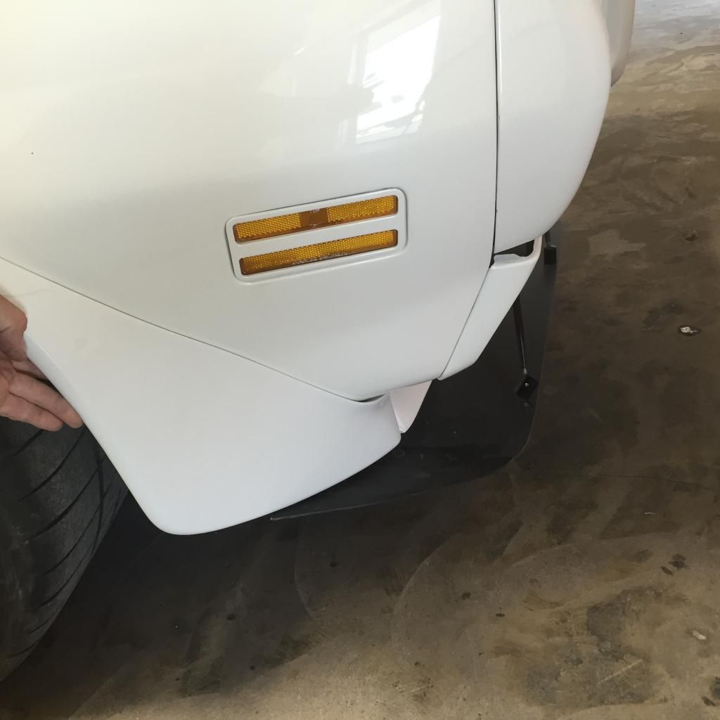

Fender flares are coming along. Getting closer to a before and after shot.
http://i1372.photobucket.com/albums/...psakeuulry.jpg
