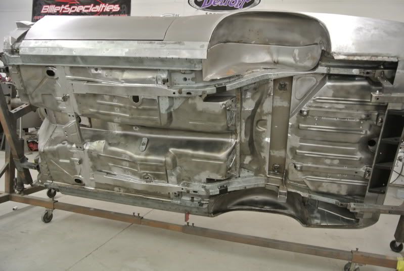

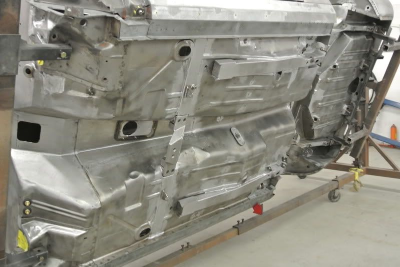

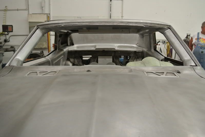

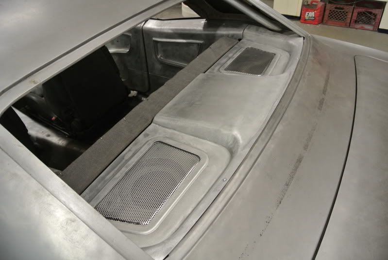

Small update:
Finished out the under side and still building interior panels
http://i32.photobucket.com/albums/d3...e/DSC_0364.jpg
http://i32.photobucket.com/albums/d3...e/DSC_0365.jpg
http://i32.photobucket.com/albums/d3...e/DSC_0349.jpg
http://i32.photobucket.com/albums/d3...e/DSC_0396.jpg
http://i32.photobucket.com/albums/d3...e/DSC_0398.jpg
http://i32.photobucket.com/albums/d3...e/DSC_0399.jpg
-troy

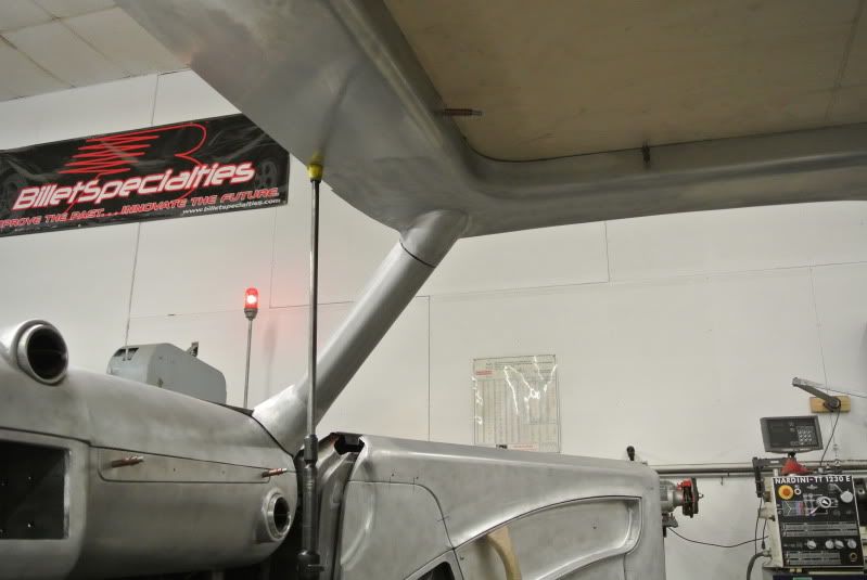

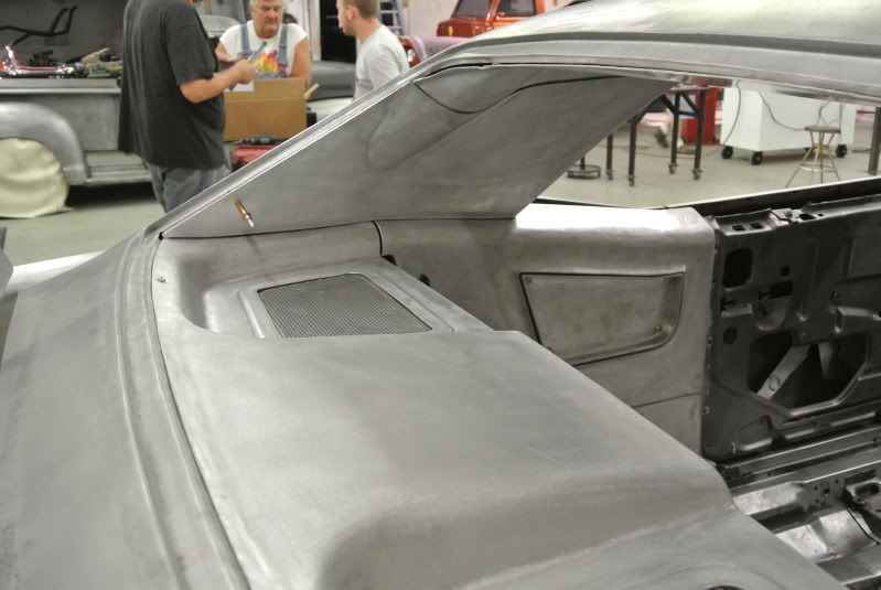

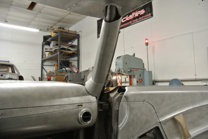

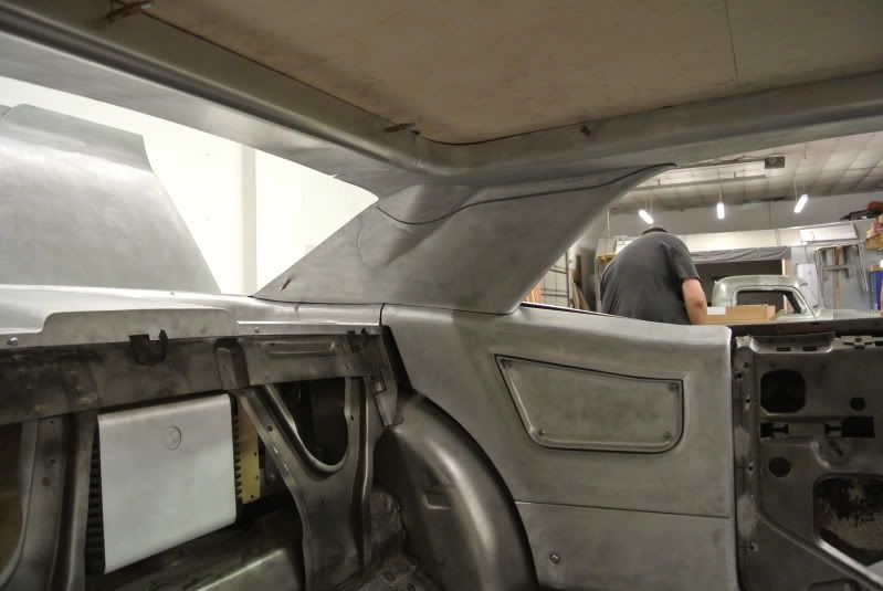

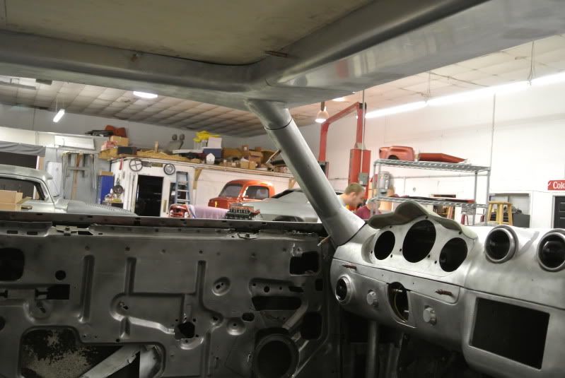

BBT FAB 07-13-2012 08:53 AM

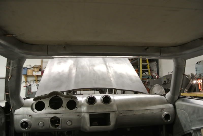

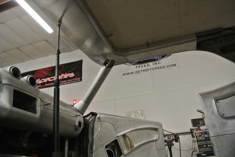

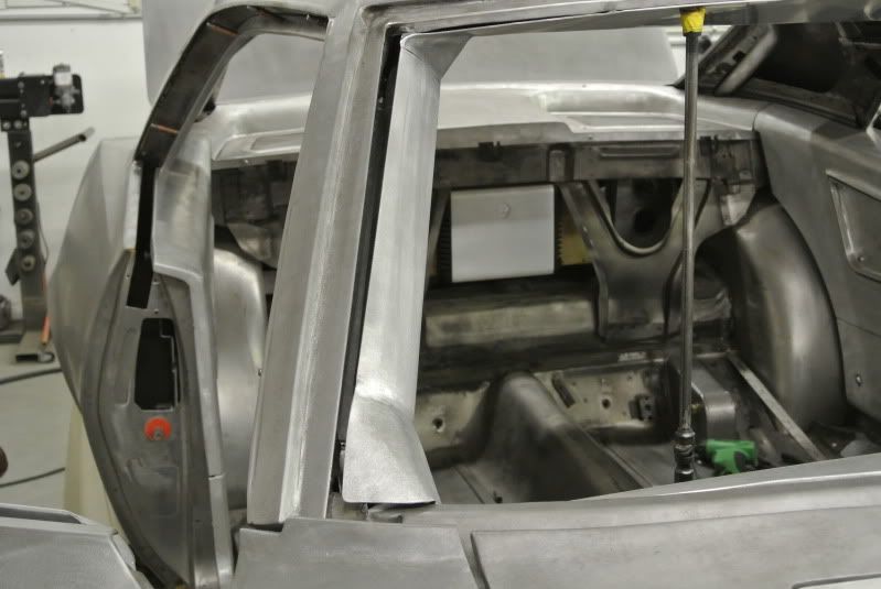

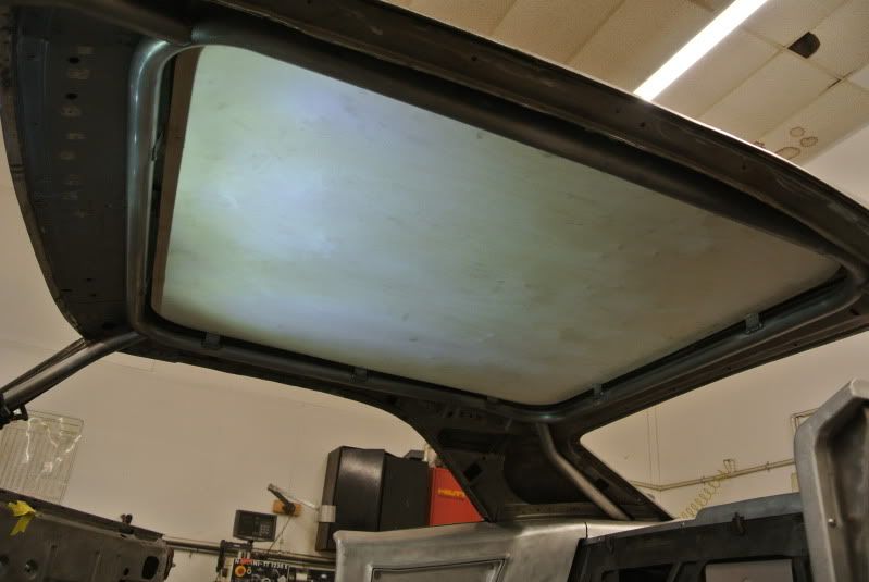

working on the headliner...
http://i32.photobucket.com/albums/d3...e/DSC_0415.jpg
http://i32.photobucket.com/albums/d3...e/DSC_0416.jpg
http://i32.photobucket.com/albums/d3...e/DSC_0417.jpg
http://i32.photobucket.com/albums/d3...e/DSC_0419.jpg
http://i32.photobucket.com/albums/d3...e/DSC_0420.jpg
http://i32.photobucket.com/albums/d3...e/DSC_0435.jpg
http://i32.photobucket.com/albums/d3...e/DSC_0436.jpg
http://i32.photobucket.com/albums/d3...e/DSC_0437.jpg
http://i32.photobucket.com/albums/d3...e/DSC_0438.jpg
http://i32.photobucket.com/albums/d3...e/DSC_0439.jpg
-troy
