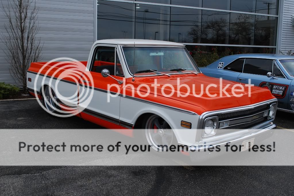

incredible work on all of the projects. just awesome. I may have missed it, but whats the wheel/tire combo on the C10? who's wheels?
CTorosian 12-02-2011 01:24 PM
C-10 is looking great, what's under the hood?

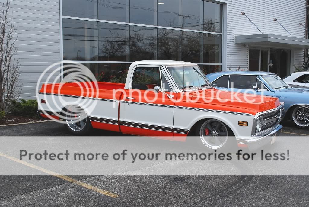

It has been a while since I updated this thread so here we go!
We have the C10 just about wrapped up. Should be heading to Upholstery early next week.
http://i563.photobucket.com/albums/s...ture220103.jpg
http://i563.photobucket.com/albums/s...ture220107.jpg
http://i563.photobucket.com/albums/s...ture220101.jpg
Going to keep the interior pretty stock looking to match the exterior. Going with a set of 70 buckets with the original center console. Seats are going to be slightly bolstered, but keep the stock feel. We are thinking of black leather with black/white hounds touth inserts.

Thanks, it has a LS6 with a TKO 5-Speed

Thanks Jay. It has Torq-Thrust wheels 18x8 and 20x10 with BFG KDW tires

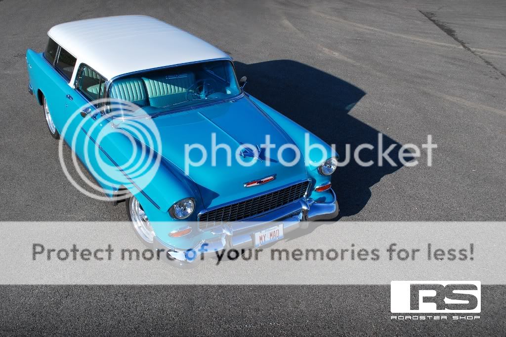

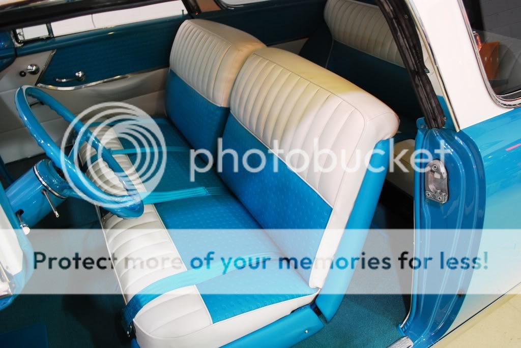

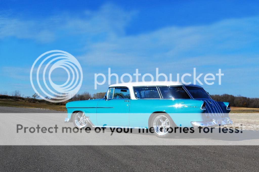

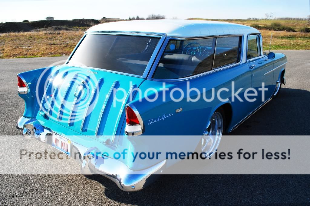

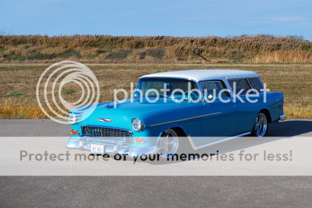

Here are a few more recent projects that I forgot to post lately.
We wrapped up the 55 Nomad about two weeks ago. Pretty cool, resto-mod type build.

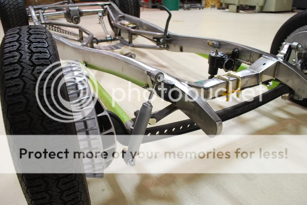

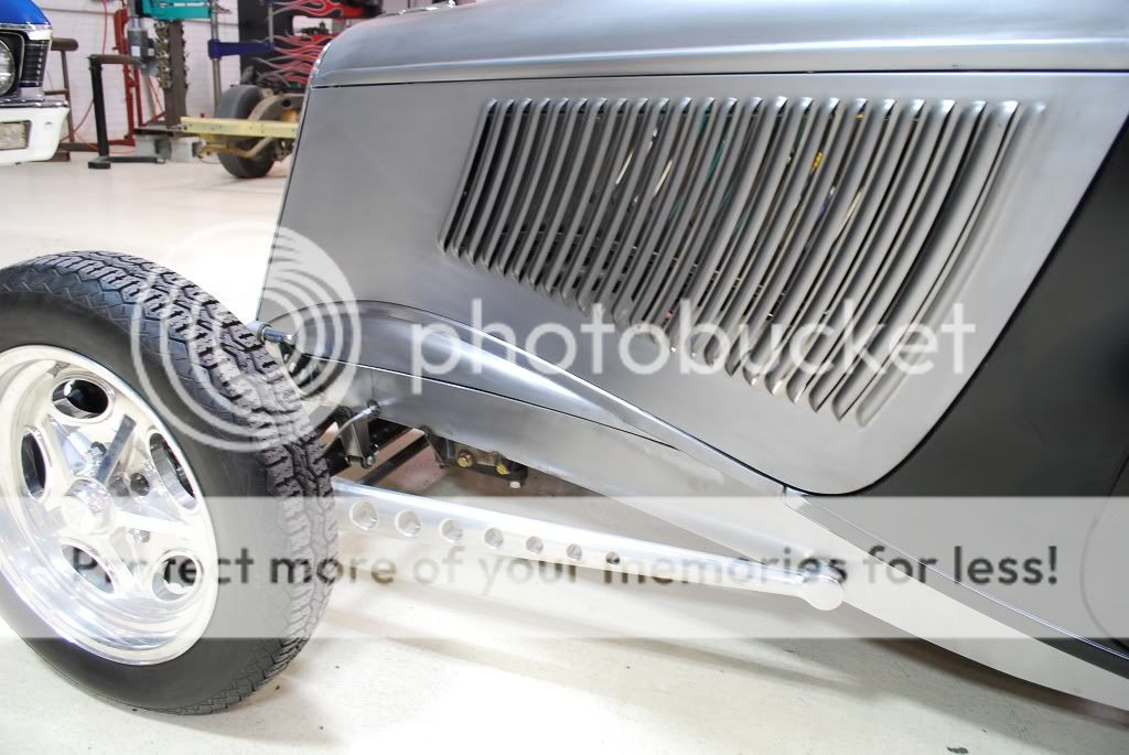

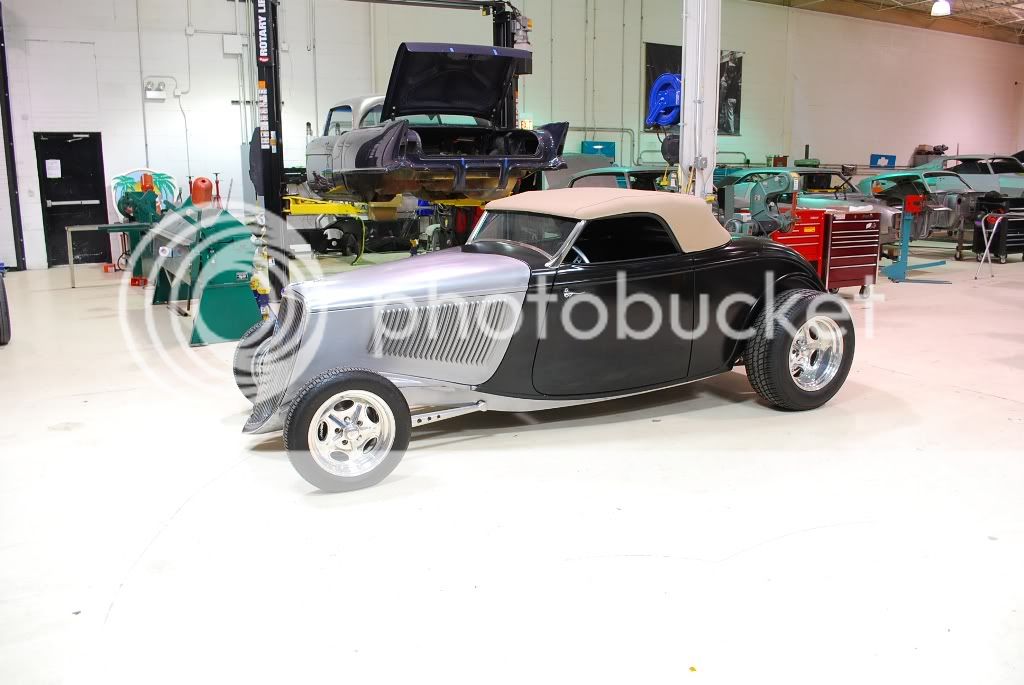

Here is another 33 with some unique custom touches.
Custom chassis using Johnson's Hot Rods Wishbones front and rear, Winter's Q/C, 5" drop axle and Buick style brakes for a real traditional feel.
http://i563.photobucket.com/albums/s...ture219064.jpg

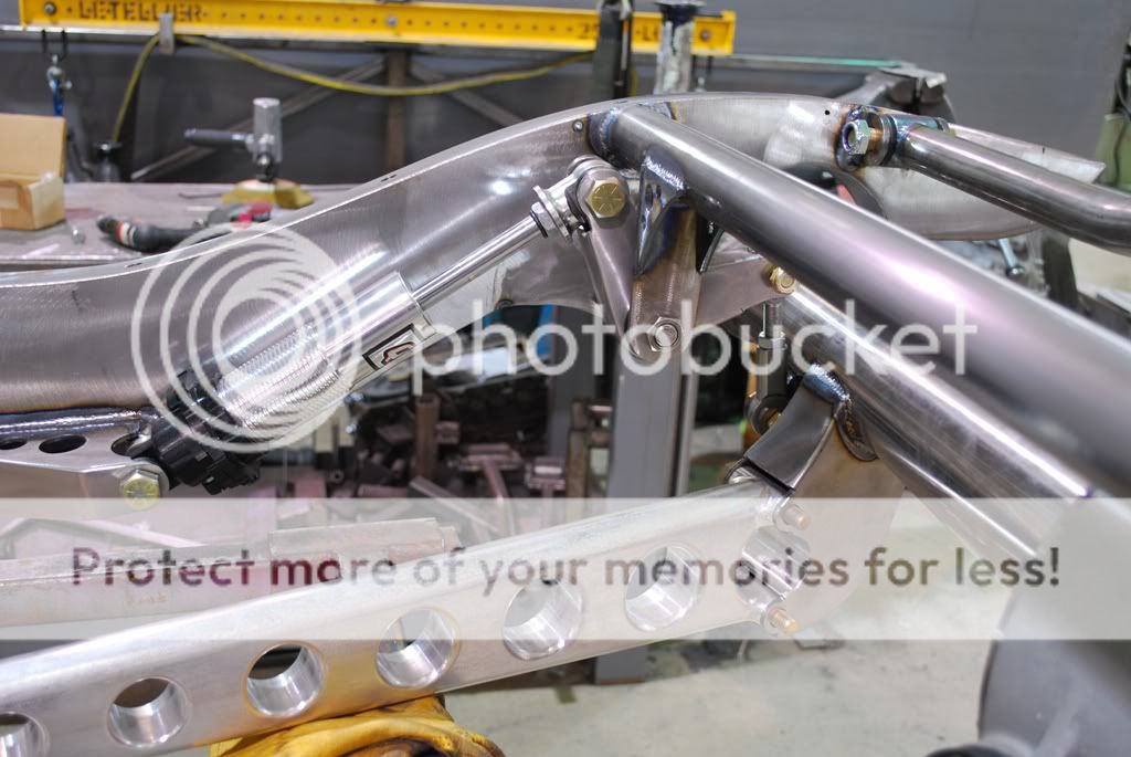

The customer didn't want to see the rear coilovers from the rear of the car so we mounted them on the frame rail with a rocker arm set up.

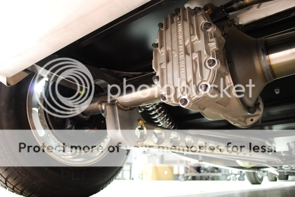

A few nice detail shots of the build. There is a full build up on our web site for those interested in the original hot rod stuff.

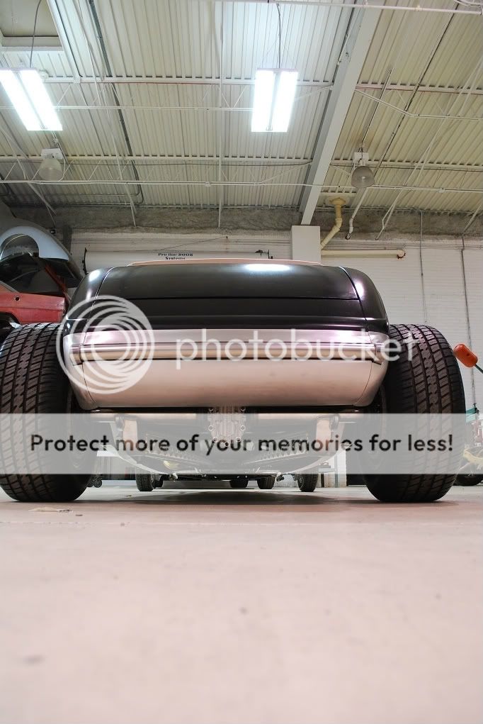

Really cool shot of the back of the car. It makes a big difference whent he rear coilovers are hidden. The split and drilled bones have a great look with the Q/C here as well. We also fabbed the rear section of the car to look like a variation of a stock gas tank.
http://i563.photobucket.com/albums/s...ture219300.jpg
Better view of the coilover

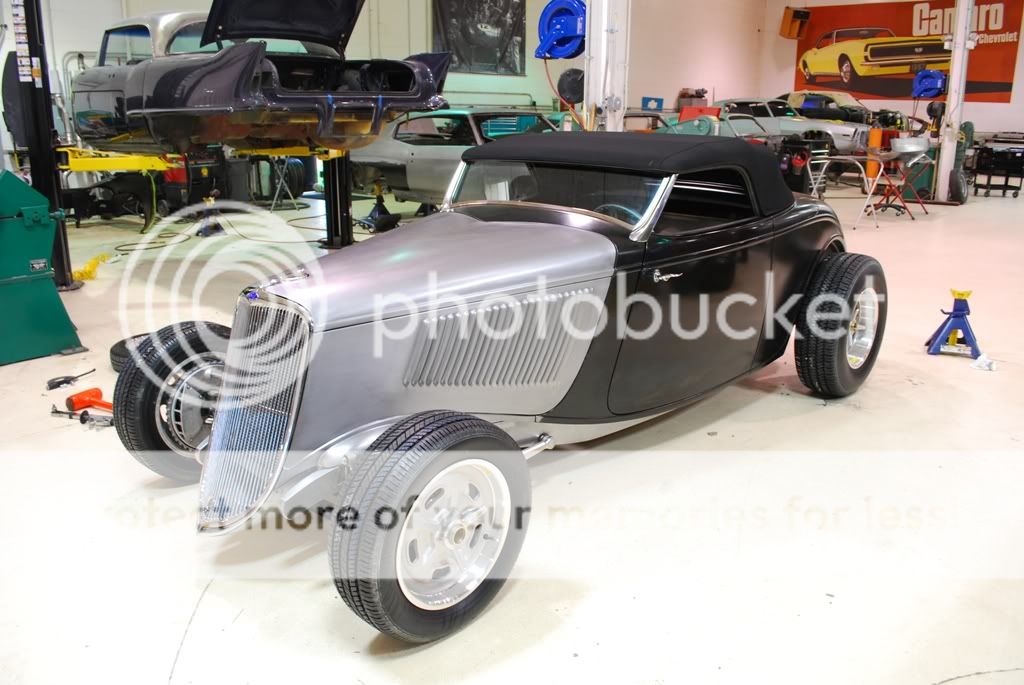

First look
http://i563.photobucket.com/albums/s...ture219270.jpg
Final look with black top and the So-Cal true knock off wheels.
