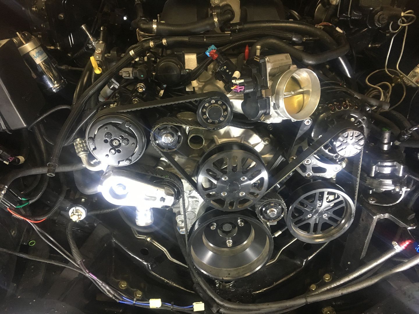

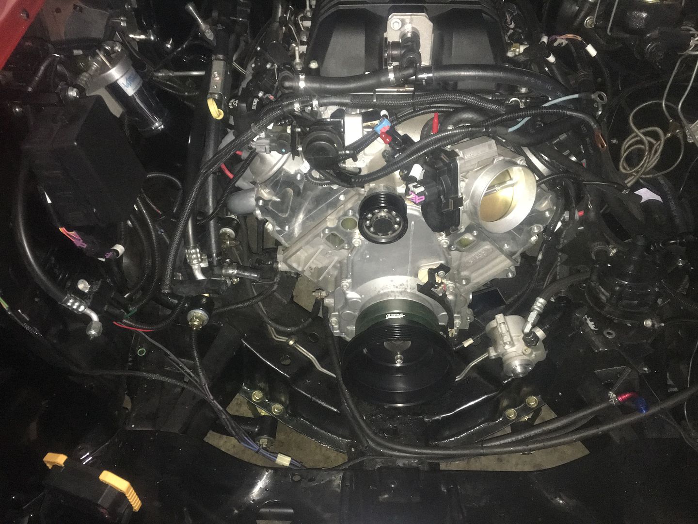

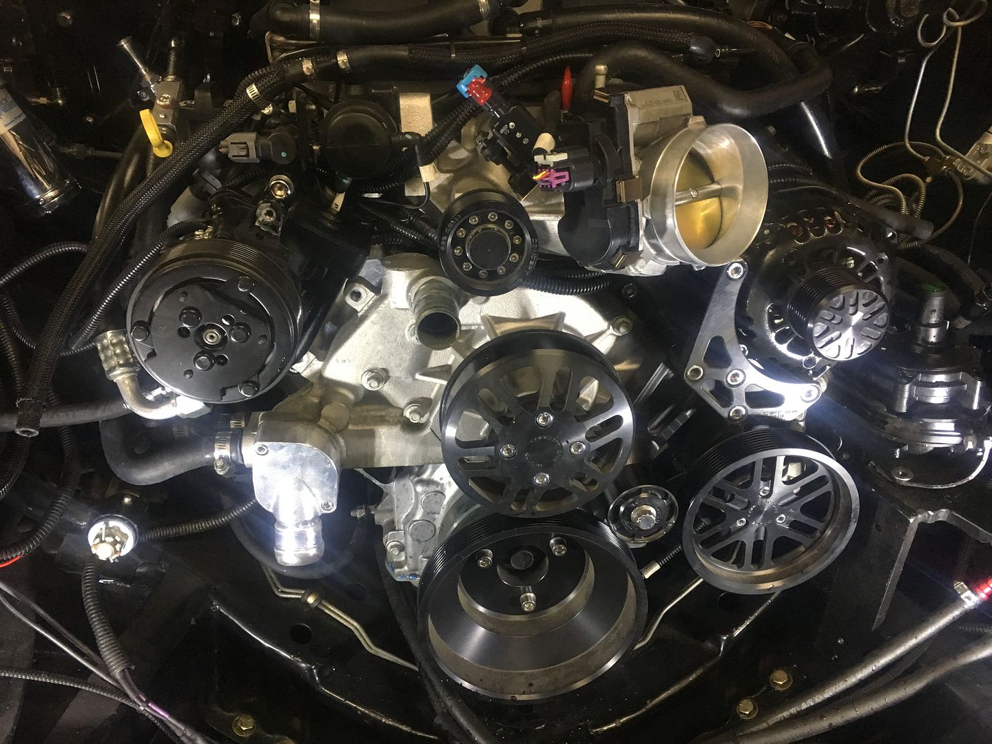

Time to fix another issue that came up with this particular combination...… I bought a Concept1 front drive system while putting the car together. After final assy it turned out that the single belt front drive setup was designed to run everything off the forward positioning of the Super Charger drive pulley. This had all the pulleys and tensioners in that forward position. After the Radiator and fans were installed, everything fit but just barely..... If something would have happened on the road there would have been some major issues having access to the components on the front of the engine..... An uncomfortable position I didn't want to put myself in..... So...… In looking at the other set-ups that are available, I decided to get purchase a Wegner LSA drive.....A two belt set-up that will provide a lot more access for maintenance in this particular application...… So... If you are going to need a LSA front drive set-up and install it in a car that has more clearance in front …… Here is a 100% complete Concept 1 system that has only a couple thousand miles on it and you can save a lot of $$$$$...… LOL....
Here are some ongoing pic's of the change over
New Wegner assy
http://i13.photobucket.com/albums/a2...DE50934EB5.jpg
Radiator out …… Concept 1 unit ready to come out....
http://i13.photobucket.com/albums/a2...493F85F3B5.jpg

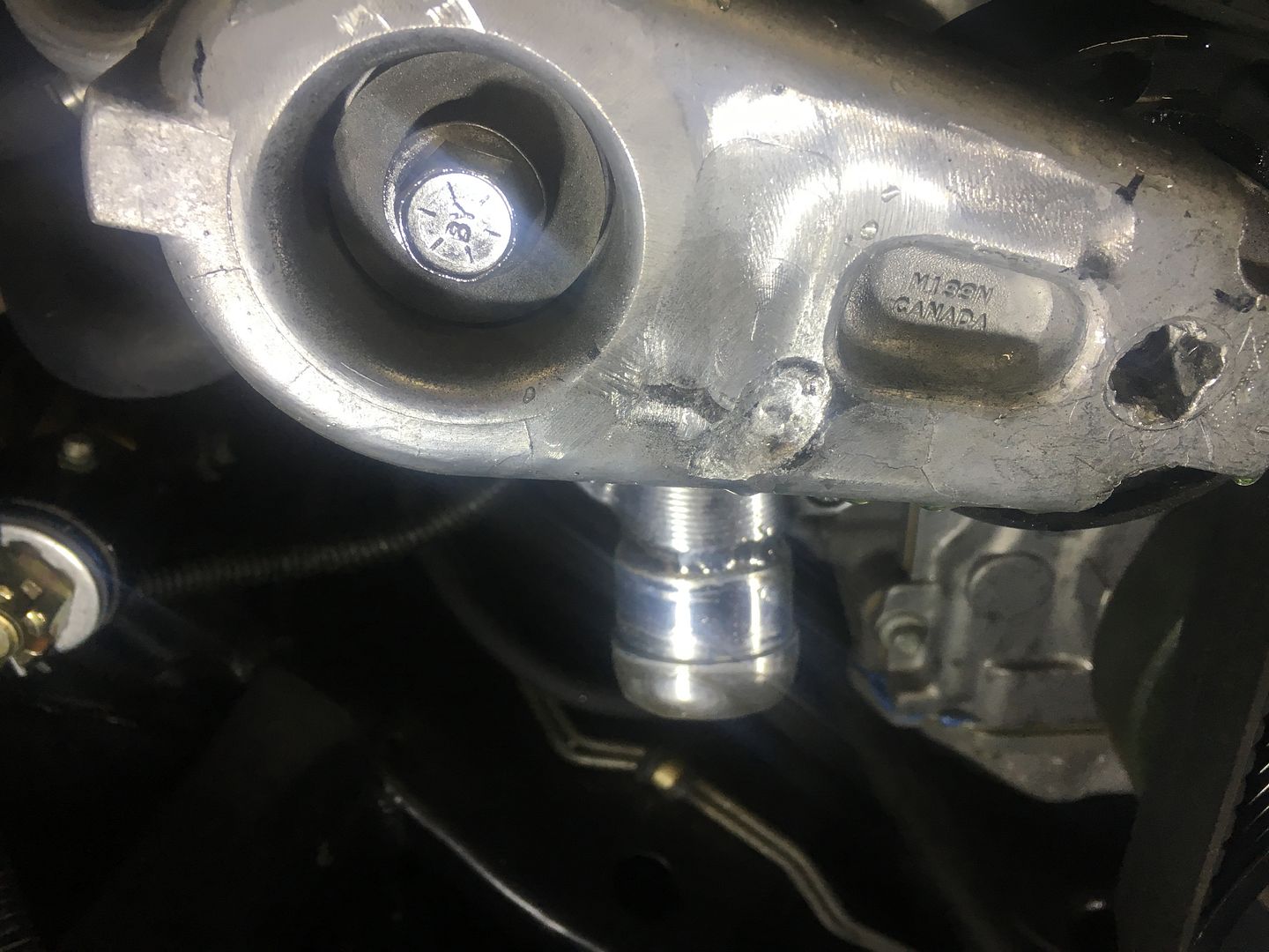

You can see where the fan was making contact with the Tensioner
http://i13.photobucket.com/albums/a2...3ED92A1DC9.jpg
http://i13.photobucket.com/albums/a2...CFC5C82FCD.jpg
http://i13.photobucket.com/albums/a2...AA30CB2298.jpg
I have a harmonic Balancer puller in the garage some where......LOL......Waiting for the new one to show up so I can get this one off and start the re-install..

is that thermostat housing a custom piece or can I order it somewhere, got some space issues right there with my bracket for the supercharger and it looks like that would solve it :lol:
kwhizz 02-19-2019 03:28 AM
Originally Posted by warhawkchevelle (Post 689810)
Hi! Been following your project for a while in silence.
looks like a well thought build and nice car :)
The Billet Thermostat housing is from Concept1...….
