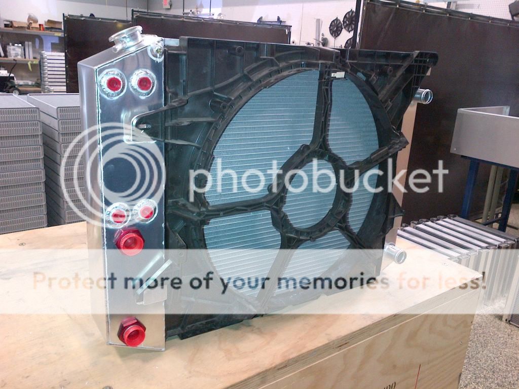

I had Dewitt’s radiator custom make me a radiator core and intercooler core. The cores nest together to make an efficient package. The assembled the cores with tanks and mounted them togther. I had it made 23 inch tall and 24 inched wide to fit a Cadillac SRX turbo fan and shroud. After a long conversation with C&R they supplied a 10 kW oil cooler for the end tank. Dewitt also built in the power steering and transmission coolers. It maybe a bit overkill but I want to get the temps under control on the new car.
http://i439.photobucket.com/albums/q...psded7cfa0.jpg
The top two coolers are power steering and transmission. The lower cooler is the engine oil cooler. Using oil to water coolers it will help heat and cool the oil.
http://i439.photobucket.com/albums/q...ps7ba89dea.jpg
I plan on mounting it as an assembly on Duramax Diesel radiator mounts. This thing is off setting some of my mass savings.
Dewitt did a killer job of building this deal. Having the ability to custom make everything makes a very nice package.

Doesn't matter how light it is if it's over-heated and parked. Nice bit of creative engineering. :thumbsup:
coolwelder62 02-05-2013 08:31 PM
Would love to see what the coolers inside the radiator look like.
